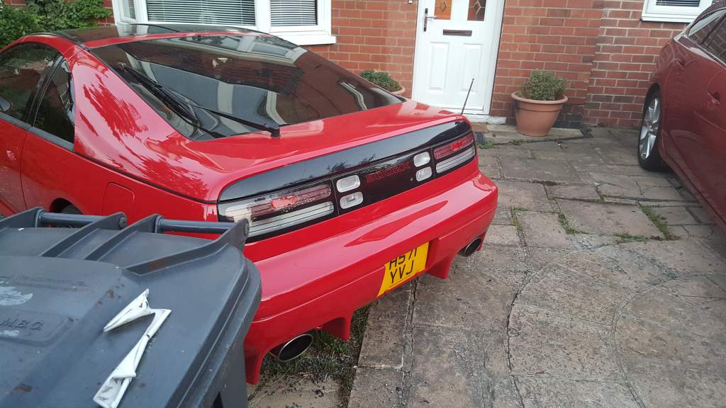

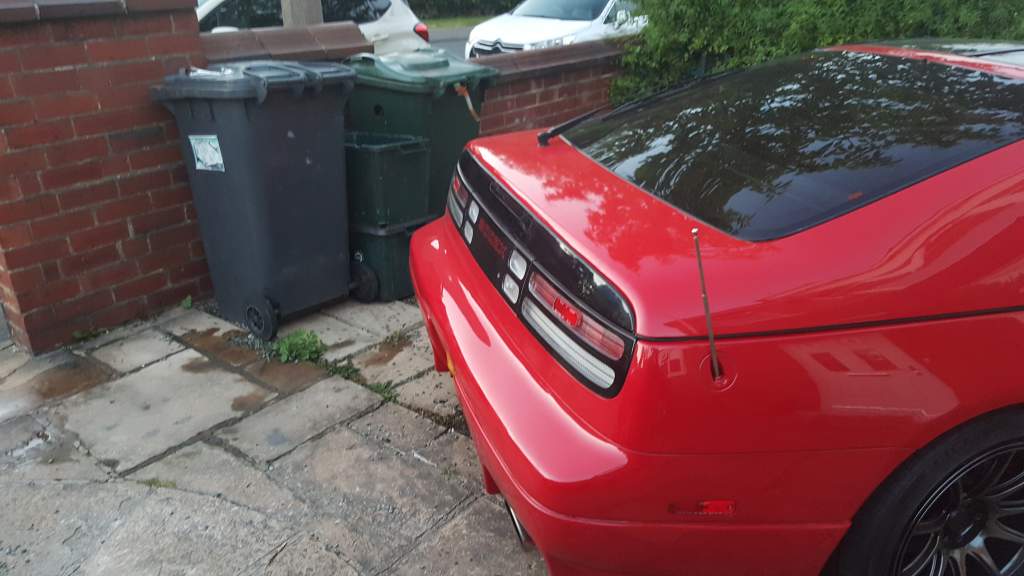

Missing the perspex strip on the back deliberately or is a spoiler going there?
Deliberately mate. Need to get one... anyone know the part code for it?
Looking much better Joel :thumbup1:
Cheers Gaz. Finally the car actually looks nice haha
Looks great, brings back happy memories for me seeing a freshley kitted and painted red zed.
You could do with some clear side indicator covers though :)
The new strip arrived... had to bond it on due to the clip holes being filled in but it's done and happy about the result

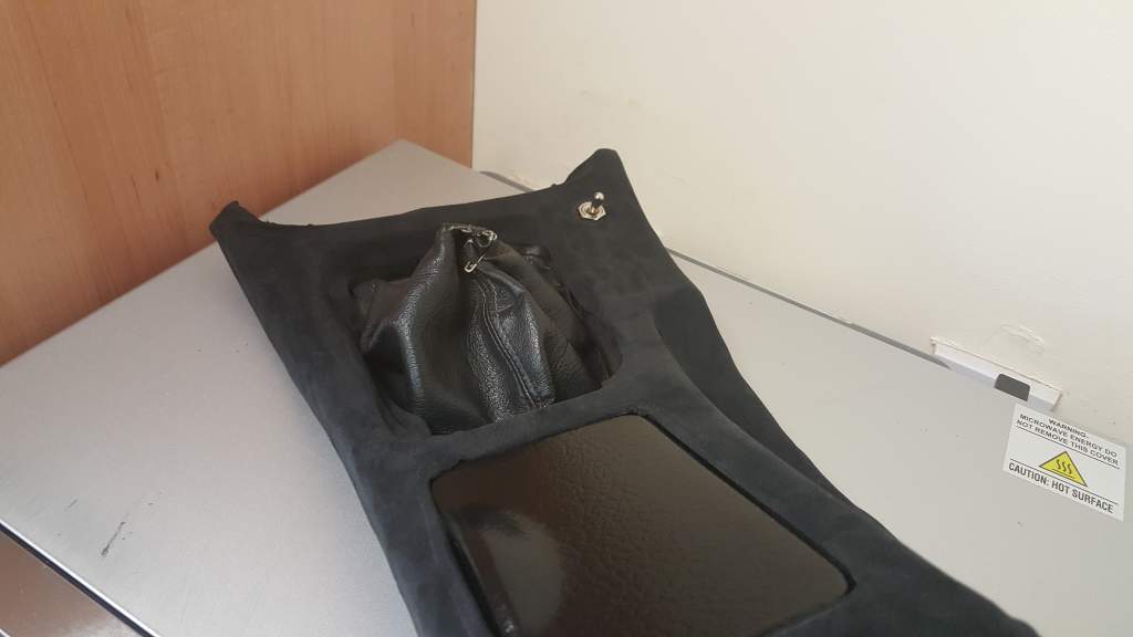

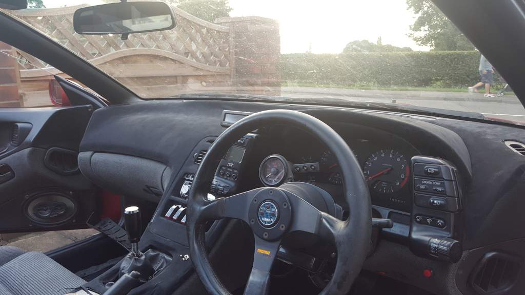

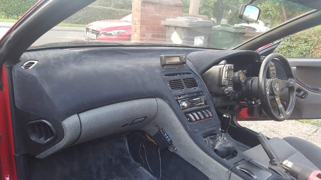

Just wanted to test how it would look with suede down the centre and to be fair I like it... took me a while to get it right... some small bits but over all happy with the result :)
The one I have hooked up (the one that's lit up) is the fuel pump... it's more of a deterant really

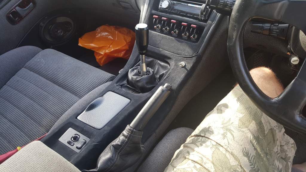

Interior completed. Love the result. Hate doing stuff like this but we'll worth it. Took 2 hours and a very frustrated person XD
How did you prep the dashboard, Joel? I take it that the original grained vinyl is still underneath the new cover...?
Yeah it is made. I had to clean it very well to get all the grease off etc... it's a pig for stuff to stick to it.

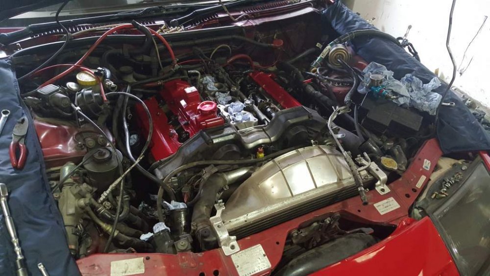

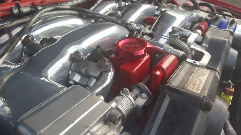

Engine been apart today to have rocker gaskets done also changed rockers for powdercoated pair and also changed plenum for powdercoated one. :D
Not sure about the suede console and radio bezel but the dash is kool! You're not concerned about the console and such staying clean?
I like your ingenuity and grit to get it done however!
Well. The dash is no longer like that... if you want something done have it done properly aha. I have learnt that. I was peeling off etc so it's back to the original now. But it's something to consider in the future :)
The only way to successfully trim a dashboard in any material is to strip the original vinyl cover off completely. I've found this out the hard way!
Haha yeah something for the future though

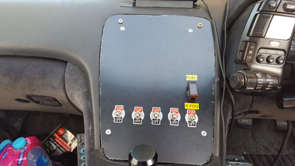

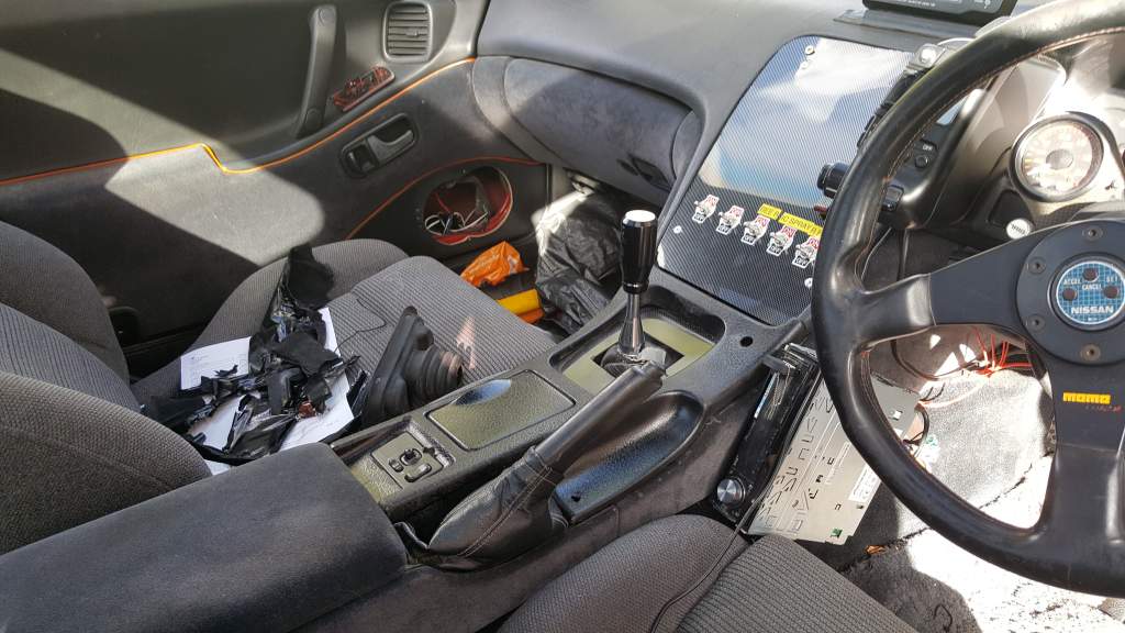

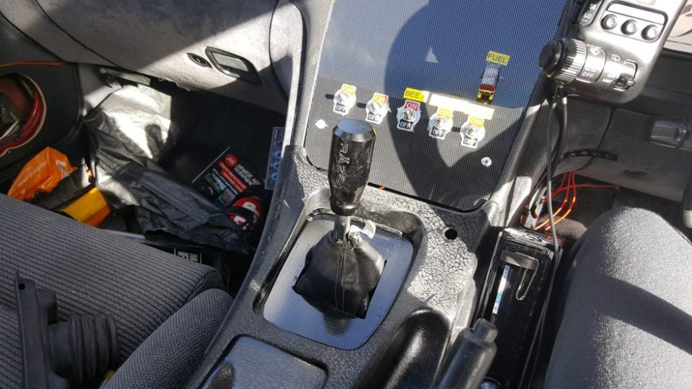

Making a switch centre console. Love it so far but isn't finished yet ;)
Real carbon fibre gear gator cover now cut and shaped and fitted. I like it :)

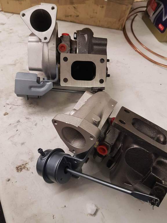

As you may know I hit some problems with my zed... regards to loads of smoke etc.
Turns out it was the turbos.
The drivers side was that bad the turbo was seizing up under high boost.
So I sent it to outlaw customs....
Now I have my turbos back with new parts on them including 360 race bearings and gap seals

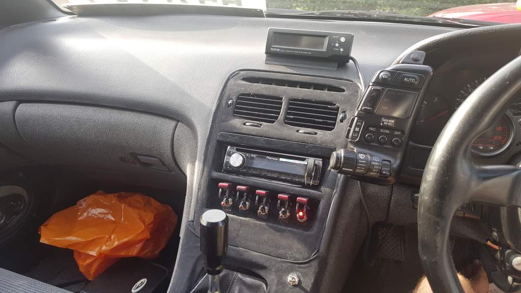

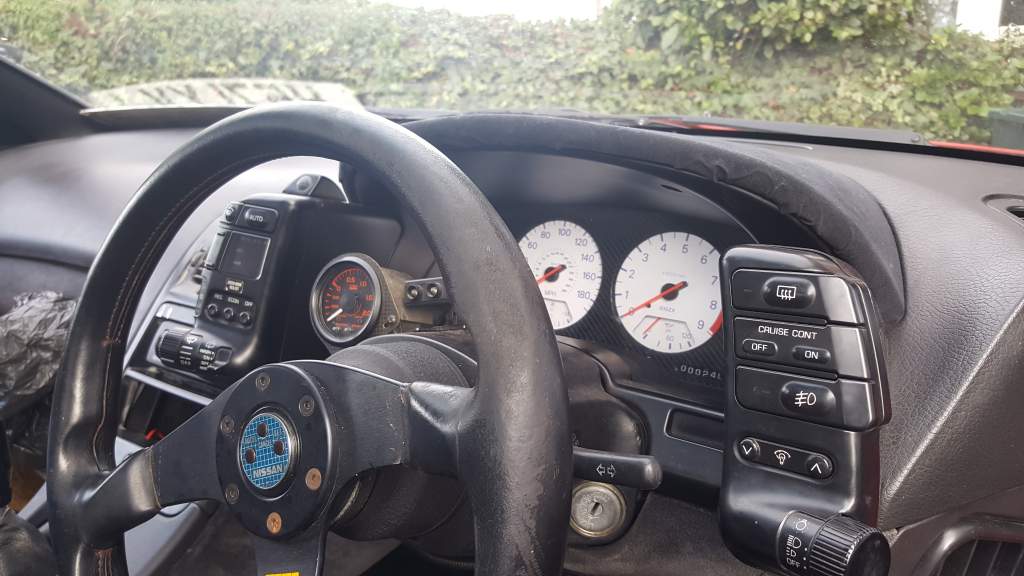

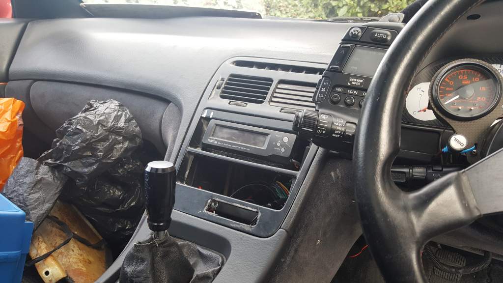

Also managed to get my hands on some white UK clocks and a original centre console. (I'm growing up)
Also managed to fix the electrical problem with the fuel pump. Now have it on a little switch in the centre console as you can see
Not finished yet as you can see but looking better day by day :)
