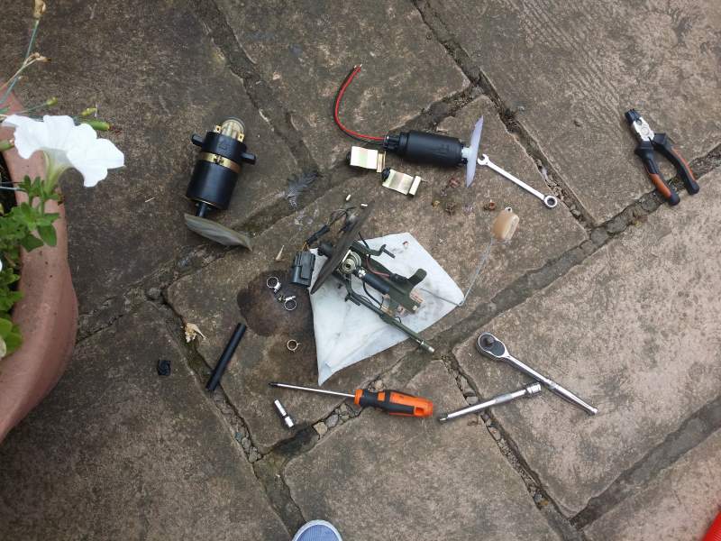

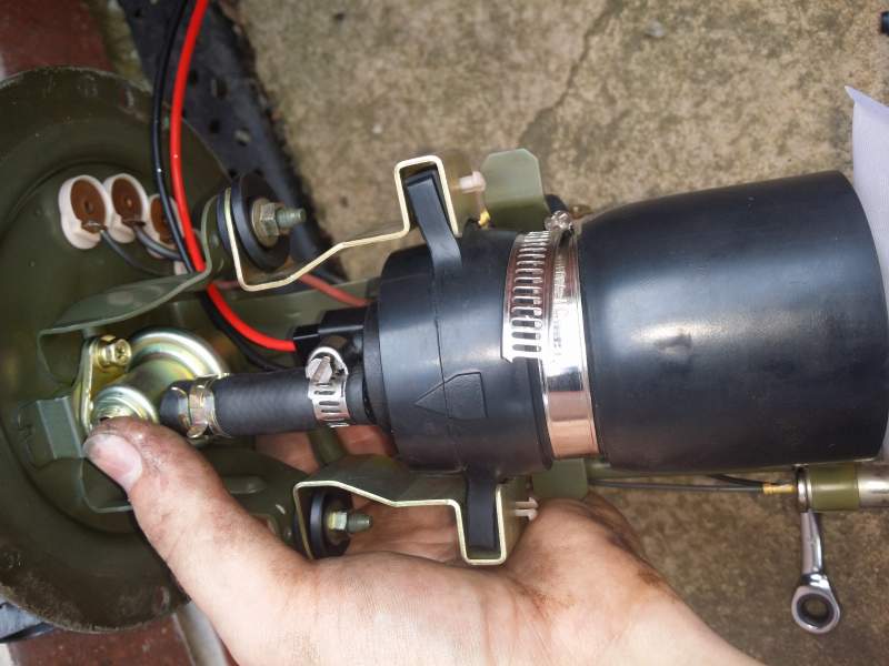

Been fitting my new AEM fuel pump today. Had to use my nogin to make it secure but all in all happy days

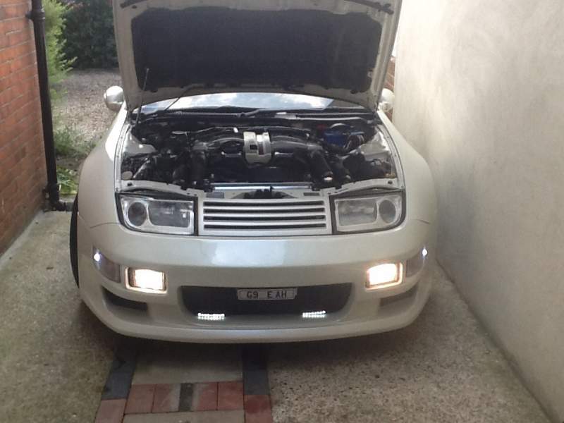

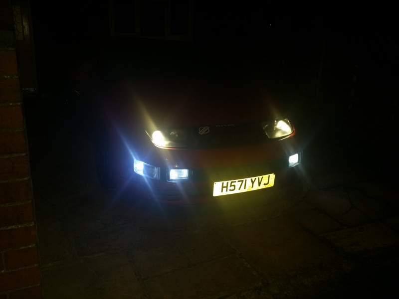

Wired in my sidelights so I have 4 lights now :D
You might attract unwanted attention with that format. It could be assumed you have your fogs on.
Yeah I get that. They were originally in the fog lights though. As it's jap but I didn't really like it

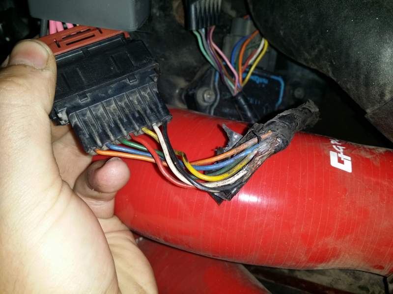

My car has been running quite bad lately. Thought it was fuel related... until I found this :O

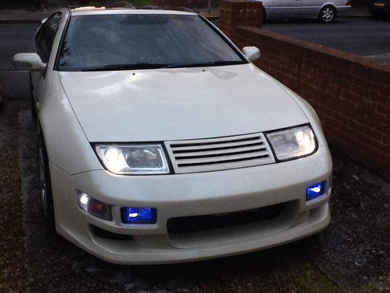

This drew attention! [ATTACH=CONFIG]90024[/ATTACH]
Had to settle with this!
[ATTACH=CONFIG]90025[/ATTACH]
I can see how that could get you a tug art, they don't like it when you display blue light. Did you have a chat with her majesty's Mafia over it? I'd be surprised if you didn't get a friendly chat or a bill, although as it appears atm. If you live at an odd number then they won't persue it anyway. Haha
Hi Si!
The Blues got replaced when taken for first UK mot!
I can see that being a problem mate.
Sorted now. Luckly it was only two wires on the ptu harness. I just re soldered them and insulated them. They had been rubbing on the fan belt and it cut through :(
Is that because the loom is extended by a series 1 to series 2 ptu conversion?
Yeah that's right mate

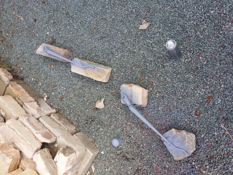

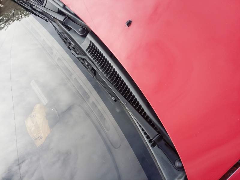

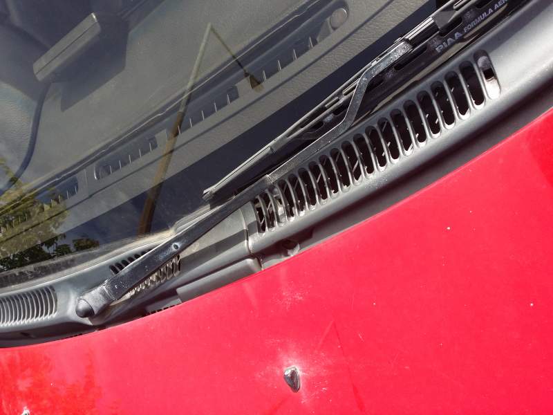

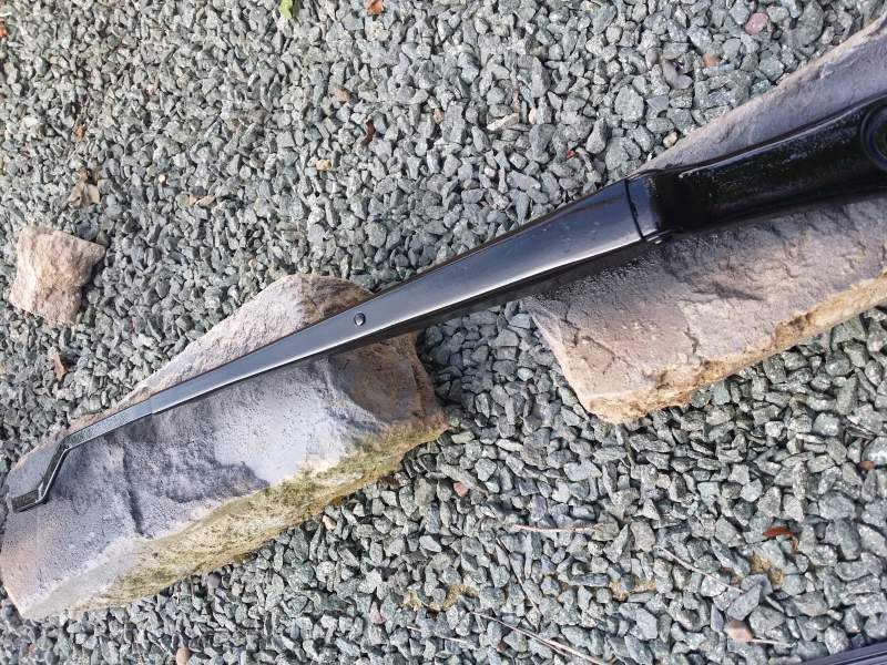

Took off my wipers and targa strips to paint them as the chrome was showing and the wipers were off coloured

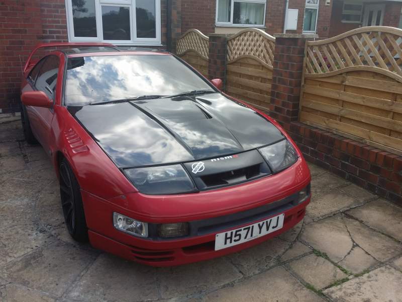

Got my new black vented bonnet on. Ready for jae... machine polishing her tomorrow morning :)
Well after a morning of hard work machine polishing and fine detailing the car is more or less ready for jae :D

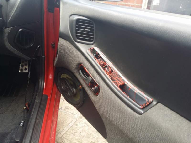

Today I have painted my tired red colour mirrors black. Very happy with the results... also painted some interior parts black then went artistic on them ;)
Nice interesting finish on the trims mate!
