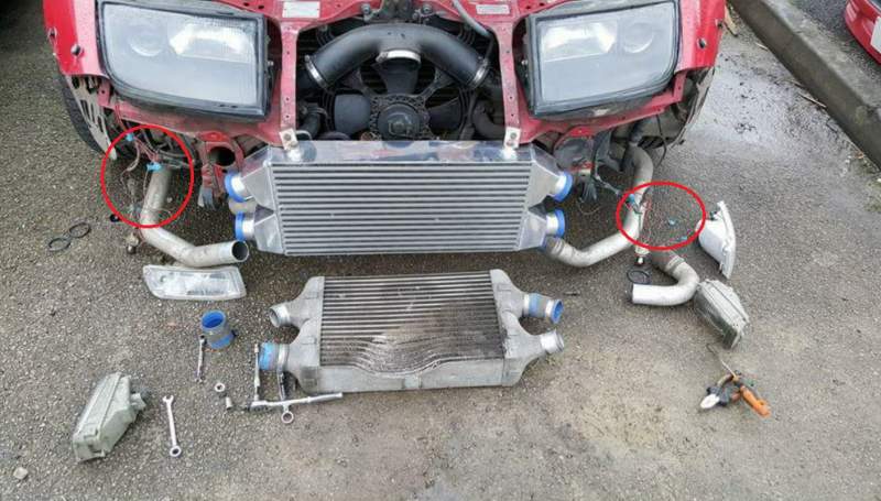

I am not sure what mechanical operation those cable ties are there to perform? :confused:

Something I noticed. Do yourself a favour and remove those Scotchlocks. They're not water resistant and should only be used on internal electrics (not that I'd use them anyway). Cut - solder - heatshrink. :)
[ATTACH=CONFIG]93112[/ATTACH]
Haha yeah... good point. Next thing I do I think ;)

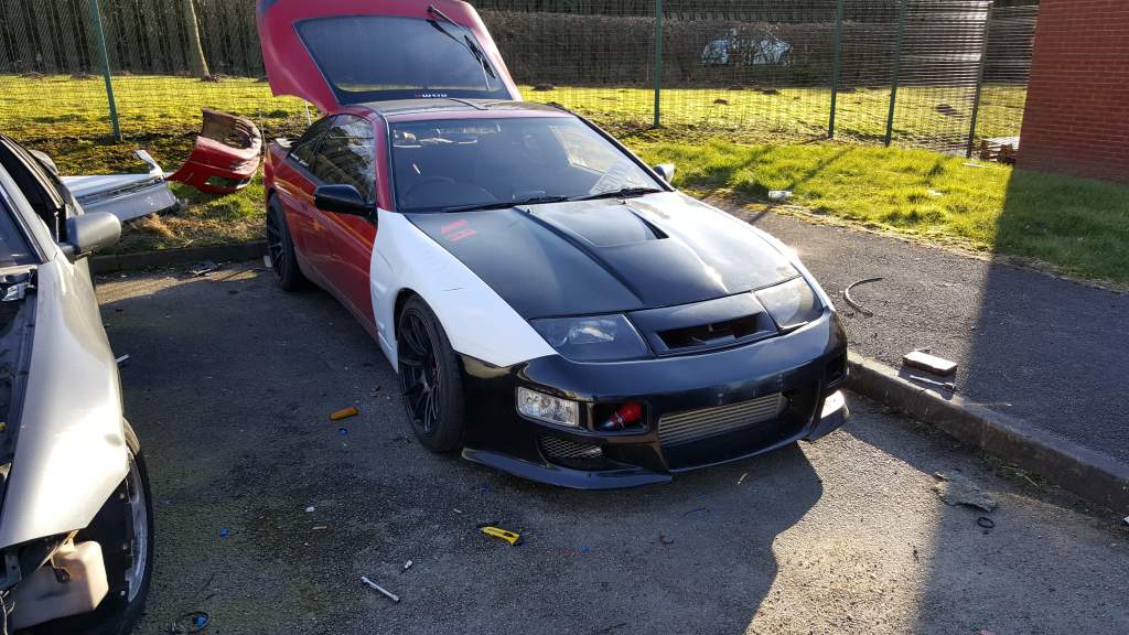

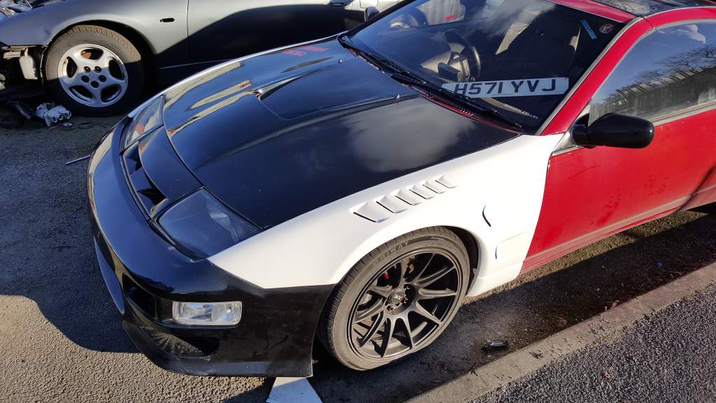

Genuine wings west plastic front bumper
Fibreglass wings from zcentre... thanks luke

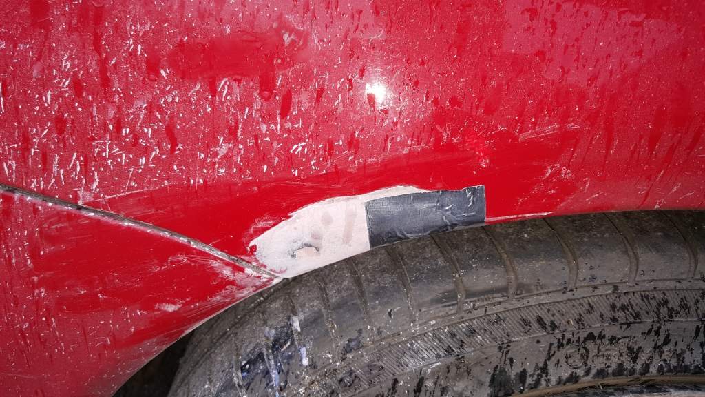

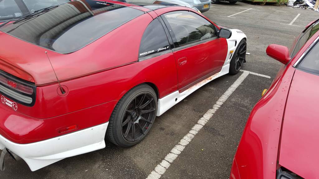

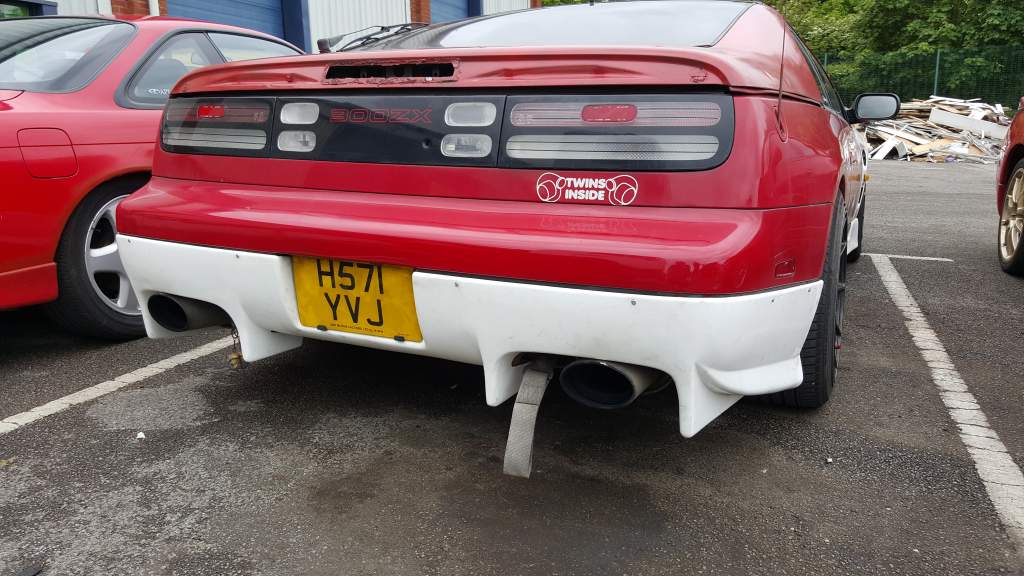

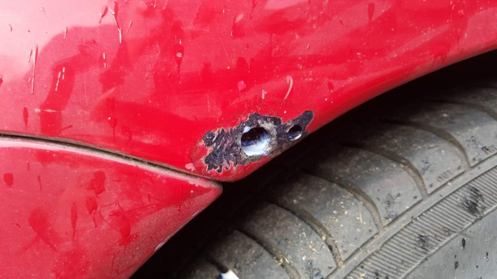

Noticed the paint was bubbling on the rear arch slightly. After inspection it was worse than I thought. Treat all the rust areas and filled the holes. Update coming soon on this...
  • 1 month later...
Had the welding done on the car. Now for the side skirts and rear bumper then a full Respray:D can not wait XD

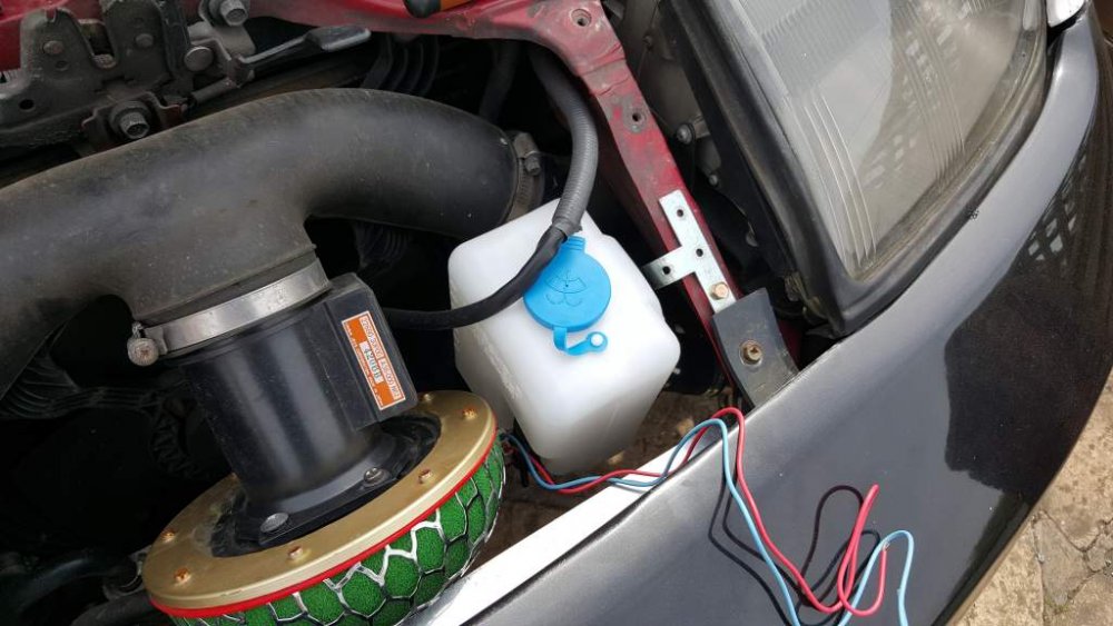

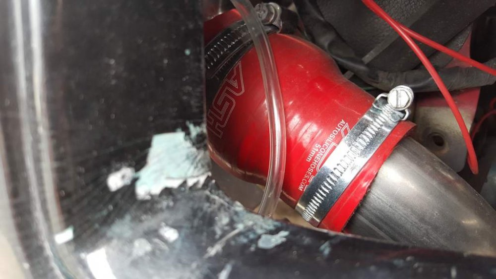

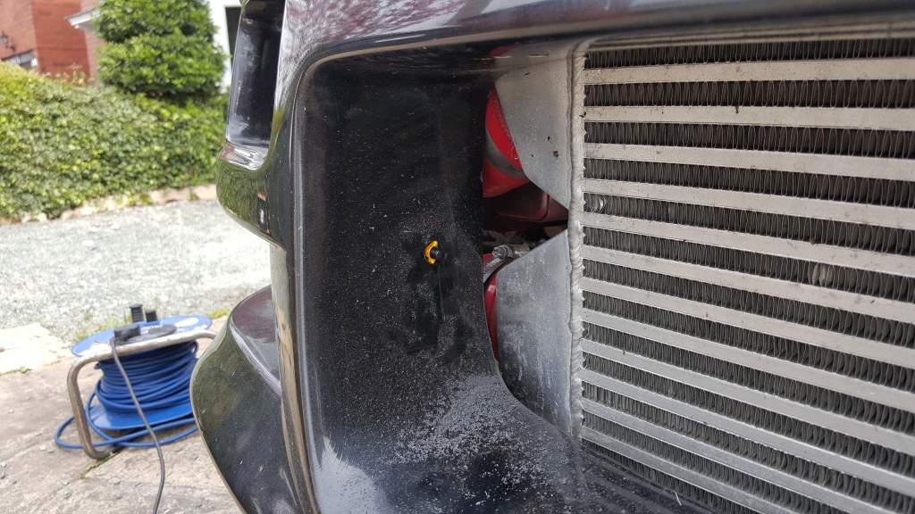

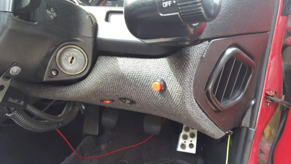

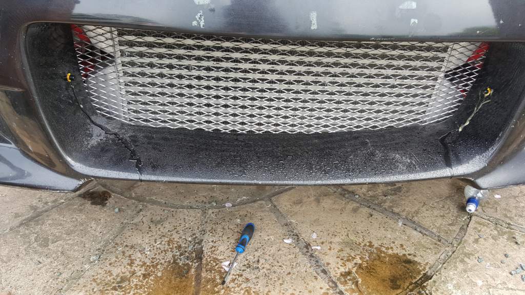

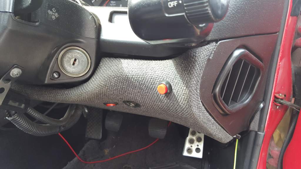

I have made a intercooler spray system today. Simple really and cost 20 quid. Would have been less but I wanted a better pump. Really does lower the intake temp of the car.
What I did:
Locate an area to mount the water bottle
Make a bracket to fit
4mm hoses to go from the bottle to the pump then to the misters
Drill 2 holes in the bumper for the misters
Wire the pump to a button in the interior then from the button to the battery. And there we go :)
Also I have fitted a mesh to the bumper for the intercooler:)

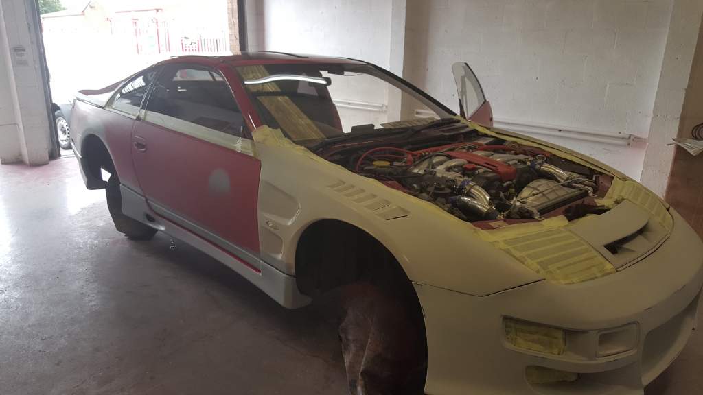

Well that's it now. The zed has been put in another garage for a full Respray. Can't wait for jae this year. The car will finally be complete

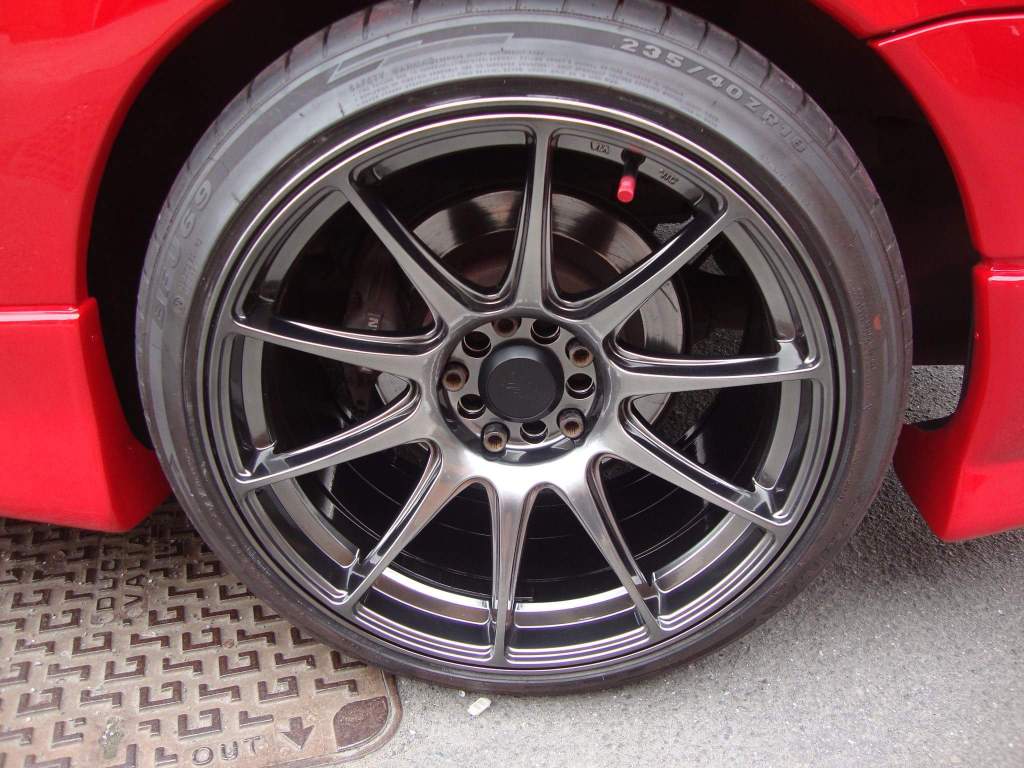

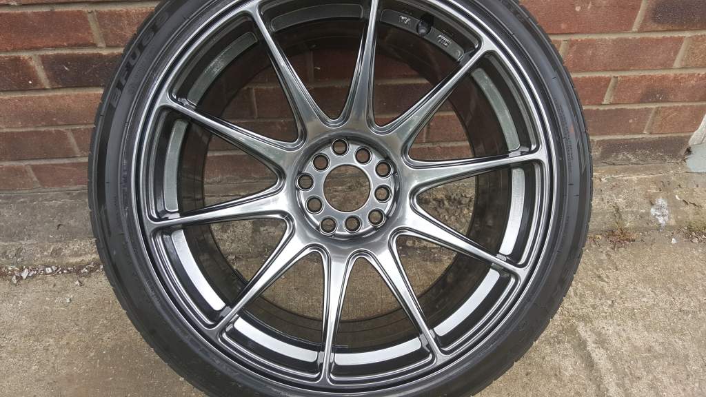

Wheels have been refurbished and powder coated to shadow chrome and the car itself looks like this at the minute :D

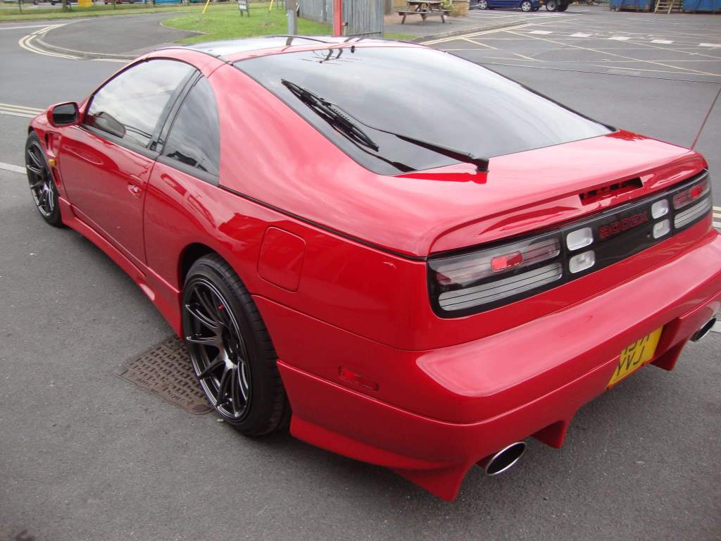

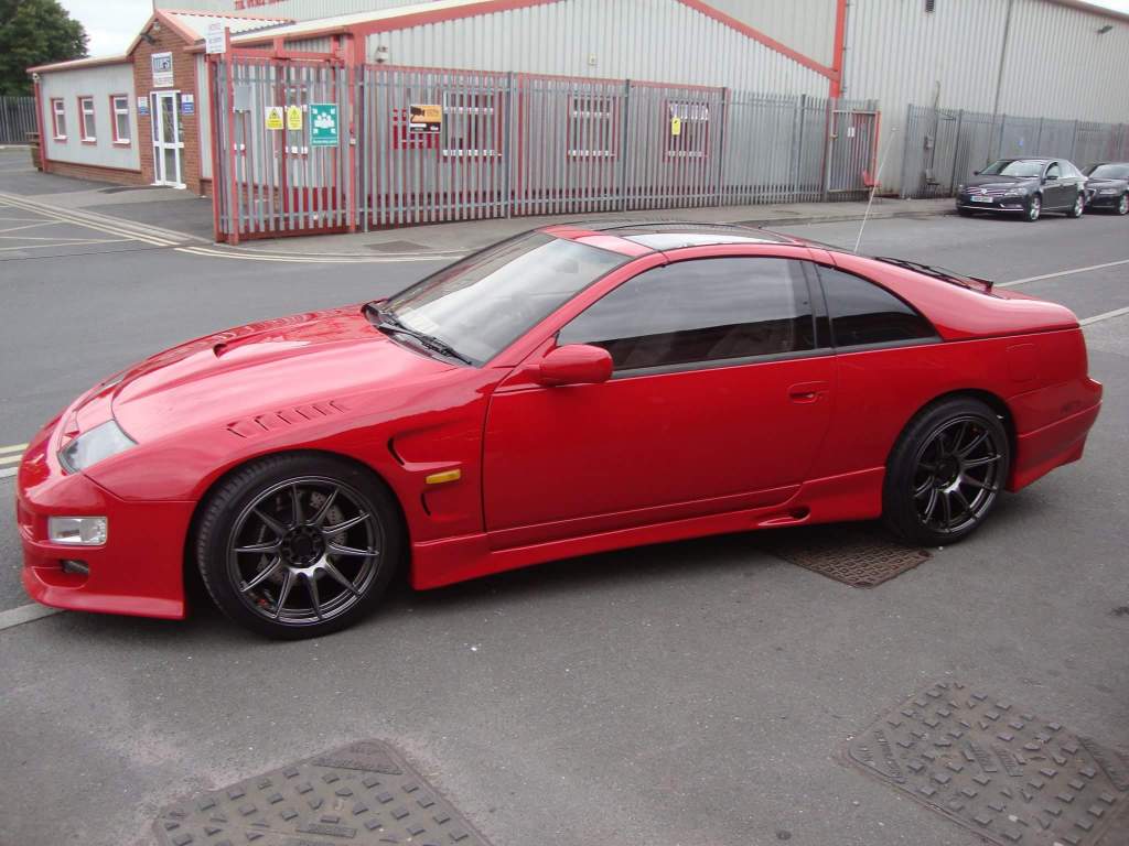

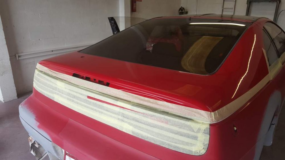

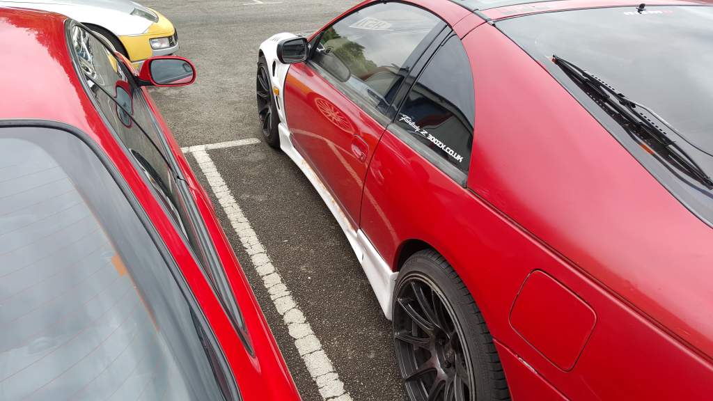

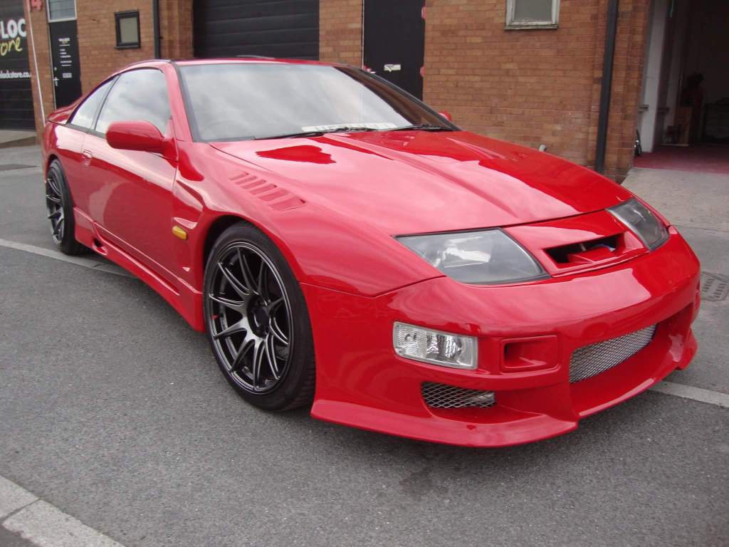

So so so happy with the finished result of my zed. Looks absolutely awesome :D
Looking good I know the car now only just seen this thread these cars are worth all the pain well most of the time lo
Fabulous colour there Joel, looks savage:thumbup:
