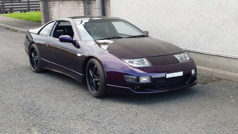

So here she is as I bought her :

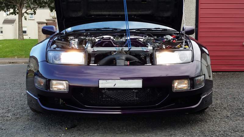

Also wired up the headlights and installed the new HID's.
