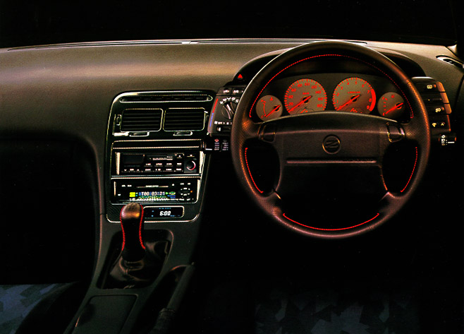

What's so different with the 99 spec interior ?
in some versions it has red stitching on leather items:
(in the non leather '99 spec versions) also the parts that are normally cloth/alcantara on the doorpanels and under the dash, are made of some really nice fabric...it has a carbon-fiber look.
You can a small part of it here:
The non leather '99 specs have recaro seats
The non recaro '99 specs have some really nice leather, also on the doorpanels/under the dash/etc.
some more pictures of '99 spec features can be found here:
