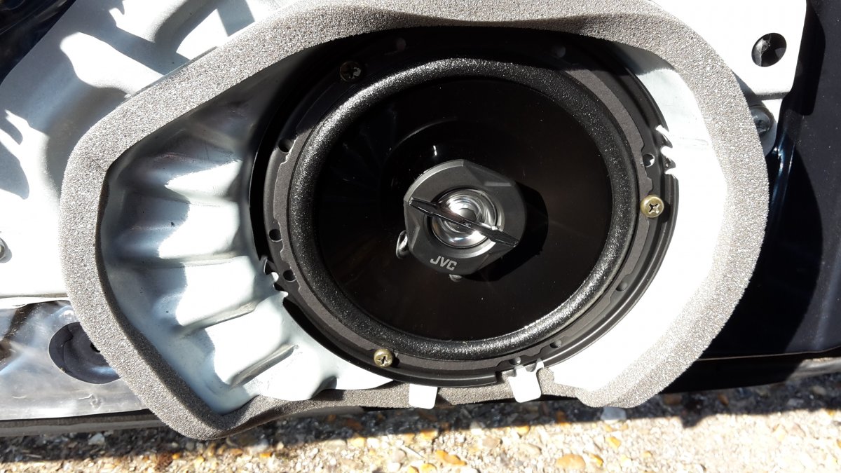

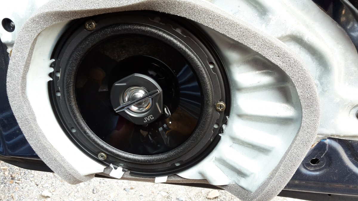

Today I replaced my front speakers. Following Gio's earlier thread, I bought the same JVC 16 inch pair, along with some new foam strip and - finally - set to work....
I also tightened up all the screws and bolts behind the door cards - and reinstalled them with some new screws and plastic trim panel clips. Everything is a nice snug fit once more:classic_smile:
I also fitted a brand new OEM boot catch - I managed to locate one in the USA... It still needs the positioning finely adjusting, so the boot closes smoothly, but that can wait until tomorrow :classic_wink:

Cheers Naz!
The speakers are fine; not bad for £20 on Ebay - and more importantly, they fit the OEM brackets perfectly. It's getting harder to find speakers exactly 16cm in diameter as most are "actually" 16.5!
https://www.ebay.co.uk/itm/JVC-CS-J620X-6-5-16cm-2-Way-600-Watts-Car-Van-Door-Coaxial-Speakers-Pair/171420040661?hash=item27e96e3dd5:g:j2YAAOSwnDZT6-py
My wheels are indeed Japan Racing - JR6 to be precise. I got them with custom drilling/offsets; fronts are 8.5x18, ET28 and rears are 9.5x18, ET40. I should probably have gone ET25 and ET35 respectively, but they are still almost flush with the arches and I didn't need spacers!

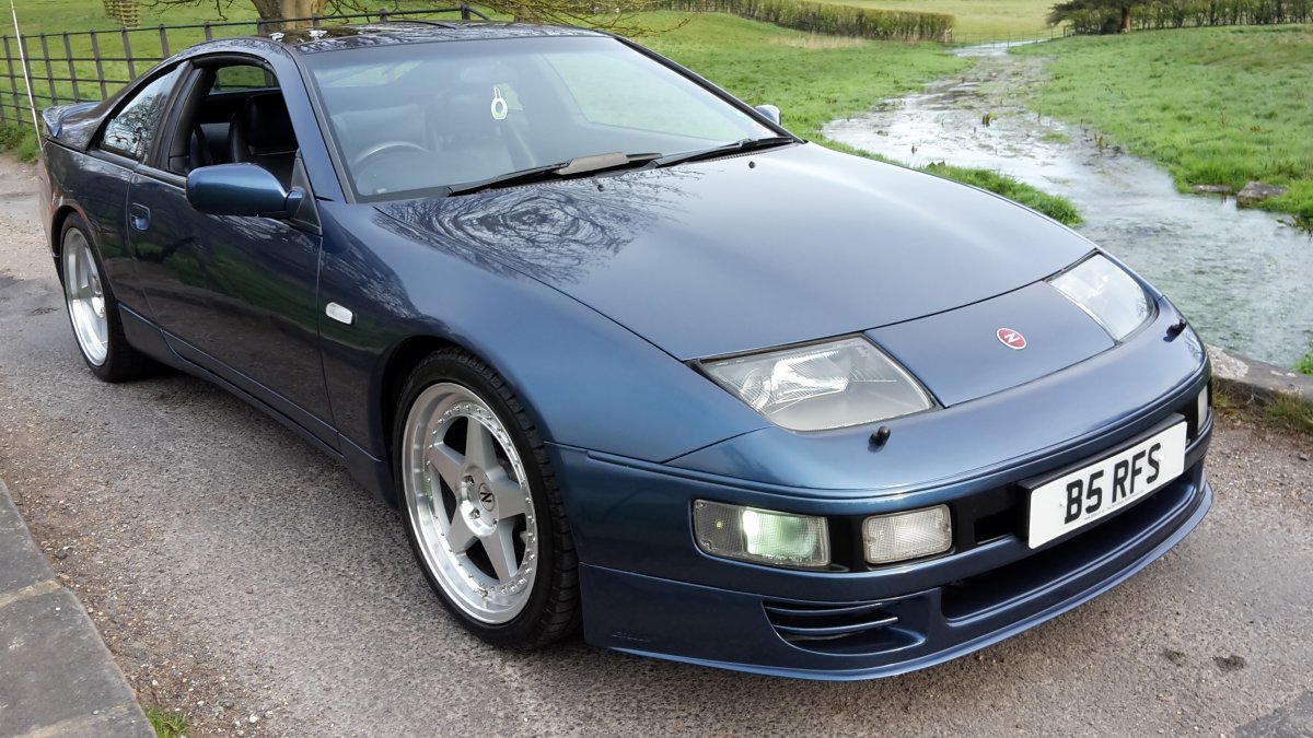

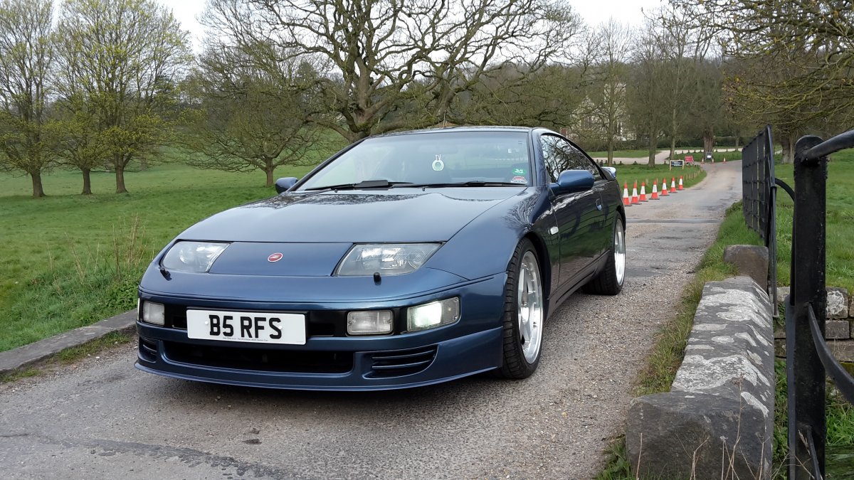

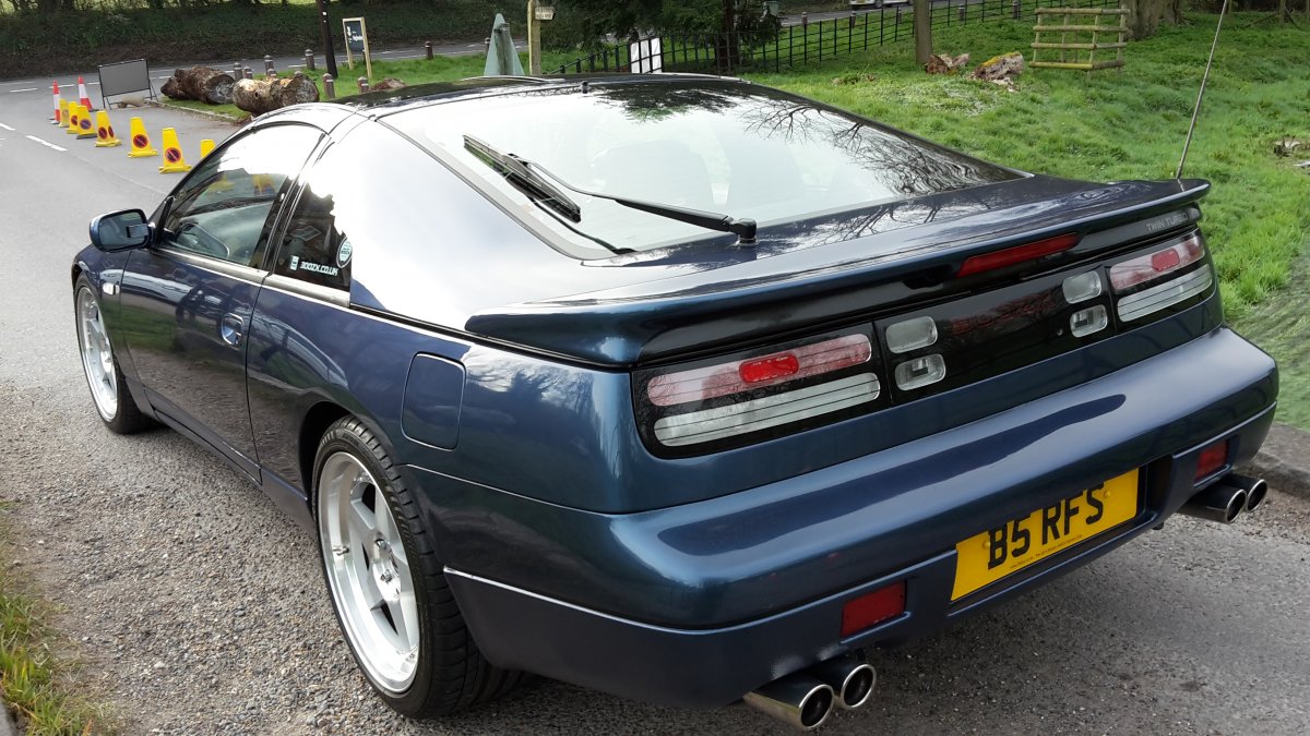

……………...Oh, and when I nipped out to purchase a few essential groceries, I took the Zed along - then stopped for a very quick photo-shoot on the way home:classic_ninja:
I know what that needs, some spats Richard.
Looking superb Richard
