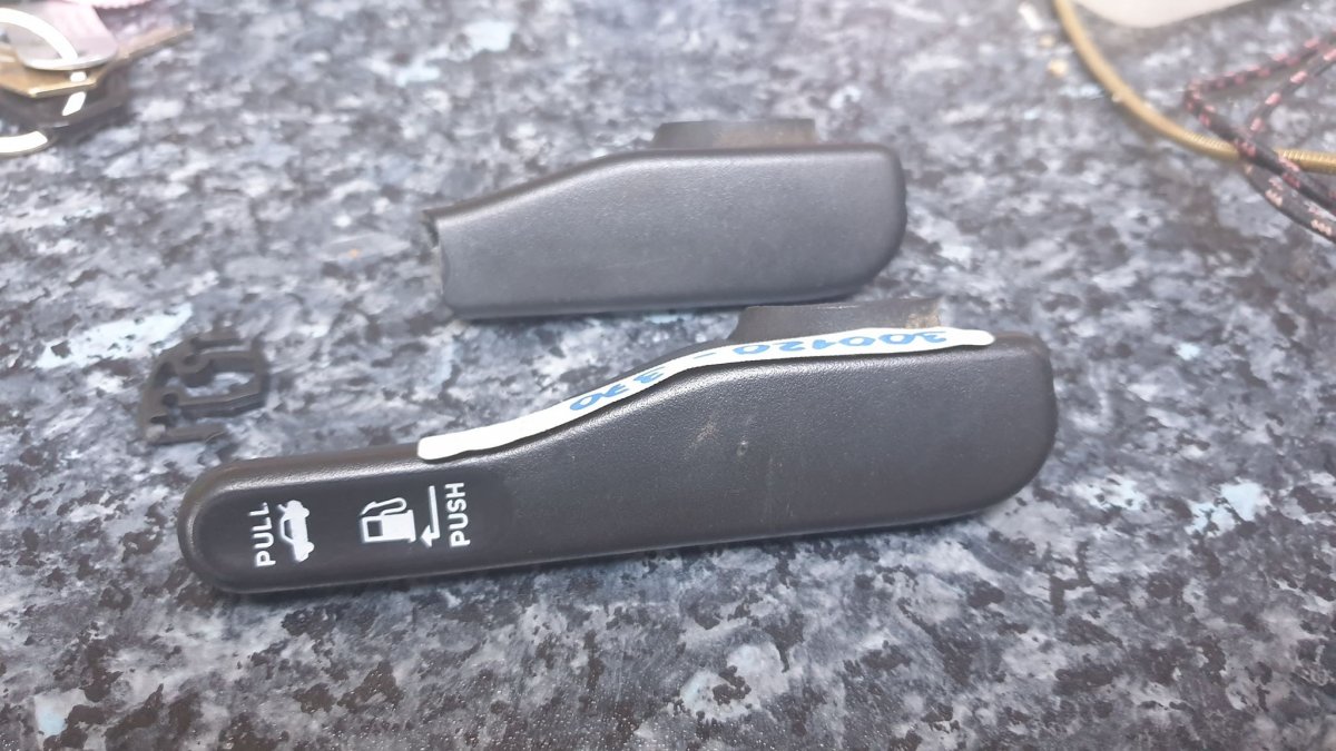

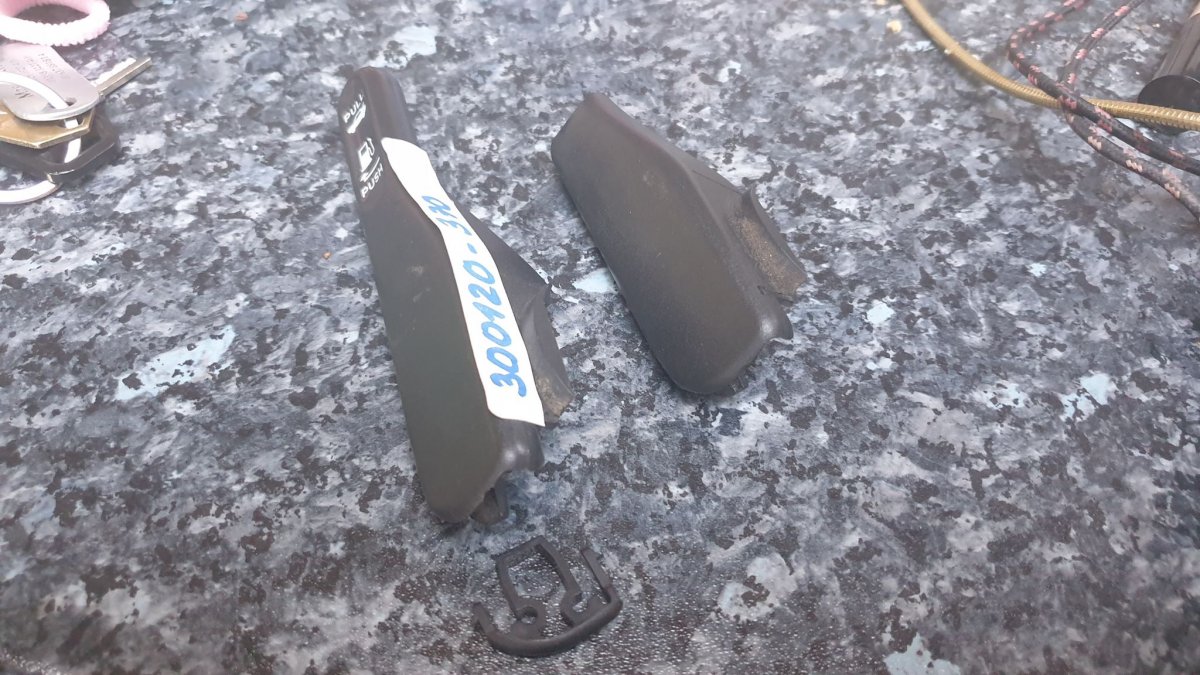

Hi All! I managed to get a boot/fuel lid lever cover from Germany (via eBay) , and I replaced my broken one.

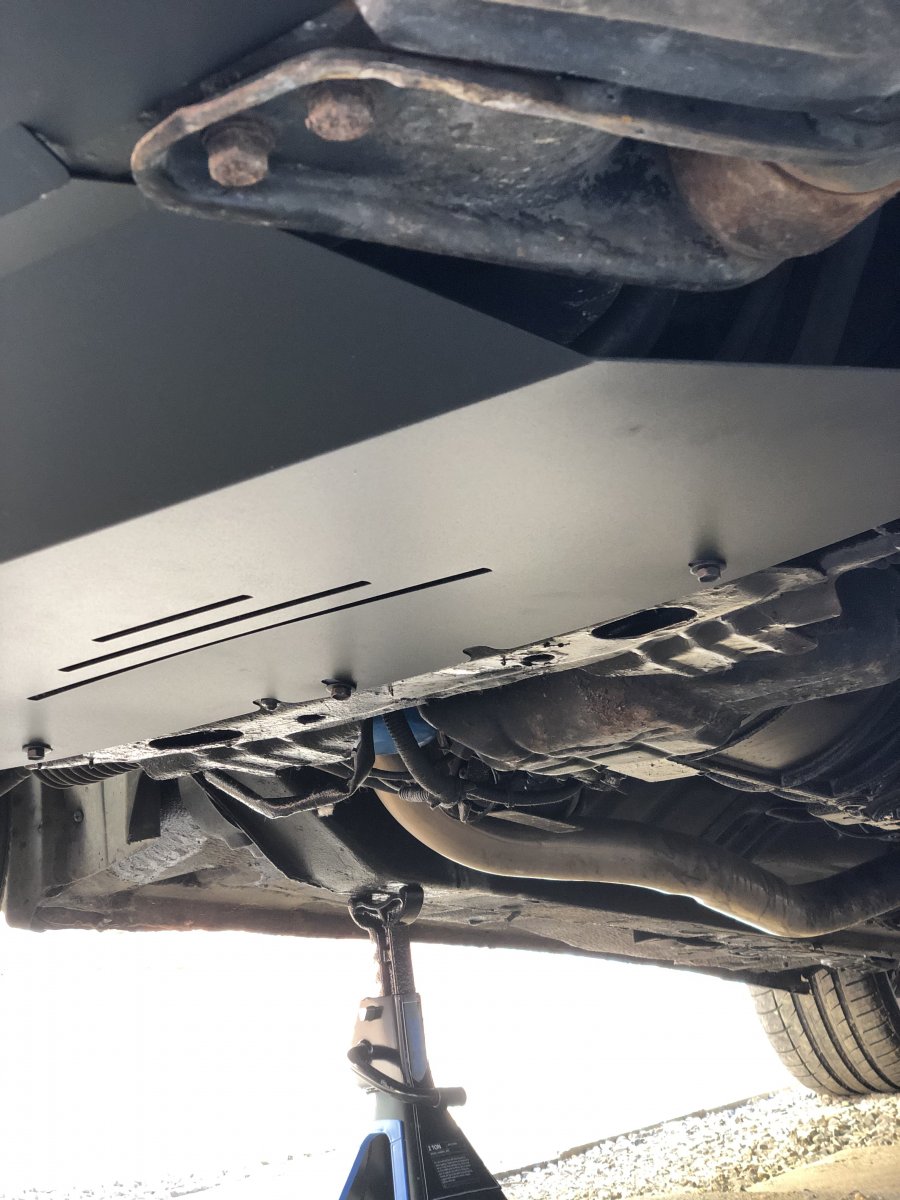

well today I had one job..............nailed it! only thin I changed was the supplied "anti rust" bolts were just standard bolts, so I used stainless fittings instead. it now means I have a brand new oem rear under tray which I will advertise later.

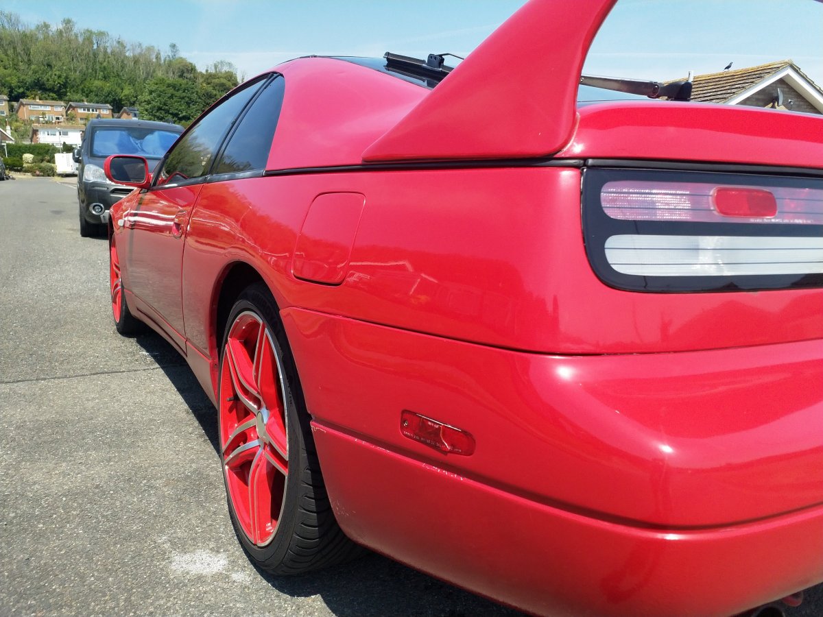

Decided to treat the car to a wash and a polish yesterday. My poor bonnett is going pinker and polish does less each time, might have to bite the bullet and get it painted. I also tried my aerosol skills by painting the windscreen wipers with satin black and clear laquer. All in all took me 5 hours to do everything and I managed to sunburn myself in the process. Pretty well spent day off!

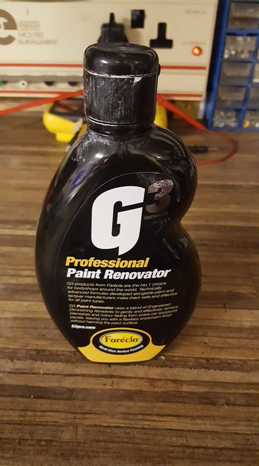

You need to give the bonnet a good t cut or paint renovator like the one I use in the picture mate then a wax after that.

I have the red version of T-cut and although it looks good for about a week, it quickly goes pink again and seems to get worse? Maybe I am doing it wrong! I will have to give G3 a go, I have heard good things about it.

Well polishes are a very light abrasive to take off the naff top layer of paint which has been scratched over time or sun damaged in your case. The wax should be applied following the polish treatment as Gaz300 has said, as this will seal the paint against the suns UV rays damage - two coats would be good.
The best product however from what I’ve heard (not personally used) is ceramic coating which is harder and more durable than wax. That should hopefully protect your red paint. Wax is cheaper, easily sourced and to be honest, it’s done the job for me for about a decade so don’t be worried about ‘only’ forking out for wax.
I’m not too clued up on red paints but that should hopefully do the trick for you.

Thanks Chris. On all my cars I pre wash them with autoglym polar, then wash with conditioning shampoo. I then use the autoglym polish followed by a ceramic polish and it works well. The bonnet is do the same, but occasionally (more often than not) T-Cut it first before doing both polishes. I think it's at the point where it can't be saved. I'll give the G3 a try before I give up and get it sprayed! The ceramic polish is brilliant, I love it and it makes the cars look amazing once it has had the 24-48 hours to dry.
I’ve had mine for 11 years and it’s red. Regular polishing and waxing and it’s never faded. Poor Boys Nattys Wax, it’s a red one, makes a fantastic top coat after polishing with the Diamond white.
I had a friend with a paint thickness tool measure the car and the rest of the car is 80-90 microns, however the bonnet was 250-290. He thinks that its been respray (maybe several times) and thats why its fading. Ill give the G3 a go, I dont think there will be any cars shows this year, so hopefully can get it sprayed before Simply Japanese 2021 ?
I had a friend with a paint thickness tool measure the car and the rest of the car is 80-90 microns, however the bonnet was 250-290. He thinks that its been respray (maybe several times) and thats why its fading. Ill give the G3 a go, I dont think there will be any cars shows this year, so hopefully can get it sprayed before Simply Japanese 2021 [emoji16]
I was going to say has the bonnet been resprayed as it sounds like your detailing process is bang on. The rest of your bodywork looks great so it only really points to that.
If the paint on the bonnet is that thick, it could be saved with a professional wet sanding etc and deep repolishing but to be honest, I’d only go that route if you can do it yourself. If you pay someone else to do it, you might as well respray the bonnet. I get charged approx £150 per panel for small respray jobs so probably better going the respray route.

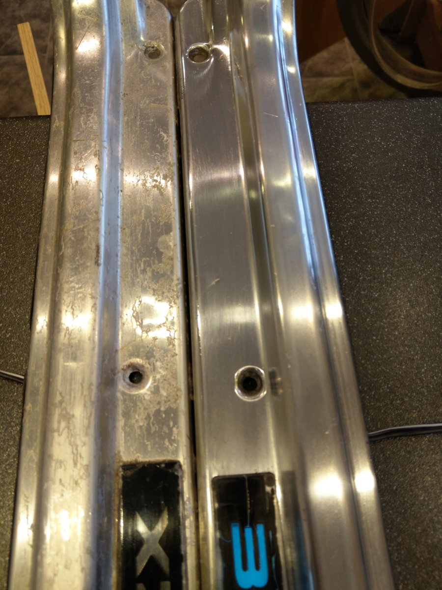

Had these indiglow sills for a little bit and decided to finally start tidying them up
