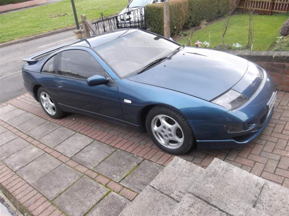

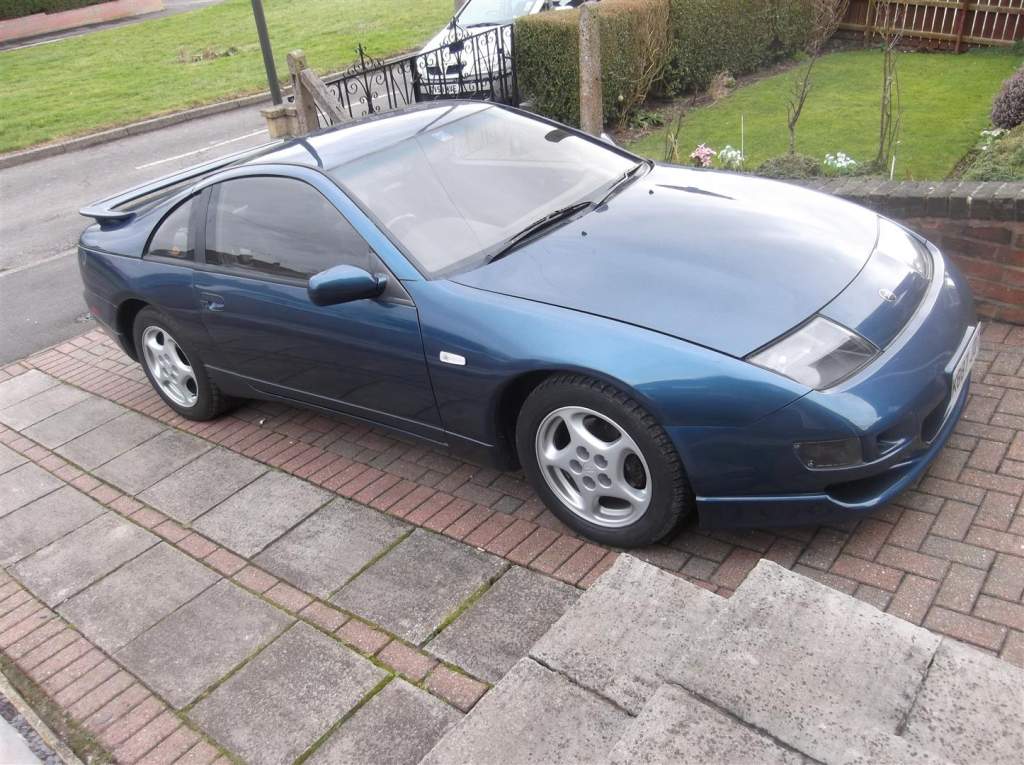

I went for a little test run in my newly taxed spare slicktop.
First drive since i got it six years ago!!!
Overall Im pleased with it.
There is just a tiny misfire under load. So I will be looking at all the usual connectors for a bit of green corrosion.

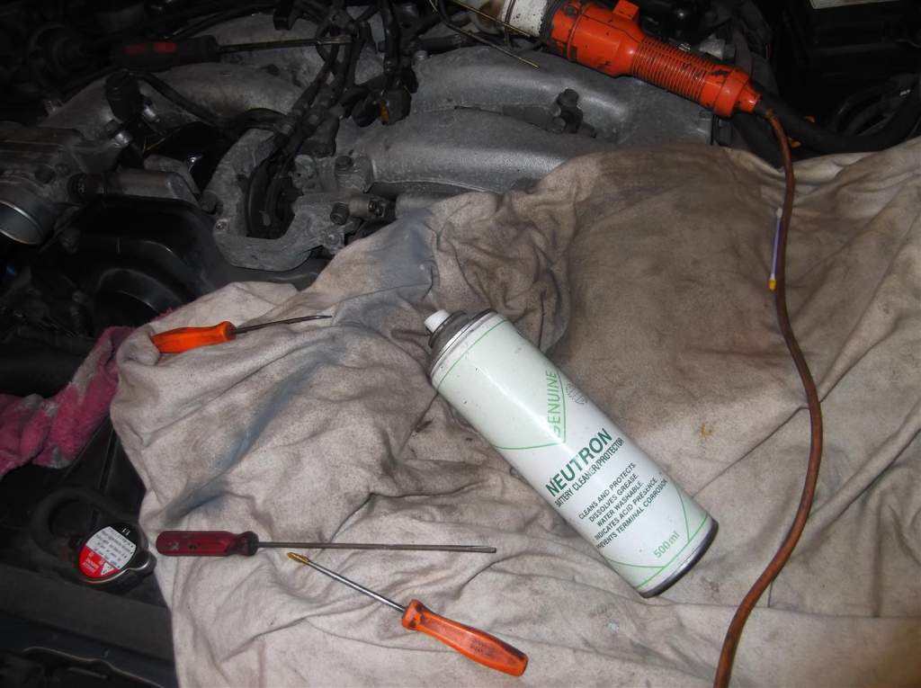

Today i moved my new trackday project car to one side of the garage and make a start on curing the little misfire on the blue slicktop.
It will just be a case of working thu the key connectors to find some/one that is corroded.
CAS plug. looked OK. Cleaned and replaced.
PTU. removed the easier of the plugs. Looked fine. Cleaned. Replaced.
So far I have done three cylinders.
Coil pack connectors were really clean. Injector connectors all showed signs of the dreaded green corrosion.
These three have been cleaned with Terminal cleaner.
Three more to do......
I have also ordered a set of new NGK plugs. I know the ones in the engine have done very few miles but in the PO advert he mentioned "Denso plugs". Now they may be OK and they may be the correct heat range I dont know yet. They are coming out whatever when the NGKs arrive.
