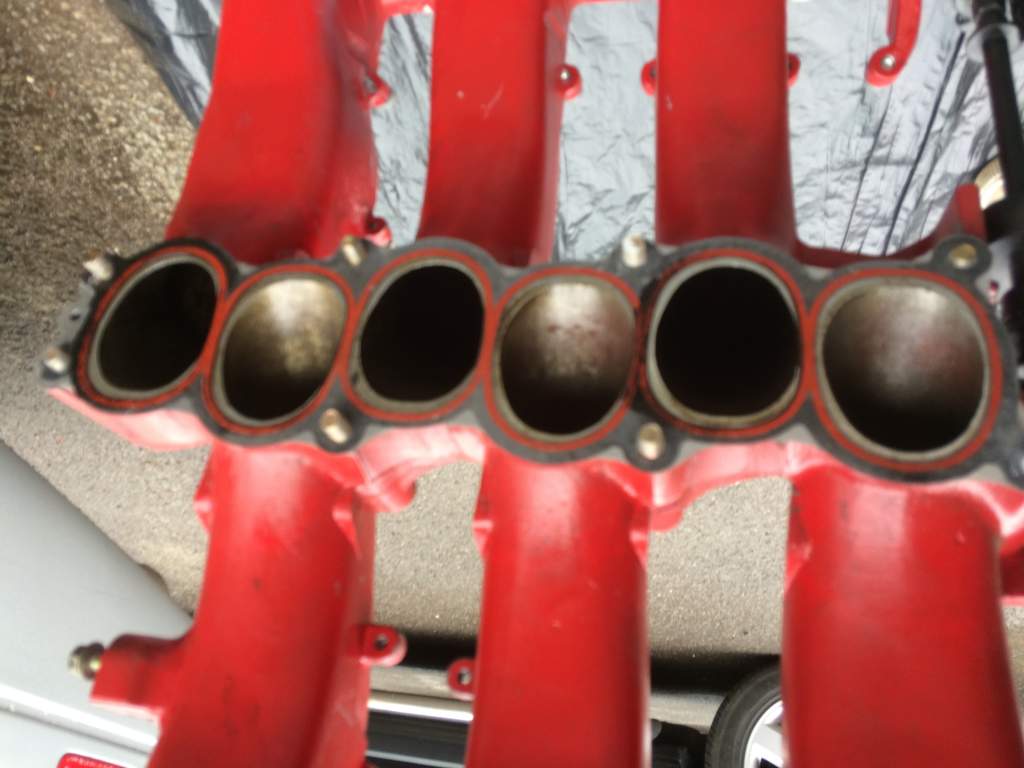

  3. They're looking good. It's a great mod in my opinion.:thumbup1: I'm tempted to make a set of these myself. Although they'd be an improvement over my current coaxial speakers, i don't know if i'd hear the difference over my exhaust...

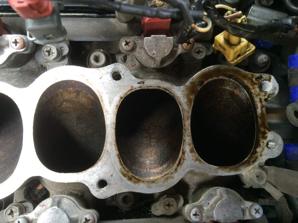

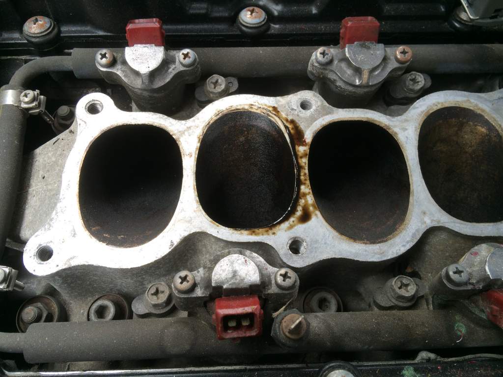

  10. Thanks guys. Some of the cylinders had a thin coating, whereas others seemed to be coated in quite a bit of oil. There was a fair bit of oil in the plenum, so I’m going to give that a clean before putting that back on the car. Anyone have any suggestion/experience cleaning inside one? I’ve looked on Z centre and seen that they do a PCV silicone hose kit with PCV valves. Going to contact them tomorrow and see if this will fit my NA engine. I want to do the hoses anyway as they’re rock hard and seen much better days. Have a new plenum gasket to install and I’m also going to replace the IACV gasket and probably the balance tube O-rings. Looking at silicone hoses for the IACV and brake vacuum hoses (in addition to the PCV hoses) as the rubber doesn’t look in great shape Also going to look at ohm testing the injectors as per Stephen’s suggestion…
  11. Evening all, After having my zed back on the road for about two days, it’s now back off the road. Although this time it’s for planned maintenance. When I purchased the car I was made aware of a small oil leak from one of the valve cover gaskets. I started the process of removing the plenum yesterday, but was held up by crappy weather and an injector connector. Today I managed to get the plenum completely off and replace all four valve cover gaskets and half-moon (or half-circle) seals.:biggrin: Anyway, the reason for this thread is because I noticed one or two things I was unsure of when I had the plenum off. Firstly, the plenum seemed to have quite a bit of oil in it, with some cylinders having more than others. I’ve tried to take some pictures below, although I think the lighting doesn’t show it very well.:blink: Does anyone know where this would be coming from, and is this something I should be concerned about? Next, I noticed that the spark plugs had seen better days. Is there any particular make/model that people recommend? I’ve only brought OEM for previous cars so don’t really know what ones to go for… Thanks

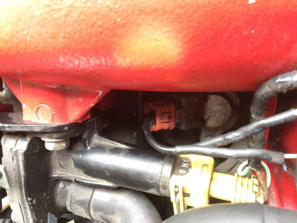

  12. Thanks Jeff, I'll give that a try tomorrow :thumbup1:
  13. Thanks for the replies. I was trying a thin screwdriver at the corners but it didn't seem to work. Certainly not like the rest of them... Going to have another go at it tomorrow.
  14. All the other connectors had a metal U shaped clip around them. This one has is different to the others and I can't actually see how you compress the clip. I've had to down tools for today as it has started to rain. Hopefully I'll be able to finish up tomorrow!
  15. I'm half way through removing my plenum and I'm being held up by this injector connector. Anyone know where I grip/press/pull in order to get this off. It appears to be a different style to the rest of my connectors.

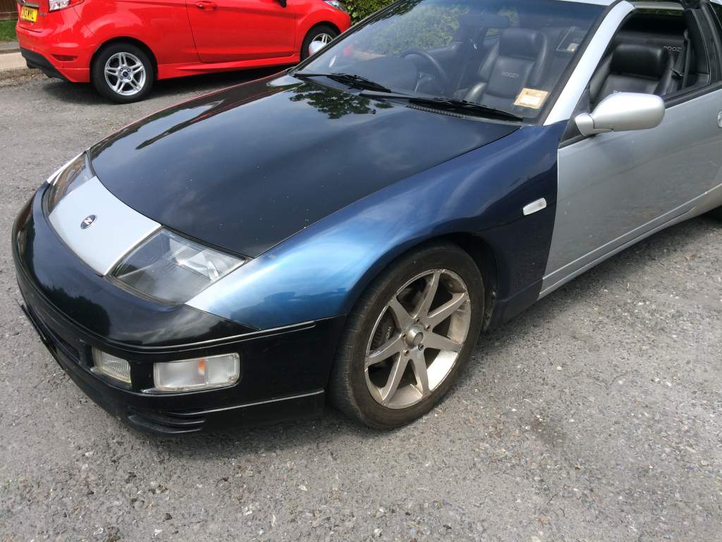

  17. Just over a month after I had the accident and my zed is finally back on the road. As it’s my daily driver and I’ve been pretty much without a car, it’s been a very long month… I was hoping I could bolt on a new wing, bonnet etc. myself, however it quickly became clear that the work required was beyond me. I left the car in Jimmer’s capable hands and yesterday evening I received a text informing me that all the work had been completed and I could collect the car today.:biggrin: I had hoped to get my hands on a silver bonnet, bumper and wing after coming across a breaker in Wolverhampton. 90 miles later I soon discovered that the car wasn’t in the condition I was led to believe… Subsequently, I ended up with black and blue panels and now need to decide how I’m going to spray/wrap the car to get it all the same colour. Looking at the panel gaps and alignment, I think Jimmer has done a fantastic job and I’m really pleased with the finished result. As someone who’s quite new to the zed world, I now have a much better understanding of why everyone speaks so highly of Jimmer and his work.:thumbup1: At some point in the future I’ll look to sort out the tired looking alloys, but for now I’m just glad my zed has been saved from the scrapheap!

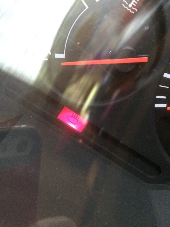

  22. Light wasn't on, i put a torch behind it to find out what the warning light should be. Just wondering what i should do about it, if anything...
  23. As mentioned in a post yesterday, I took apart my dash and dials yesterday with the intention of doing a few odd jobs. I had a look at the instrument cluster and noticed that a bulb was missing. So I put my torch behind it and found this… Now, I’m guessing it’s the catalytic converter. Which leads to a few questions… Did an ’89 Zed come with a cat? Should I be worried that a warning light has been removed? Oh and also, am I right? Is it the cat?

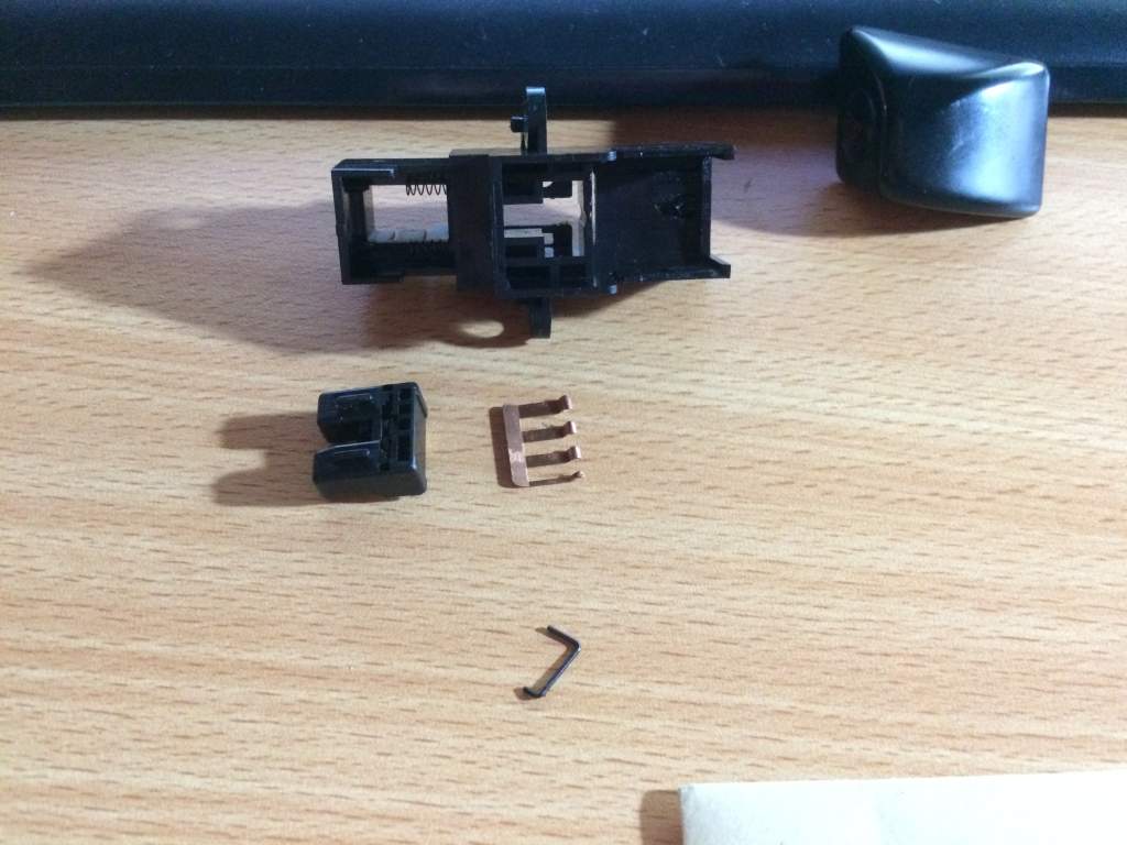

  24. Evening all, Thought I’d take some time to do some odd jobs on my Zed while it is parked up. One of the things that was bothering me was the hazards light switch, which didn’t light up. When taking it apart, a small L shaped bar jumped out of the switch, as shown in the photo below. Does anyone know how this thing goes back together? Specifically, where this small bar/spring goes. I’d prefer to reassemble it over admitting defeat and buying a new one. Thanks
