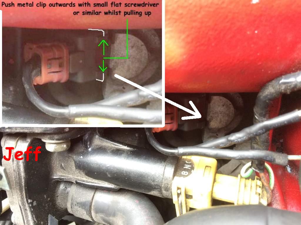

I'm half way through removing my plenum and I'm being held up by this injector connector.
Anyone know where I grip/press/pull in order to get this off. It appears to be a different style to the rest of my connectors.
That just looks like a normal plug to me, has a spring clip around the connector, Did you have them on the others?
All the other connectors had a metal U shaped clip around them. This one has is different to the others and I can't actually see how you compress the clip. I've had to down tools for today as it has started to rain. Hopefully I'll be able to finish up tomorrow!
You will have to get a long thin flat head screwdriver and at the corners slide the metal clip off.

I was trying a thin screwdriver at the corners but it didn't seem to work. Certainly not like the rest of them...

Try this:

Thanks Jeff, I'll give that a try tomorrow :thumbup1:
