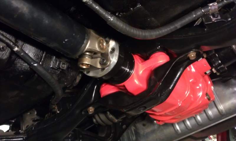

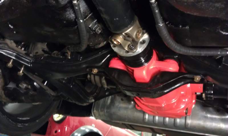

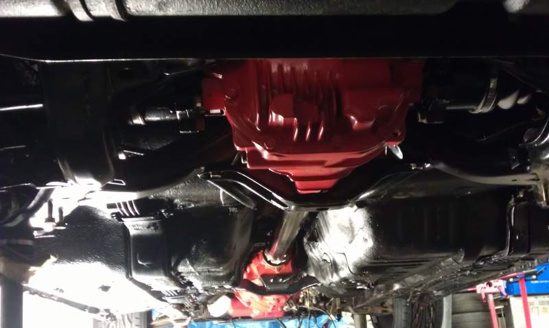

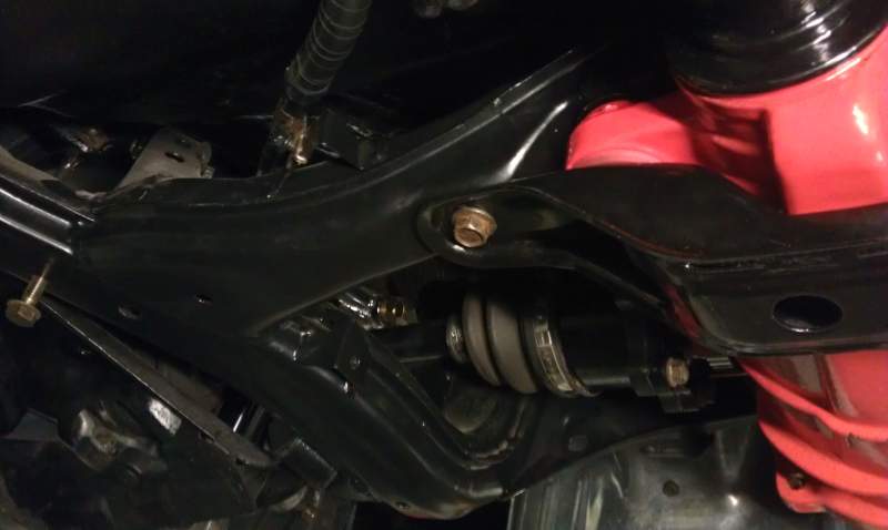

  5. At last me and a few pals got the diff in place :tongue_smilie: Was working untill 3am but it was worth it. We also got the 1 piece prop shaft, Drive shafts and a few loom problems solved. So glad its over and done with moving on to the next task now... A few pics
