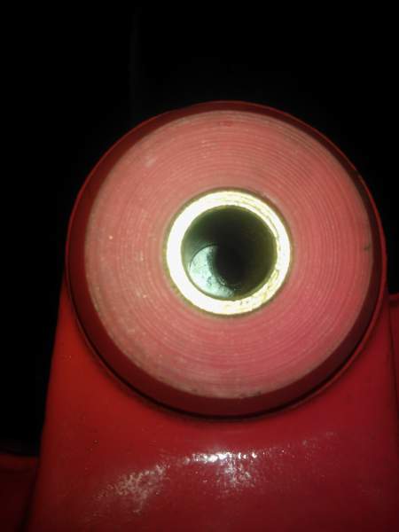

What is the correct way in fitting the diff? I've been locating the rear threads in to the 2 cups first then trying to bolt the 4 bolts and bracket to the front of the diff. But when I try to align the bolt holes up they are about 5mm out.
What am I doing wrong? Pic below

Can you get a decent prybar in and lever the diff around:closedeyes: a bit to line the holes up?
Think I'm going to have to try. I'm abit worried as my subframe has been freshly powder coated
it may just be a case of making sure the diff is level. if it isnt then you would be trying to put bolts through at an angle.
maybe a silly question but have you tried turning the cups slowly to match against each hole? maybe they are offset and will only go back together one way.

but any chance of some pictures from further away, so as to get an overall view of the diff and surrounding sub frame from varying angles?
I am wondering if the powder coating my have distorted the sub frame itself.

Are they just not lining up or are they different widths apart? Have you taken centre to centre measurements of each to check?
