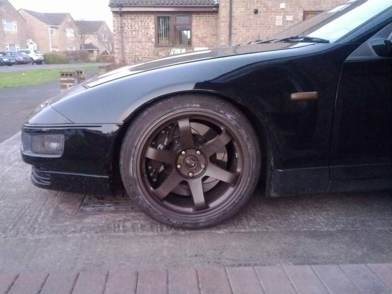

I'm running 9.5" Grids up front on a +20 offset on a 255/35/18.
Lowered 50-60mm, no tracking issues.

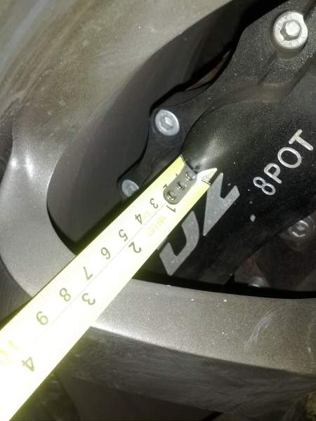

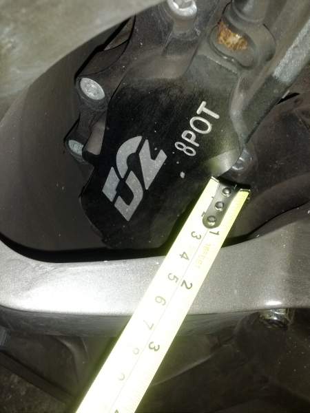

I have D2 356's behind them and you could fit your fist in the gap between the spoke an the caliper.
Pictures can be provided tomorrow if needed.

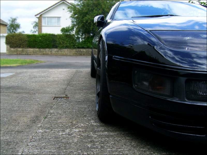

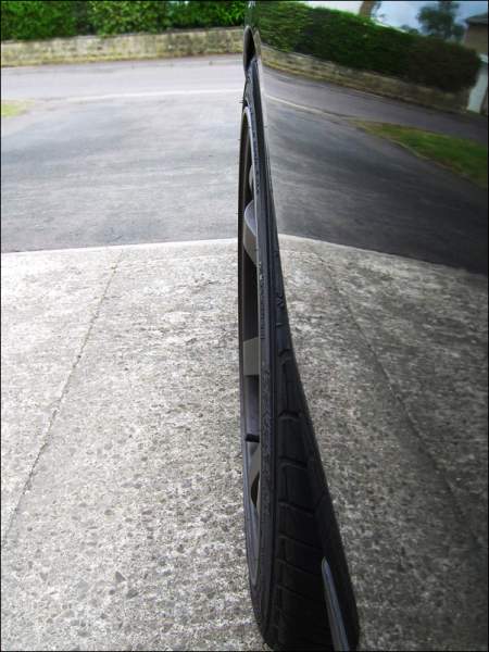

265's on the back
The arch lip needed flattening on the inside to make this work without eating the sidewall on bumps.
Thanks for the pics thats what im on about!!!! those pics look of the chain ...think im gonna order mine tomorrow.
