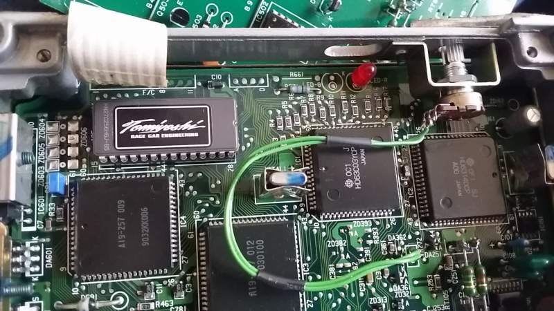

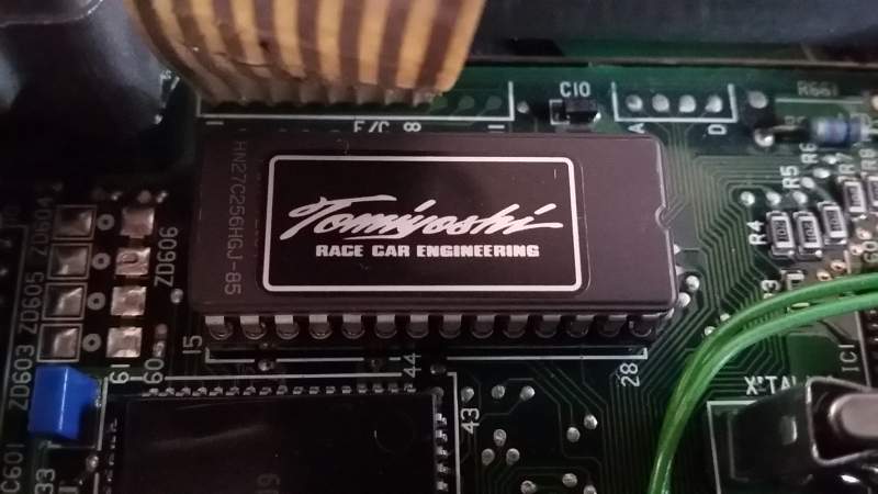

  16. Update... The chip does have a name on it... pictures: Anybody know if it's any good?
  17. I know Noz is real good with this kinda stuff but I have a ecu chip which is soldered into the ecu with two wires... However it doesn't have a name on it and I feel this could be a cheap chip. also feeling that this could be the culprit of my bad idle (earlier called a misfire). Is it safe to test this by cutting these two wires to cut out the chip? Thankyou
