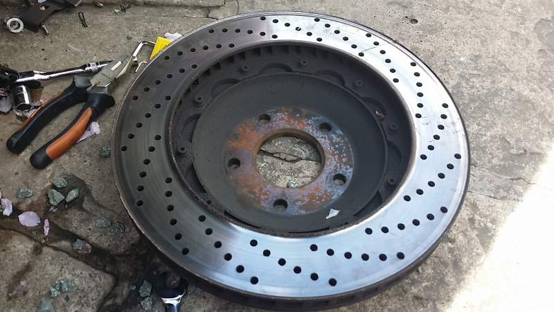

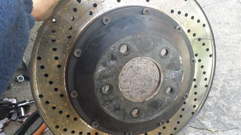

Alright guys. Changing my disks and the ones I had for replacement which are 350z disks don't fit. Just wondering if anyone has a idea what they are

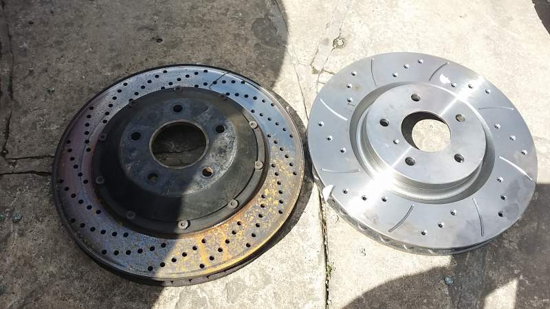

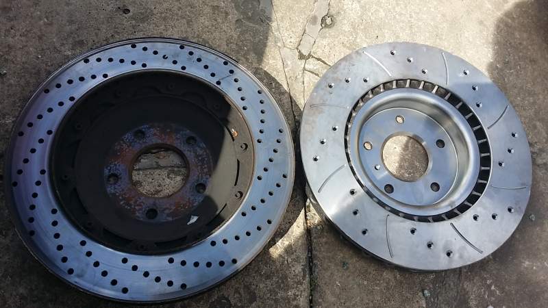

the pictures where there are 2 is mine v the 350z ones
the point to point on mine are 330mm
Thankyou
Some 350zs didn't cone with the larger brembo brakes.
maybe those discs are from the base model.

If the old ones are 330mm then they aren't 350z discs.
The 324mm discs are the largest fitted to them, the import edition brakes are a lot smaller and don't use Brembo calipers either.
