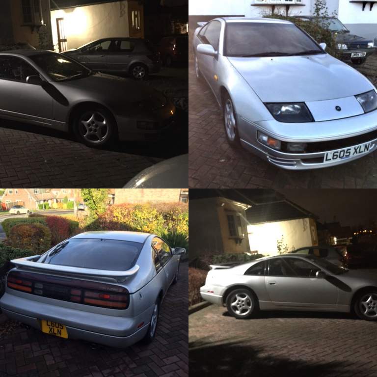

  21. Okay plot thickens today. Garage he has always had look after it called me back today. The guy drives about 500 miles a year and 2 or 3 years ago he had a problem with the (temp solenoid thing) sticking open (or closed... sorry my memory is failing me) and caused it to "get warm". He then had that fixed and continued to drive it for the last few years pottering to his mums etc with the smoke getting worse each year until it now doesn't pass MOT. So the smoke is described as mostly white, with a bit of blue maybe. The guy at the garage said to do a cylinder test which will check what is damaged on the block... rings, valves, gasket etc. Apparently 90% accurate. I am going to hope my mechanic can do that test for me to try and diagnose, but it might end up being a money pit so possible a replacement engine would be better.
