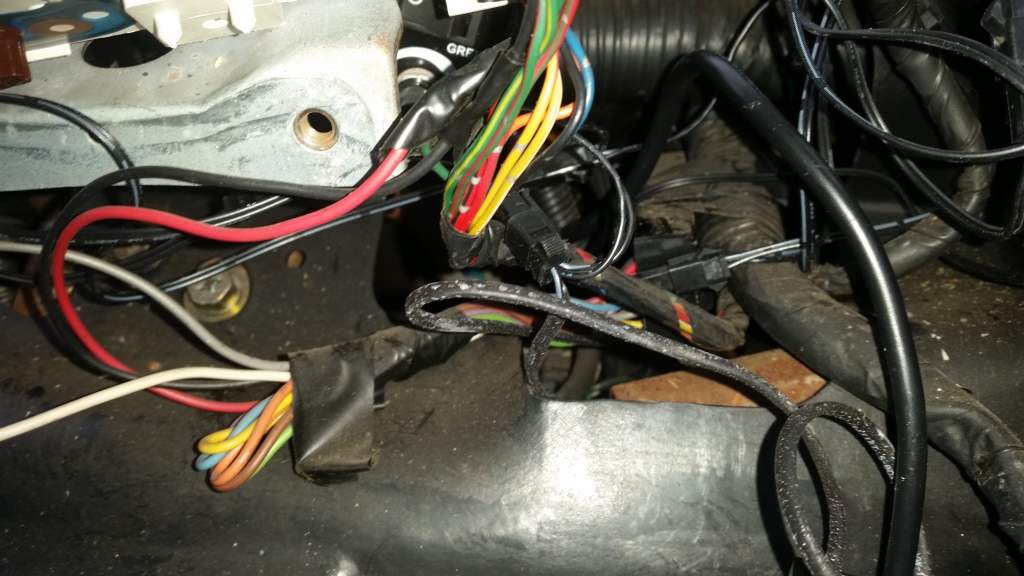

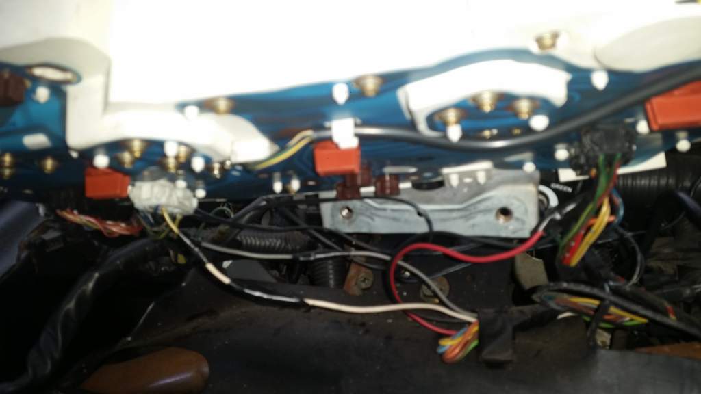

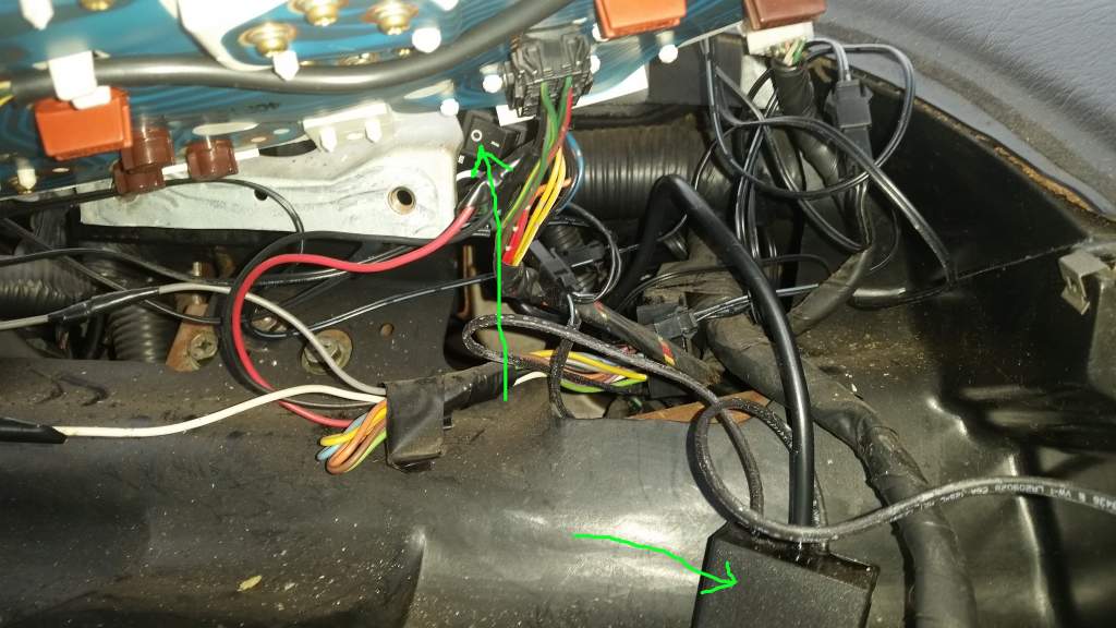

  4. Guys I got the dash clocks out but I can't see anything behind there that would look like a kph/mph converter. To be honest I feel this is getting beyond my ability to fix - I am very good with electronics but not with cars :no: I now hav about a zilion screws and I hope I can rememebr how it all goes back together!!! Here are some pics of what I can see from behind the clocks. This things with the green arrows are the power and switch (green/blue) for my electroflourescent dials To add to my woes I moved the drivers seat back so I could easier work on the dash and now the bloody thing wont move forward again (electric) I had this problem a few years ago as I recall but can't recall how I fixed it. I really love this Zed but sometimes it is a difficult relationship grrr

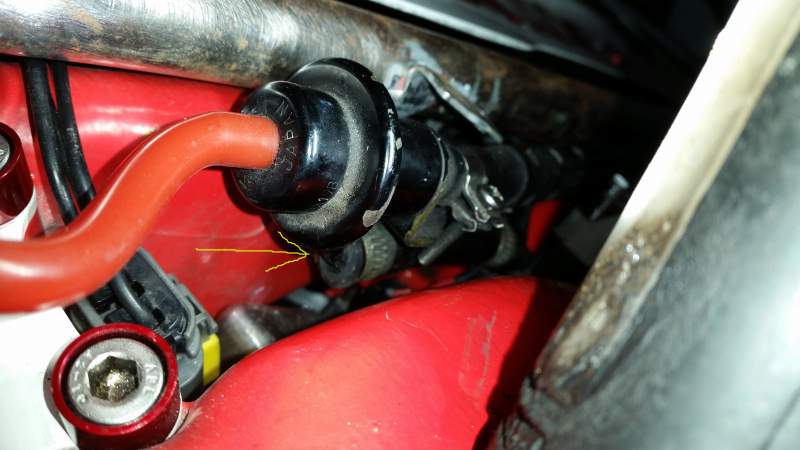

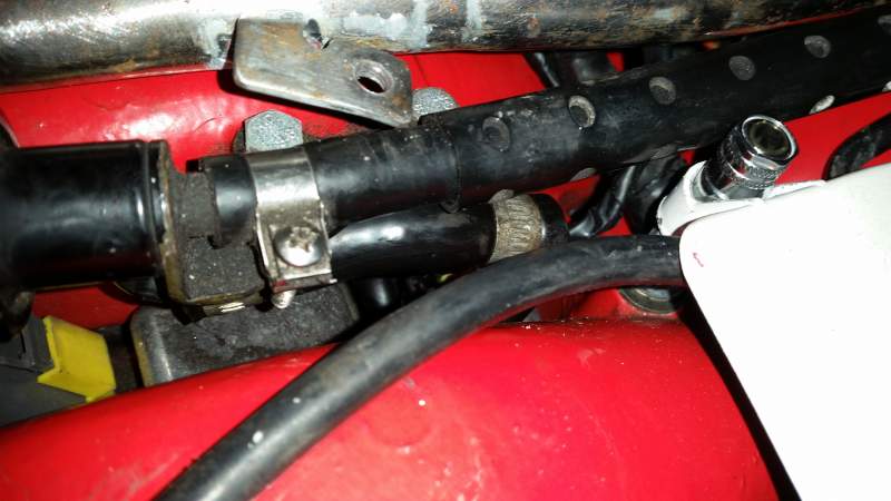

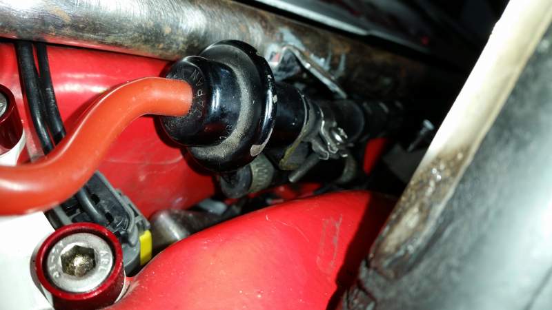

  18. Thanks guys - the garage are going to fit a couple of Fuel line clips rather than the Jubilee clips that are currently fitted.

  20. Hi guys - my car is across the local garage, Istarted it up and could immediately smell petrol very strongly They had a look at it and I have a bad fuel leak, it's spraying out from the high pressure fuel rail What they wanted to know (and I don't know the answer) is should there be this little rubber pipe clamped on with jubilee clips (see pics) or is the fuel rail supposed to be all metal piping. The petrol is spraying out from where the arrow is pointing. They say they could just tighten up the jubilee clip but are a bit loath to undertake the job if this rubber pipe is a modification/prvious repair as they say they would be responsible if the leak returns and something bad happens Cheers Rich
