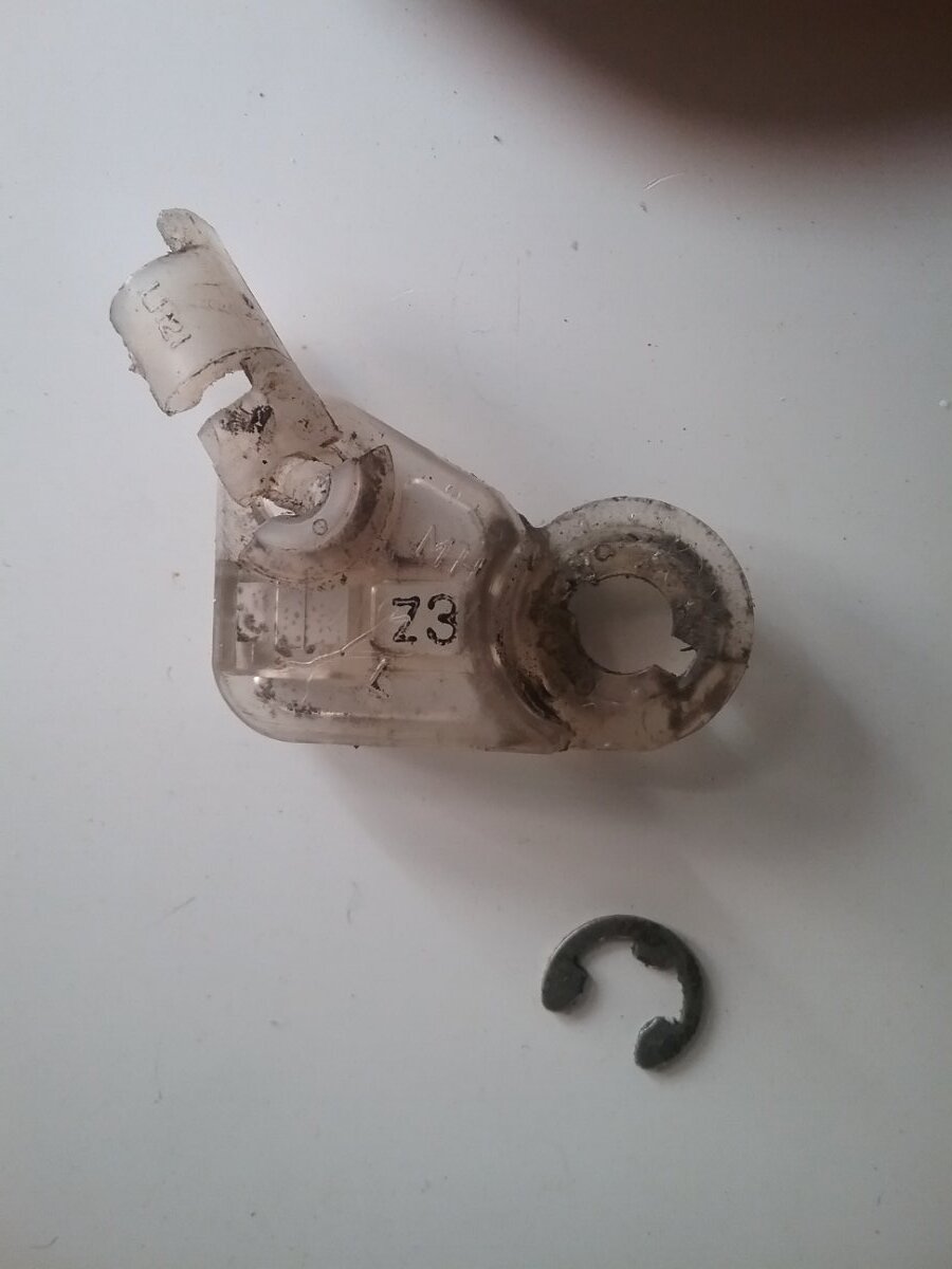

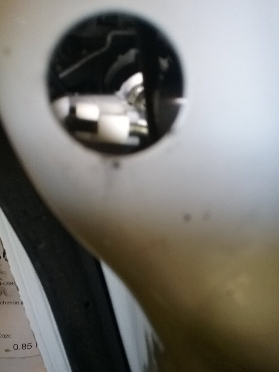

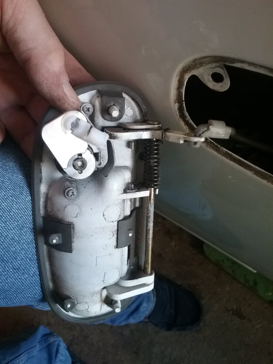

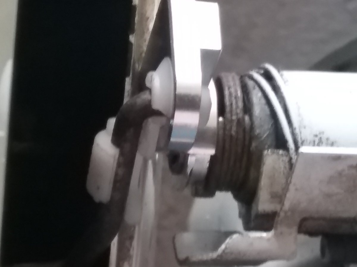

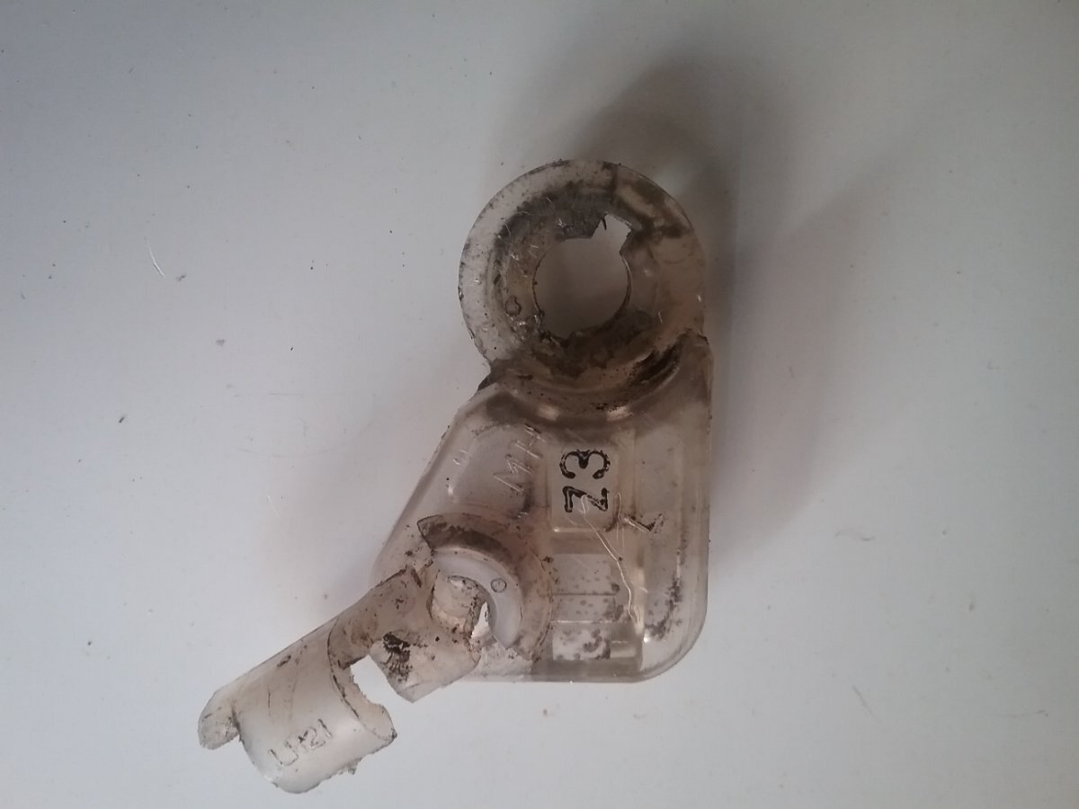

  18. When replacing broken part part on end of key barrel, you need to .. Take door card off Take two nuts off back of handle FROM outside you can now carefully pull handle bolts out Which are part of door handle. At this point you can see both wire rods leave on for now and rotate handle90 degrees or so You now can get at broken plastic part , take rod out of this one leave the other in place What looks like a rivet on end of key barrel is in fact a E CLIP Use small screwdriver and release this Take broken bit off and clean end of barrel put new metal type on and refit E CLIP Now refit rod and rotate handle back to original position manoeuvre back into door Refit both nuts And test. Metal replacement was bought from CZP as a pair they sell new plastic clips also. About £20 Hope this helps
