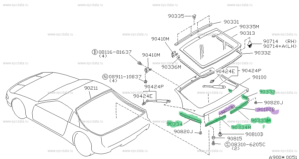

My Z is missing the moldings which fit the underside of the boot hatch and fill the gap between the body & tail lights and the hatch itself... leaving an ugly gap and somewhere for water to creep further in than it should.
I am trying to determine the parts needed and am quite certain I need the ones marked green in the diagram below (although these seem to be the only parts I can find so I hope there are no differences between LWB and SWB?). However, I have no idea what the part marked purple is or if I need that too?
Also if anyone has any pictures of the underside of their hatch... that would really help me visualise what I am missing. And if anyone has any of these parts spare for sale, I would be very interested.

BTW the "purple" item in your diagram is the anti-vibration weight attached to the underside of the tailgate. A mysterious
block of metal suspended on rubber mounts it was designed to reduce tailgate flutter.
How interesting! Thanks. Does this live under the hatch lid plastics or somewhere in line with the moldings?
Seems like a very skipable part that I'd never miss and yet I quite want one.

Not sure we are talking about the same thing. From my picture in the first post in this thread I am talking about the trims marked in green. Clipping onto the underside of the rear hatch to bridge the gap between the hatch lid and the car body - one trim each side and two trims at the back of the car.
Hahahaha! It was me being dumb. When you said back of the car, I was thinking back of the tailgate, as in towards the end of the glass as in toward the front of the car lol!!! Doh!
