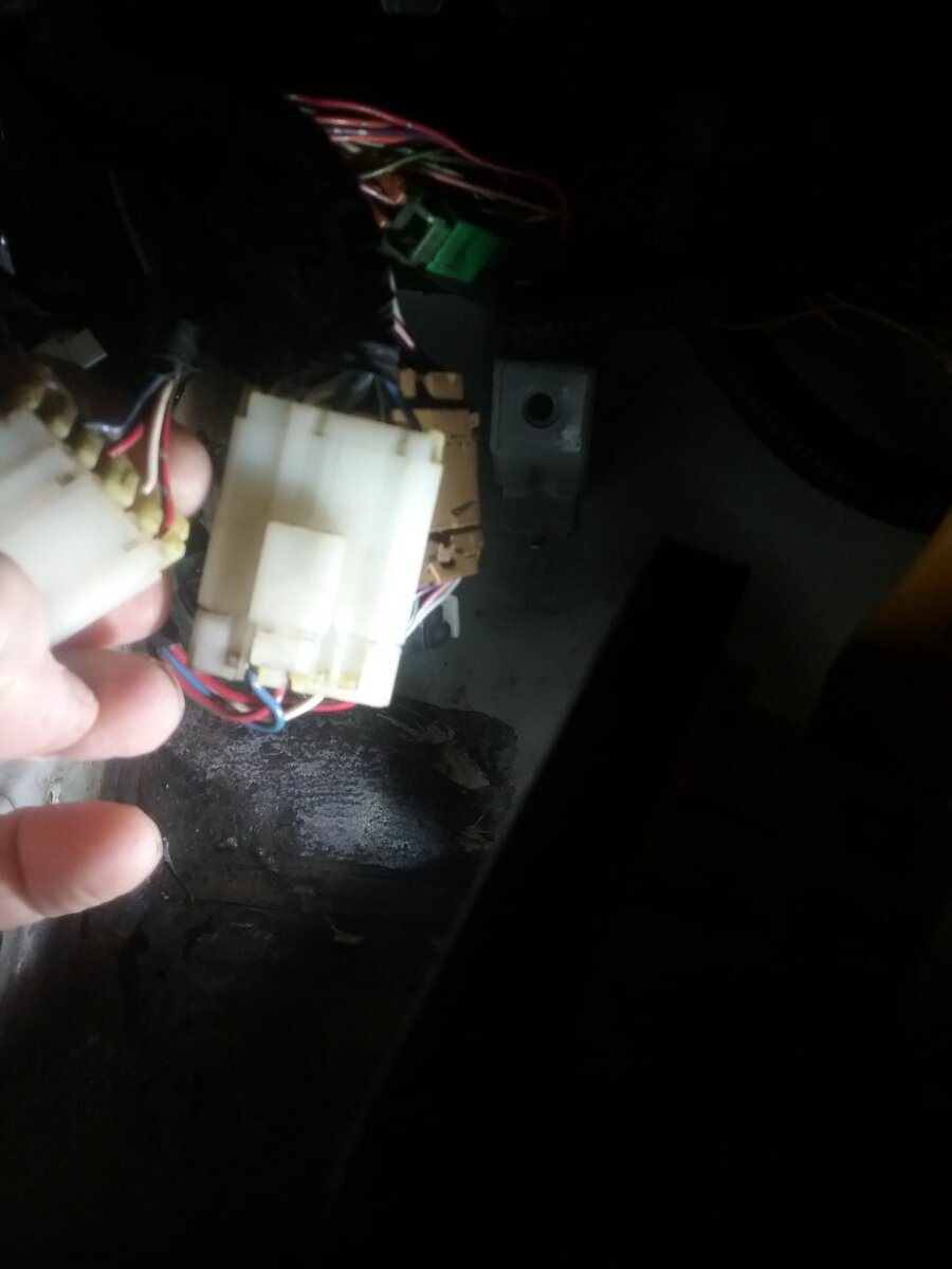

  3. Does anyone know where this plug /socket goes to / from ? It's in passenger footwell. 2x red 1x white 1x blue White plug with yellow top.

  6. Its like the one jefftt showed when doing a targa leak brief, March 17 2014. Will try to get picture soon. UK car Andrew is there a page showing the colour plug and socket on electrical diagram ? Regards

  12. Electrically speaking Live 12v comes from FUSEBOARD to RED wire pin3 This will trigger coil to set timer in motion which should feed live 12v to either light green OR blue depending whether you are locking or unlocking. Light green and blue are your feed to passenger side L/G and L Side note though on my spare colours on passenger side are green and yellow !!!!! So you should have on driver side 12v on red, 0v on black(negative), and switched 12v on light green OR blue(yellow). Passenger side 12v on green or blue(yellow) Regards
