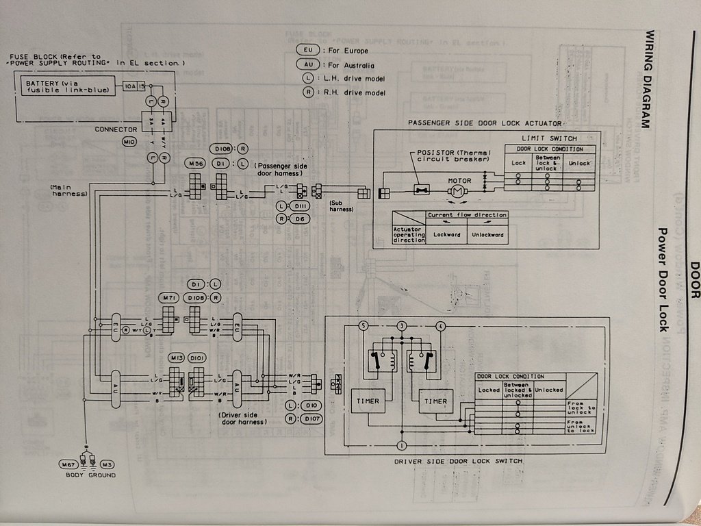

Good Morning Andrew
Thank you for posting the circuit diagram, I have never been very good at reading these things (just thick i guess)  I can follow the path and assume that I would be looking at the Australian part of it, which answers my question that it appears to have a permanent live but it still does not give me the colour of the wires going to the Drivers side door lock switch is there some sort of code ?

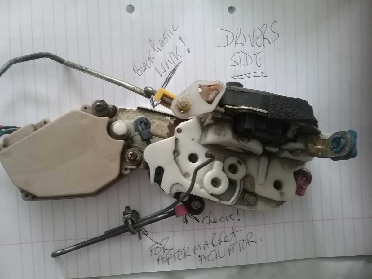

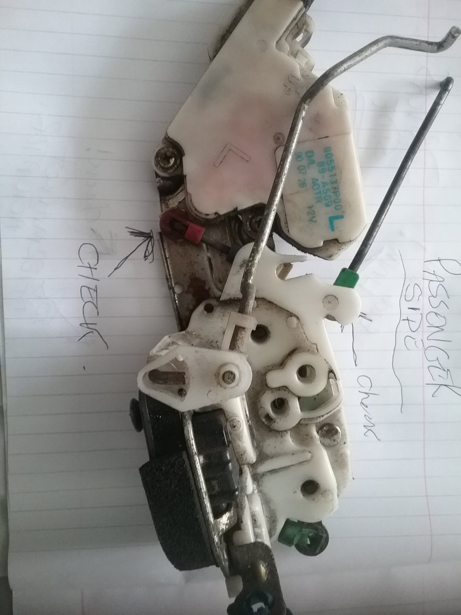

Hi, when I fitted my aftermarket alarm I had to connect new actuator to existing linkage in drivers door, if all links are ok in driver door look at linkage in passenger door , the coloured links are made of plastic which become brittle and snap !!!
The small black one which links electric to mechanical is probably worth double checking on passenger side.
If after checking you need one CZP sell metal upgrade products for these.
Hope this helps you.

Live 12v comes from FUSEBOARD to  RED wire pin3
This will trigger coil to set timer in motion which should feed live 12v to either  light green OR blue depending whether you are locking or unlocking.
Light green and blue are your feed to passenger side L/G and L
Side note though on my spare colours on passenger side are green and yellow !!!!!
So you should have on driver side  12v on red, 0v on black(negative), and switched 12v on light green OR blue(yellow).
                                         Passenger side 12v on  green or blue(yellow)

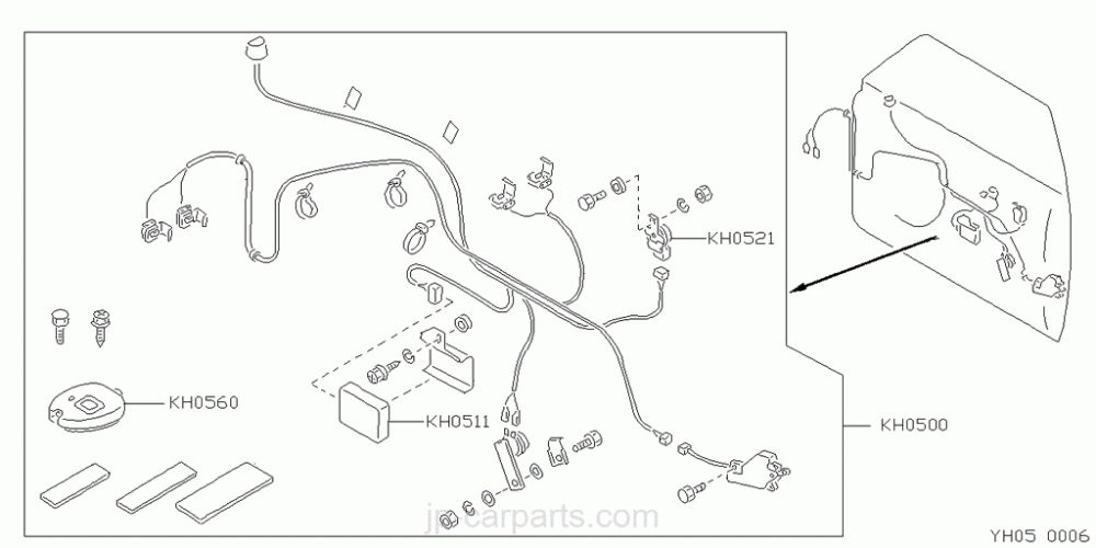

H0561-35F00 (KH0511 in diagram below) is part of the Nissan remote door locking system kit (H0560-64J27) offered in the JDM market
an option.
http://jp-carparts.com/nissan/partlist.php?maker=nissan&type=69&cartype=6&fig=H05
I don't have the Japanese circuit diagram, but the parts diagram shows the key parts and wiring. And yes, scotchloks were supplied in the kit!

Thanks for the info, presumably fitted in Japan before export, I don't really know which way to go from here, presumably the quickest way to a solution is to take this Control box out and follow the loom from it to wherever the wires have been connected, disconnect them and remake all connections to the vehicles loom where it has been spliced into.
Without the wiring diagram I don't think I will be able to trace the fault at least with the cars loom back to factory (as best I can get it) I might stand a chance.
