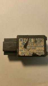

Flasher unit should be behind steering wheel under dash and there is also a bulb check relay  that looks like it is on accessories  board behind fuses in drivers footwell !!!!! Hard to get too so try flasher tset first.

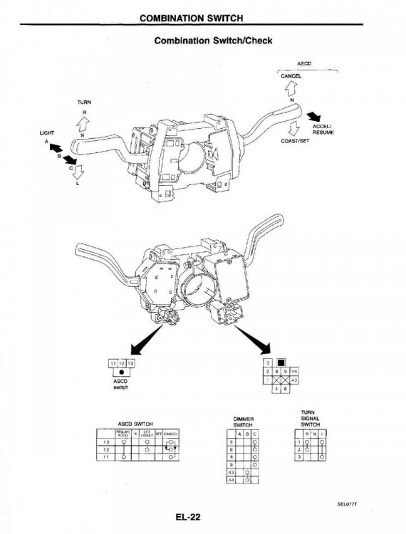

Ok. If you go to stalk  plug side you should have 12volts on pin number 1 ,  if not you will need to back track to flasher unit.
If you DO have 12volts on pin 1   you could try putting a temp link between pin 1 and 2 this should make one side flash.
Link between 1 and 3 the other should side  flash.
If you have 12v on pin 1 and nothing happening when linked you have broken wire between 2  and lights or 3 and lights
Chances are only one will be not working ,you will then need to check wires from pin 2 or 3 to the actual lights
You just need to keep methodically  going though them.
Remember you will need ignition On     so be carefully when linking or you will of course blow fuses.
Like I say multimeter check 12v on pin 1. First

I have 12V on pin one, i have looped wires 1+2 and then 1+3 both times worked as expected but still with no power to either front indicators (the back and sides are OK).
Think I need to find out what the relay does behind the fuse box in the foot well and check backwards from the front bulb connectors.
The back of the car is jacked up at moment awaiting parts which should come today, tomorrow I'm gonna jack the front up and take the inner wings off to see whats happening with the loom, but the are fed independently from each other one wiring loom per side inside the inner wing.  Blowing my mind lol

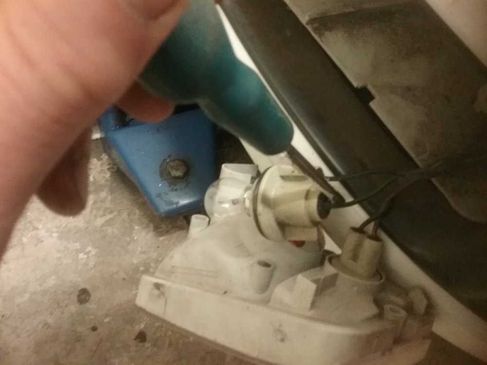

I've put a vidd up on youtube, as you can see that the end the sidelight is working and the sidelight shares the same earth so not an earth issue.  only recorde drivers side but passengers side asme.
I only noticed this as my car is nearly 'finished' and ready for mot an I was putting my lights back in but I have now got larger front mount intercoolers so the lights don't fit back in with the bulb holders how they are.  Ive decide Ill have to make something, so going with LEDs that shouldn't have to be replaced.

The side indicator should be connected somewhere to the front indicator you coulď try putting another wire in from side indicator to front, this will work , if it then doesnt work you need to give indcator fresh earth connection. Try running wire direct off neg on battery .
Quick test I would do is using your meter,   neg on battery check indicator for 12v if none try reversing put red lead on to battery pos black on indicator earth. This second test will prove you have good earth
Yes video doesn't show passanger side but is same. Well I have put hazards on the with multimeter black lead to negative on battery. The multimeter set on voltage jumped from a signal to zero as it flashed but only 0.02v. When connect bulb holder earth direct to battery it still does not work.

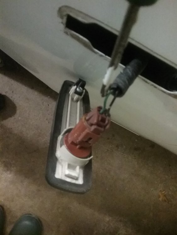

I connected the side indicators to the front but still used the earth cable from the light cluster and is now working as we knew it would with hazards but flashing quickly with indicator stalk as if there is a bulb out. Going to jack front if car up tomorrow and take it from there. Your help is much appreciated mate.

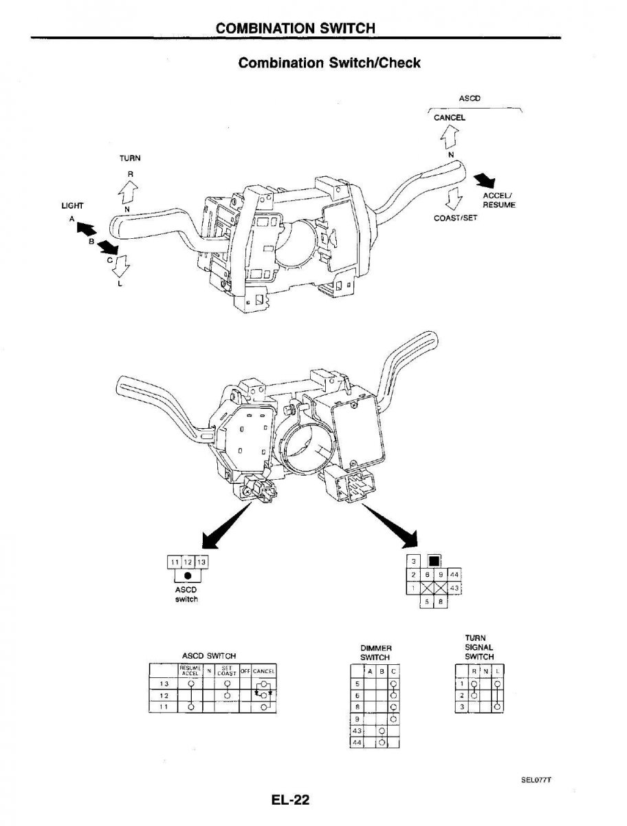

Cheers fog the drawing. Wish a had the electronics knowledge like you mae
