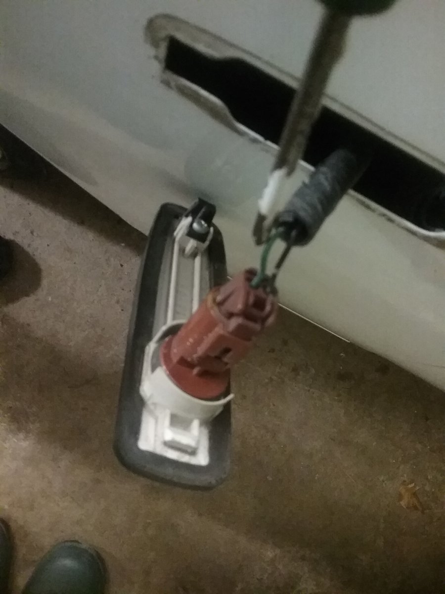

Should be straight forward only one wire needed . Go to side indicator there are two wires one will show 12v when you put hazards on . Cut that wire join another wire to both ends like T piece insulate. Then at indicator end do same. Find the 12v feed wire (the other one is earth.) Cut and join light side wire to your new wire. Remember to insulate the harness side of wire you have just cut.
Make sure you have good joints, soldering iron works best.and heat shrink.
Test if all well do same on other side.
You should cut on indicator side of plug and socket power off.
Just opened my indicators and basically it is the green wire you cut and join between side and front.

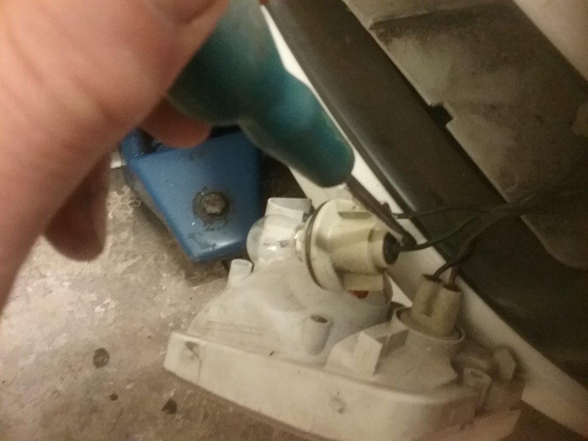

I would now advise you check rh indicator take bulb out , take bulb out of side , put meter on continuity and test between cenre of front to centre of side,  there should be full continuity  this will prove whether you have broken wire.
Do same on rh indicator.
