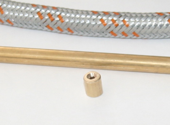

  10. Well couldn't get a restrictor, so I made one from some brass rod..... Cut a 3mm hole through it..... apparently this is the size if the oem one in the std hose...... Just need to fit to the new hose now.... So Question 1 is now done...... Anyone know about fuel pumps.... Question 6......????

  15. Hi, I have just fitted the new oil cooler and lines and before I get finished putting radiator in and cranking over the engine............ I have a few questions..... 1) I can't find the restrictor in the old oil lines as I only had the ones from the block to the metal hard pipes.... no restrictor seems to be in them..... do I need to get one and fit it to the new braided lines? Made restrictor myself 2) How do I prime the new oil cooler and oil lines before firing the engine for the first time? I know about cranking the engine without ignition to prime the turbo's..... Do I fill the oil cooler manually? Going To fill oil cooler before I fill engine to make sure there is oil in the system before cranking! 3) Also fitted Transmission oil cooler.... used a std TT oil cooler for transmission as I am fitting an alloy rad without oil cooler for the transmission..... Do I fill this with auto transmission fluid as I lost loads when I pulled the engine a few years ago? Going to fill with fluid and check transmission fluid level when running 4) Is it okay to clean up brake discs that are rusted..... cars been sitting outside for 6 years without use......? Going to remove and clean off the rust and see if they are pitted! 5) Does the old fuel need emptying before I fire up the engine as it is 6 years old, about 1/2 a tank full? Emptying tomorrow after advice!! 6) Will the warlbro 255 pump I fitted be okay for a TT or should I have gone with a 2nd hand TT pump? Still need advice on number 6 .......please....
