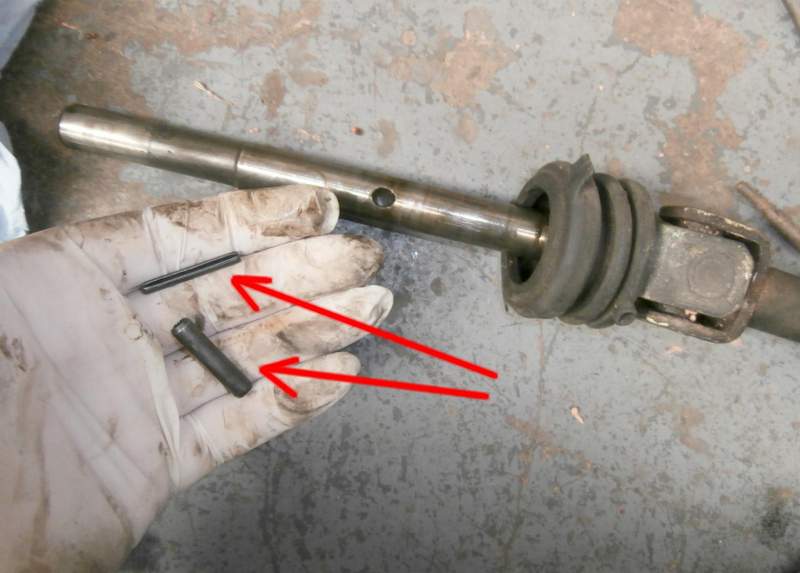

Here you go...
Packaged and posted will be with you tomorrow, now back to that drivers side turbo replacement with the engine still in....yuk!
Jeff TT
Here you go...

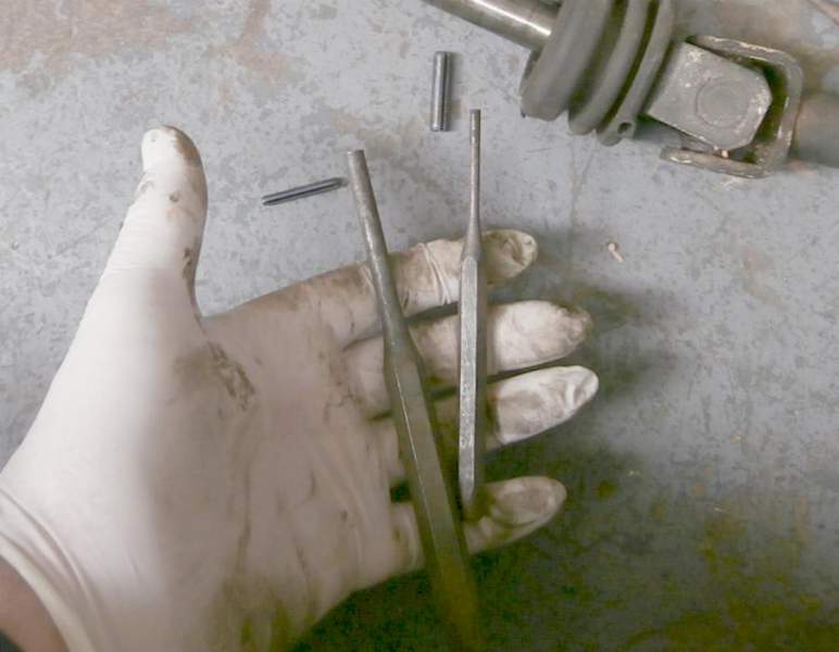

is it just the one pin i need to knock out? looks simple enough
Two pins one fitted inside the other, knock out the centre one first.
Jeff TT
Helpful if you have two different sized drifts.

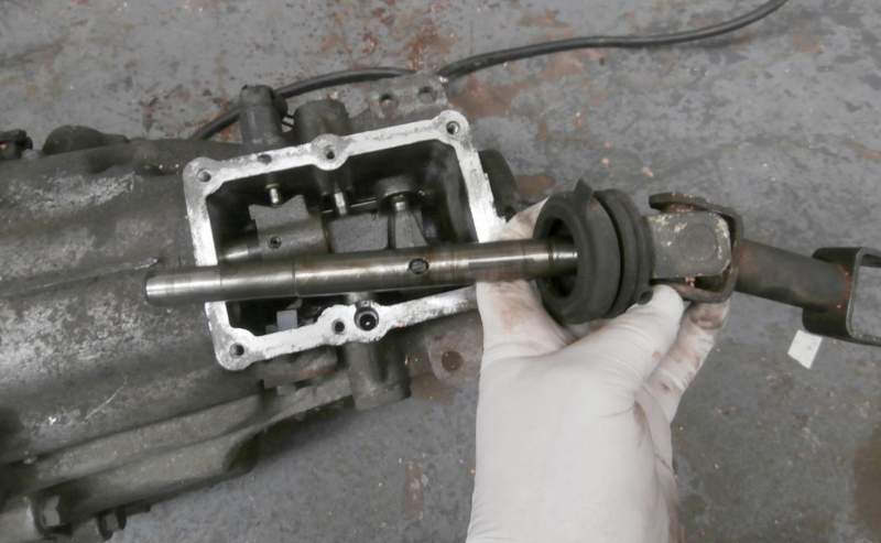

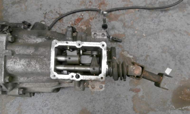

Is that accessible with gearbox dropped slightly, out or can it be done in situe?
I'm thinking it would be better done with gearbox off the car, if you drop those pins in the gear box it's going to have to come off anyway
If you need to take the box off anyway then fair enough, but i would try first, if you are lucky enough not to drop the pins then less work lol
