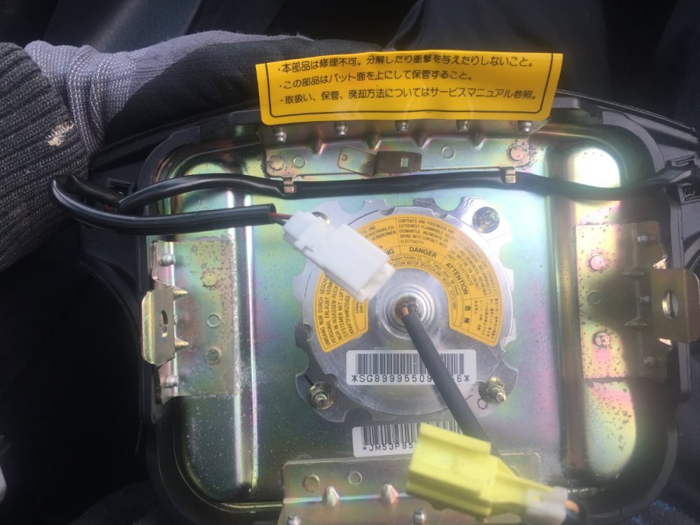

  9. I was kind of hoping this would be the issue, but I tried both the original location of the horn bolt mounting to the chassis and a few other locations - still no luck, - Ascotec - So does that mean that the 'module' is the air bag module? It looks completely different to what I can find when searching online, - The horns and relay were tested individually on a bench test and were working - even the old horns worked when tested individually! I feel this may be the way to go. Sorry for the simple question, but would this mean running a wire from the left-brown connector on the module to the relay? Hopefully, this doesn't cause any issues to make the module think something is wrong, I'm trying to source a just a second module too as it's a bit annoying having the additional wire running around for the horn. But as TheRealNips has said, they can only be found on the Japanese auction sites, Thanks for the inputs all ?
  10. Hi Everyone! I’ve got a bit of an issue that I was hoping someone may be able to offer some advice on. The horn on the Z no longer works and I can’t really work out why ? I’ve changed the fuse in the engine, the relay in the engine and even got new horns – Hella Supertone, but still no joy. I also removed the air bag from the steering wheel to check if something had happened there, but everything looked good! One thing I’m not sure on is how the wiring for the horns works. The buttons from the steering wheel connect to the earth and then go into some kind of ‘module’? Is this for the air bag or the HICAS or something else? As everything else is working independently, I’m leaning towards this ‘module’ thing being at fault – but I have no idea what it is or does! The ‘Air Bag’ light goes on on ignition and turns off as normal too. Nothing has changed in terms of the wiring and the problem randomly occurred. I’m not that great at electrics, but I have a friend who is and they also suggested it may be the ‘module’ at fault, as everything else looks okay. Is there anything else to consider? Thanks in advance all! ? Information on the ‘module’ sticker: Nissan Motor DC12V Custom ER’S No = 98584 53P00 Parts No = 407933-0591 ASCOTEC A picture of the module under the air bag – Horn Button - Steering Wheel Rear View - Module Closer -
