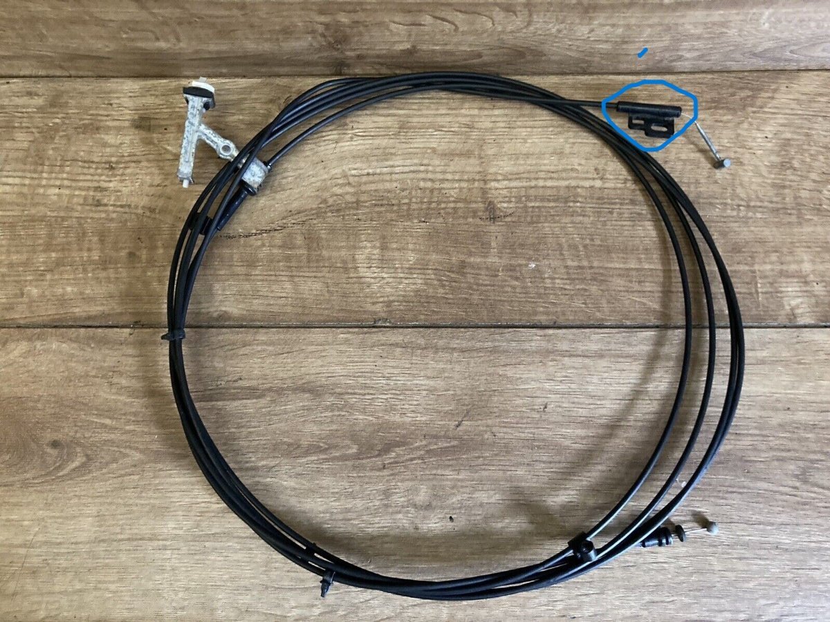

I am pleased to report that I have fixed the issue.....
The little plastic fastener had broken at the release lever. Luckily I had a brand new Nissan part sitting in my garage ๐Ÿ˜‰ย

Typical, finally got my car back, went to fill up and the cable snapped!ย  Anyone for a good spare before I reach out to the usual suspectsย
