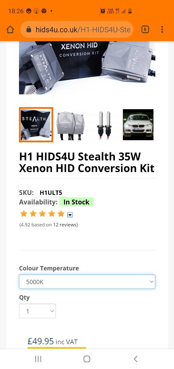

Ended up buying these with the 5000K option... will update once fitted:)

HID's arrived today... But... bulb is different, is H1 not the dipped beam??
Damn... from the HIDS4U website it said I needed the H1 so didn't even bother to check! just assumed it would be correct... Hopefully they will be able to do something as I have tried to fit them and cut one of the rubber fittings!?
H1 is high beams.
Spoke to HIDS4U who were very helpful and agreed to swap the bulbs over fo the H3's free if charge? can't ask for fairer than that?

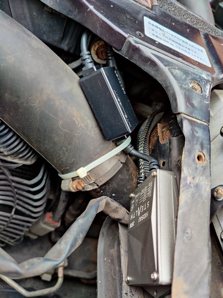

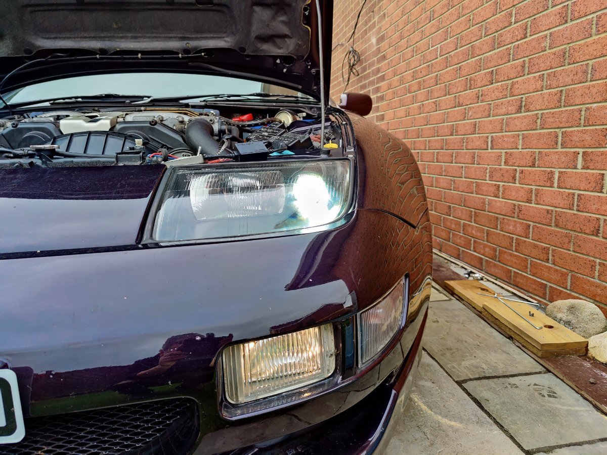

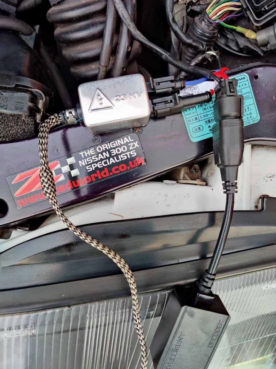

HIDs are easy for a DIY install. Takes about 20-30 mins. Longer if you want to hide the ballasts away under the nose panel (even longer if you tuck them under the headlights themselves).
The Hids4u kits are proven to work. EBay kits are a lot cheaper and they do work. I've used both and happy with both.
What can take the time is doing a suitable headlight flash mod so that the HIDs don't turn off when you flash the main beam. There's write ups of a few different methods in the how to sections. It's not difficult to do though.
Remember that cleaning the inside of your lenses will make an absolutely huge difference too. It's fiddly but doable without removing the light cluster itself.
