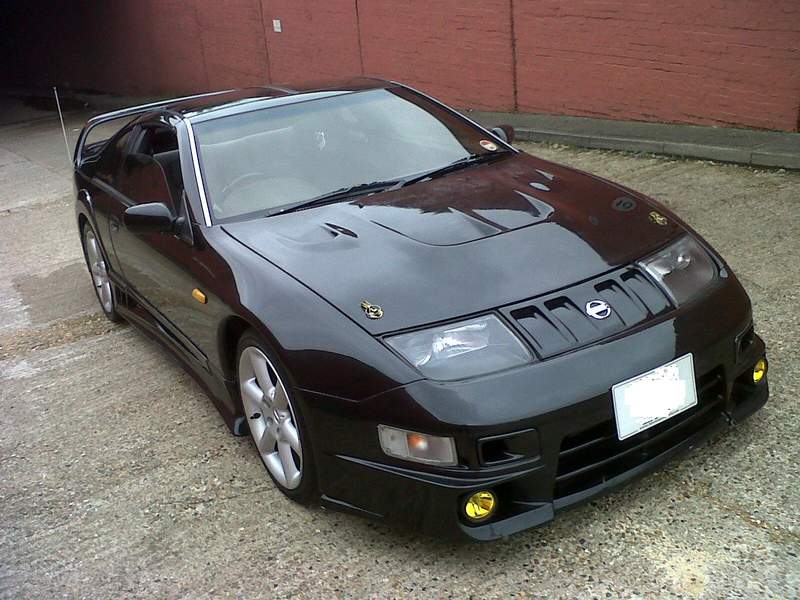

  6. Alot has changed since this pic was taken. Never got a chance to take new pics but you can see it.

  17. A friend of mine made K300 MAL look like that. He bought it standard off someone. But that is me enjoying the car when this pic was taken..:devil:
