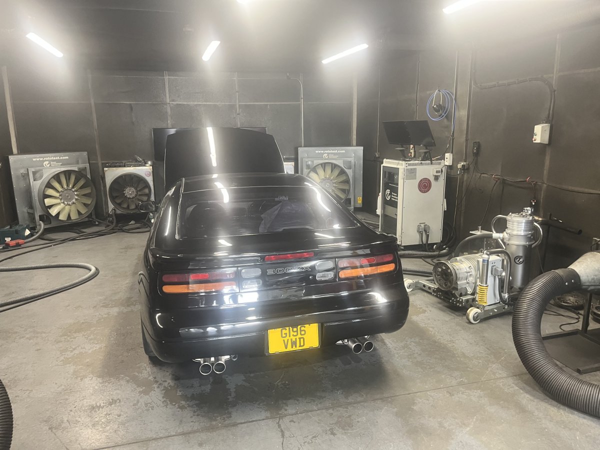

Tune scheduled for Sept 1 by RaceCal using TDI’s dyno. Will post the results. Great to see there are other owners chasing the elusive NA power!

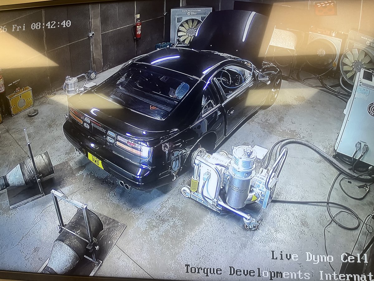

Hate to report this but ran into problems during mapping. Tuner noted power drop off at 6k on multiple runs then detected ticking sound. The consensus with RaceCal and TDI is to pull the motor for inspection. Car is on the way back home tomorrow and I will tear it down and send the long block back to TDI for inspection. Will update as things develop.

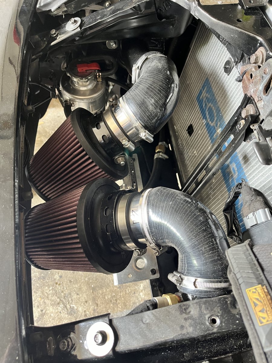

Not yet, still waiting for TDI to finish the inspection. While the engine is out I’m taking care of a few small jobs. New dual air filters rather the HKS set up, power steering lines no longer leaking, horn wiring fixed, and a few cosmetic jobs.
