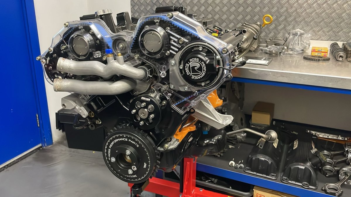

    Body repairs were delayed due to my body guy needing an Op but the Sills have finally been completed. A lot more work was required than I imagined, and the complexity of the sill construction was the
  • Engine is home now, just need to add the fuel rails, new injectors, upper plenum, throttle bodies, and then the belts, alternator, etc... Everything should be good to go once the body comes back from

Yes, main bearing was fouled by some contamination. Current theory is that some loose metal was in my remote oil filter tree/cooler set up and that I didn’t adequately flush it out after it sat in the lock up for over a year. The debri from the damaged bearing spread throughout the motor damaging all crank and cam journals. Engine has been fully stripped and now going through a fresh rebuild at TDI. This was a very costly mistake and to say I’m gutted is an understatement!

Engine rebuild almost complete. Updated to 88 pistons and Tomei cams. Should be back on road in time for summer, will update as she progresses.

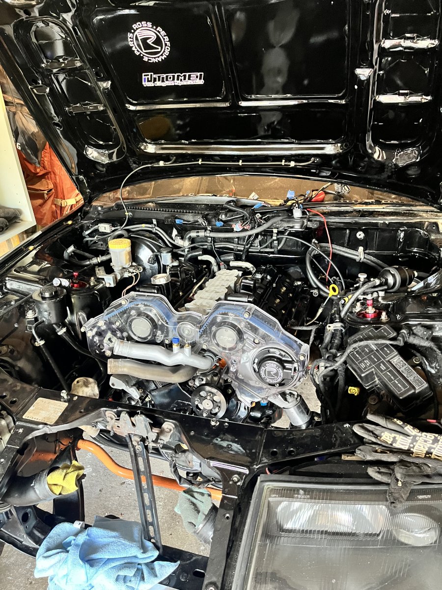

Black Sunshine part 2 begins! Picked up the motor from TDI yesterday and installed today. Taking my time but should be back on the road soon.
  • 3 weeks later...
She’s fully assembled and running sweet! New cams are a bit more lumpy and she has a nice rasp when reved. Feeling really positive, dyno check next week at TDI and assuming all is well a full summer of track days and meets are in the cards.

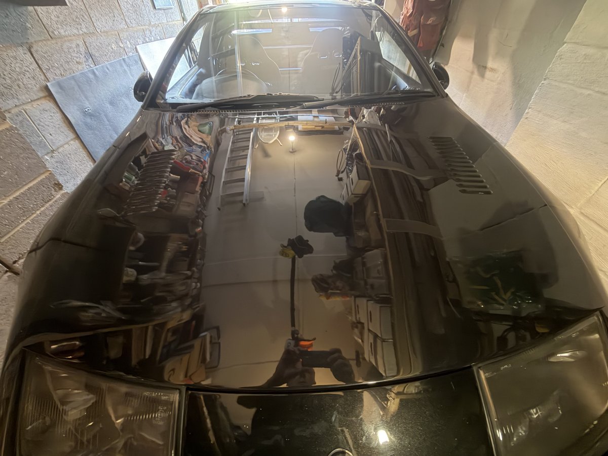

Time to reduce the under bonnet heat, didn’t want those horrible plastic vents so had proper louvres made at Cool Louvres in Crawley. Will drop off for paint tomorrow.
Bonnet painted and installed. Exhaust uncorked with a Z1 race pipe, if this doesn’t solve the 6K + lack of power gain then it’s not the exhaust!
