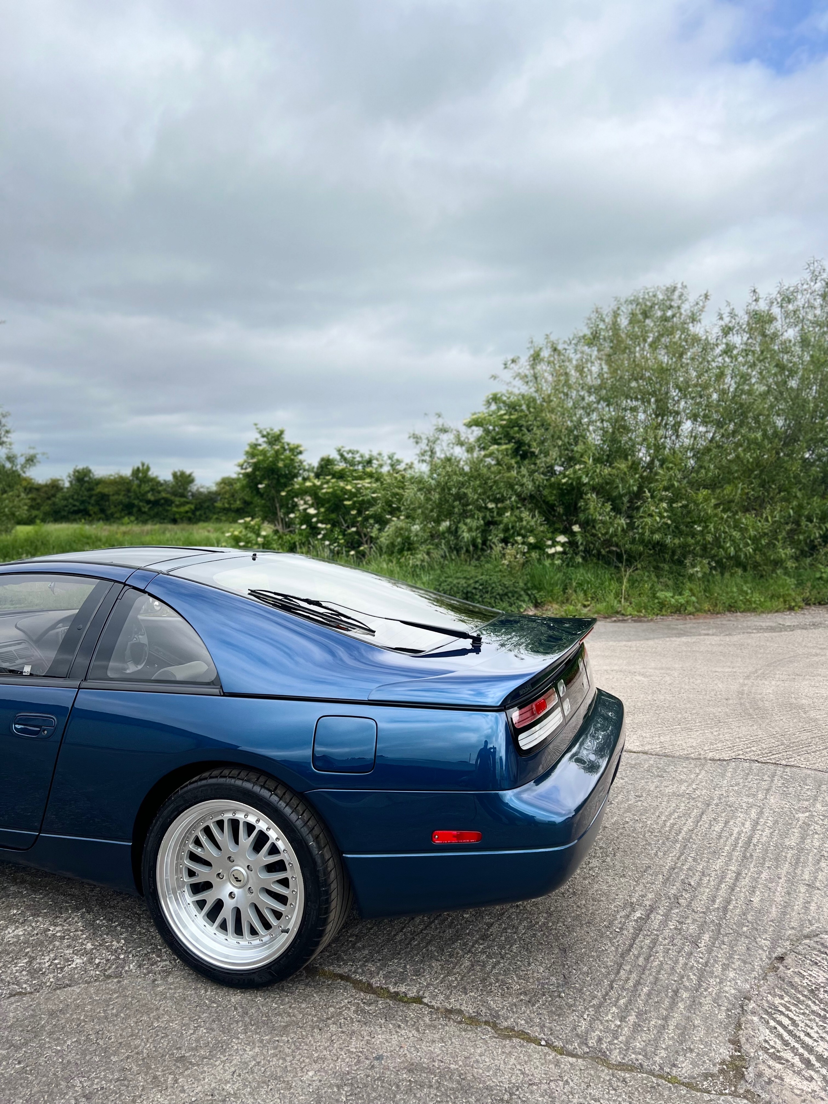

  • Finished putting the engine bay back together this morning and got out on the road. Went straight to Shell and filled up with V power and pumped tyres up. Bought one of those fancy Ctek battery charge

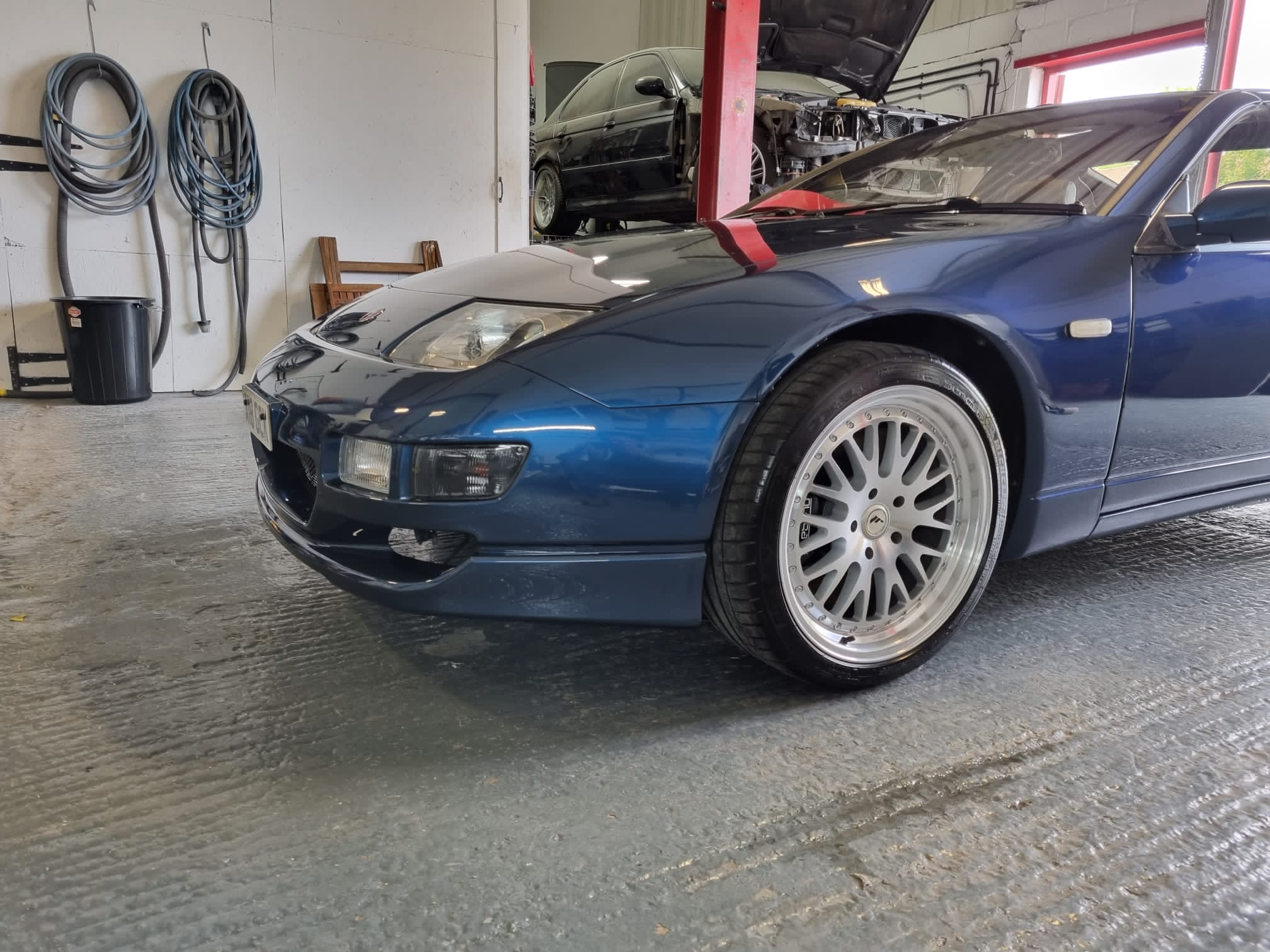

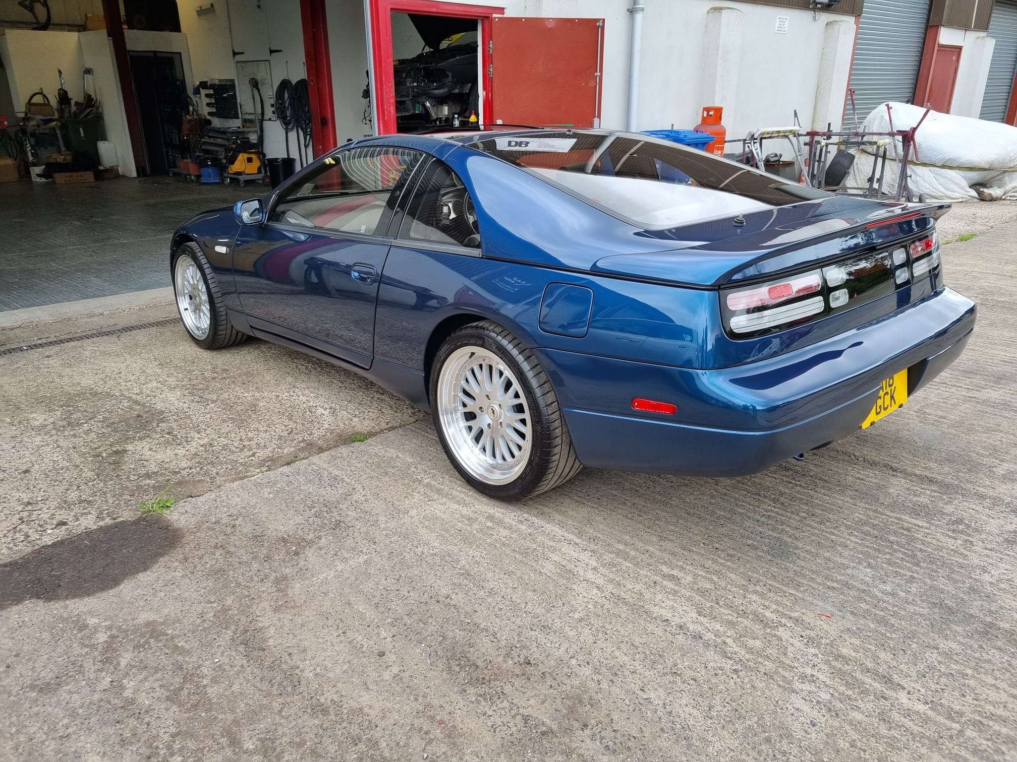

And he just sent me through some more pics!... [emoji7][emoji7][emoji7]
Look at the brothers parked up together the bodyshop says haha. Front end sitting a tad high as it’s engineless, but other than that, an absolute dream come true.

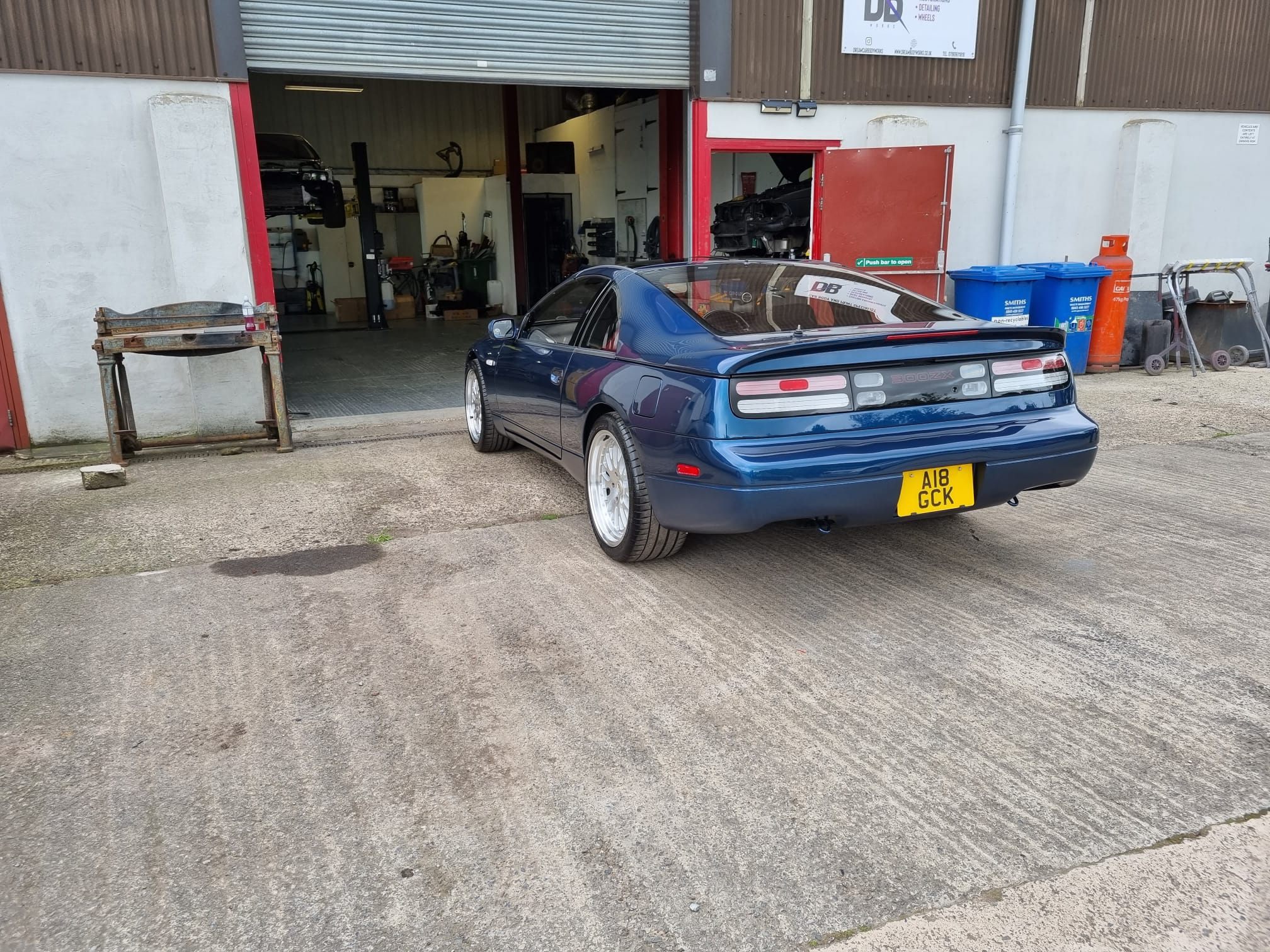

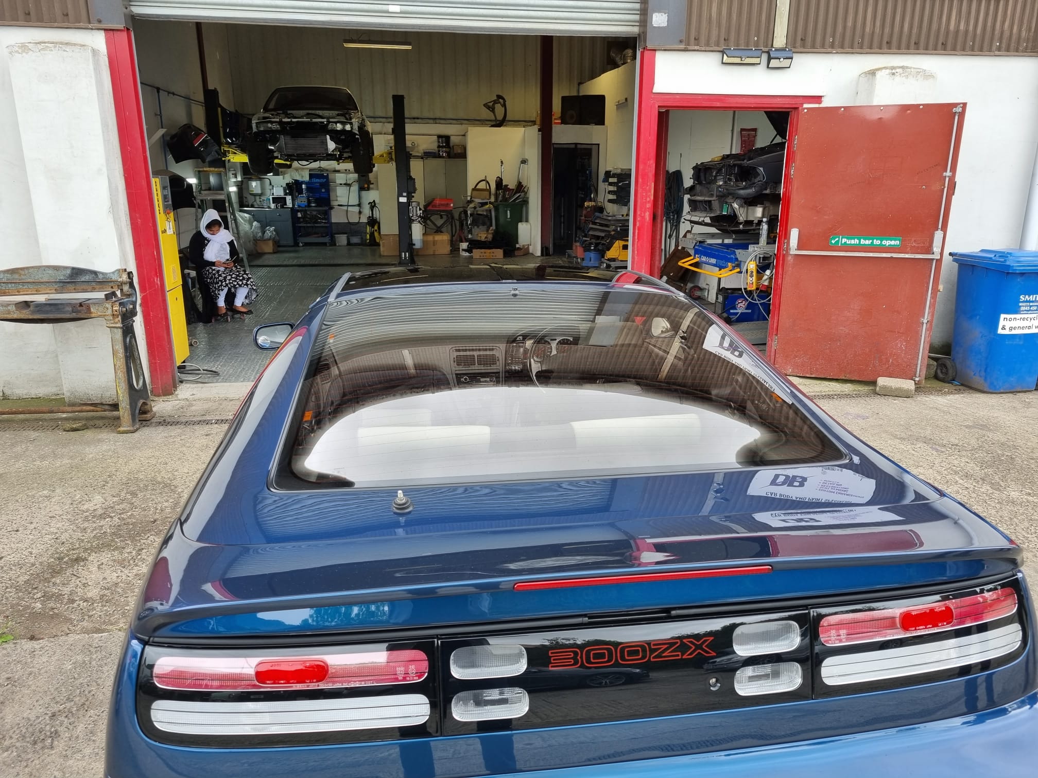

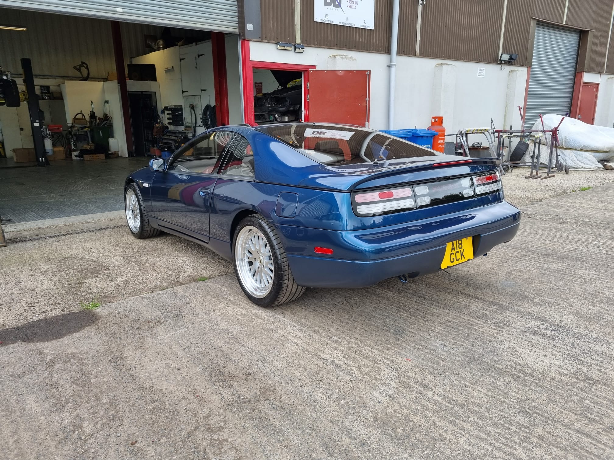

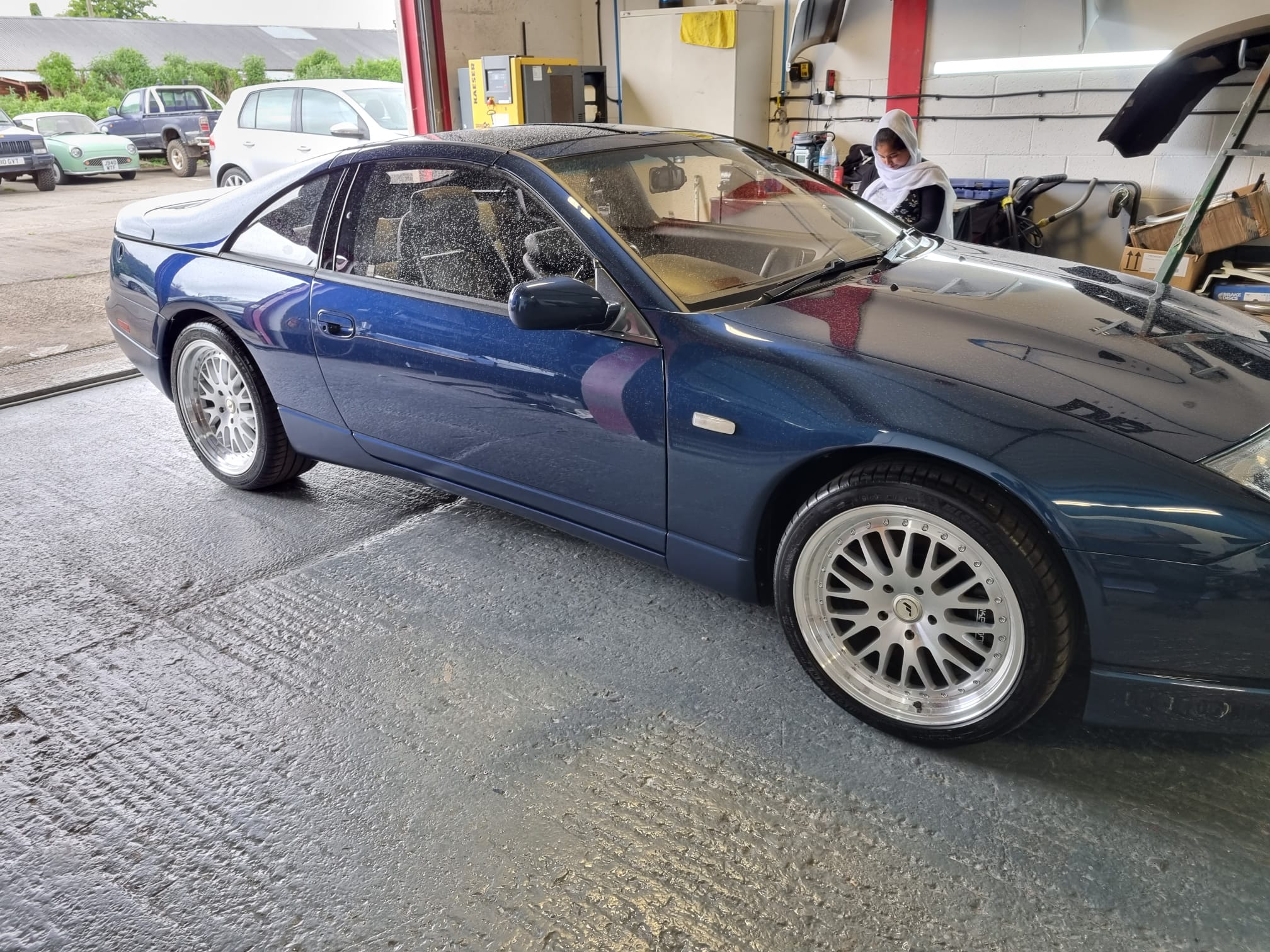

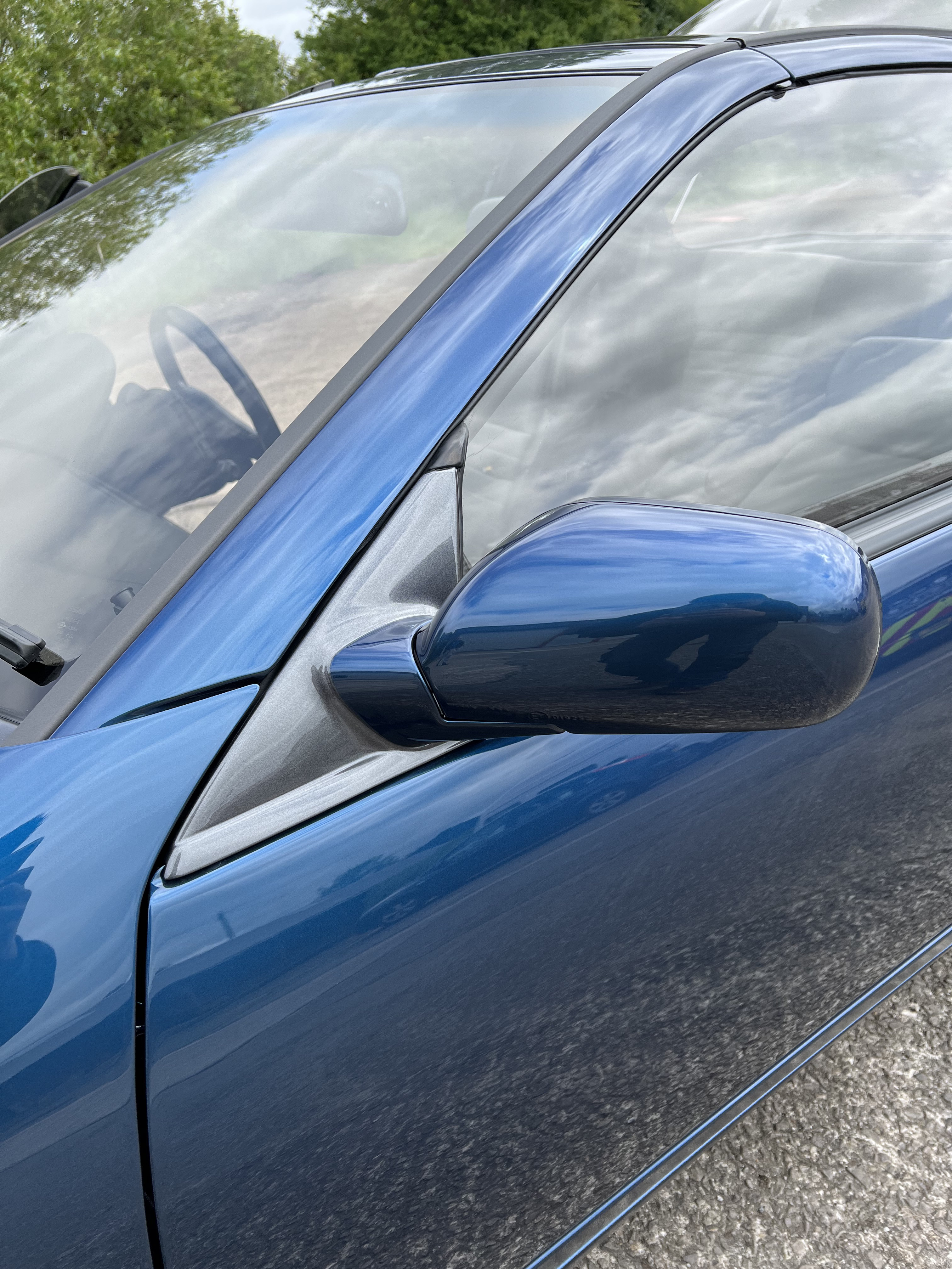

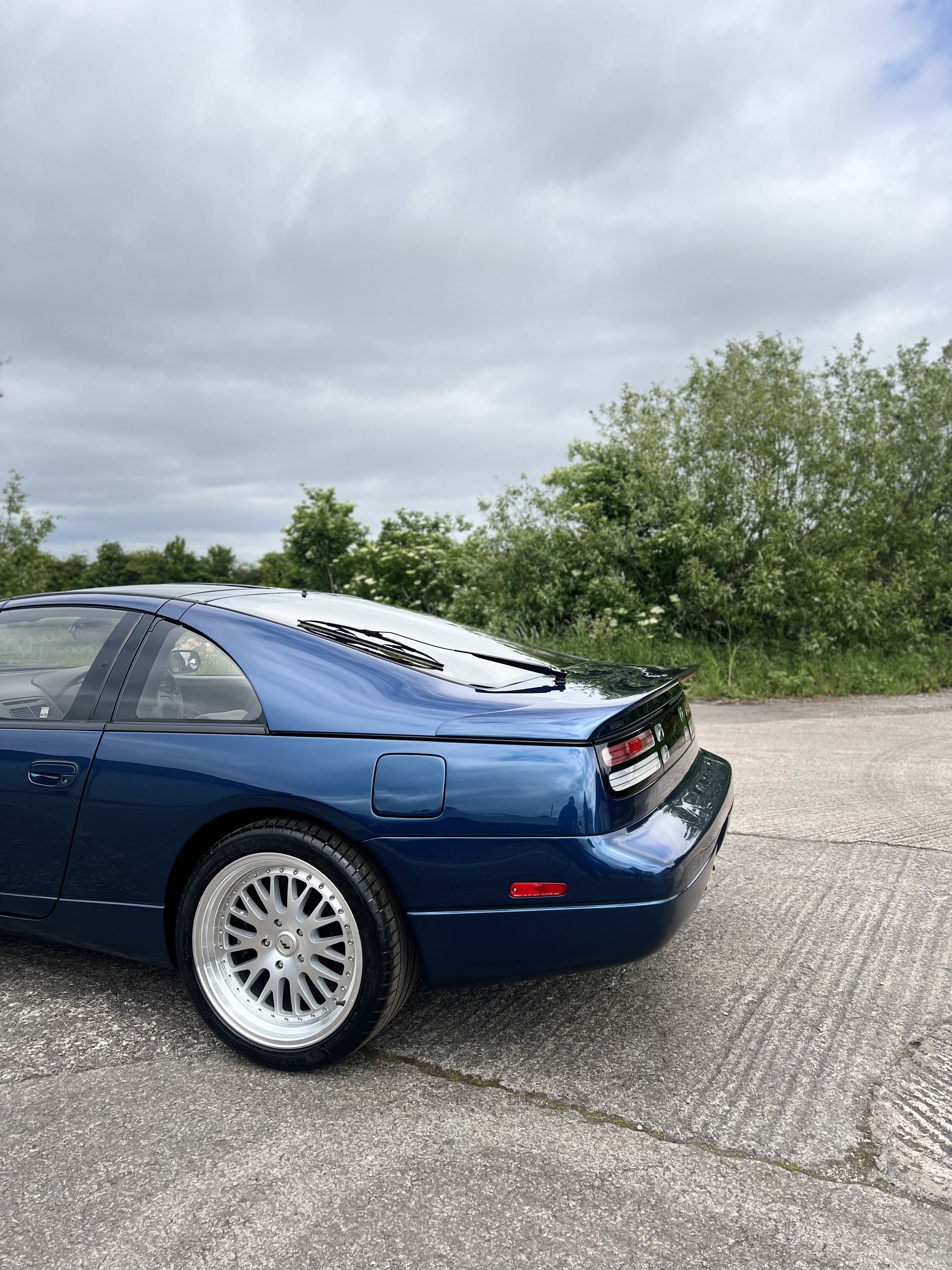

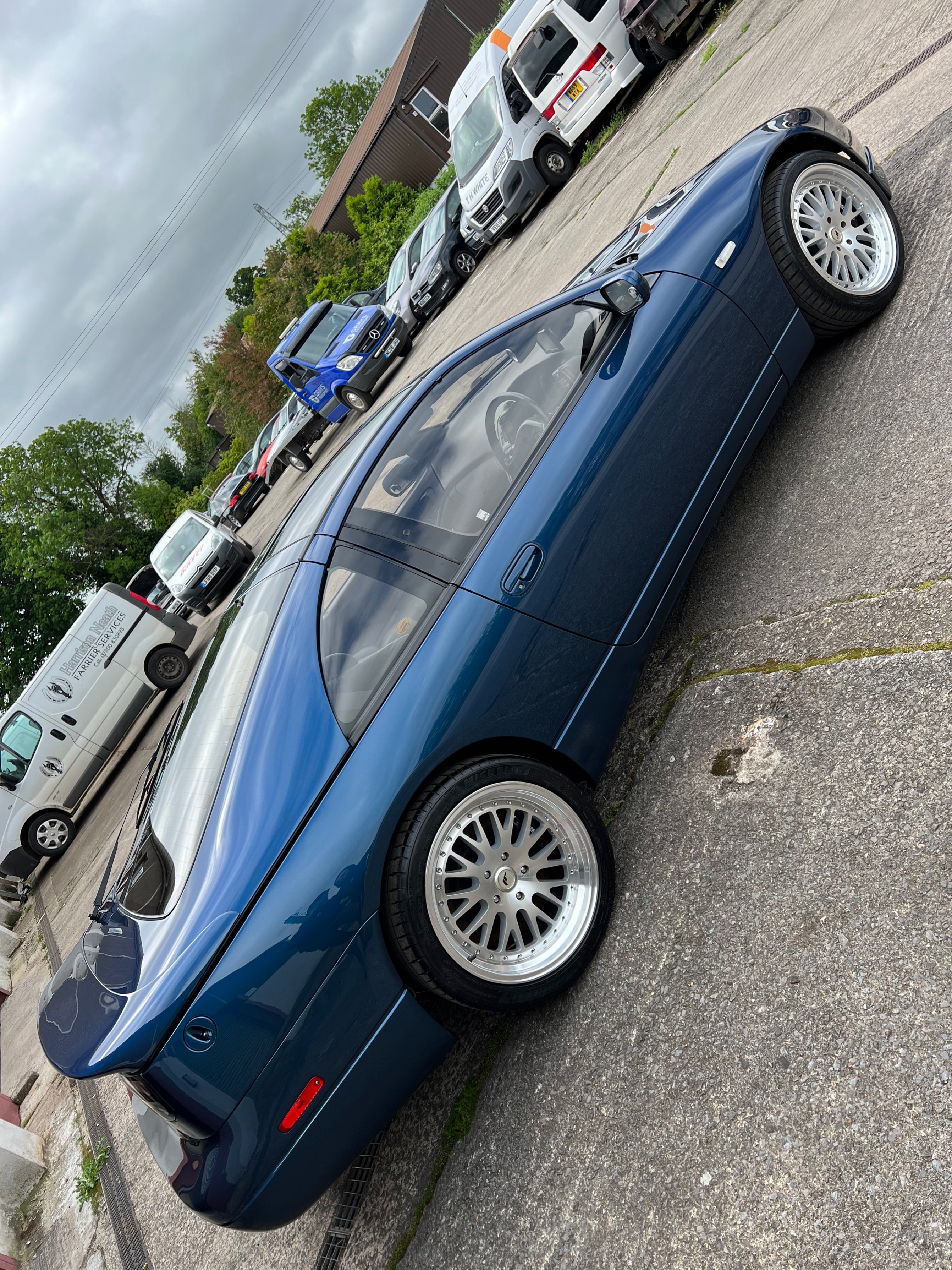

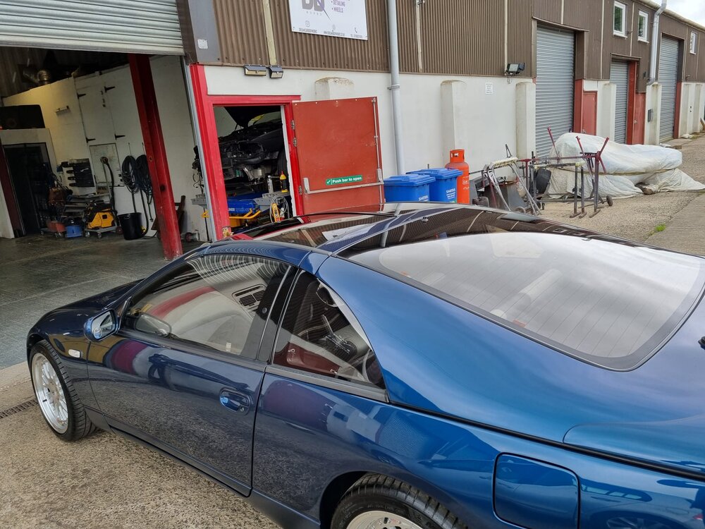

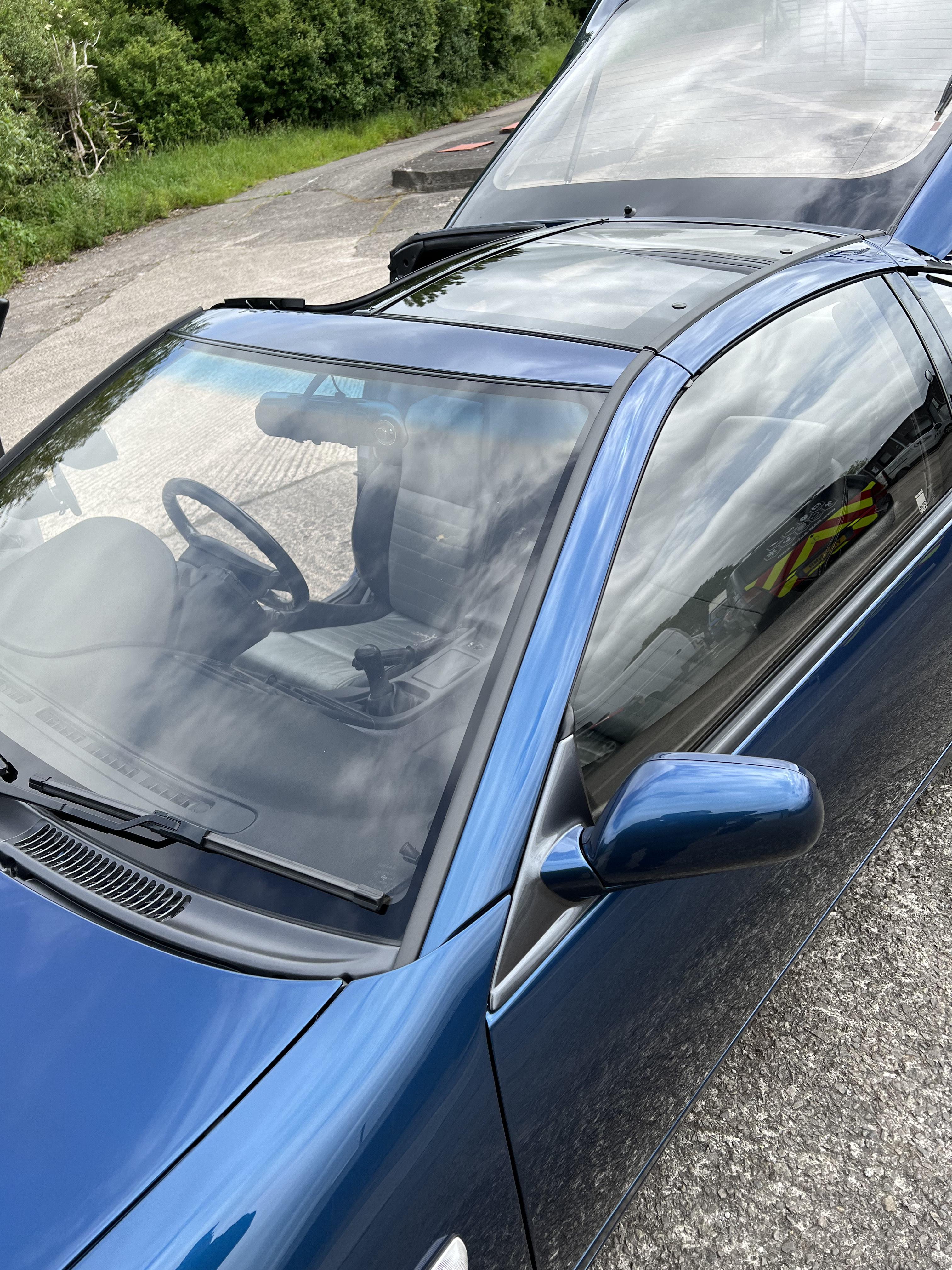

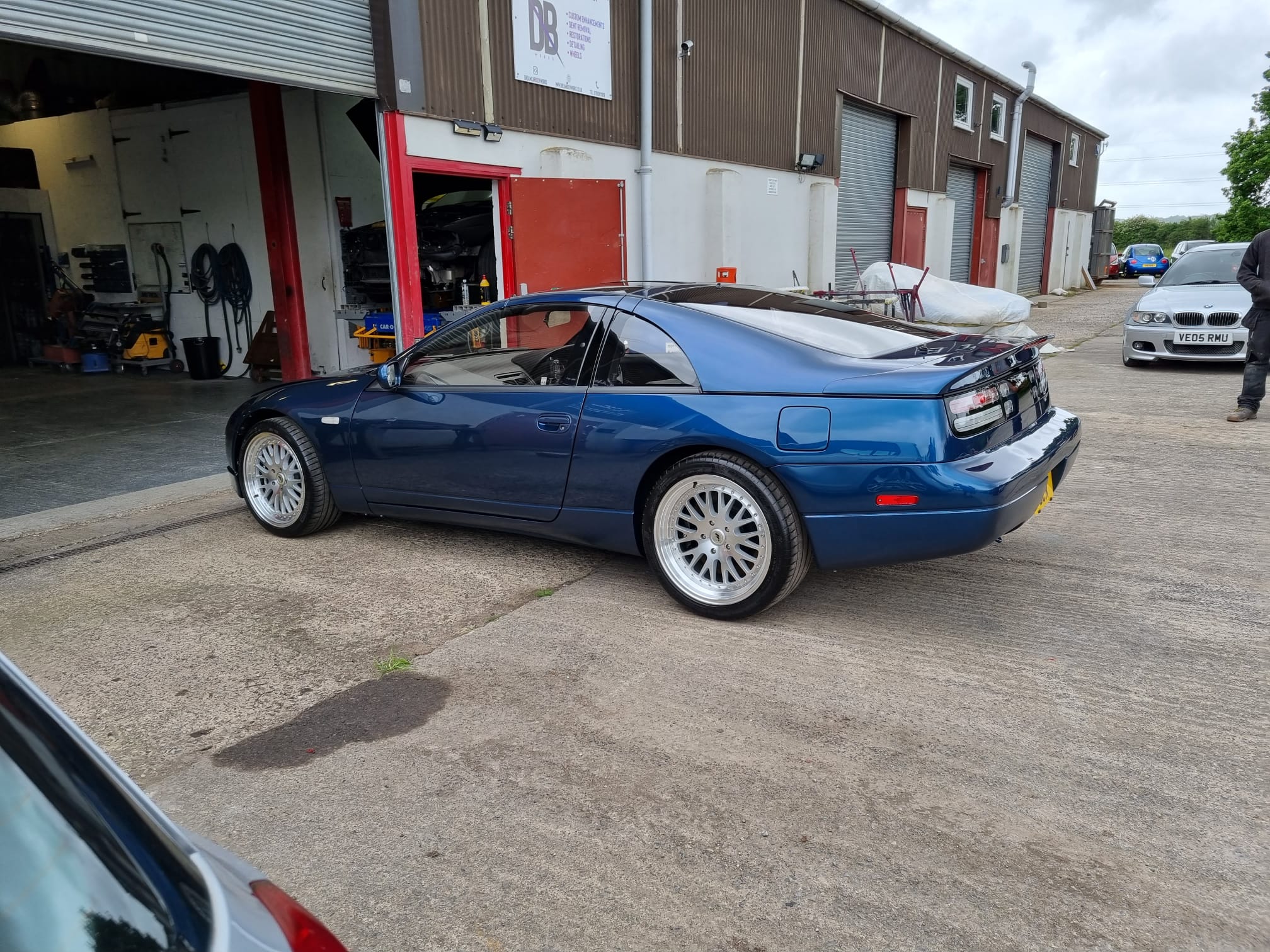

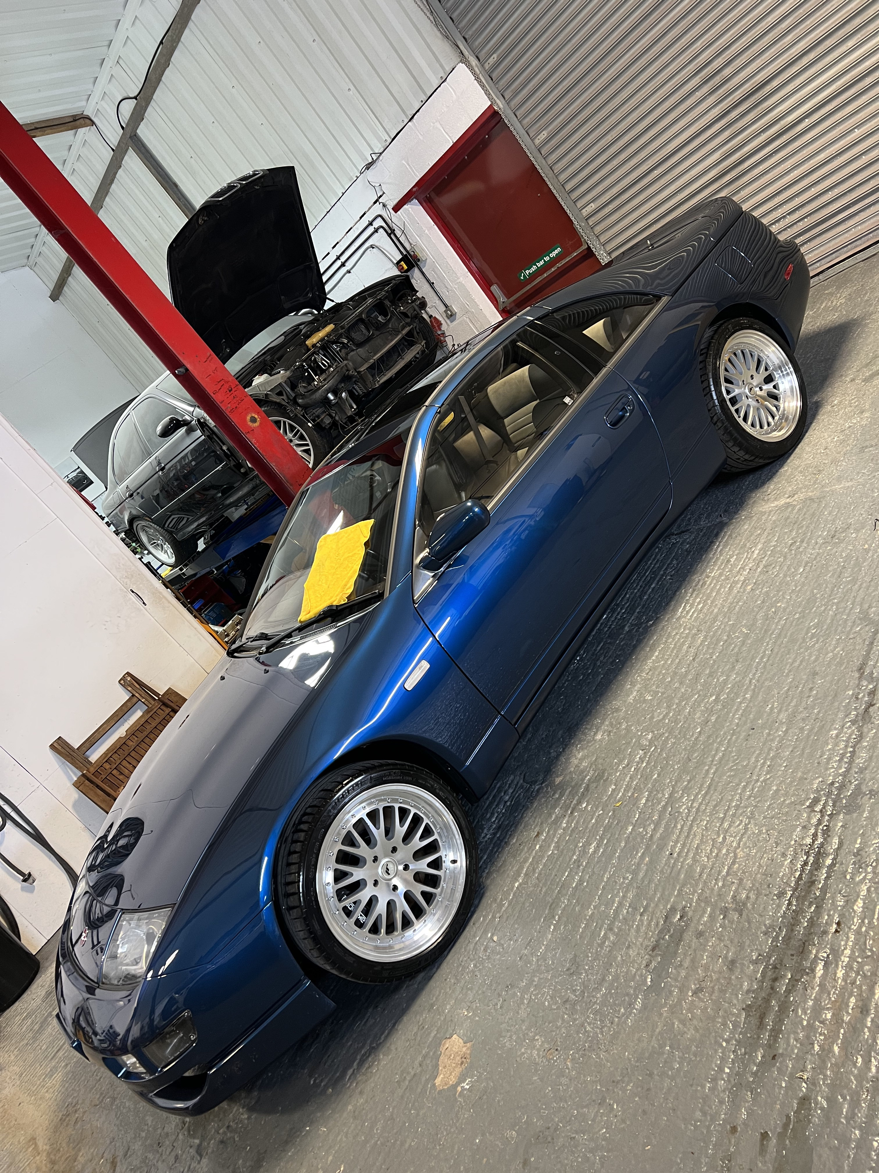

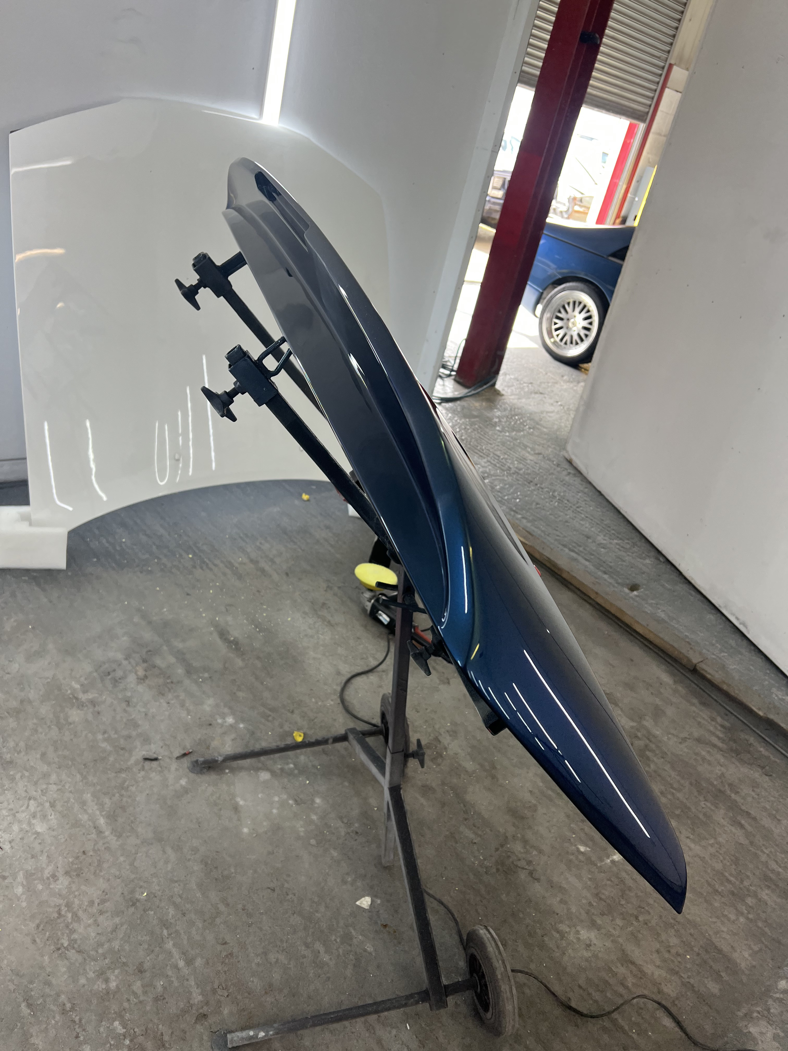

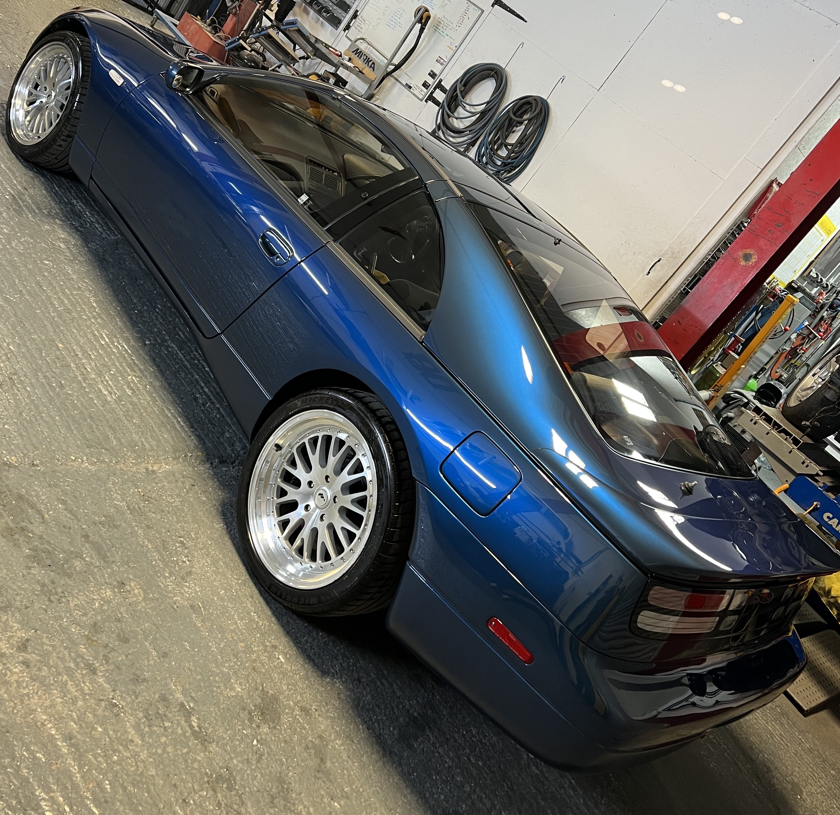

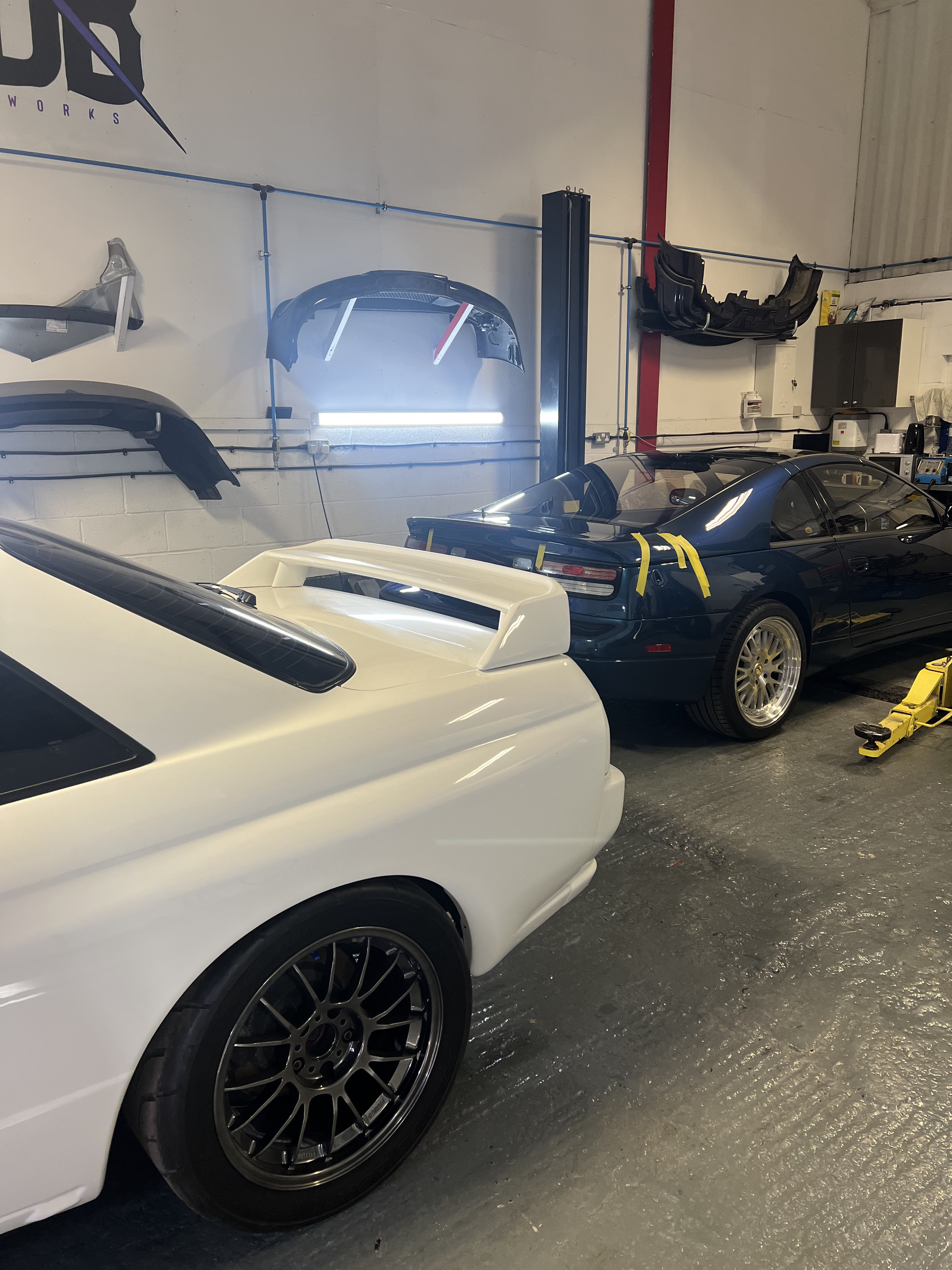

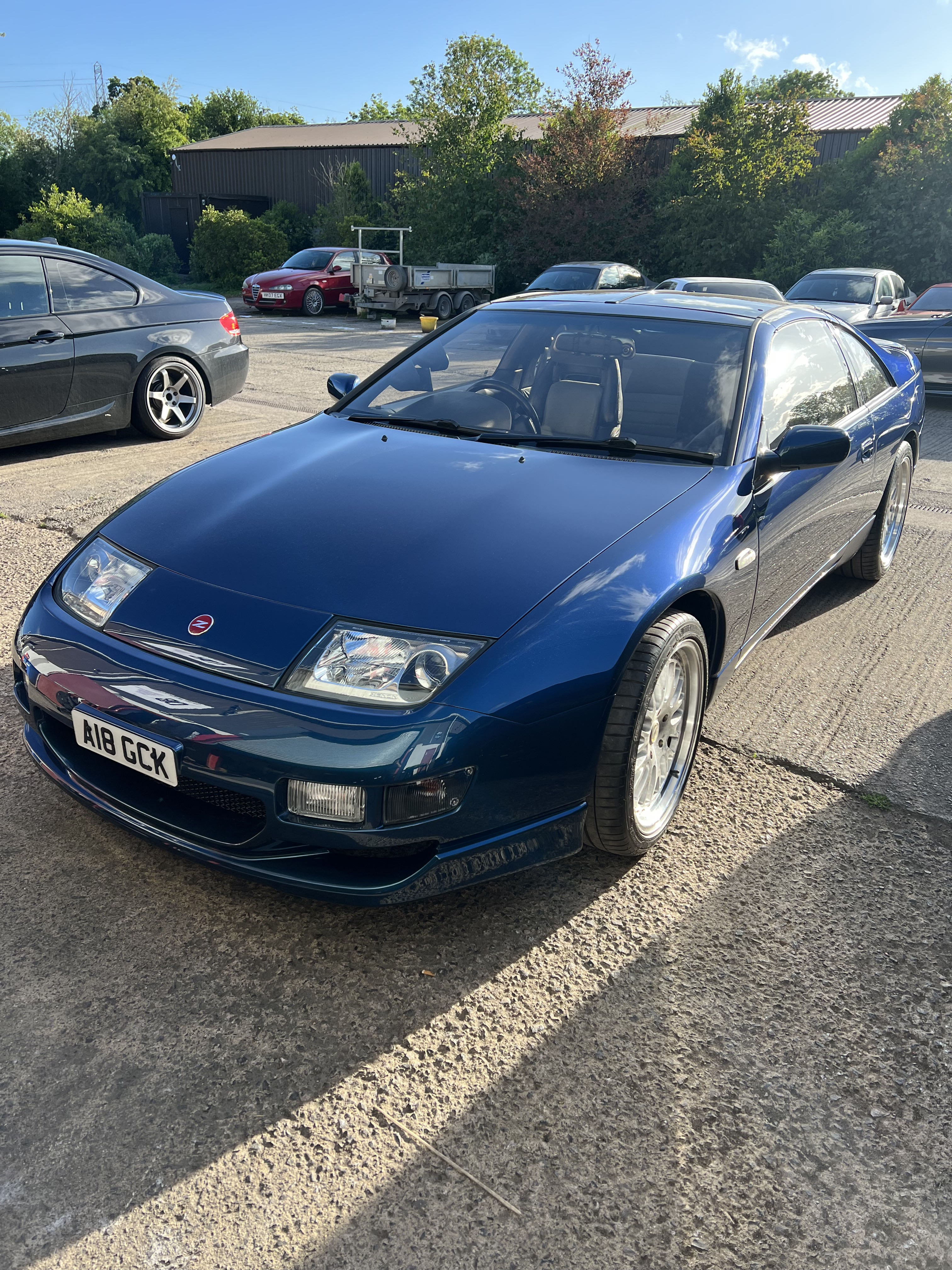

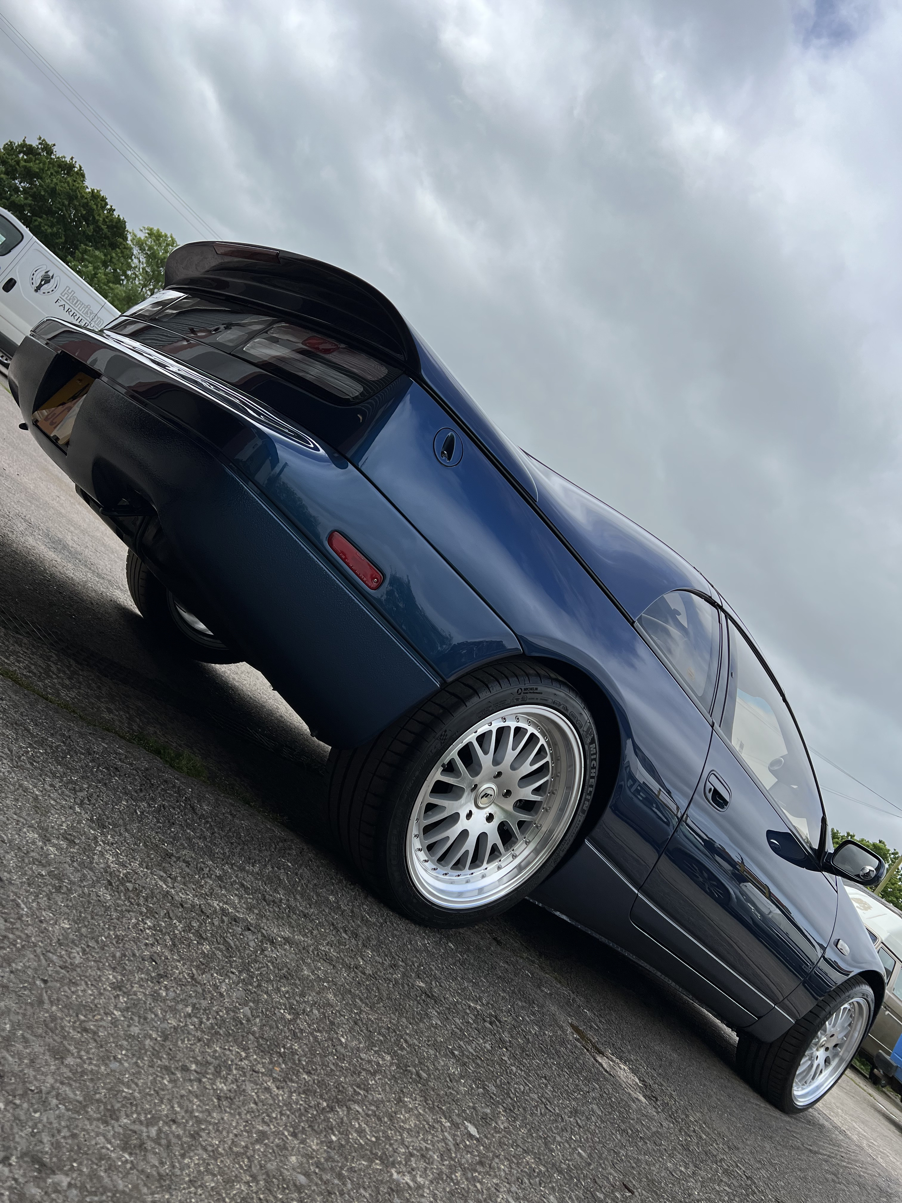

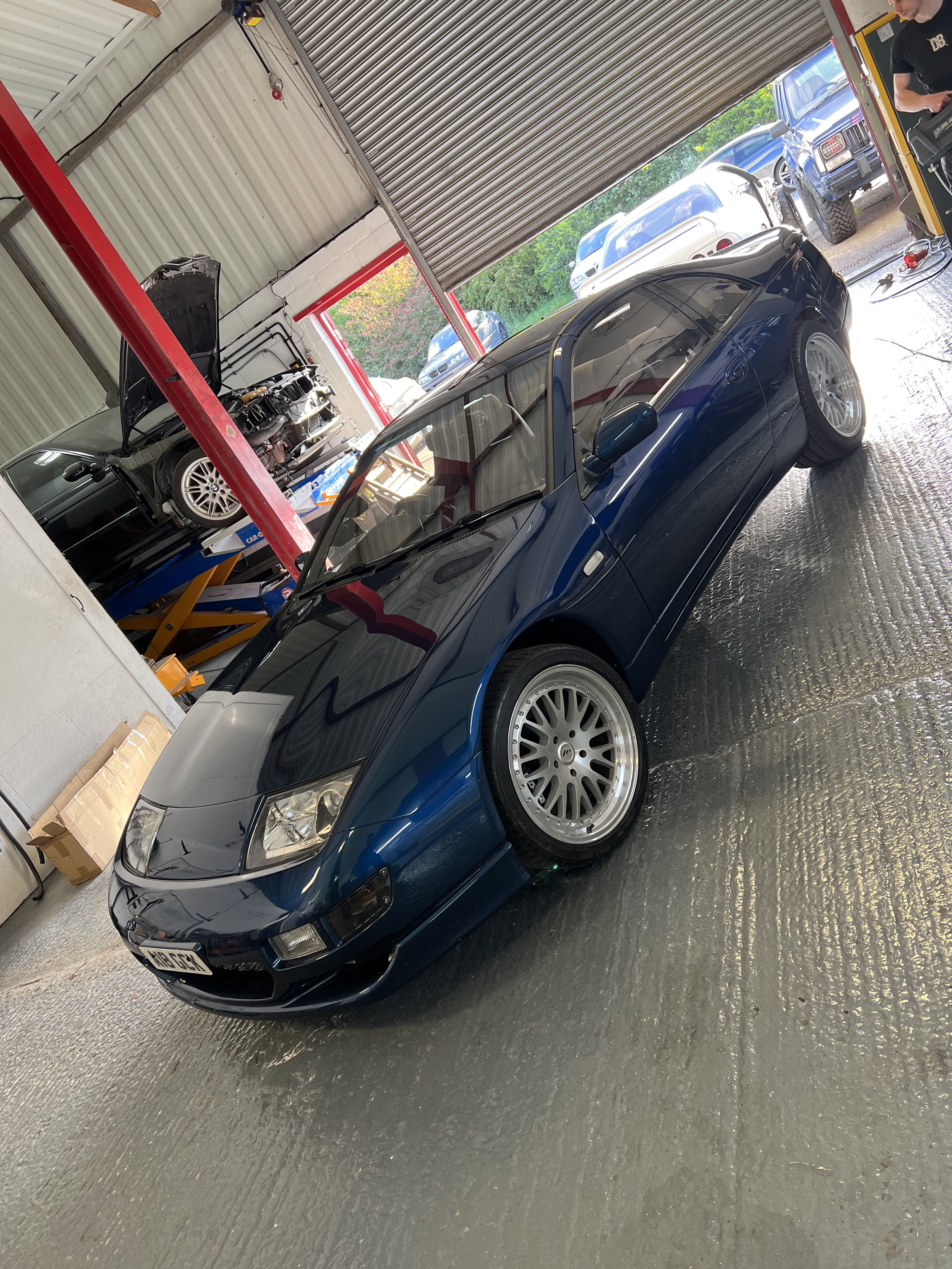

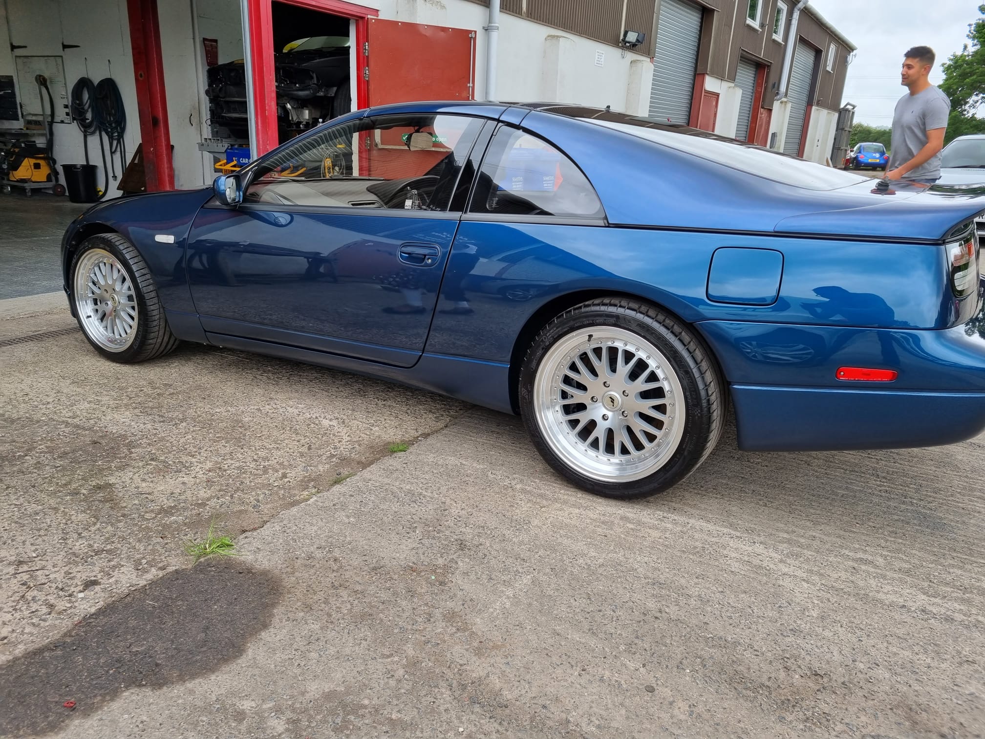

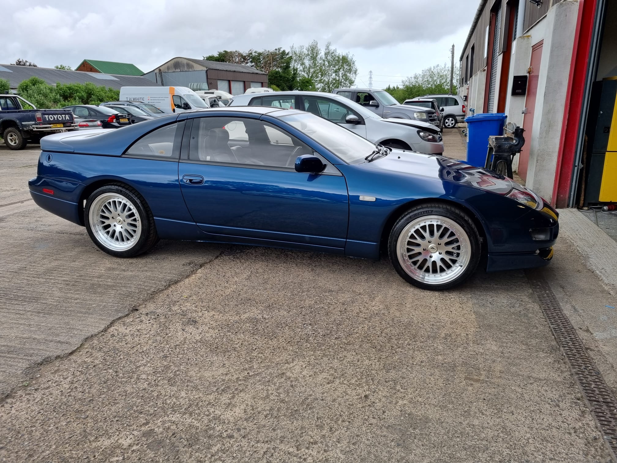

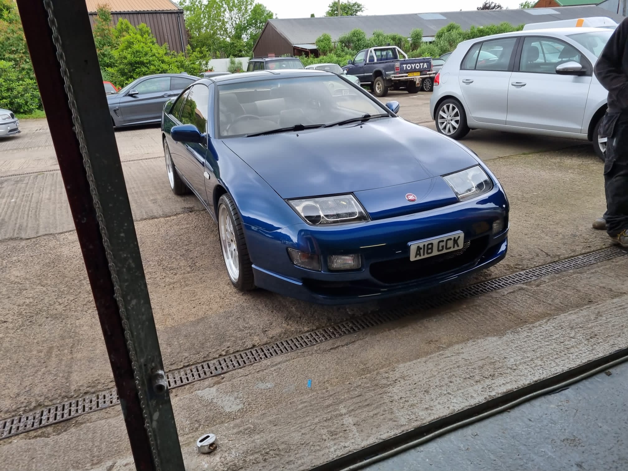

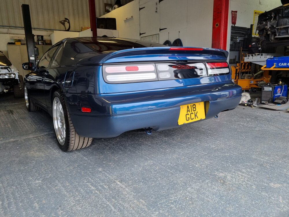

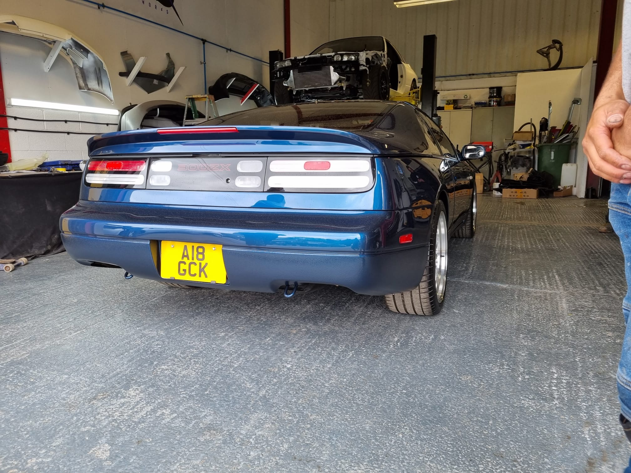

Set alarm for 5am ended up waking up at 4:30 from sheer excitement haha. Anil and his colleague are true old school craftsman, pay attention to every single detail, some details even the most picky of enthusiasts won't notice.
From the honest and transparent advice, to the regular updates, the understanding of how our cars are shaped and put together in the proper manner, I could not have asked for or imagined a better job. He genuinely suffers from OCD, which works out to be a huge benefit to the customer. He hasn't discounted the price or paid me to say kind words about them, I just feel true craftsman like them who are so rare to find, are worth all the credit they are due.
I congratulated them on achieving such a fantastic finish and thanked them for all the work they have put into my pride and joy. Highly, highly recommend them to anyone who is after the perfect finish. I made a lot of sacrifices to fund this work, but both me and the wife wouldn't think twice about the decision.
Had a good look at his Skyline, Chevy Nova and Civic track car he's had for around 15 years. Proper enthusiasts providing impeccable work for the like minded enthusiast!
If anyone wants any advice on using them, don't hesitate to ask.
I also made a table of all the body trims, clips, retainers and rubbers I bought with associated part numbers and quantities. I've passed this onto AdamD for his respray, but if anyone else wants this document, please ask and I will send to you.
Edited by Raja93

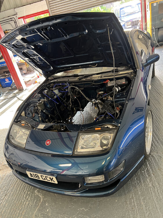

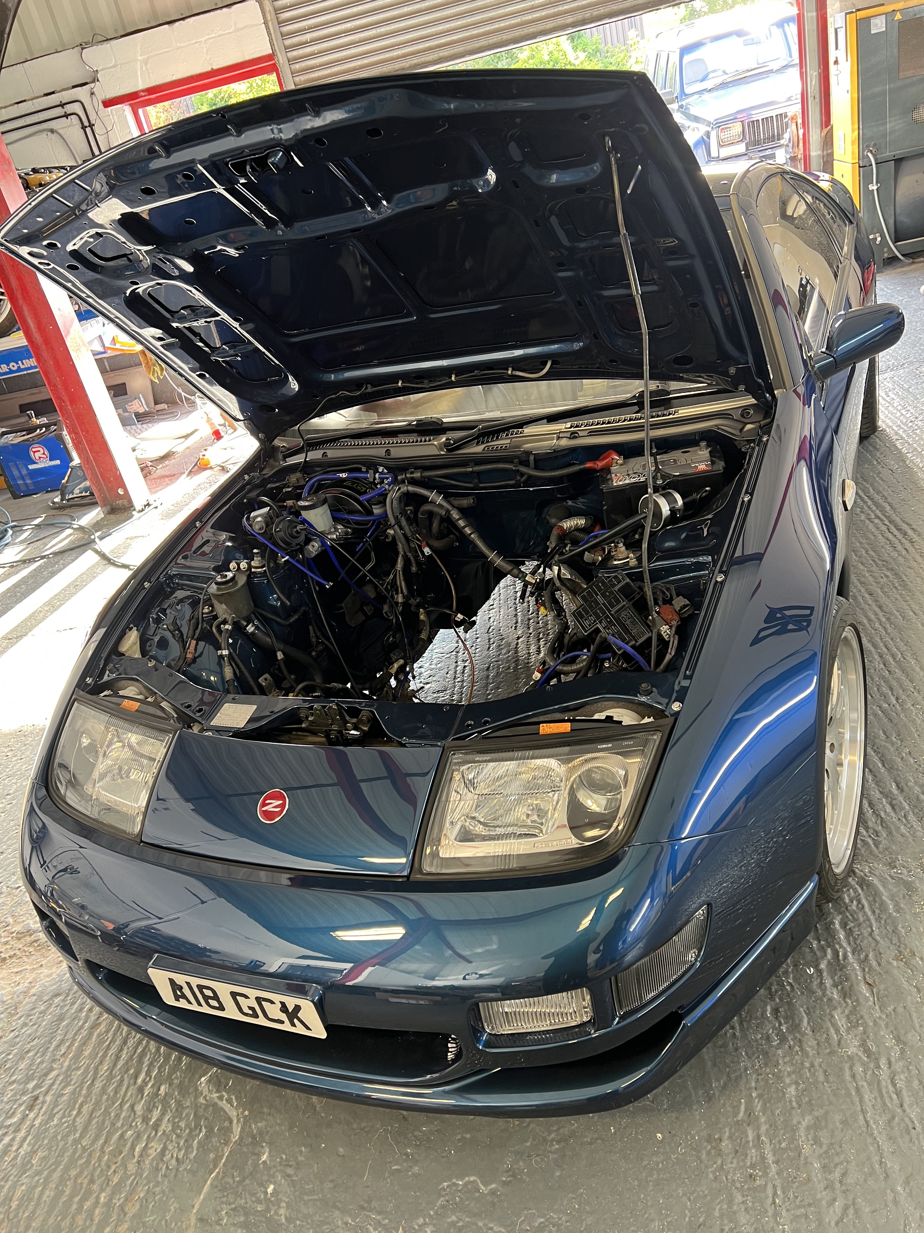

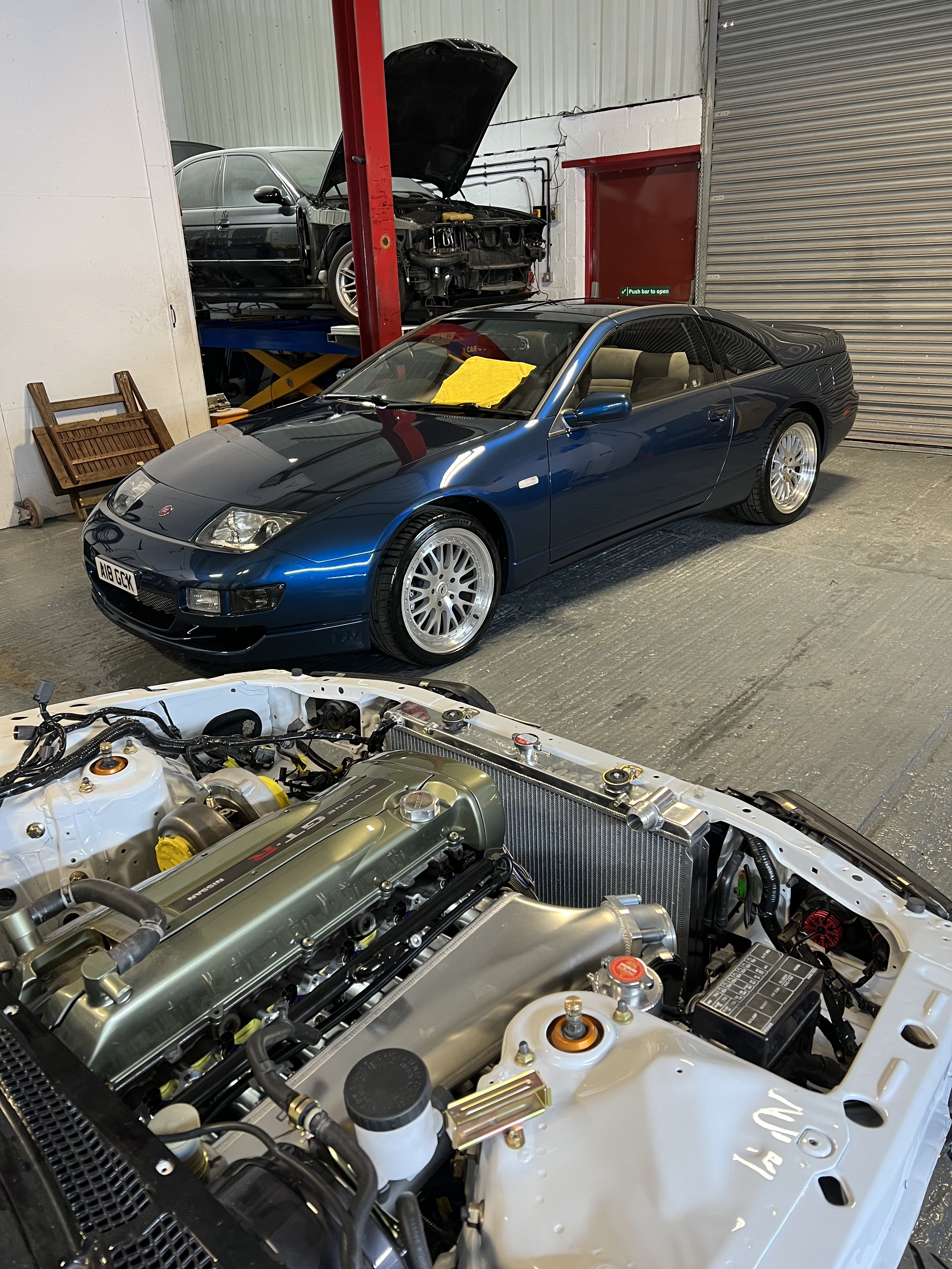

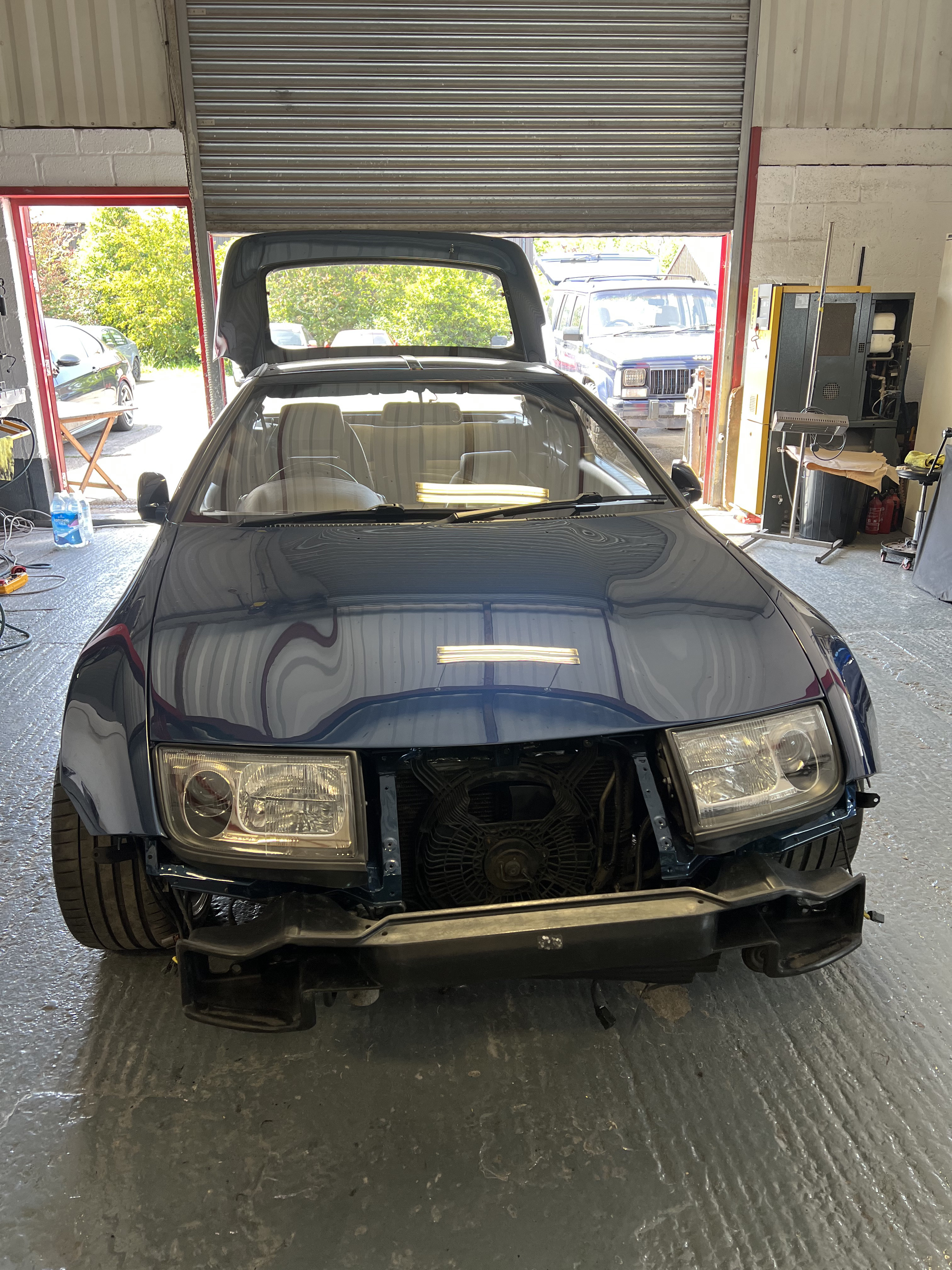

Few points to note. The front bumper hasn’t been fully bolted on as they want to make it easy for Jimmer to remove for the engine work. They still have to fit the new decals to the rear spoiler, fit the rear wiper arm and realign the rear number plate as it’s very slightly wonky. The rear quarter window trims I purchased the Kuruma Z replacements as you can’t purchase OEM 2+2 replacements without buying the whole quarter windows. Unfortunately they are a very dark shade almost black and did not match the OEM door trims so they kept the originals. They are going to apply a oil to the original one to darken it down to match the 2 year old nice door trims. The rear bumper as with a lot of Z bumpers has slight ripples as you get from sun damage. I didn’t mind this and opted to keep my original bumper rather than buy another used one which will have the same issue long term. They still stripped right back to the bare material and did the best they could with it. I was nervous about the spoiler choice but I’m very happy I went with it. I feel it compliments the Z boot perfectly, adds a nice curve to the otherwise very straight block like rear ended, which modernises it a touch to make it timeless - in my opinion of course. Appreciate the original spoiler for all its own merits also, just a personal preference. I’ve always like the CSL-R spoilers but prefer this one as it’s less curved.

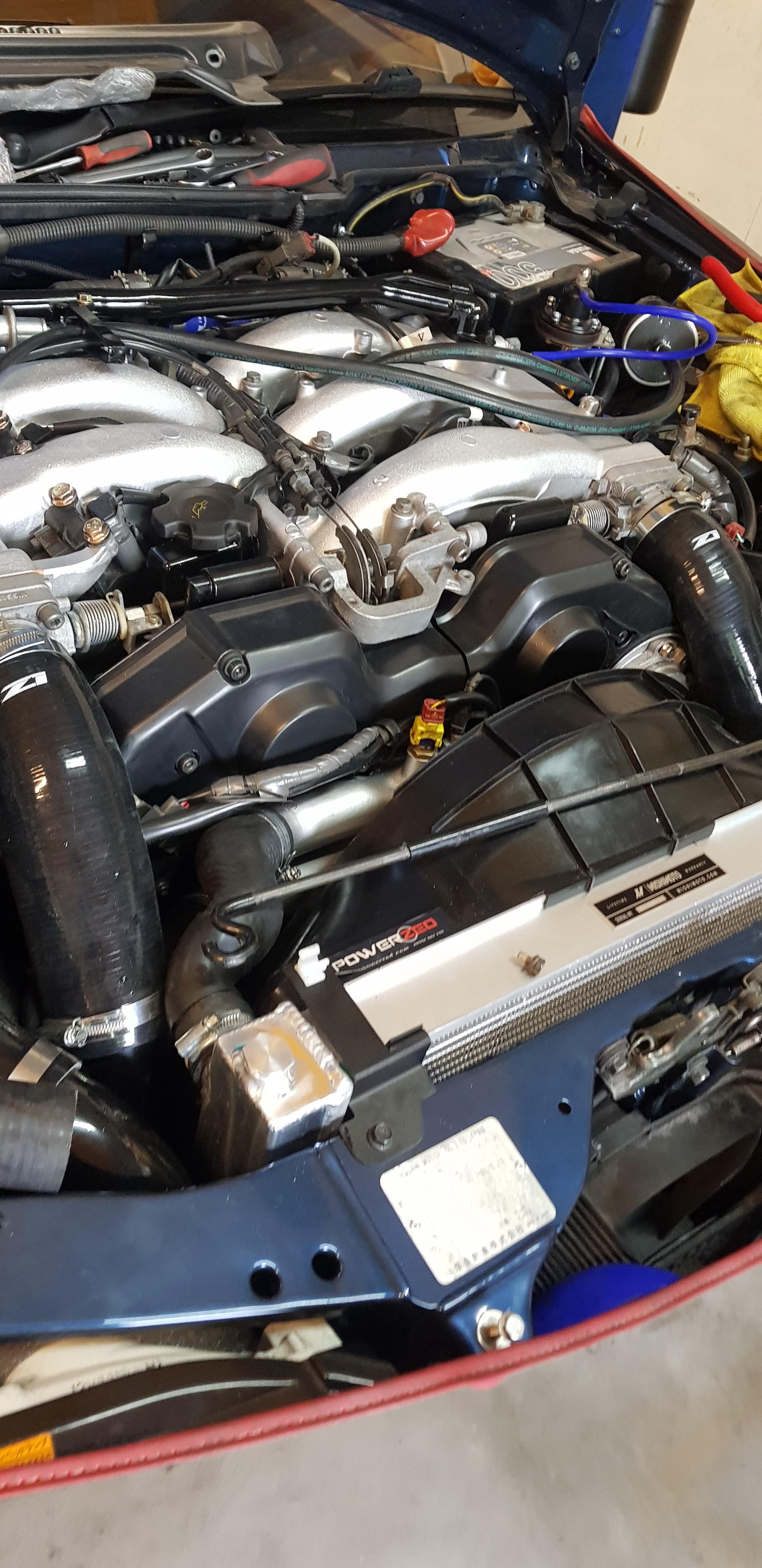

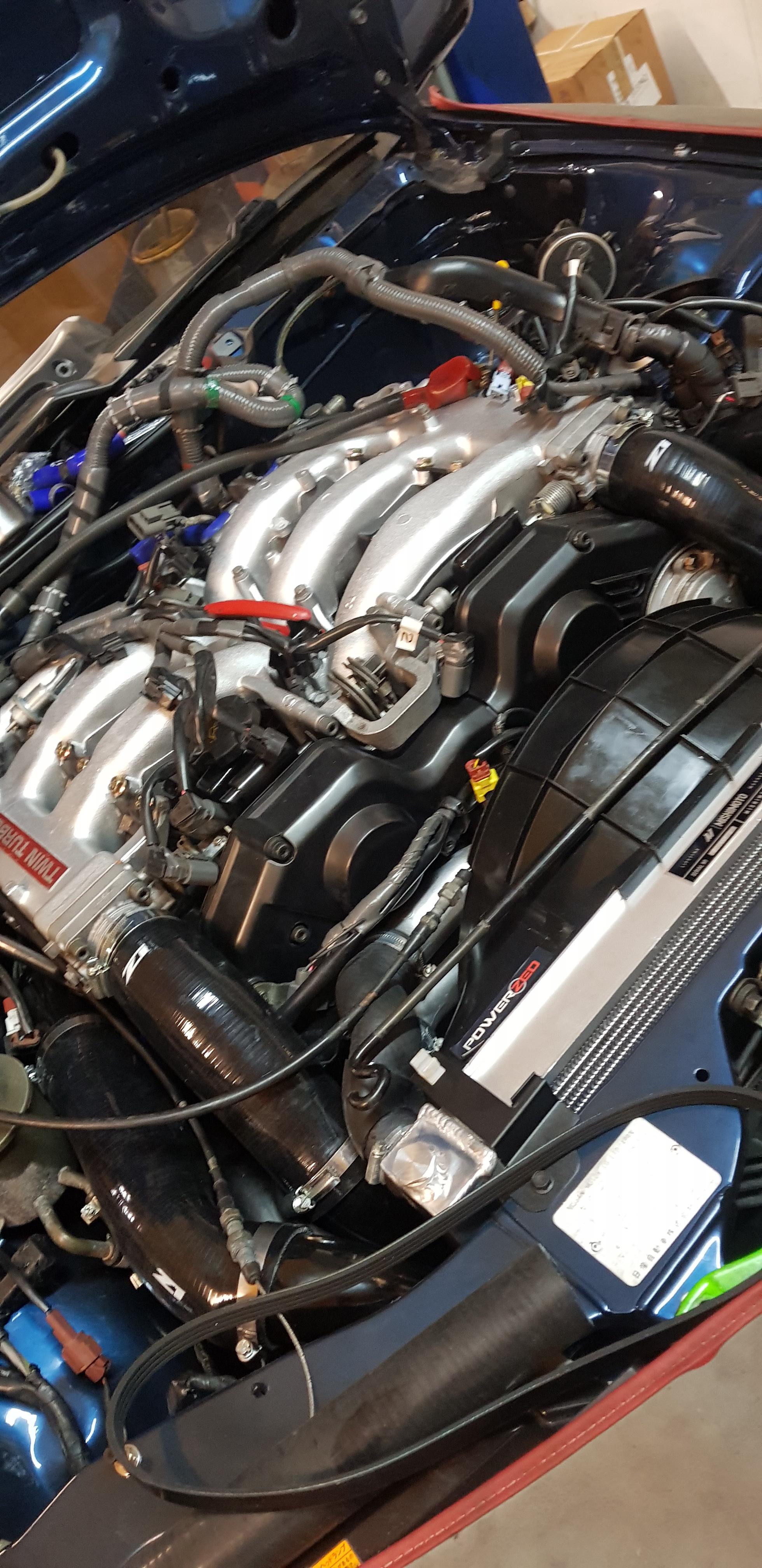

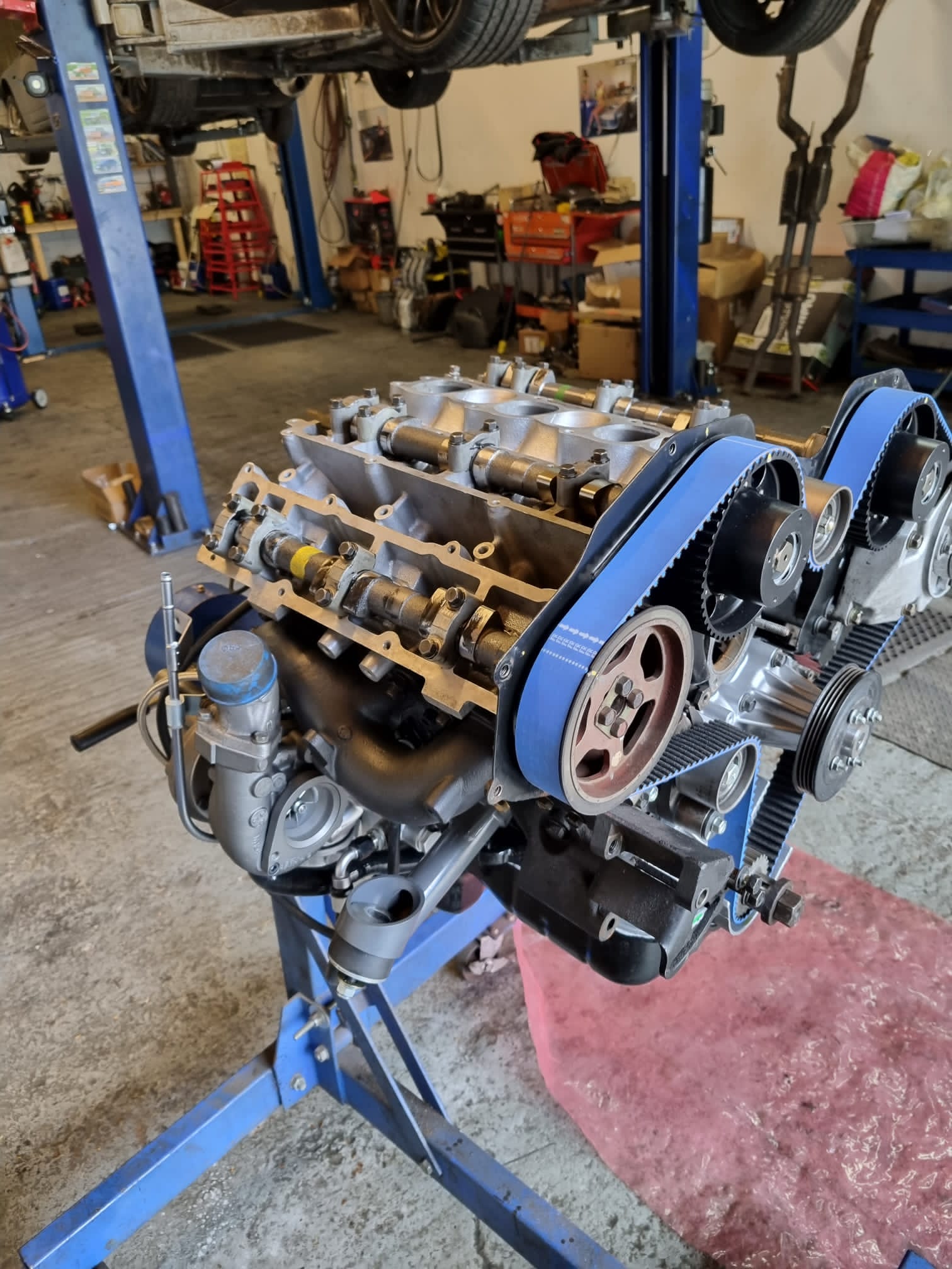

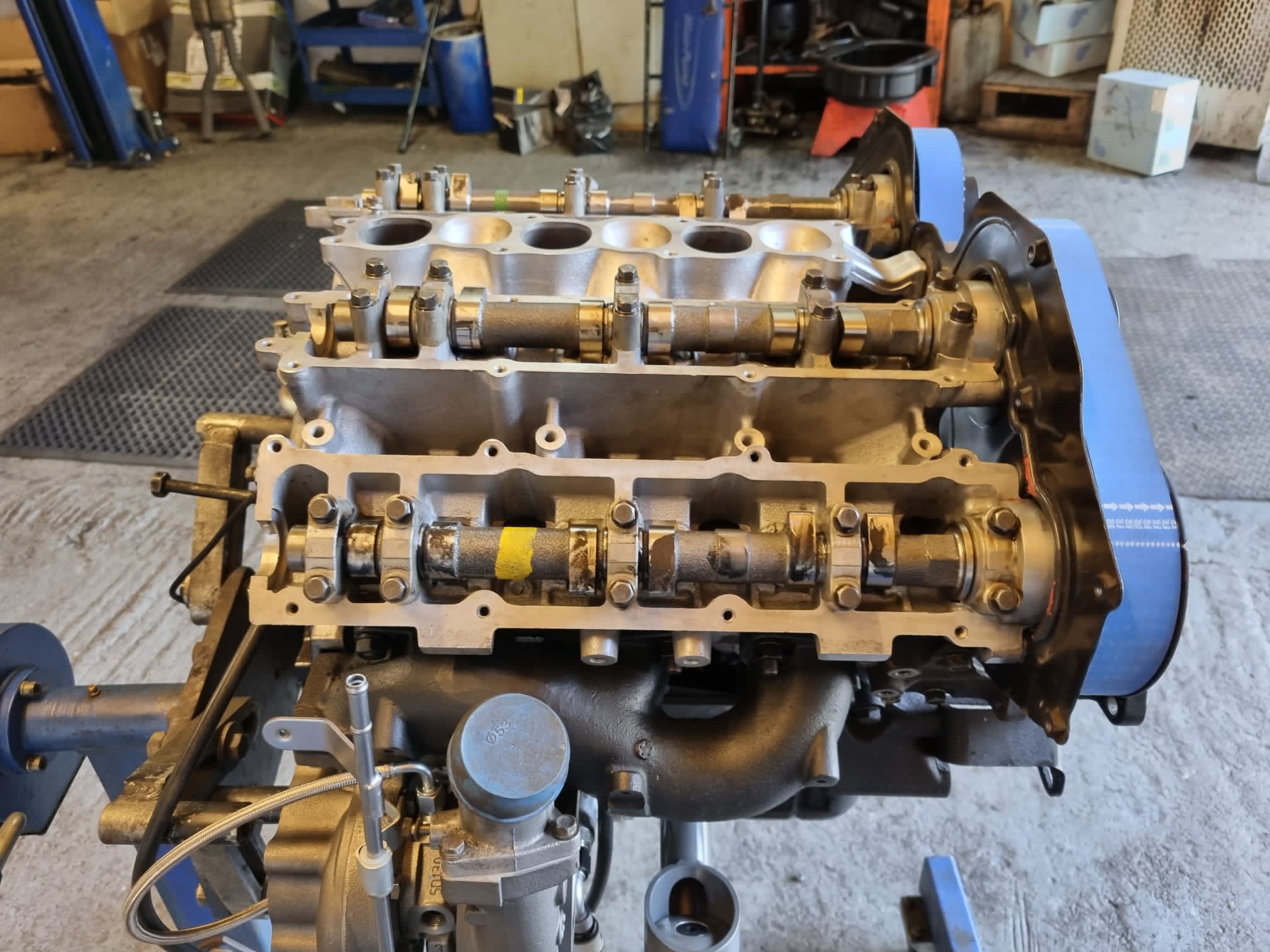

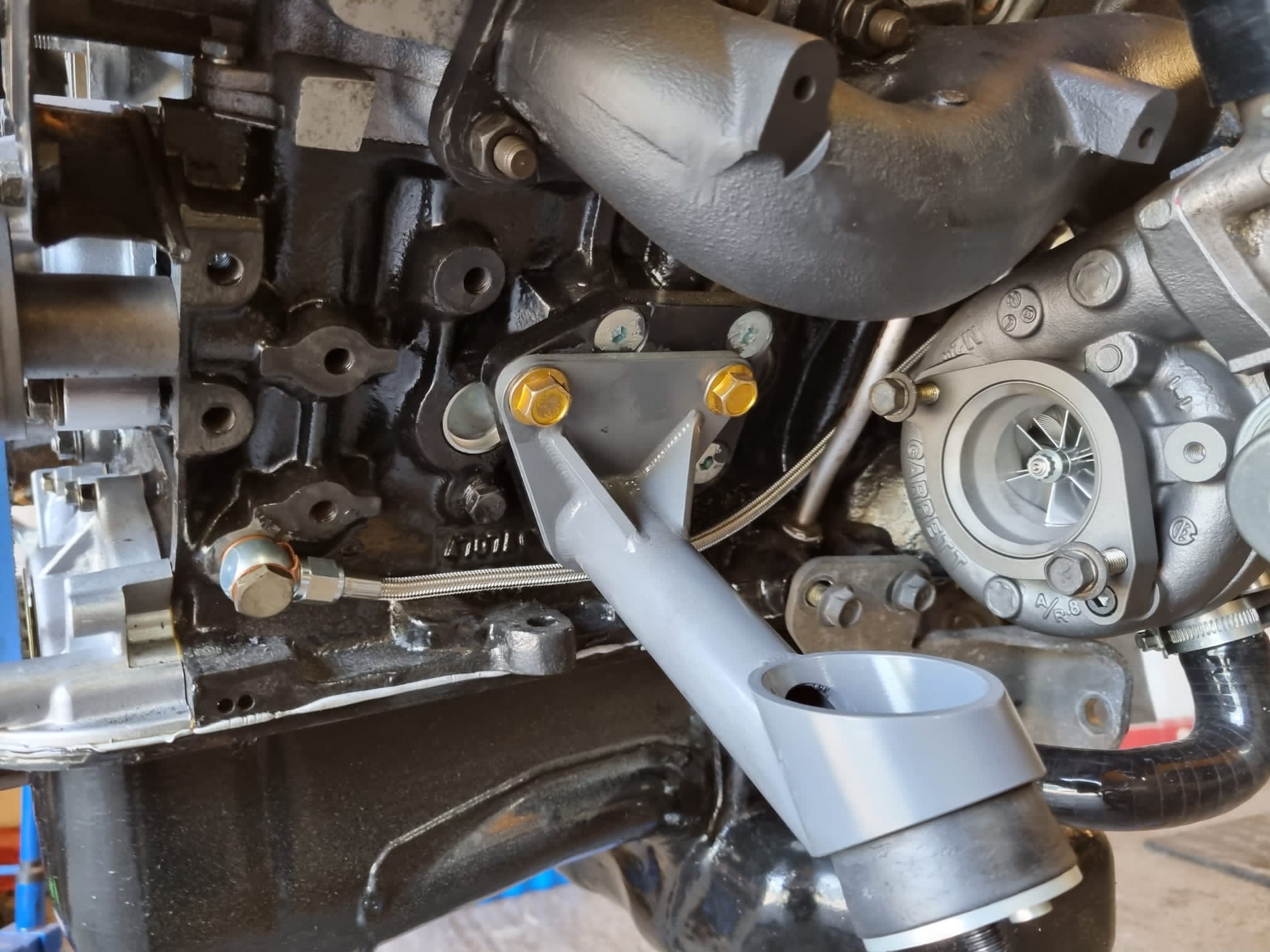

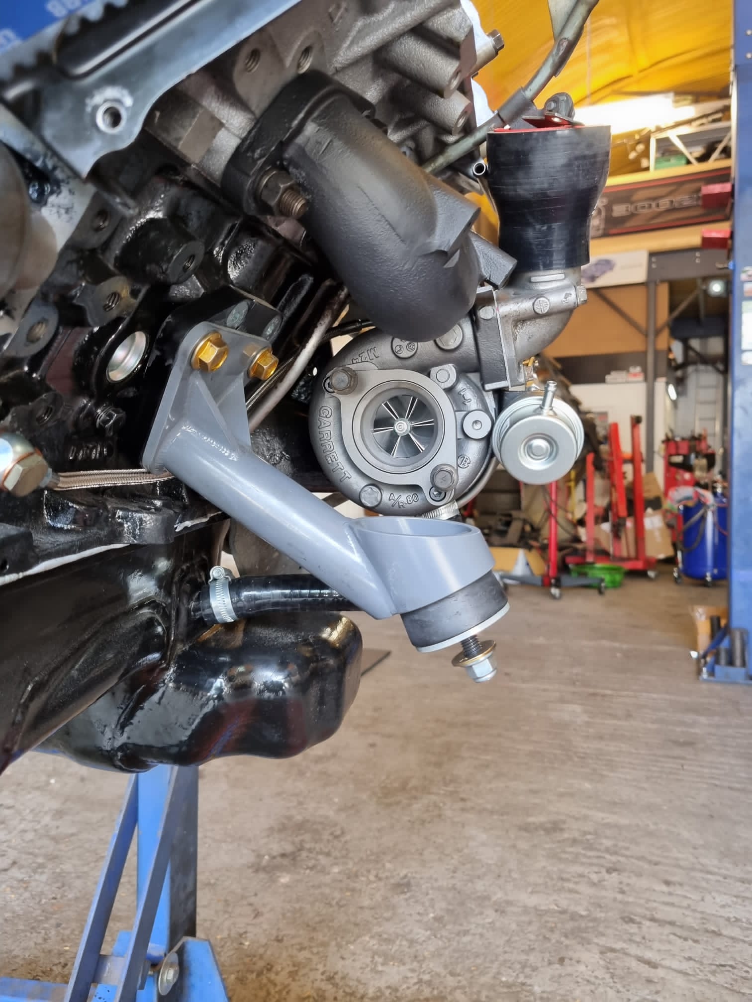

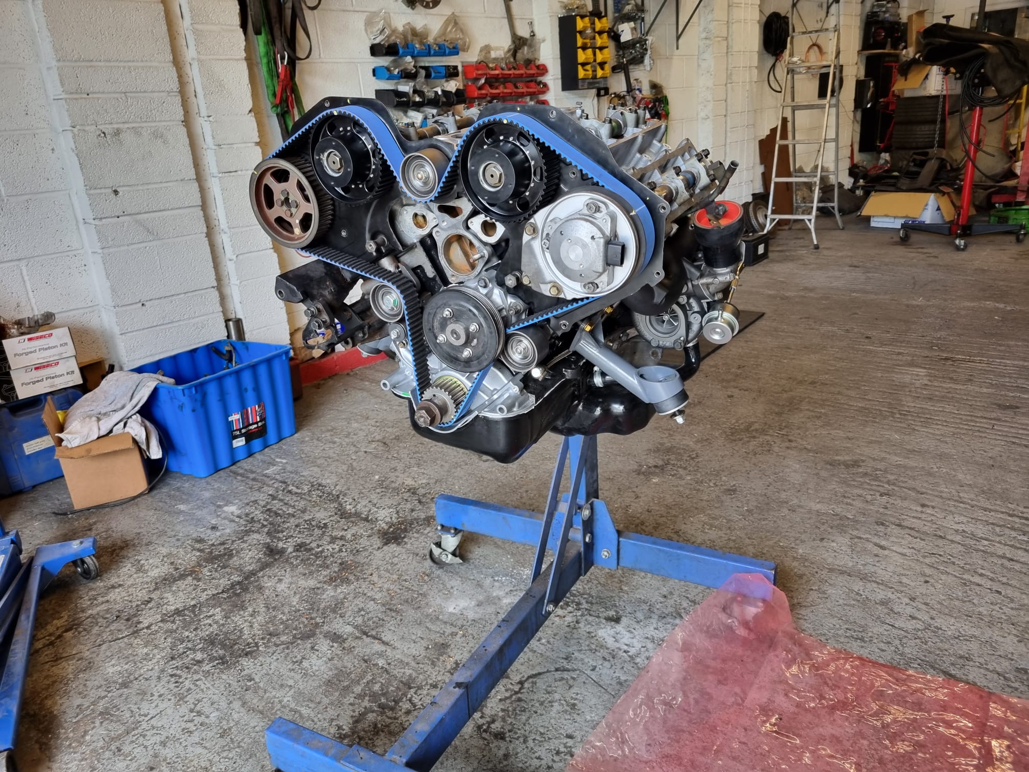

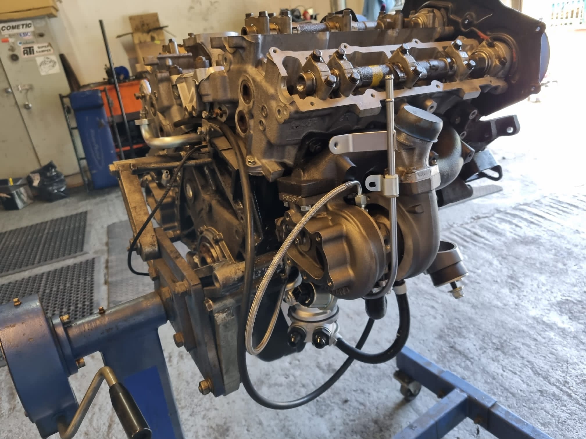

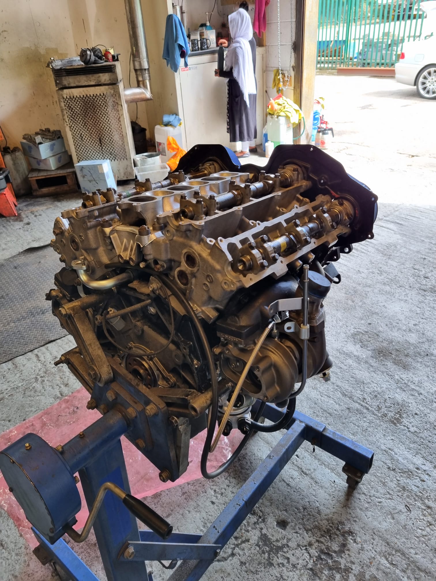

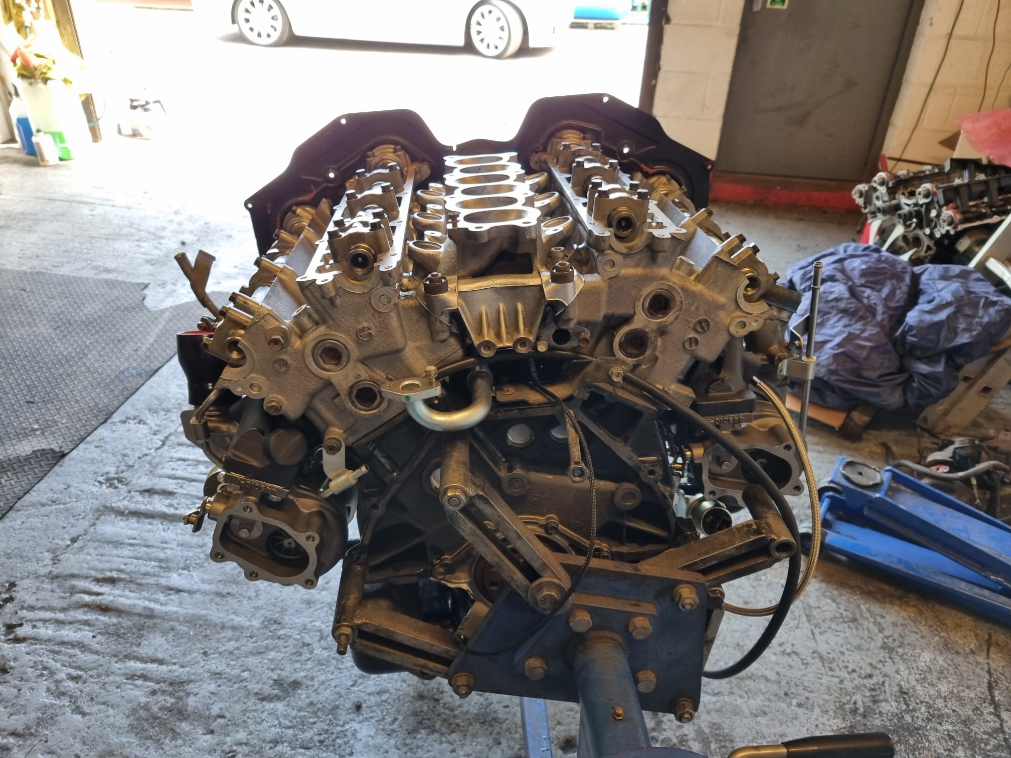

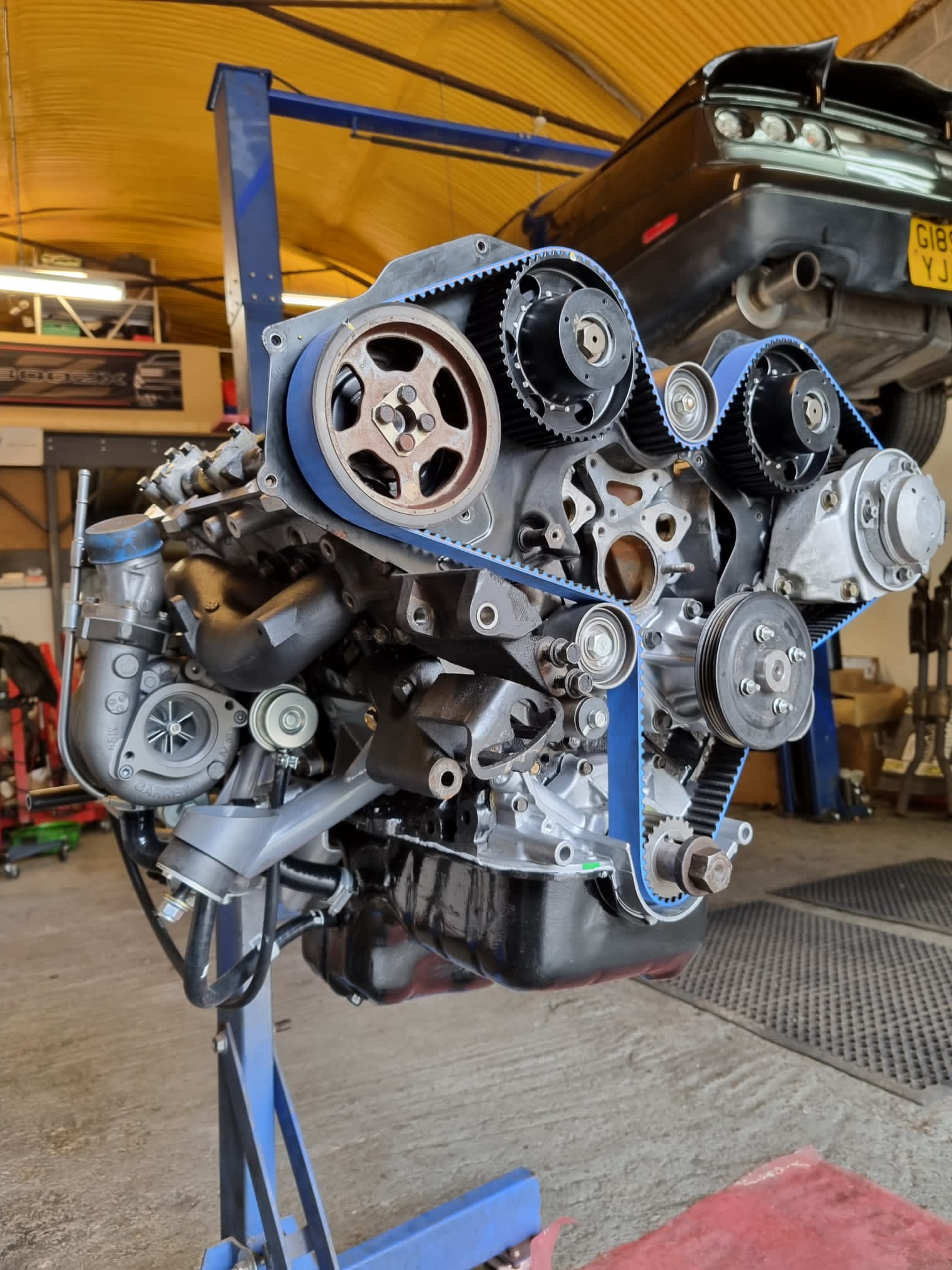

Popped in and saw Jimmer on the way back. Pleasant visit as always. Took a look at my newly built engine with all the new bits on - very exciting. He was telling me how some of his customer cars with high HP fare against some expensive super cars, which has got me even more excited. The traction control Greg Gush can install sounds absolutely fantastic and capable of putting down the high horsepower very well. The benefits of modern tech courtesy of the Link G4X and Greg’s magic!
02275c27-2a03-42c1-91e5-59ab3358a9d5.jpgef6ca2e9-463e-4a4c-a261-d08db8594f7a.jpg779455a9-47be-4719-be03-47c271ad1157.jpg328bb399-4644-494c-afc8-dbb240b81193.jpga4664f79-e68e-40f9-bb8b-f66c15ffed02.jpg19e871fc-ca93-46d6-b055-6bd35a8c348a.jpg002c2058-2915-4fb9-8885-93f3522a874f.jpg6aa85a68-aaa7-495c-af8c-895f4e239edd.jpga94a9130-fb08-426c-a3d4-4f1076be0e31.jpg
All looking fantastic mate!
You may have mentioned already, but what was the main issue that had caused the engine trouble, was there anything specific, or just wear and tear over the years?
A couple of the hydraulic lifters were getting stuck causing idle issues and compression issues as a result. We believe it was due to the oil pump slowly failing, due to age. By failing, it couldn’t provide sufficient oil pressure and oil to the heads, therefore starving the lifters of oil. This was a symptom of its way to failure. One of the turbos was seized as from memory one of the boost pipes was hanging off on one side, causing the opposite bank turbo to over boost, and seize. Compression was down on a good couple of the cylinders - I’m on my phone at the moment so difficult to scroll back and check, but I detailed the issues back in last September/October. I’ve got a photo of the old engine heads and they are squeaky, I mean squeaky clean, which backs up the amount of oil changes you and all the owners have done on this car. No sign of any darkness or varnish layers as you get with engines that have not been maintained.
No worries bud, oil pump is something we don't ever really think about on cars, water/coolant pumps usually get changed, but you tend to forget about the oil pump with it being away in the depths of the engine.

Thanks mate, appreciate it. Engine has pretty much had the usual PowerZed rebuild bits, probably similar to yours. Forged internals, AMS manifolds, Z1 B.A intercoolers, bigger intercooler pipework, 3" exhausts, turbos, better cams, 740cc's (already on there), higher flow fuel pump and some other bits n bobs.
Jimmer mentioned that to me haha - sounds like your Z is an animal. He also mentioned flooring it in a high BHP Z on a test road near Greg's, and although the car felt like it was trying to break loose a little, it never came unstuck from the road. In a normal Z, it would have flung out sideways when flooring it like that he says. Sounds absolutely fantastic, and will help in keeping up with modern cars TBH.
Safe to say it will be good for many a year once you have finished it ?
Exactly yeah, I never would have thought that was the underlying cause to it. Anyway yeah, glad its all sorted and will be for a long, long time ?

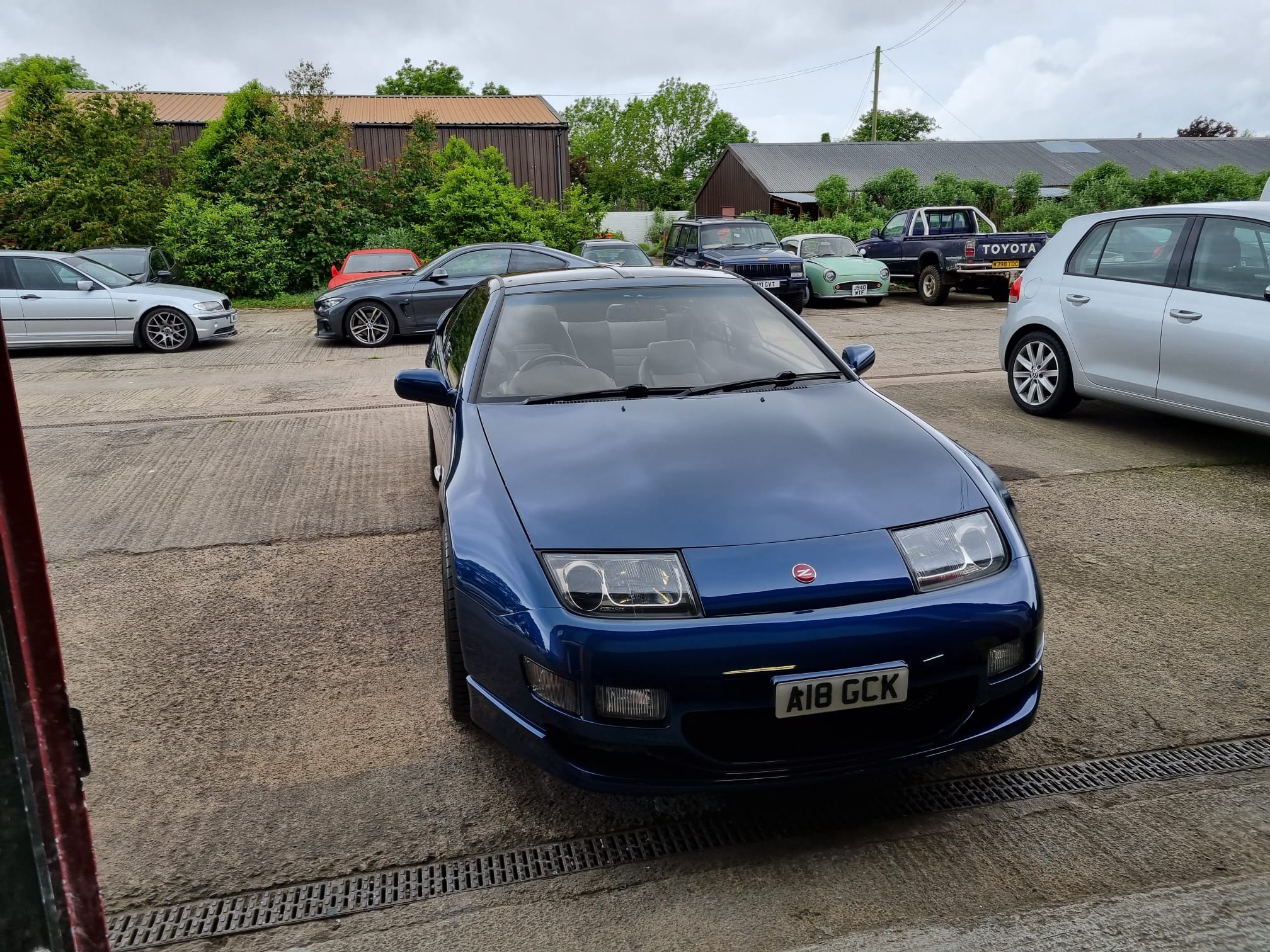

Another batch of photos he sent through, showing some of the detail and also some great angles captured - better than my pictures!

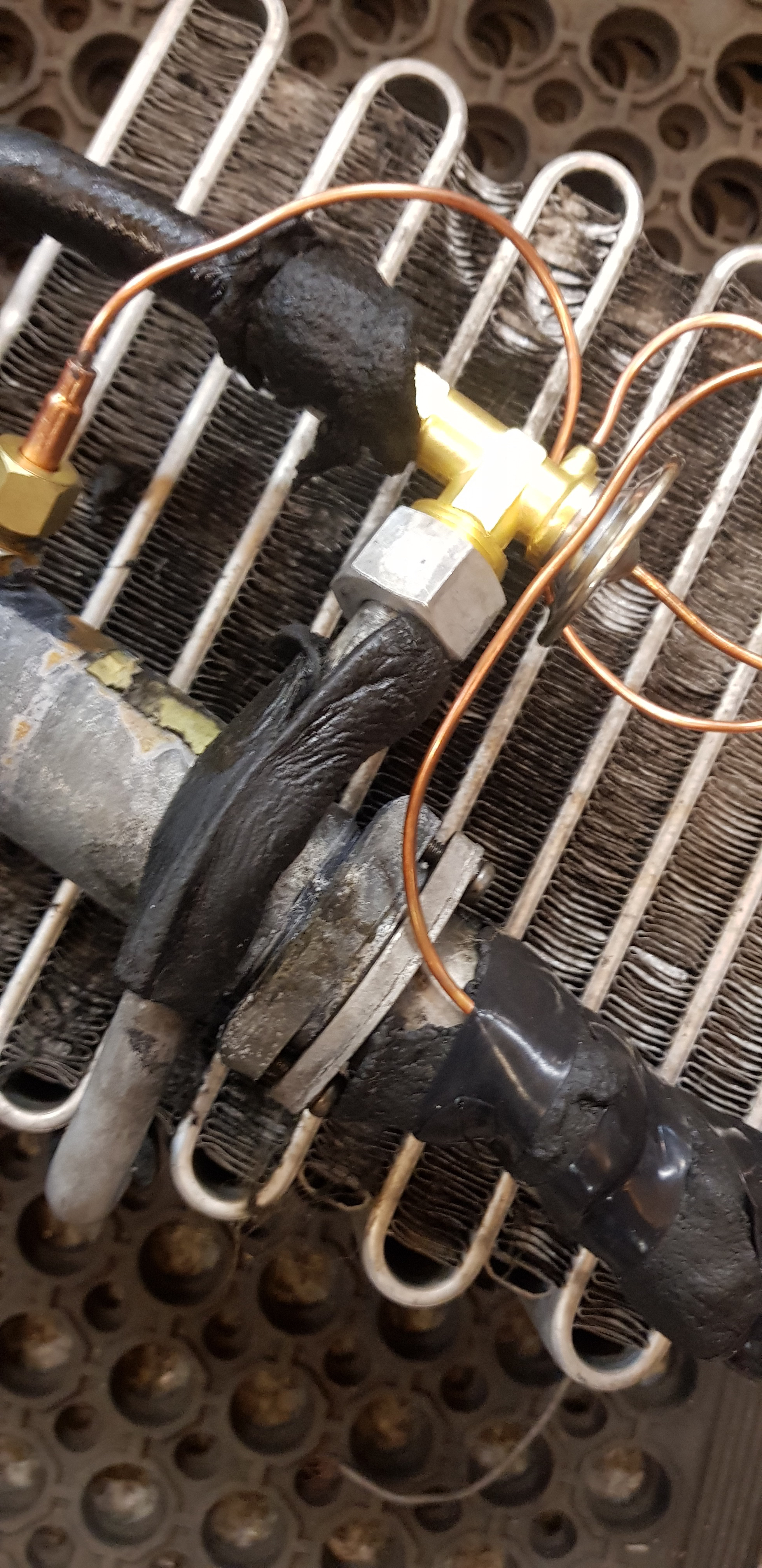

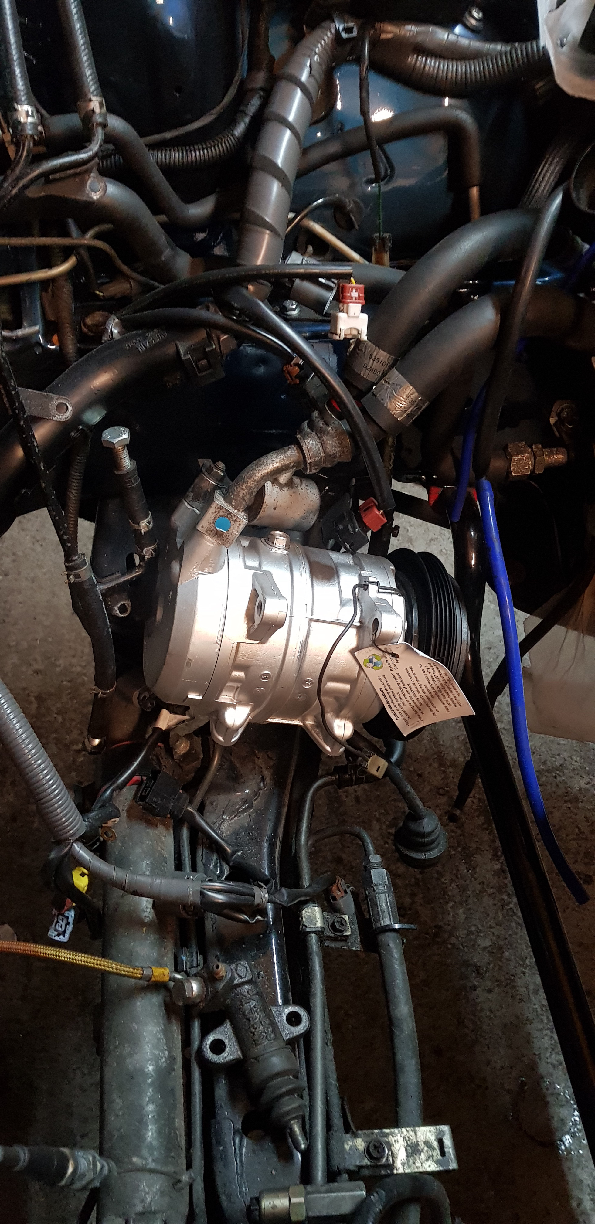

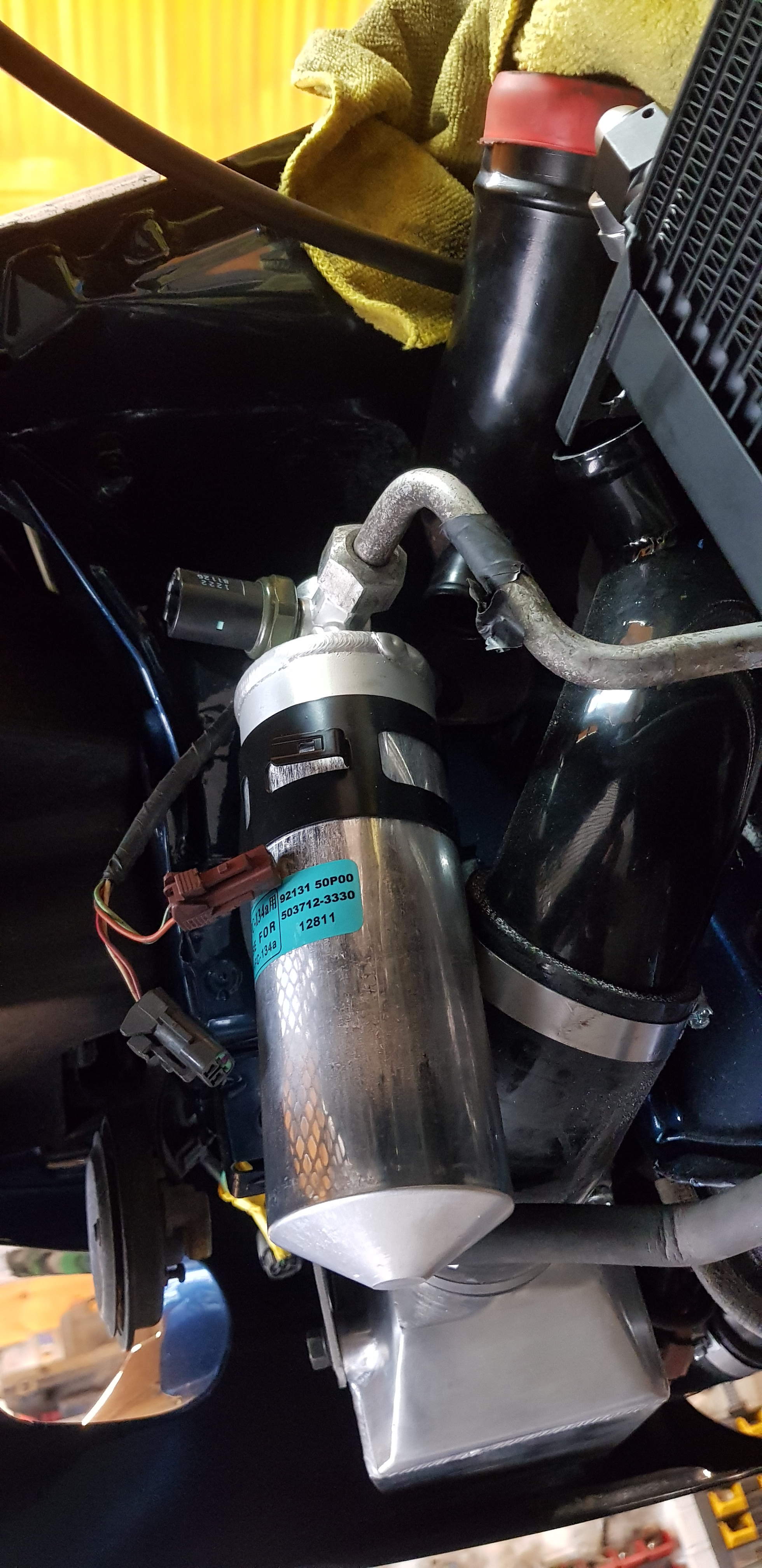

Engine is now in and running well reportedly! Forget the beastly power and fresh engine, one of the best jobs done is sorting out the AC [emoji7]. Expansion valve was at fault and replaced. Fully refurbished compressor fitted. Jims AC guy has been round and fully commissioned it - gone are the days of dreading traffic on a hot day, sitting in the green house like interior.
Greg is going to remotely put a base map on so she can be taken to get an MOT and run in by Jim, then off she goes to Greg towards the end of July.
In the mean time, trying to sort getting the whole front end covered in paint protection film and rest of the car ceramic coated.
Shame I won’t have her back for the best part of summer but ah well, should have back for mid August, so not too long now.

Loving the freshly painted plenum, balance bar, valve covers and some new hardware/bolts. Just what the engine bay needed.
