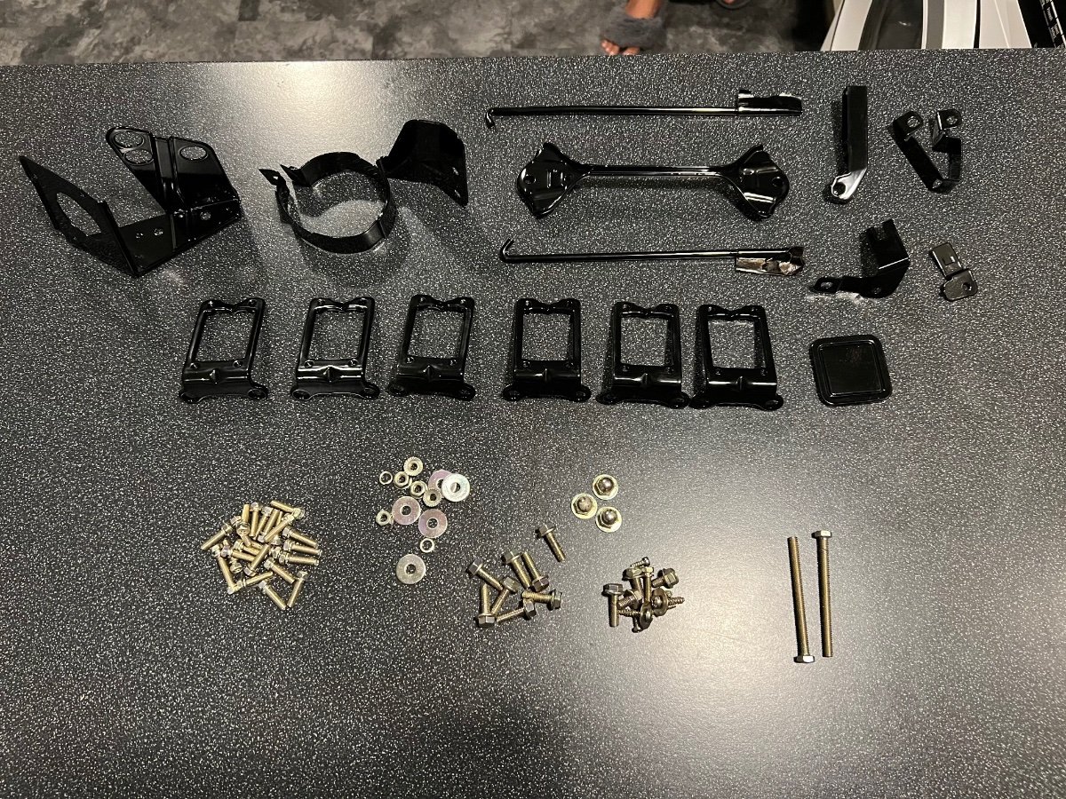

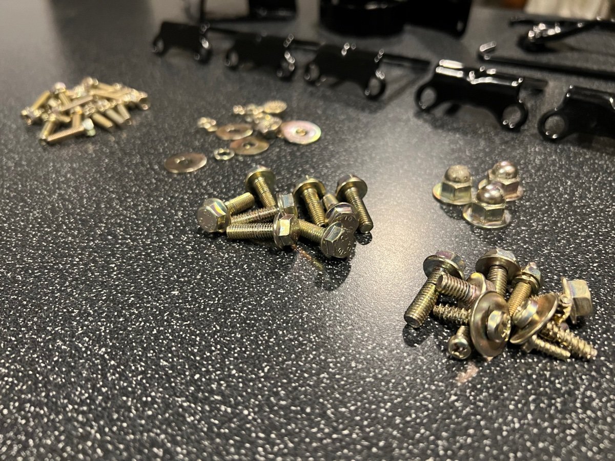

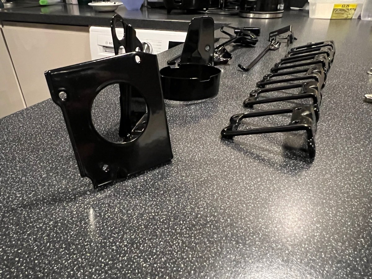

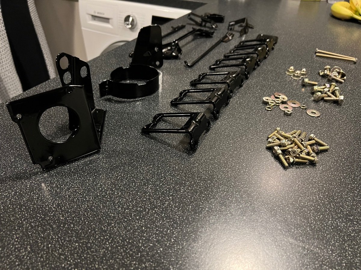

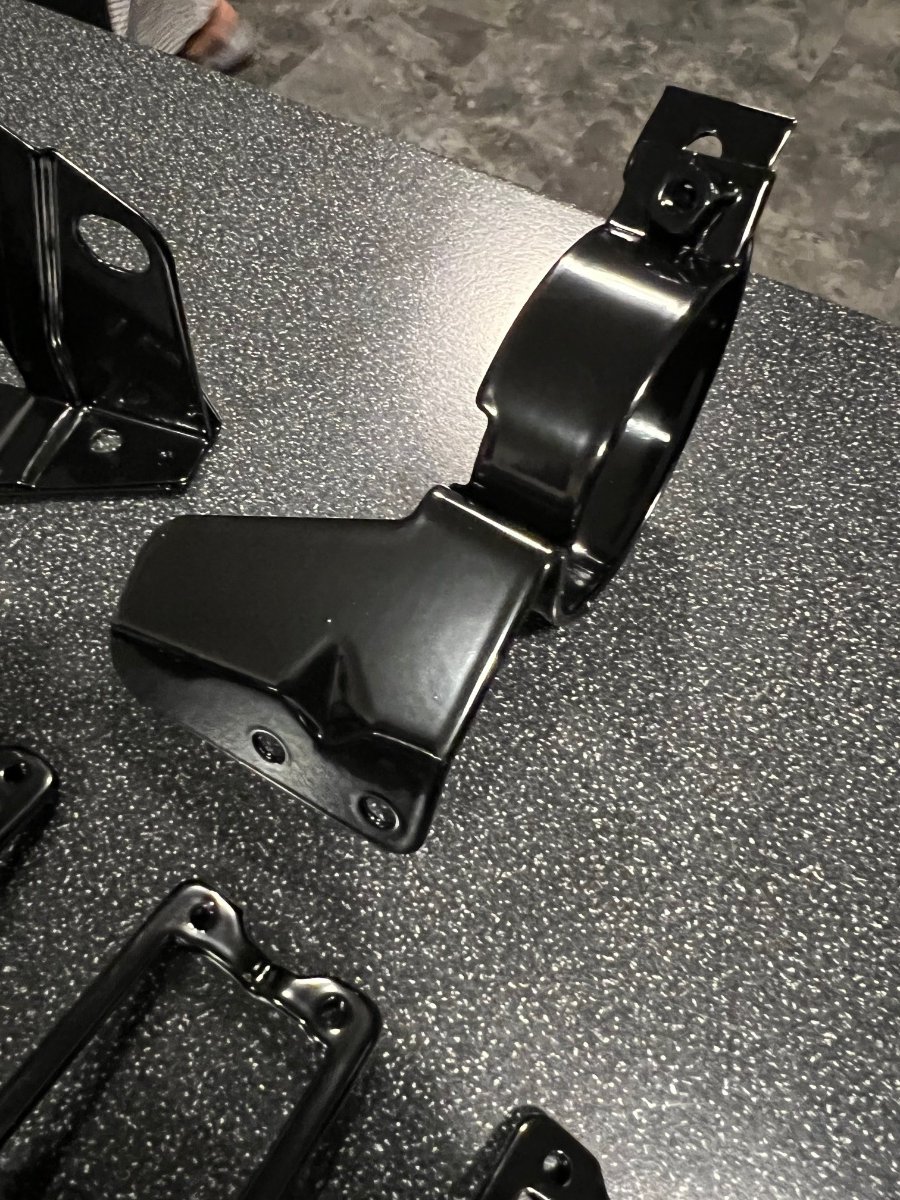

  • I get more excited about this type of stuff, than the big works like the engine build.  Both the metal platers and powdercoaters turned it around quicker than quoted, and at great prices, so very

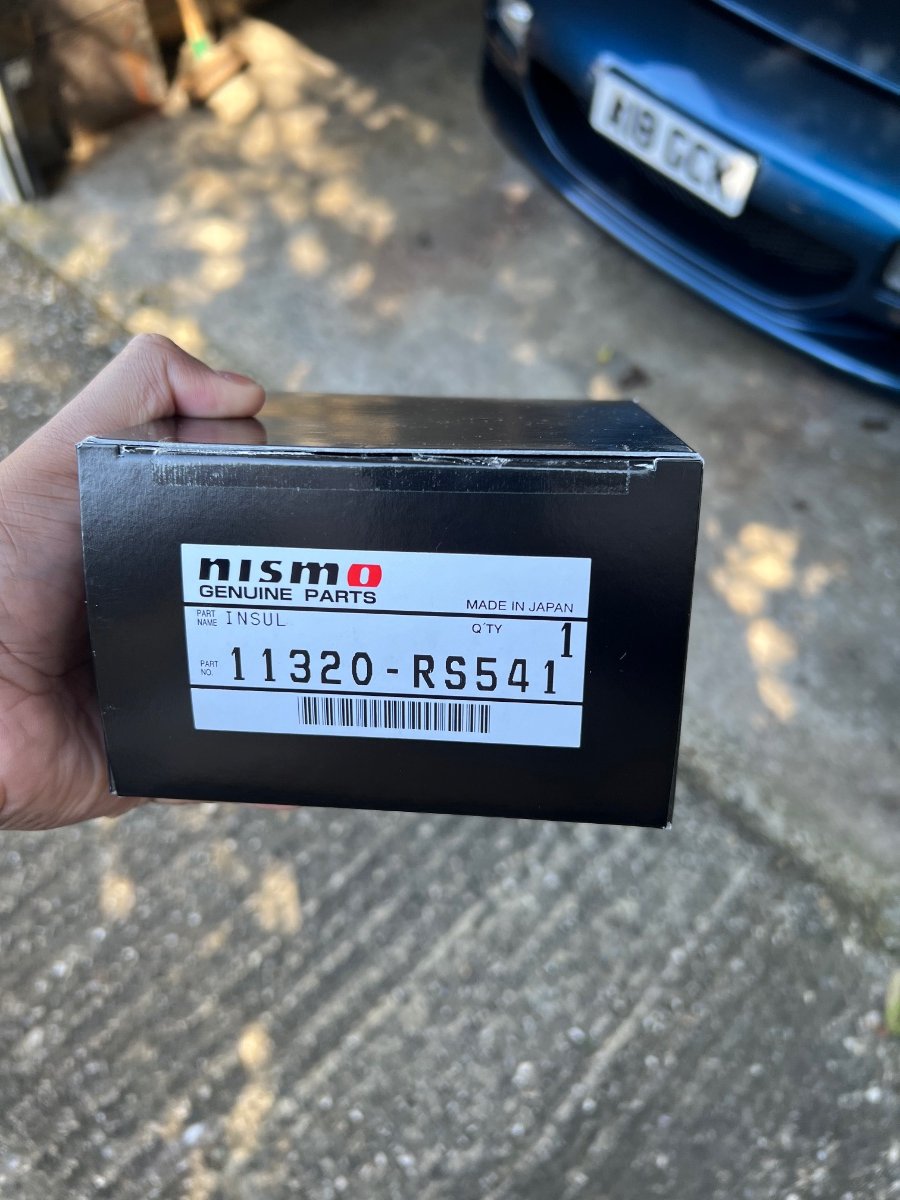

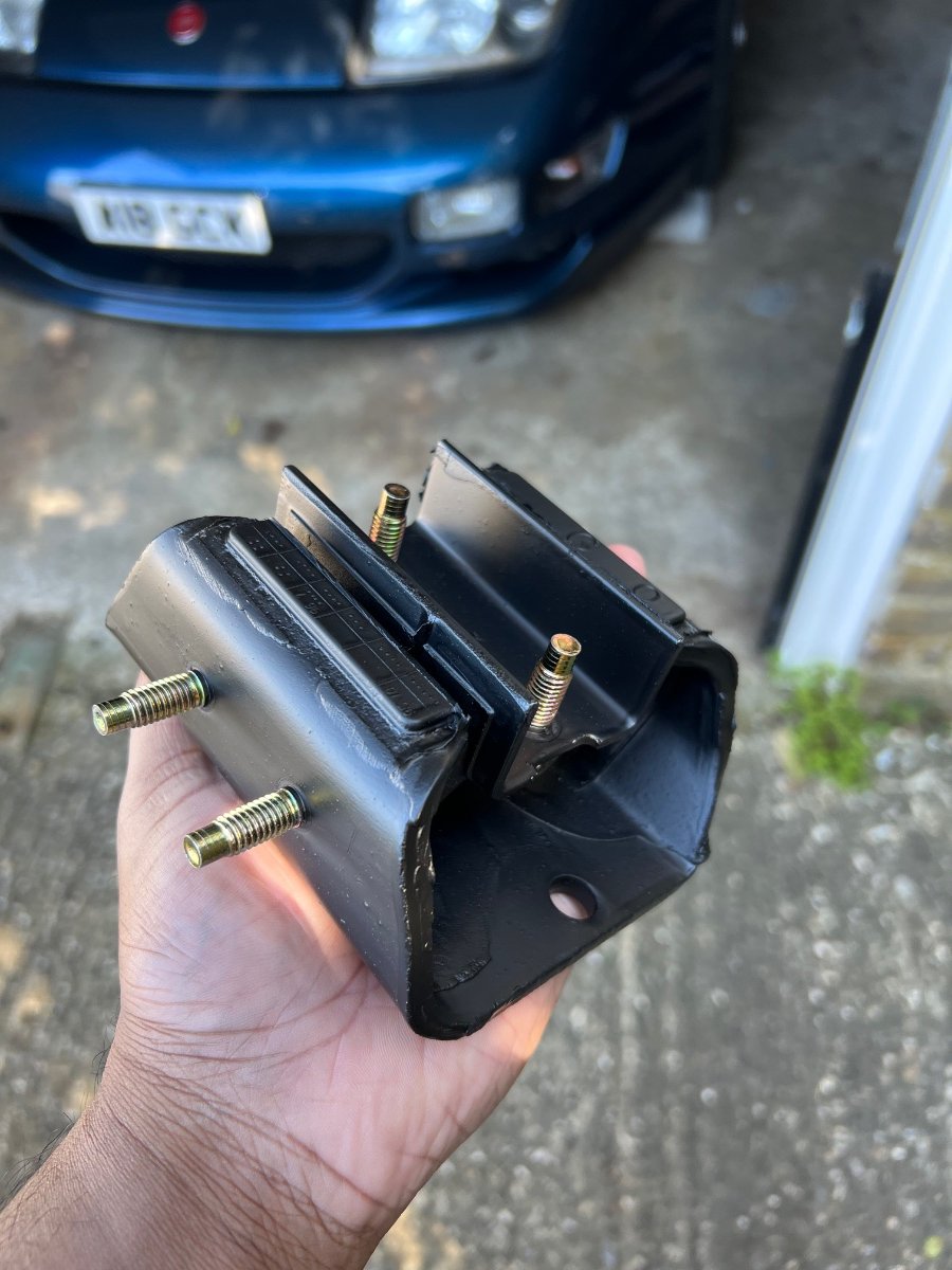

As mentioned earlier in the thread, I went OTT with getting both the BDE engine mounts and transmission mount. At idle the car vibrates too much, which although I don’t mind too much, I’d prefer it back the way it was. I used to have a Nismo transmission mount which had been on the car since before my ownership. Sold that to Lexx thinking I’ll never need it again - Doh! Sourced a shiny new replacement now from Amayama so all good.
8ED6C83E-CE05-432B-902C-297F1CBE86FE.thumb.jpeg.cc6af3b9314cb7611a6fb9cb41f1922c.jpeg2812DBB7-C35A-4630-8518-A5B74971E2CB.thumb.jpeg.2614606edd6882f583c41c05e4419504.jpeg
I haven’t brought the Z out since very early November. Once I get the tinware and bolts back, I will put it all back together and get her out and down to Jimmer for an oil change, general check over and swap out this transmission mount. Fingers crossed a nice summer to look forward to 😎.

Nice work mate. Zinc hardware does look nice.

Both the metal platers and powdercoaters turned it around quicker than quoted, and at great prices, so very happy.
Oh so shiny 😍….

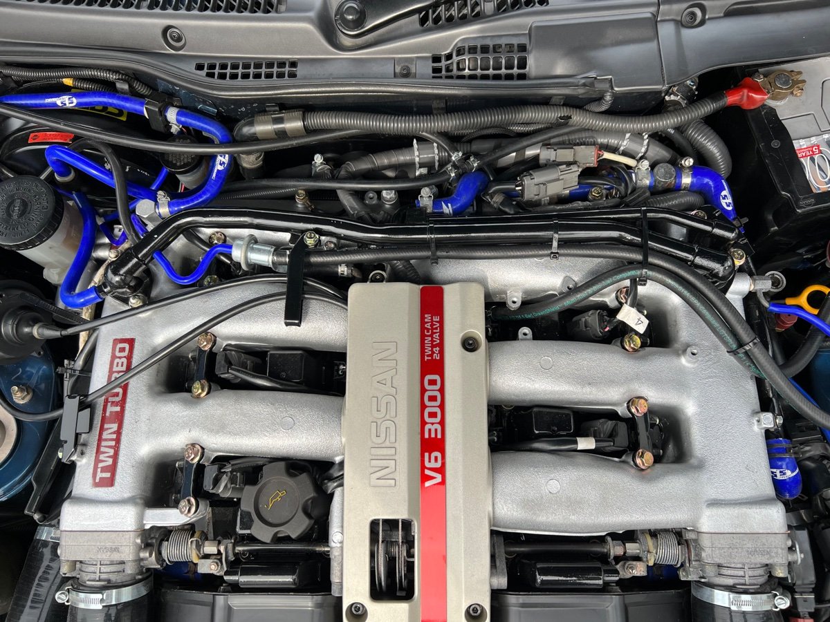

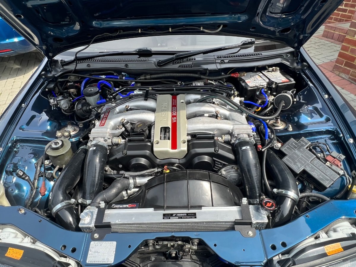

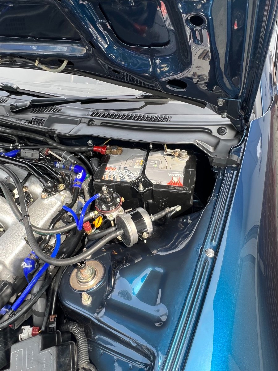

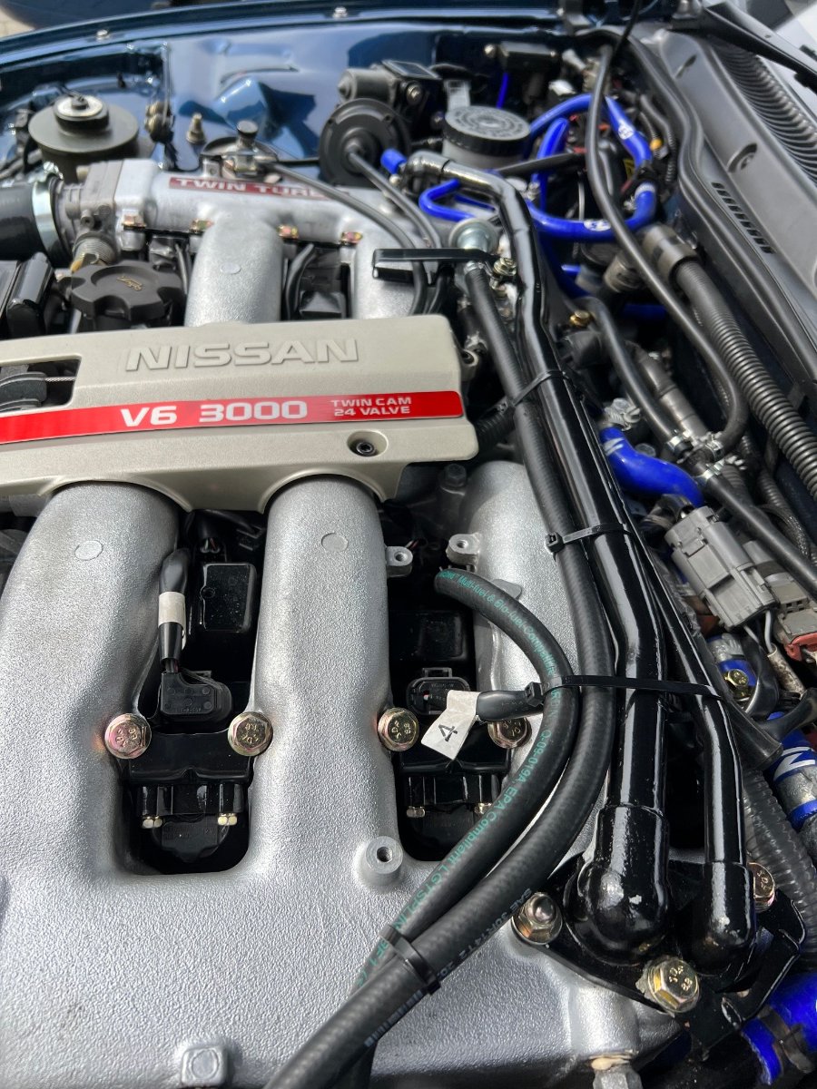

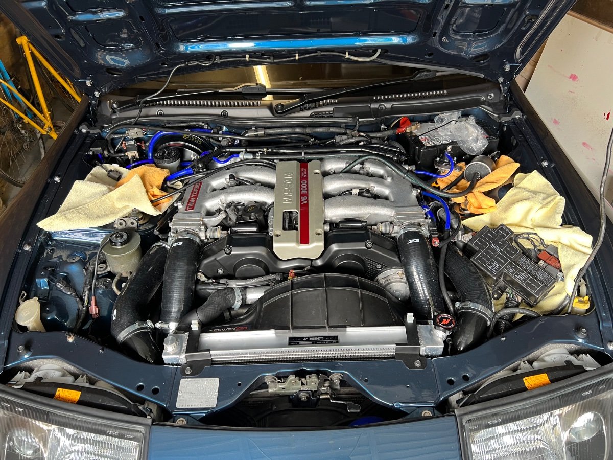

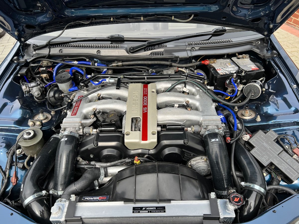

Finished putting the engine bay back together this morning and got out on the road. Went straight to Shell and filled up with V power and pumped tyres up. Bought one of those fancy Ctek battery chargers which reconditioned it and fully charged before I got her out. Started right up trouble free. Few pics of the engine bay below. Hard to appreciate the new powder coated bits and zinc coated bolts without seeing it in person.
Driving it was absolutely glorious. Forgot the attention this thing gets - within a few hours had 3 different people talking to me about it!
God Dam I missed driving the beast 😍.
Going down to Jimmers in May for an oil change, swap transmission mount to a Nismo one, replace the power steering J hose as I noticed that’s cracking at the bottom of the power steering tank and to re seal the coolant hose from the engine to rad, which seems to be seeping at the join. Noticed my original transmission mount had some corrosion on the mating faces so dropped to the powdercoaters to get blasted and refinished and ordered all new hardware.

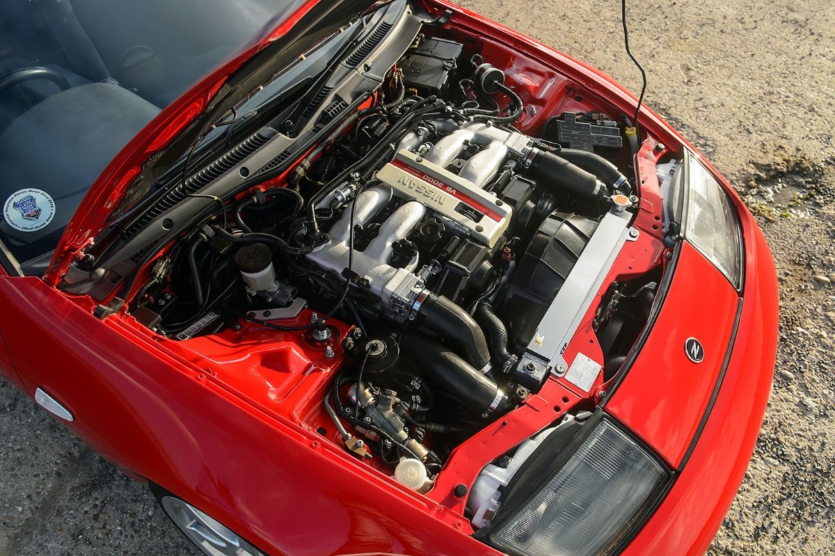

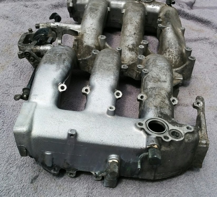

For reference - you can achieve very respectable results with this product:
https://www.frost.co.uk/frost-ali-clean-alloy-aluminium-castings-cleaner/
The product is great at cleaning aluminium castings such as plenums and I've used it on a number of occasions with excellent results.
Very little effort is required, just spray on and work in with a stiff nylon bristled brush and leave for a few minutes then
rinse with water. The result above was achieved with three applications.

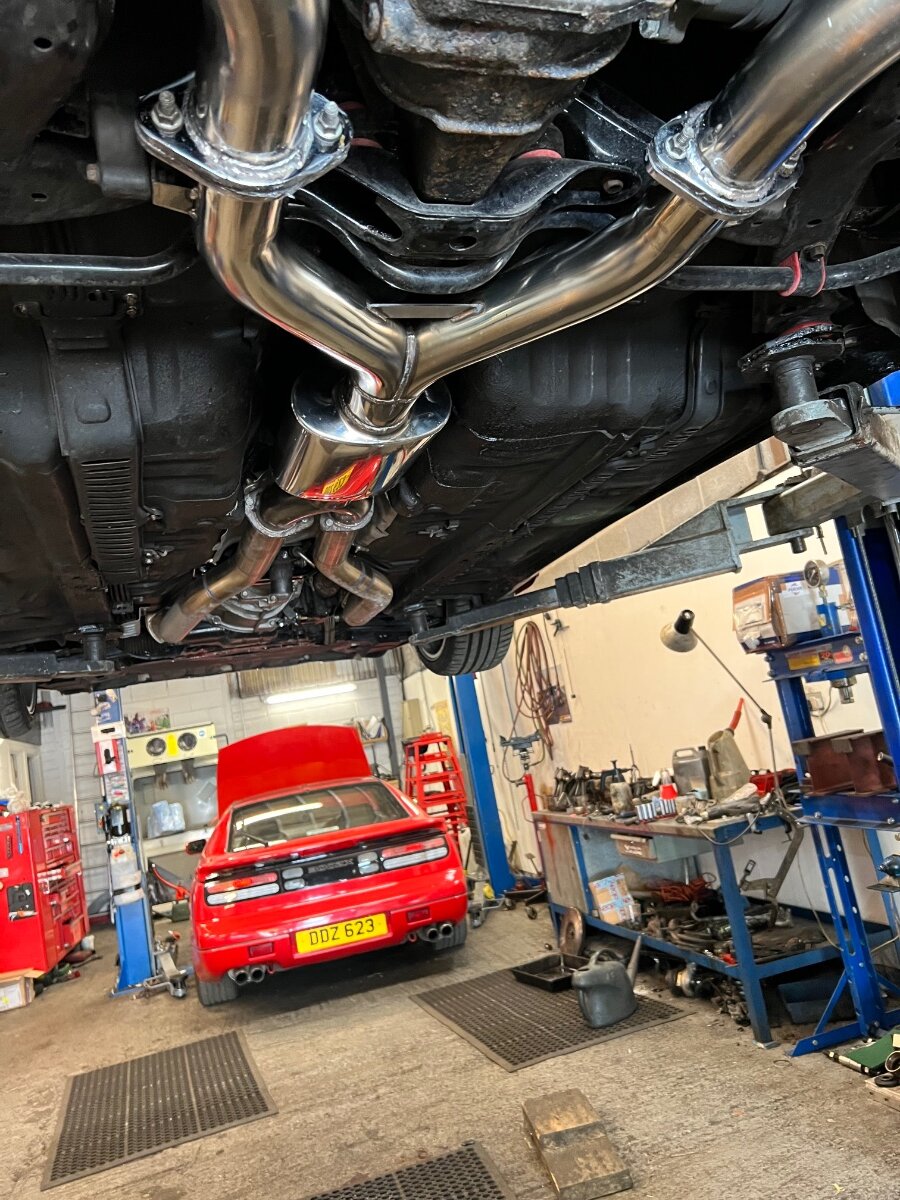

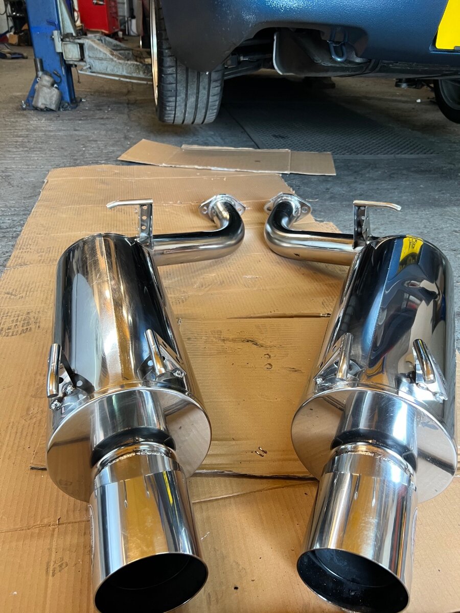

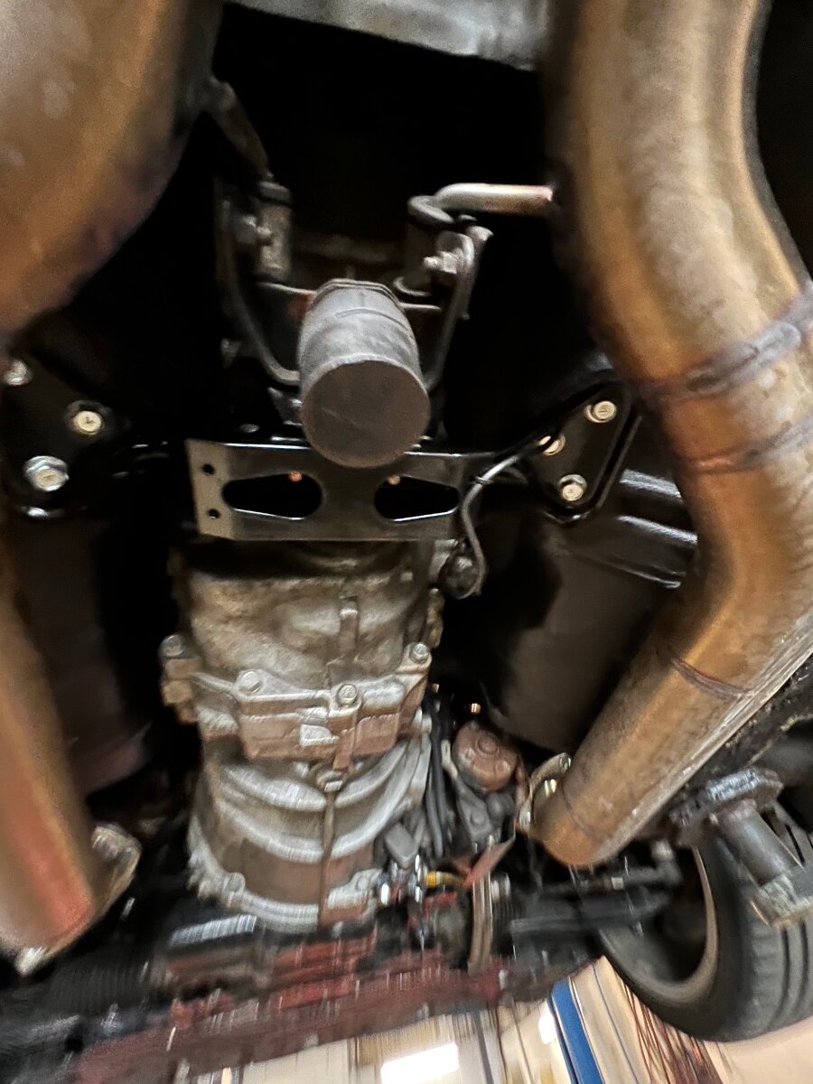

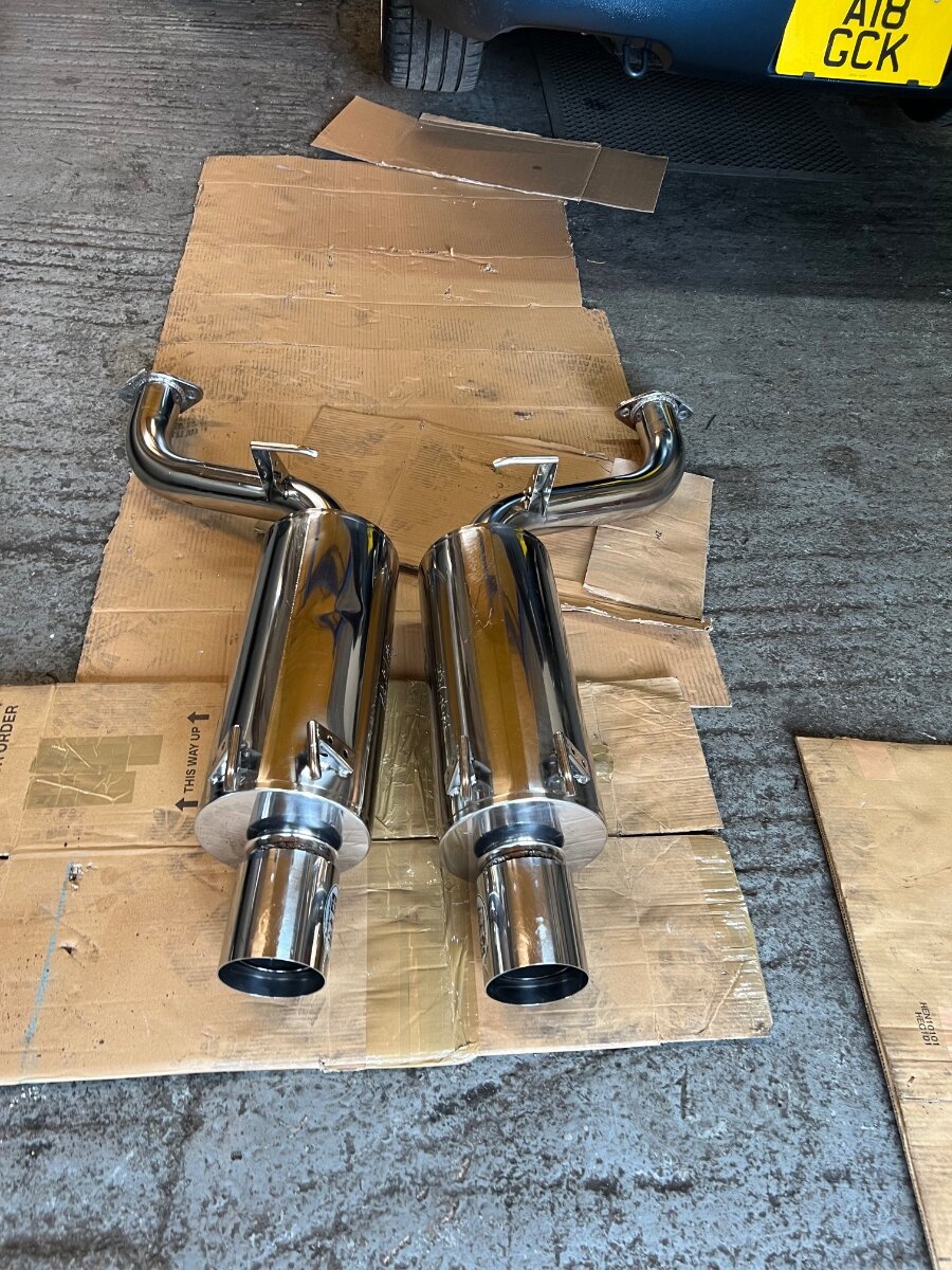

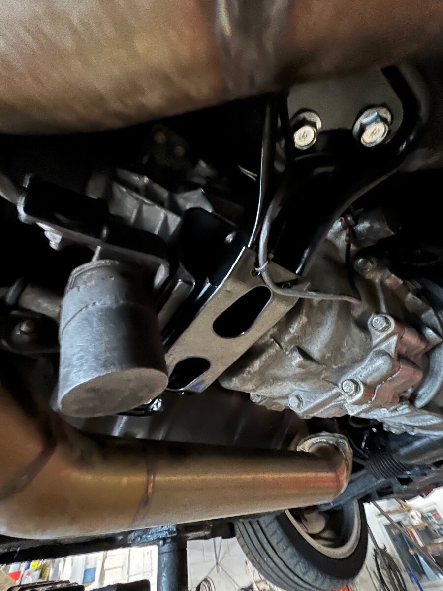

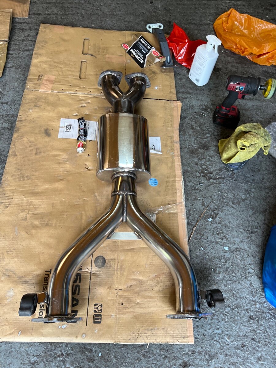

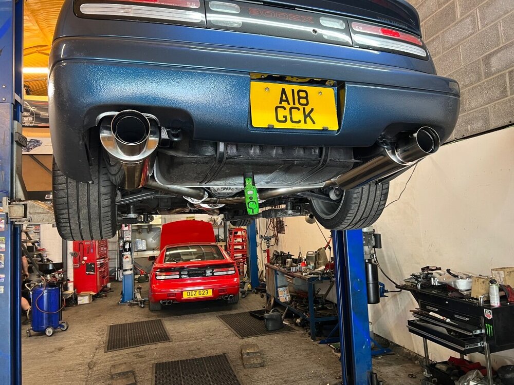

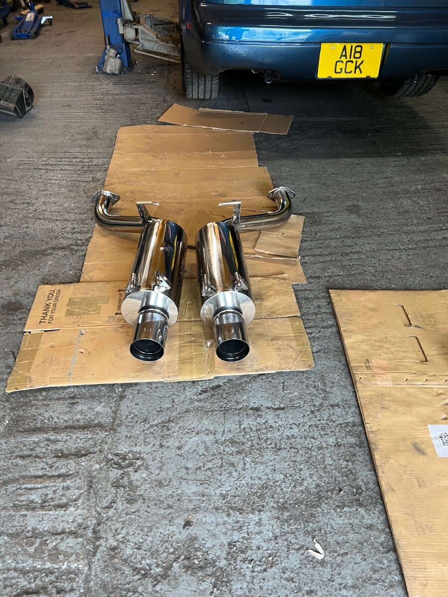

Went down to PowerZed on Wednesday, left at 5:30am with my friends driving my daily down in a convoy. Always a good drive down the M4 😁. Got my oil and filter changed, power steering J hose swapped for a genuine item, coolant leak fixed which was due to my original rad to engine coolant pipe pitting by the hose join, letting fluid seep out and my BDE transmission mount swapped for a new Nismo one.
My old transmission mount was powdercoated and new hardware was sourced, so all fitted squeaky clean. I polished the beautiful Kakimoto exhausts with some Autosol, whilst they were off the car and they look brand new again!
