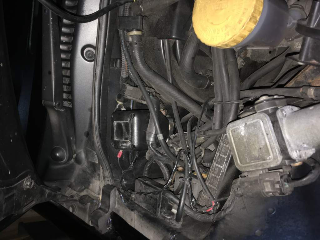

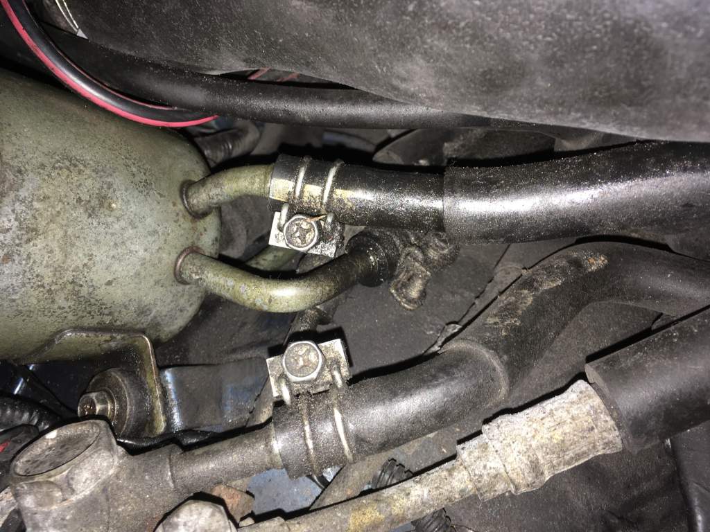

Post a pic so we know what sort of grime we’re talking about mate
Here we go...
It’s black but very crusty and almost sandy in texture.
This is just general grime
Here is a lot of soft gunk, looks like it was a leaking PS pot but I’ve cleaned a lot off.

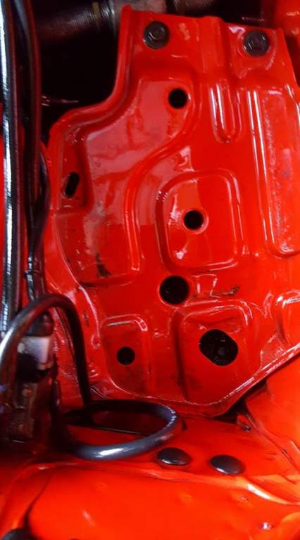

And here is my first bit of cleaning.

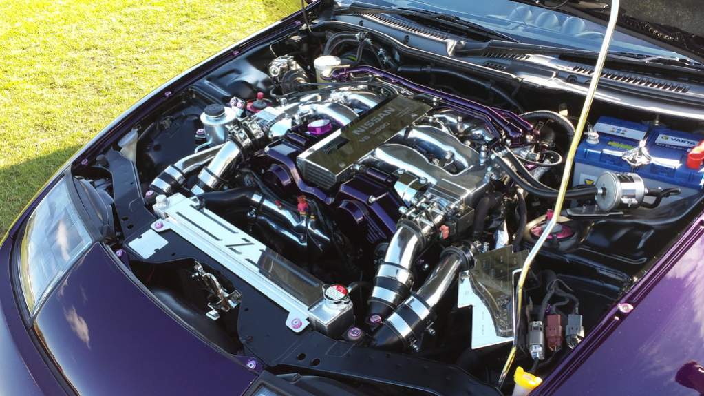

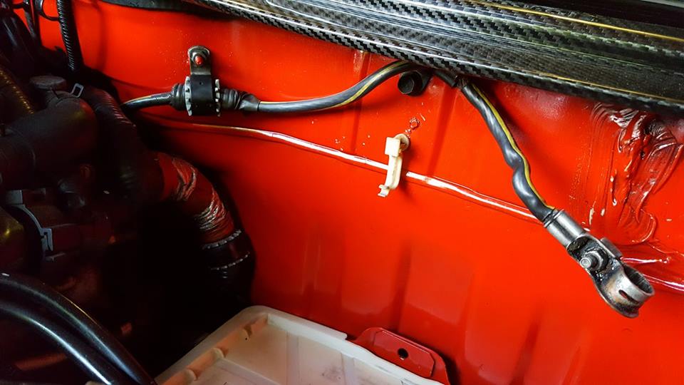

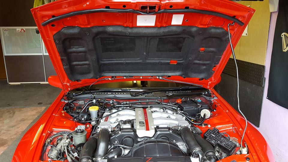

Thats a dirty bay but very common. I used Gunk, T cut and polish.
[ATTACH=CONFIG]111876[/ATTACH]
[ATTACH=CONFIG]111877[/ATTACH]

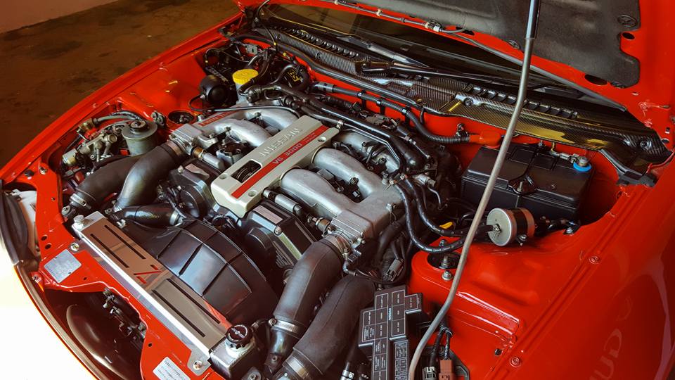

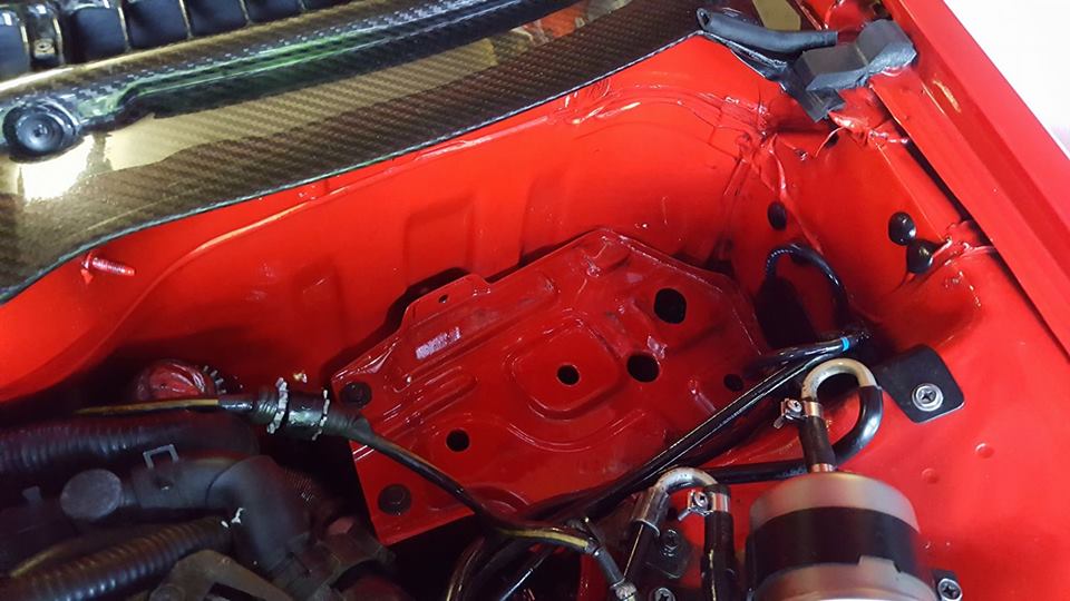

That is wonderful. There’s more skill in my opinion in cleaning an engine bay than the body work. Do you unbolt a lot of items to get behind them properly or leave in place and look for a cleaning tool that can get in those hard to reach areas.

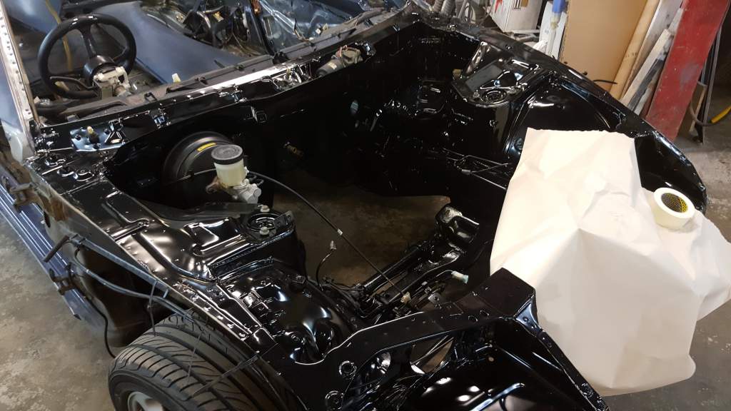

Obviously, I’ll have to get some elbow grease down lower before the engine goes in but will make life a bit easier on the cleaning front :yes:

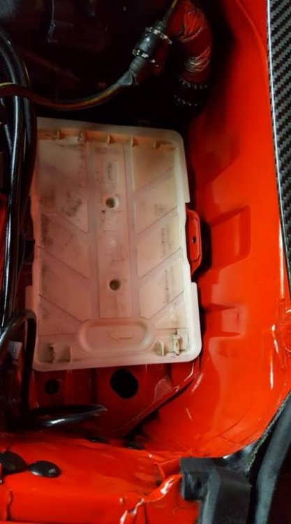

Unbolt what you can and dont forget the underside of the bonnet.

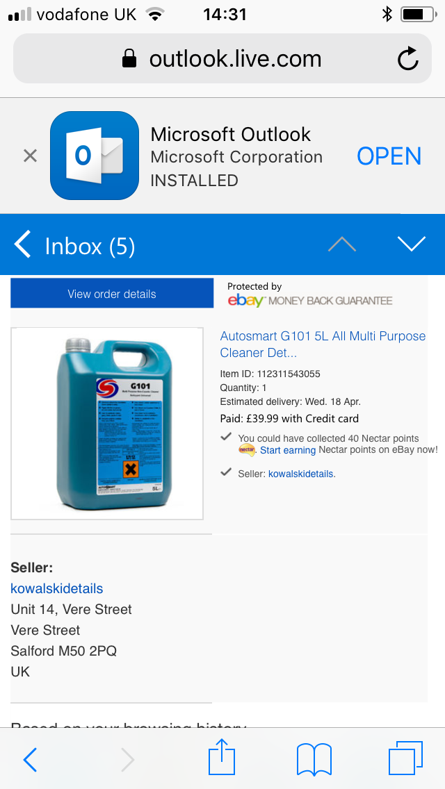

Just order the G101, not cheap but it’s undiluted so should last a long time. Can’t wait for it to turn up now!
