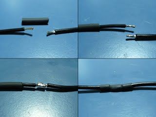

I must admit I've never seen a joint made using the technique below fail in all the years I have done
them - maybe I'm just lucky.
To be fair, it is a widely accepted practice in the automotive industry due to its low cost and ease, it is generally fine if done properly but an in-line splice will always be superior.

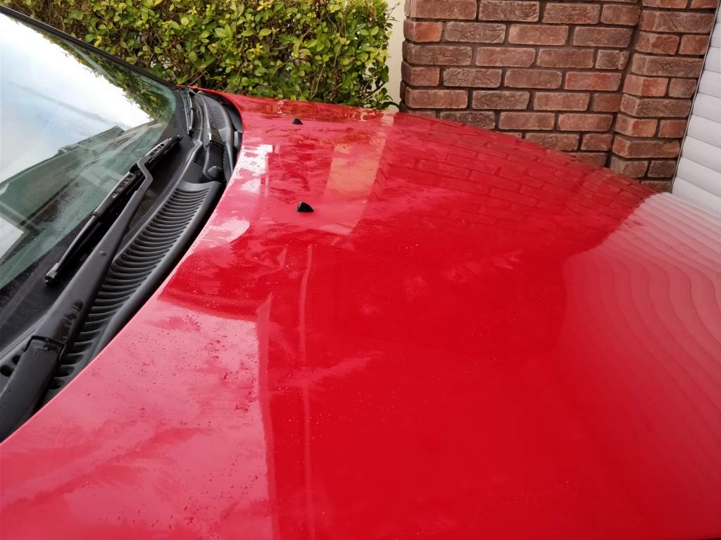

Bonnet was pretty much soaked when I unveiled the car today. The rest of the car was almonst dry though.
