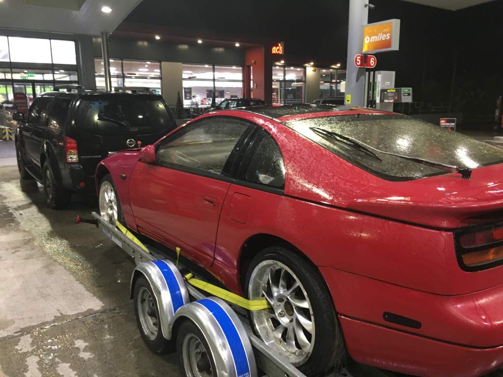

Just home from a 600 km round trip to go fetch this:innocent::whistling:
1989 Factory manual TT SWB!!:yes:

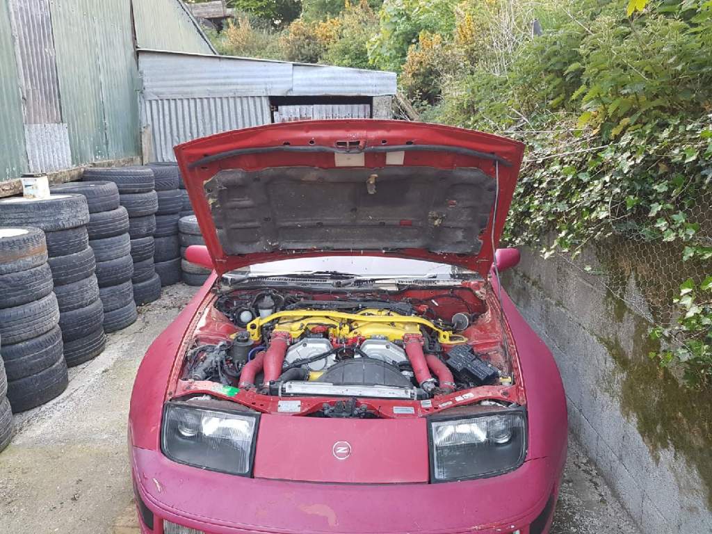

It's missing a few bits and has some rust, also has a "Noddy and Big Ears" themed engine bay:scared::thumbdown:
Was running before it had its gearbox, diff, drive shafts, brakes and exhaust stripped off it:whistling:
Needs a bonnet, new trims, and some paint and bodywork, but it'll be a work in progress.
Have to wait and see how I get on, figured I have a fair few spare bits from the other car lying around, so might as well be hung for a sheep as a lamb!! :thumbup1:probably struggle with it but at least it'll keep me occupied for a bit:thumbup:

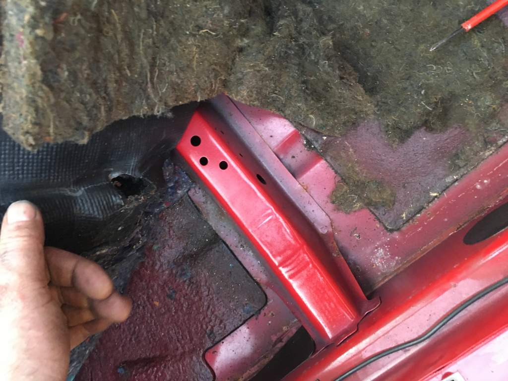

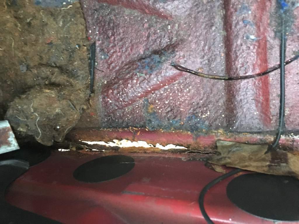

Stripped out a good bit of the car, pieces were either pulled apart by previous owners or had mismatched screws / fittings. :thumbdown: Pulled the carpets as Joel had mentioned it to me last year to check the floor pan. Drivers side seems solid with rust along the sill line on the passenger side:scared:

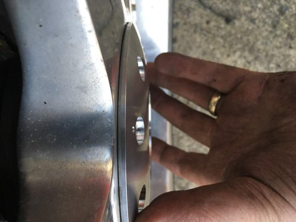

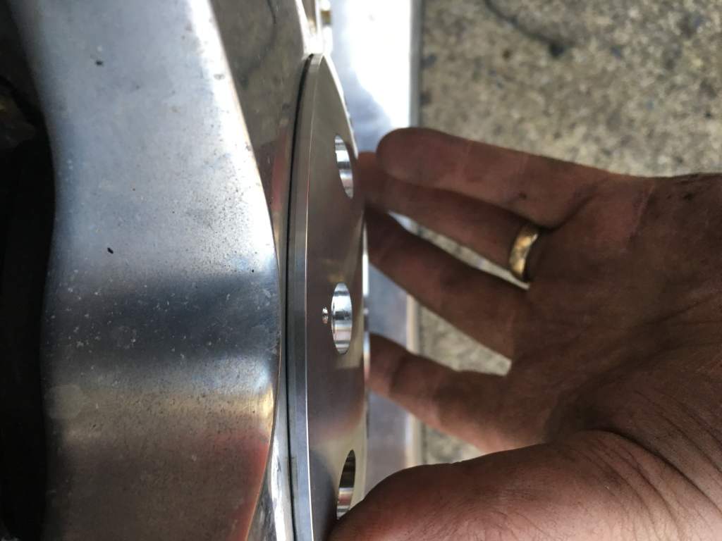

Another problem is the custom wheel centre’s hit the top of the lug nuts, so it’s back to the shop to have more metal skimmed off:blush:

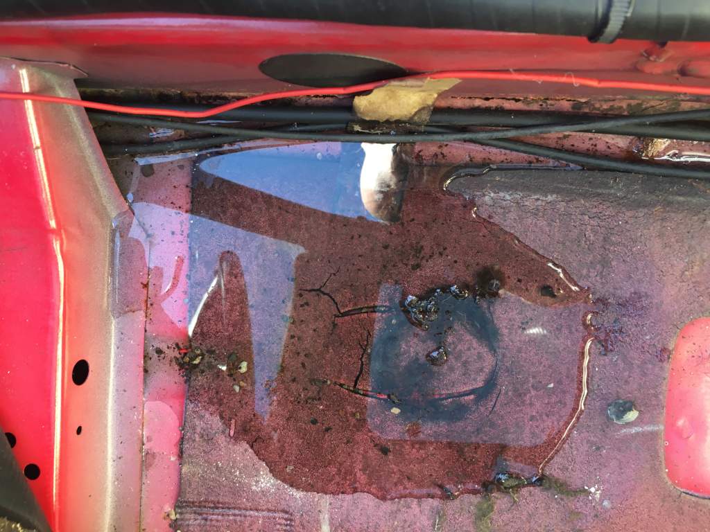

So, Opened the drivers door yesterday evening and (as the carpet is lifted) I see a puddle of water in the floor pan, I'm assuming I'm going to need door and Targa seals??:innocent:
Check your targa drain tubes 1st down the a pillars and behind the fuse boxes in the kick panels to make sure they are all still connected and ok
Don't think it's the drains Ian, the puddle was back where the seat would normally be, forgot to photo it yesterday before I soaked it up. Should be able to get one tonight when I'm home from work. I'll have a search on here to see if there's a seal conditioning thread and have a go at that for the weekend:thumbup1:
If you get replacement seals remember its the swb ones you need mate.
Cheers Gaz, already looked on CZP:scared: Think I'm going to try some Gummi Pflege first:whistling:

Going to give it a try anyway, this is what I just found
I’ve already priced up the seals:scared:, said I’d try the cheap option first:whistling:
Edited by Richie K
Just double check the glass fitment Richie if you're getting water ingress. There are two bump stops for the glass, you could try adjusting those if the window is sitting too low against the rubbers.
Thanks Si, I’d read a few old threads which mentioned adjusting the door glass :thumbup1:
