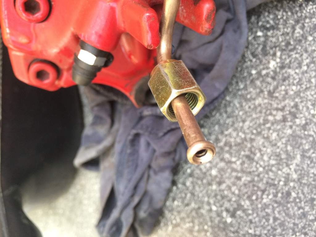

Some more components for the rear brakes arrived so watch this space on that. Slight cock up on the adapter piece to convert from flare to banjo, so there back to my mates shop for tweaking.
It's a similar issue to this;

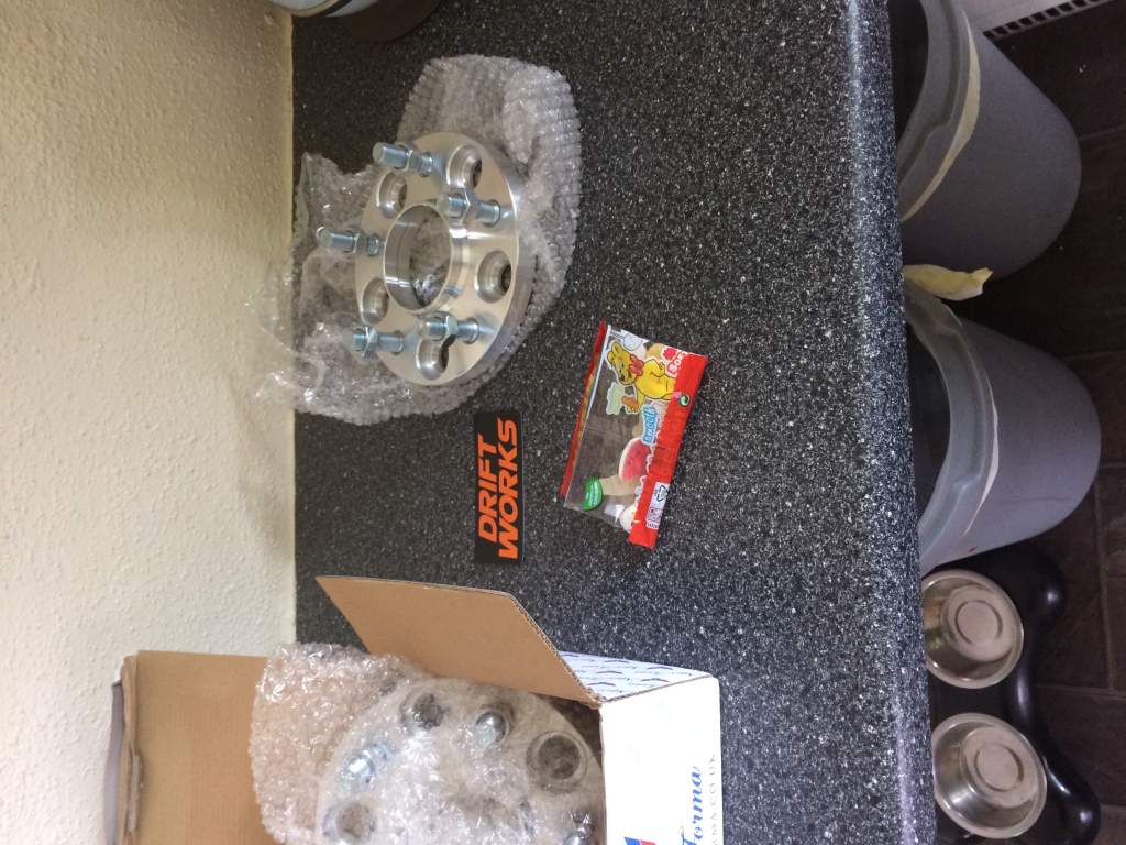

Some shinny bits and sweets turned up from Driftworks, still got to assault the rear bumper tab though. Die grinder might be a good shout.

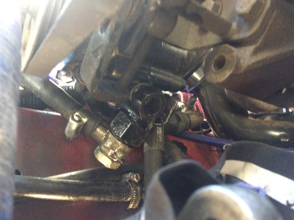

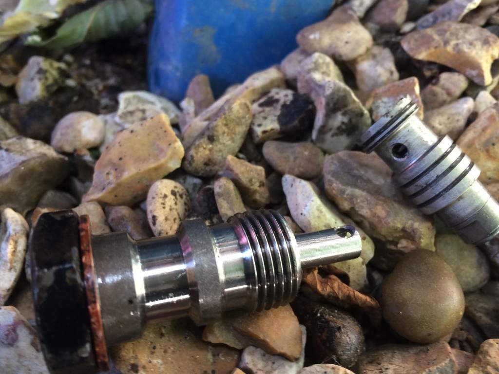

The power steering leak was located, turned out to be from the redundant hicas feed banjo. Except it wasn't, it was in fact the block that bolts to. Closer inspection left me with a pile of bits as it sprung apart. Turns out it was the pressure regulator valve. I was under time pressure and rather than pull the pump and proceed with caution I reassembled it, you guessed it right, wrong. Breaking it in the process. So new pump o clock. So I actually ended up further behind where I started. :taz: alternator out and some other pipes etc.

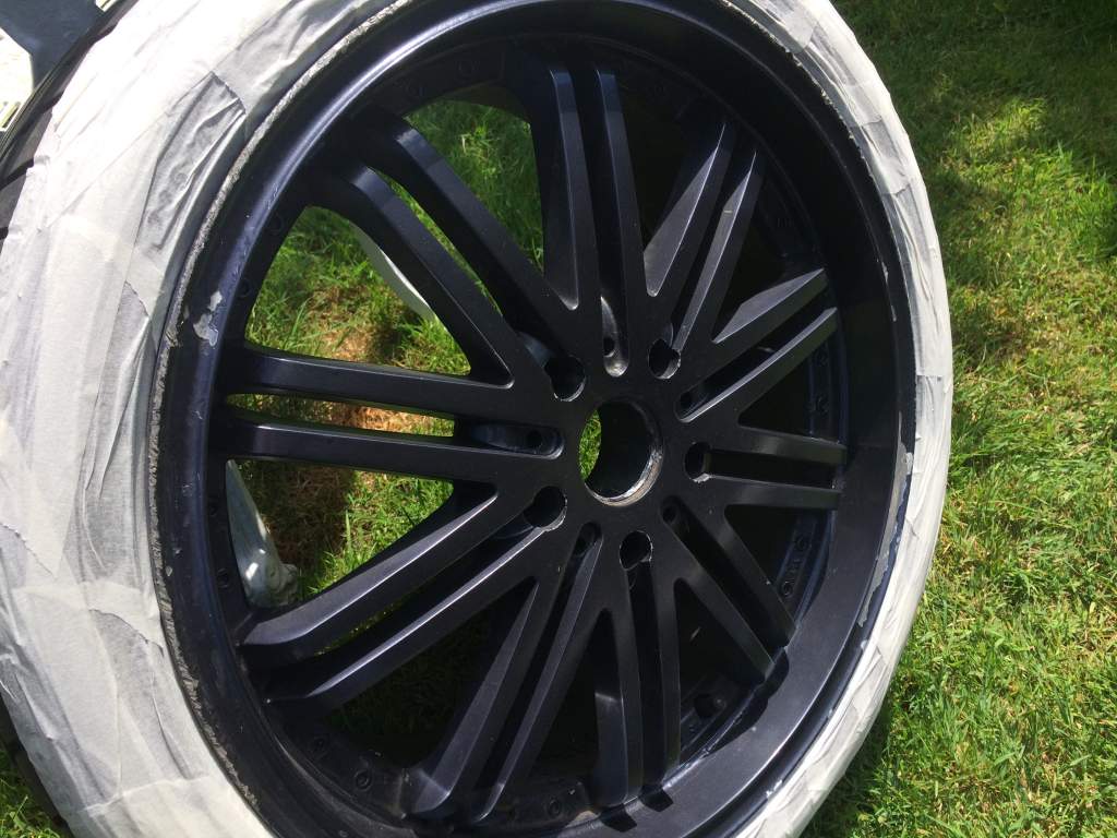

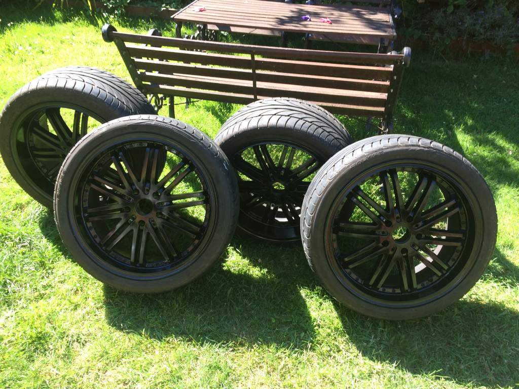

I've been annoyed with the state of my wheels for a season or two, some curb rash combined with the colour which was supposed to be graphite, it was actually a steely navy colour in some lights, not a good look on a red car. There a unfortunate offset for how low the car is and I've had to add some spacers to get the fitment right at this height compared and accolade the brakes. At 8j and 9j respectively there a touch narrow for my ultimate aims, in short I'm not planning on keeping them longer term. A tin of black hammerite has been waiting patiently on the shelf for just this job.
Before;
After a few coats.
Leave them now for a few days to harden before I hit them with the compound polisher. Not perfect but better.

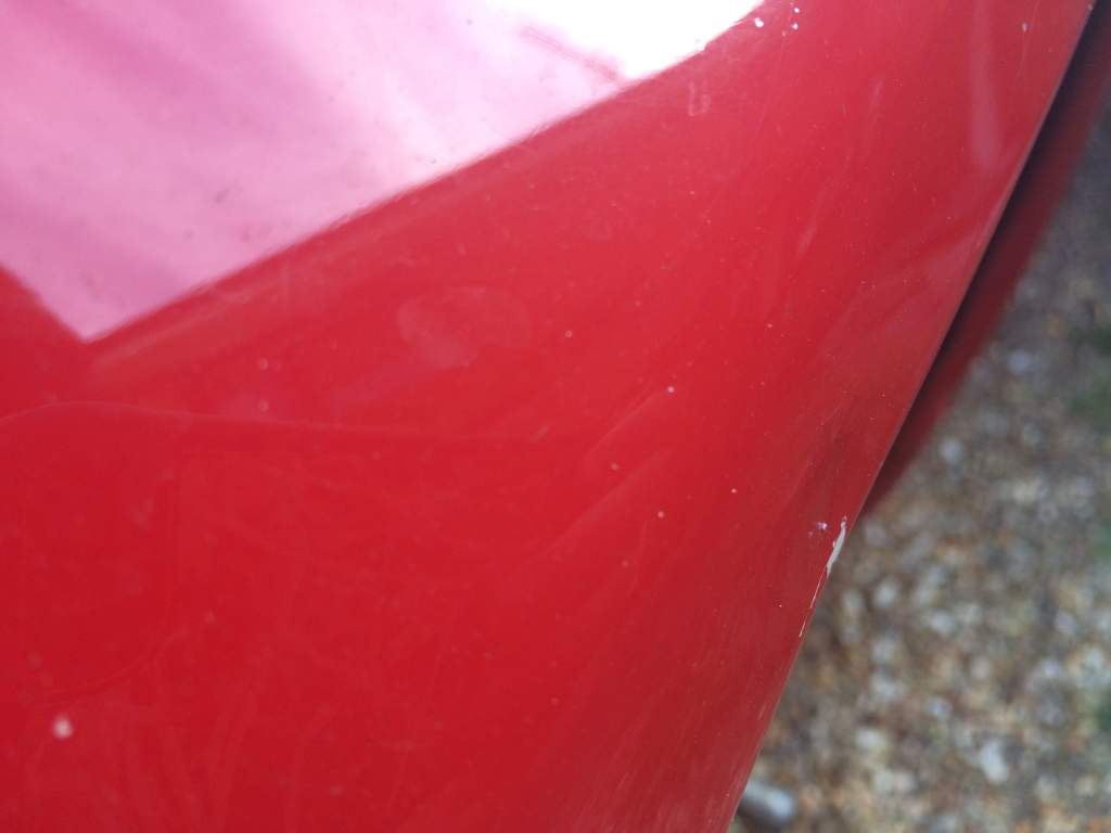

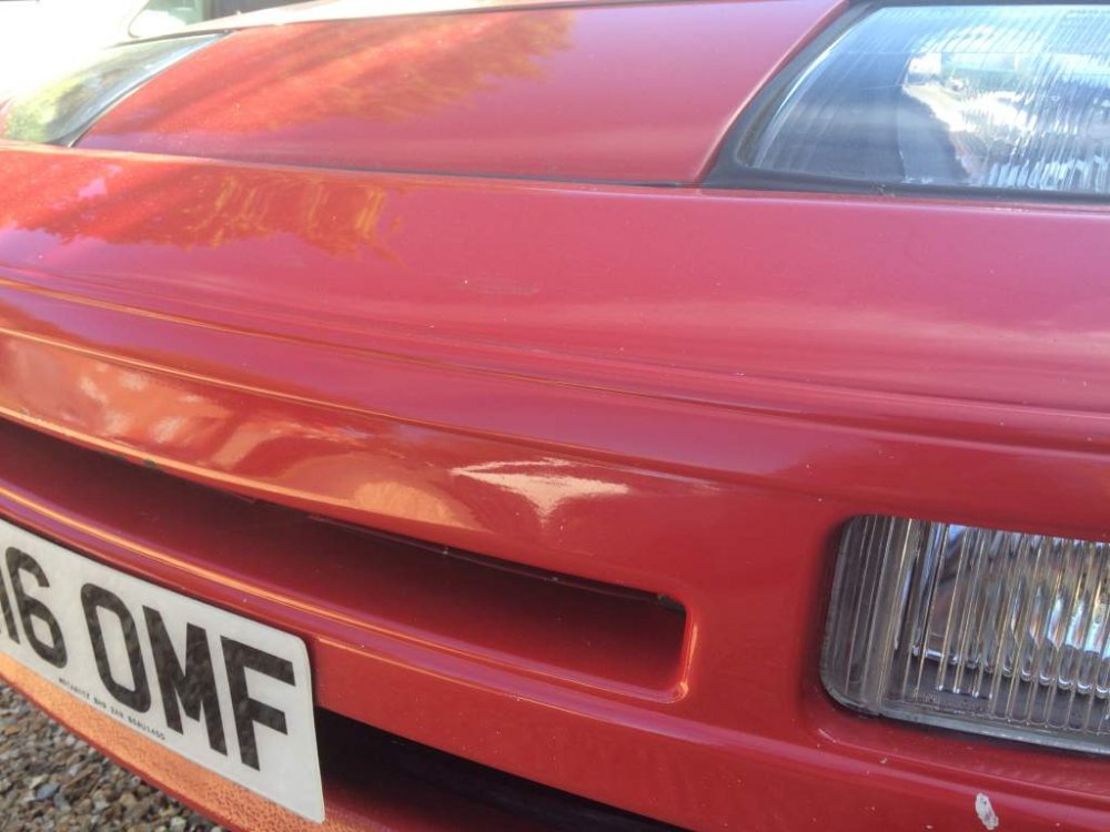

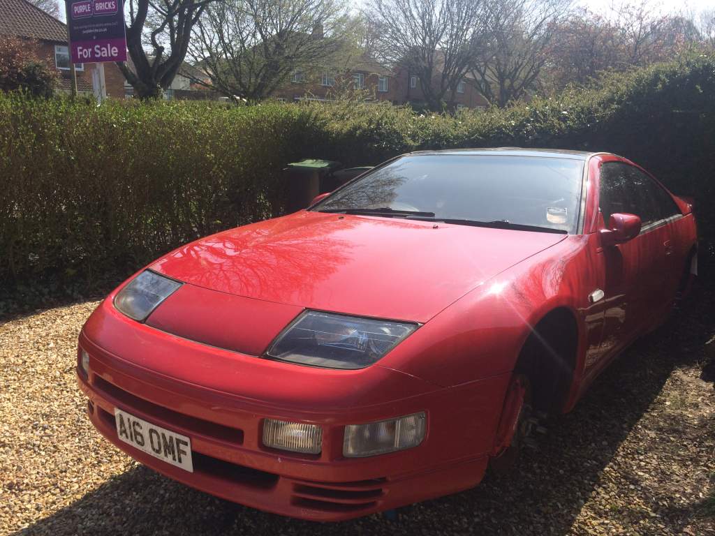

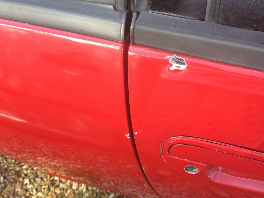

I've had this car now the best part of ten years, it's lived outside that whole time pretty much, covered but outside. It's been a daily driver when I first got it, a second car used every weekend regardless, in all weathers including snow at least once. Now a days it mostly doesn't go anywhere, because I'm working on it but in seriousness when it is on the road it's used for the fun of it. This has taken its toll on the body work, gravel scars, stone chips, car park *******s and worst of all a paint reaction when my original bonnet started peeling. The drive train and underside are, aside from one area that needs some attention still, bloody good. The top side of the car is letting the side down these days. Here's some highlights or lowlights if you prefer.

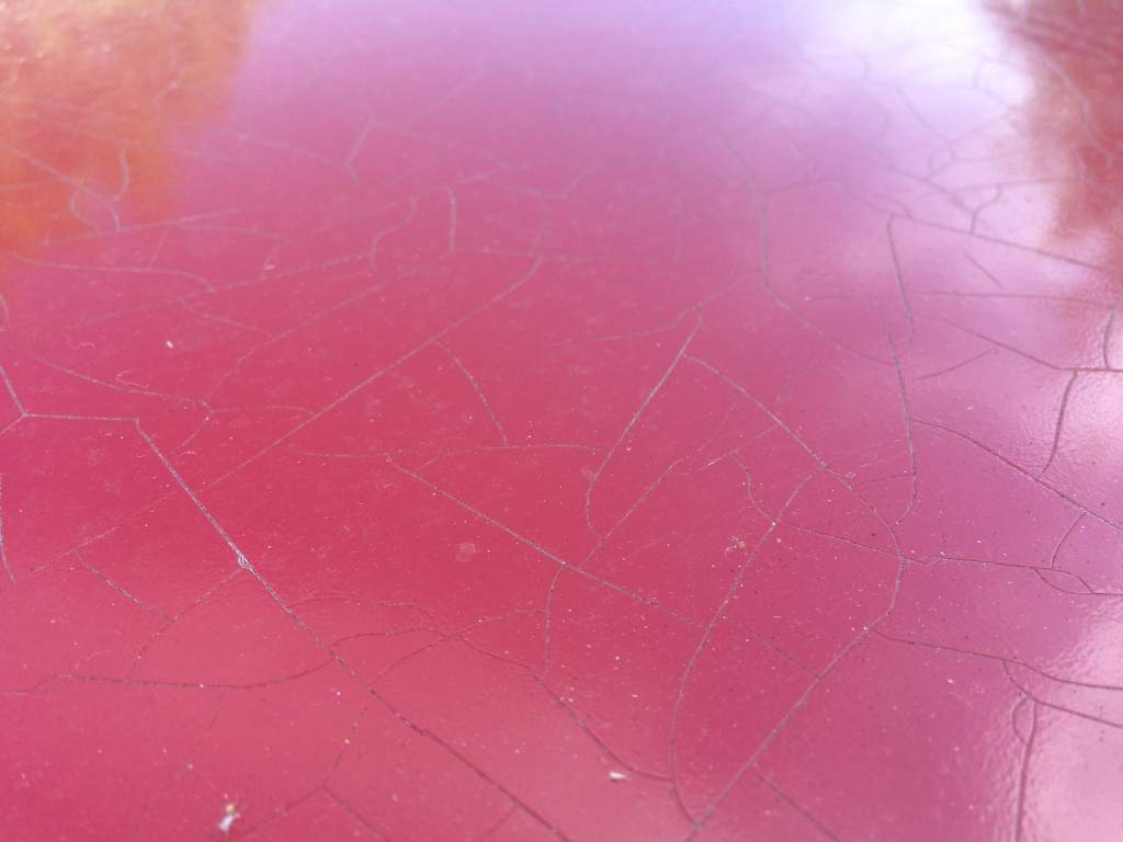

I've pretty much resigned myself to the fact that half the car needs paint again, it had a blow over in 2007 by the previous owner. He reckons it was a full respray but I can tell you quite clearly it wasn't. I really can't decide how to progress on this. I had sort of decided on wrapping it. Why? Because I could do it myself with minimal time input and the cost was low, sub £400. No poisonous gasses to worry about and it would give me a few years to save up a few grand for a full job. A recent BBQ with some mates though and they all really put me off the idea. The scars are still there underneath. One friend who is way more body work savvy than I am reckons it's half a car essentially that needs painting. His recommendation was to chat to his body work guy because for the kind of money I'm talking a deal could probably be done to sort it all out.
So what do you guys think? I'm not building a show car, I just don't want it to look like a shit box. Good from 5 feet is fine by me.
Paint......good
Wrap......not good.
shame you are not near me I could soon sort that bonnet out. Solid colours are very simple to paint.
Even if you go for shitty wrap you will need to fix all the cracks in the bonnet as the wrap will not adhere properly to it.
IMO of course
Cheers for that Pete. I don't mind doing bits myself but full panels is just too hard to make safe and controlled with my set up. I'm honesty my compressor is not large enough either. Il have a chat with this guy and hopefully we can come to a good outcome.
The bonnet is a large panel. I struggle with air supply on one and Im on a 3hp 14 cu ft/min 50L compressor.
Just do it once and do it right.
Paint...Paint...etc

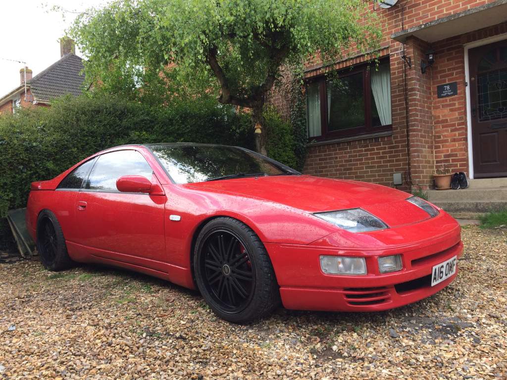

It’s been over six months since a spanner was turned on the Z. To be quite honest I have just lost interest. Time has been at a premium like never before and what little free time I’ve had I’ve really not wanted to spend it doing more stuff that’s similar to Work. Anyway today I can confirm two things;
Firstly the car is safe (for now at least) looks like we are officially moving and the car will finally have a home. Unless things go wrong it’s not being sold.
Secondly today I lifted the cover and....wait for it.... actually worked on it for a bit.
The plan is to get it Road worthy again, it’s the best way to transfer it to it’s new home if nothing else.

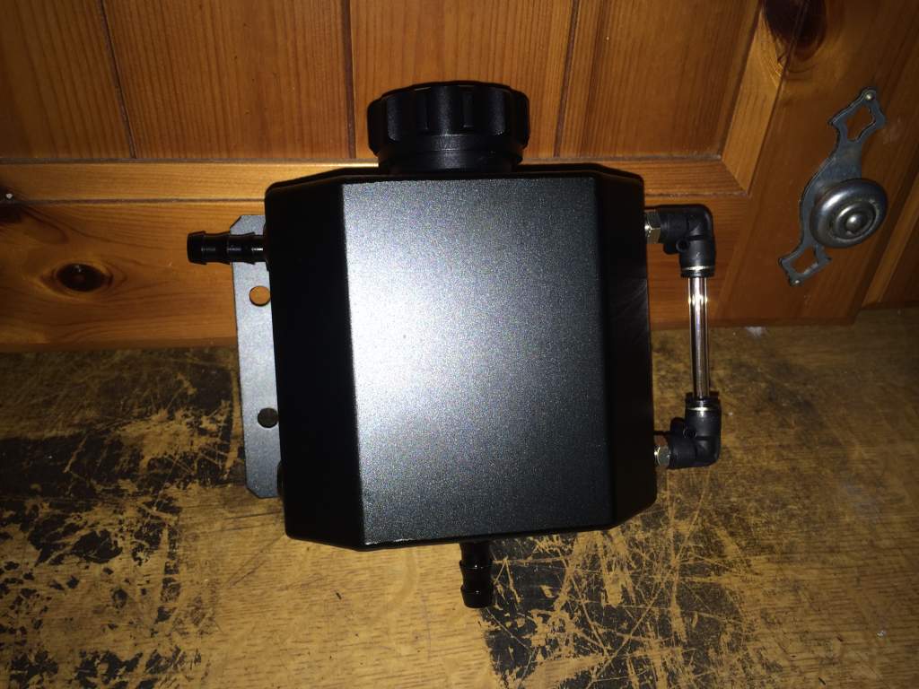

Today I fitted an expansion tank, I removed the stock one to allow the new intercoolers to breathe. This left a problem and my initial plan to fit a new one in the wing, quickly became obvious a no goer. After some umming and Arring, I found this little beauty, and it’s sat where the sitcom compressor wheel was on the chassis rail. It’s been in the shelf a few weeks but no that’s complete.

I do tell a lie a little while back I made a trip to Bognor Regis and picked up a bonnet off Edd. That solved some of the cosmetic issues.

Interesting. Would that expansion tank have fitted where the OE one would sit? (Or was that that you meant by inside the wing is a no goer?)
It’s something I want to look into (clearing space being the intercoolers)
If you need any help getting it back on the road, give me a shout
Cheers Nick. I’m very much nearly there now. At least for this round of faffing about.
I did try popping it behind there, it kind of fitted esp if I had used a 90’ elbow on the hose port. Alternatively a bracket could be fabricated to allow it to sit behind the intercooler itself, didn’t like that option. My original plan was to shove it in the AIV hole, this was smaller than I though. I decided that all in all it would be far more serviceable on the chassis rail. Next time the block is out il look at a more permanent installation with Riv nuts, it’s currently secured with fixings I have from Work for unistrut, it’s solid.
As an aside note, Summit do an ideal solution but it’s pretty, esp including shipping, expensive for a plastic bottle.
