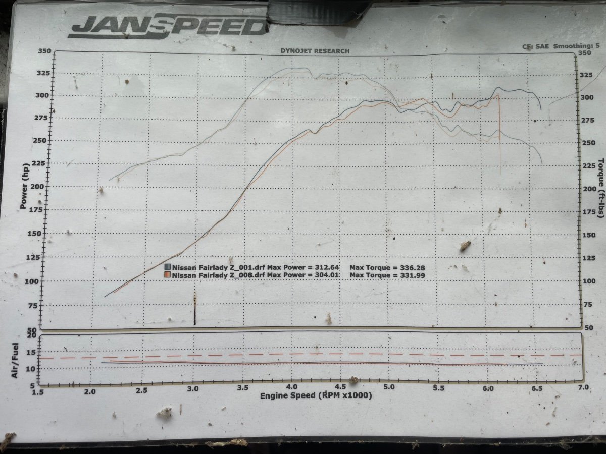

Somethings deffo not adding up here, there no mechanical reason why it shouldn’t be revving up to the factory 7200rpm rev limiter. It has to be electronic systems based issue. But for the sake of being thorough, I’d do a compression and leak down test to eliminate any potential issues in the combustion chamber (I’m not suspecting any, but better to be safe than sorry and know for sure!)
the fact the dyno sheets don’t show what happens after 6200 rpm doesn’t really help with being able diagnose the issue.
Did the tuner give a reason as to why he didn’t Rev it all the way out to the limiter?
I don’t think the issue is VTC as I originally thought. The engine would still Rev out but it’s peak power would be made at around 5000 rpm and the torque curve would drop off more dramatically than that.
spark gap shouldn’t have made the slightest bit of difference at 16psi of boost, even at 24psi I ran NGK supplied gaps with no issue at all. Which makes me think ignition system based issue producing a weak spark
Is it still on a S1 PTU? Any sign of any misfire no matter how minor?
He said there was no point as it was plateaued, that if the power had dropped off there must be an issue as it should pull through the redline. He wasn’t comfortable pushing it past this apparently. Compared to other maps it seems I’ve looked at it seems that that plateau is pretty typical of stock turbo cars.
It is on a series 1 PTU but it’s never caused a problem, especially not the stereotypical issue of hot misfire the issue I had was the opposite. It would misfire unless the engine was hot hot.
I think a lot of the above highlights the issue. The ability to data collect with the stock ECU is really limited.

When my car was virtually stock (Stillen filter and kakimoto cat back) it made peak power at 6850 before tailing off to Rev limit….. and it stock boost made 339bhp at SRR. I’ll see if I can find the dyno print
Something I hadn’t noticed before is the fact you low boost makes peak power and revs out cleanly to red line yet your high boost doesn’t is also unusual! I’ll go back through your thread and see if there’s anything I spot that could be a cause, because at lower boost your engine is flowing enough air to breath all the way to red line, yet when you up the boost it appears to choke out
1 hour ago, nickz32 said:
That’s exactly why I went to Haltech so long ago!
That choking out observation was one the dyno operator mentioned too, but that it’s cause could be numerous.

I mean there’s nothing screaming out as a glaring issue.
2.25” exhaust is small and will be causing back pressure issues. That will be a contributing factor…. Be worth checking that none of your silencers/resonators have collapsed internally.

At the first session, he noticed that the car was running out of puff at high revs, he duly connected a fuel pressure gauge and that showed that the in tank fuel pump was unable to provide enough pressure at the top end.
Once I'd fitted a new fuel pump (and new O2 sensors), the car was mapped to a very safe 335 bhp. Yes, I could have had higher power but I'm looking for safe and reliable - not just a high power figure.

It’s actually 2.5” according to the blurb, maybe it 2.25” ID. In terms of the exhaust the biggest bottle neck would be the turbo elbows.

Just for clarity, when you raised the boost, did you got from wastegate pressure straight to 16psi, or was it raised incrementally?
Wastegate to 16.

personally, the amount the dual MAF setup costs, you’re 80% there to a Haltech Platinum Pro standalone that absolutely snots a stock ecu and “dual” MAF setup in every measurable way possible…. I know what I’d do out of those two options!
This is where I feel whoever did the dyno last time could have spent an extra few minutes to help diagnose. Really, they should have dropped the boost to see if the issue persisted or changed or disappeared. Maybe that was a lack of knowledge of the car on the tuner part and has taken the “engine wants what it wants” a bit too literally. I wouldn’t be using him again.
Again, if it were me, I’d have tried incremental increases from wastegate to 16 psi to establish where the loss of ability to reach full RPM disappeared (Stock 9psi, 12psi, 14psi). That would have shown if it was an airflow problem or something else. I’d suggest it would probably be worth an hours dyno time at Horsham etc just to do some runs on different boost levels, monitor the AFR’s and see what the engine does and where the problem arises. I wouldn’t do it on your own with just boost level changes as you don’t know what the fuelling has been set up like above where the tuner was terminating the dyno runs
