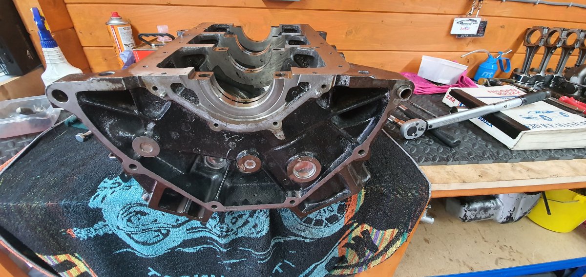

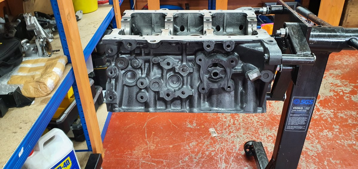

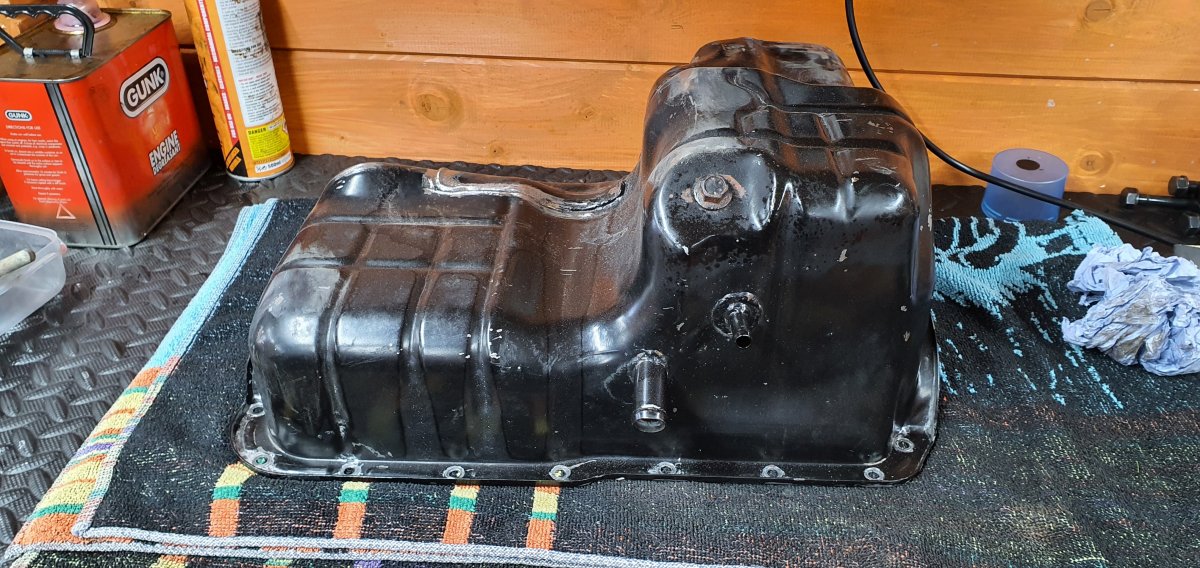

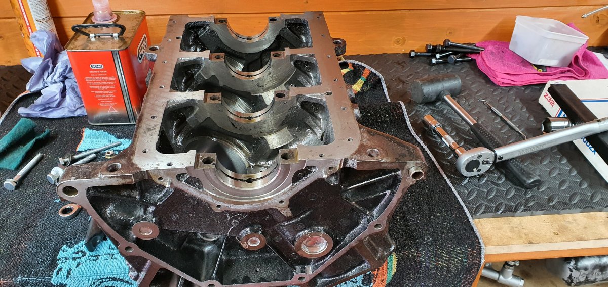

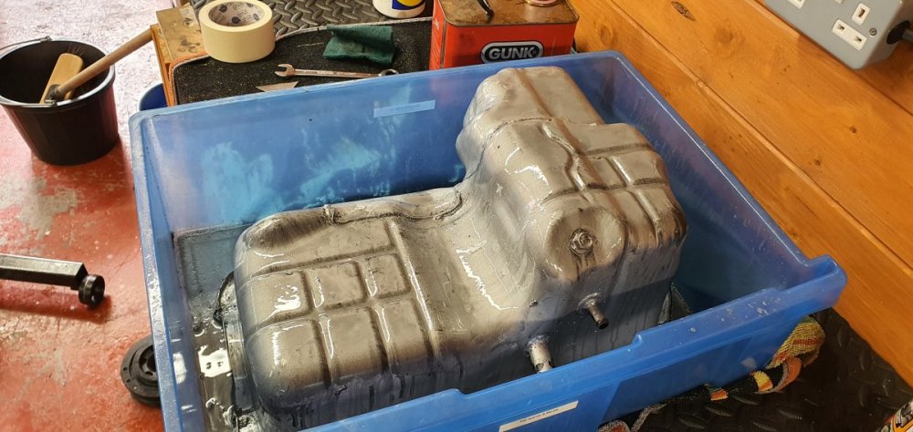

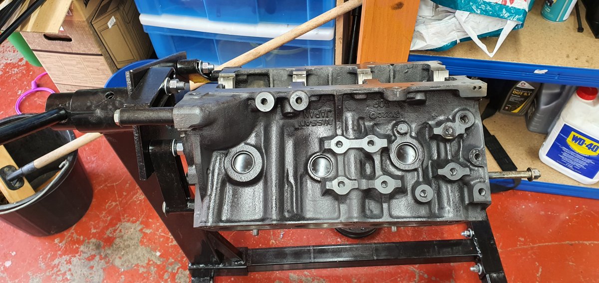

Cant believe how long this took me and i used a combination of gunk de-greaser, wd40 and brake cleaner.
Extra luck that the de-greaser was strong enough to strip paint too so all the silver that was only the block came off.
When everything was dry again i used high temperature paint to coat the sides of the block and top to make it look new.

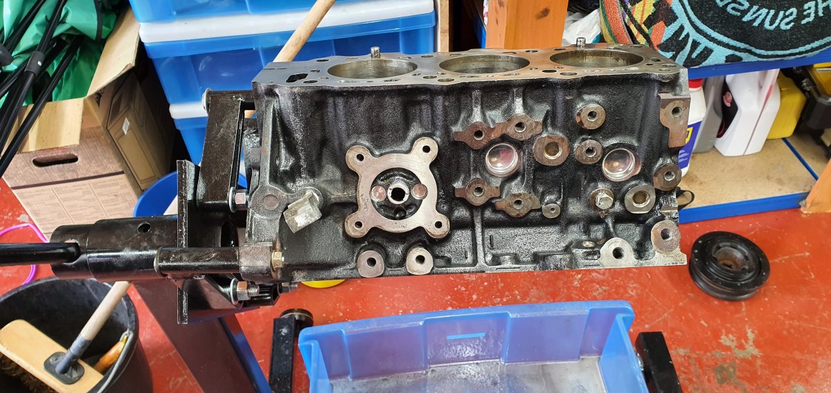

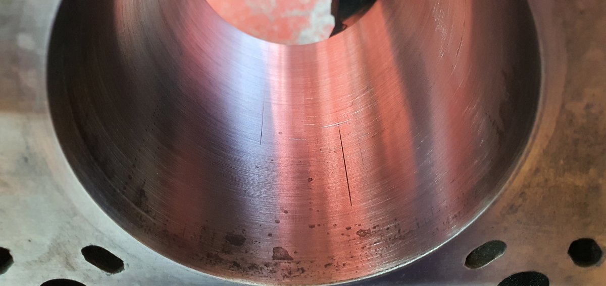

So just out in the garage with my new honing tool and just as i go to do this cylinder i notice these huge scores.
I'm guessing i either need to get a new block or get these professionally done larger then get pistons to match.
Whats everyone thoughts ?
The grooves that are clearly visible can be felt with my nail as i rub them across the surface.
56 minutes ago, phutumsch said:
You are going to be advised then to go to 87.5mm, not cheap this Z ownership is it.
That or a replacement block with clean bores if he’s already got Forged Pistons in stock size. Might be the cheaper and faster way.
He's to find a later block and clean, good luck with that one. Needs to get his own to a shop and move up a size imo.
So late blocks and early blocks are different? That’s a new one on me. I know the long block is but the short block I assumed was the same...
I was thinking complete engine for some reason, personally I don't know of any differences, the decision is yours Lee.
2 hours ago, JaiKai said:
Found a local engine place i can take it to get the block properly checked.
I'll see if i can get a price for a complete clean, cylinder bore and paint job.
I can’t remember so best check with someone who does know but I think the Forged pistons sit a little sloppier in the block with bigger ring gaps.
You may find the shop can resurface the bores to take out that score, obviously this depends on the depth of the scratch and you will just have a slightly larger ring to accommodate. You might be within tolerance, if your lucky. This would also depend on what happened to the bores last time.
