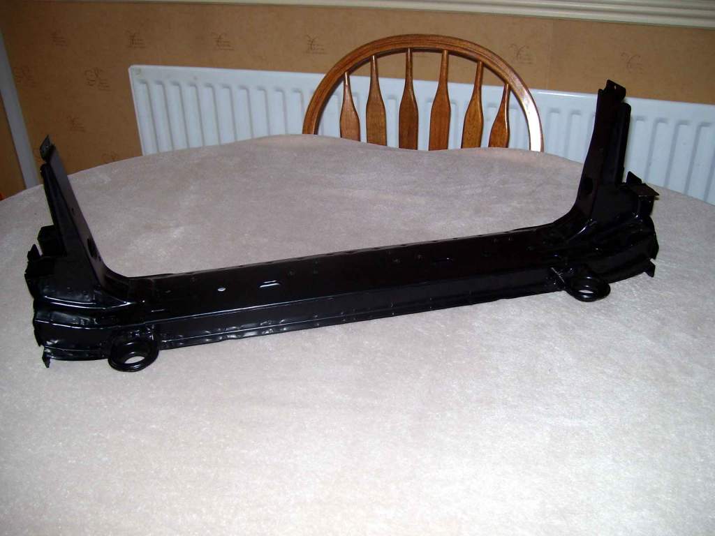

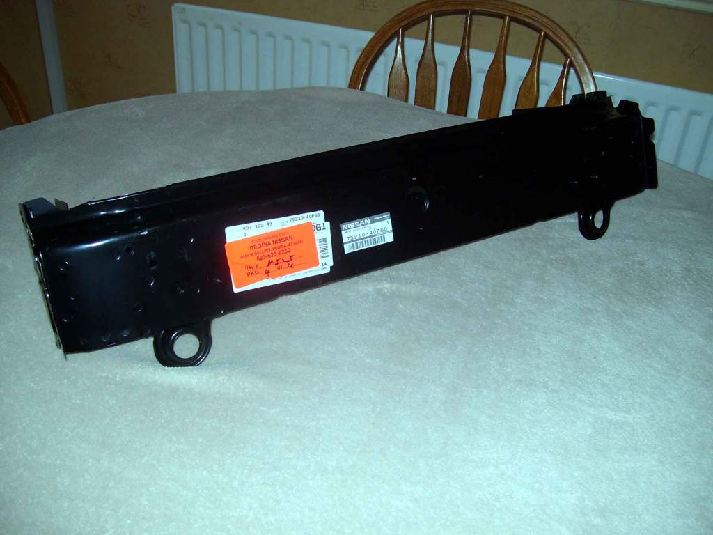

Let's see the thing then!
Sorry Andrew, ran out of time.
I will post a couple of pictures tomorrow. :whistling:

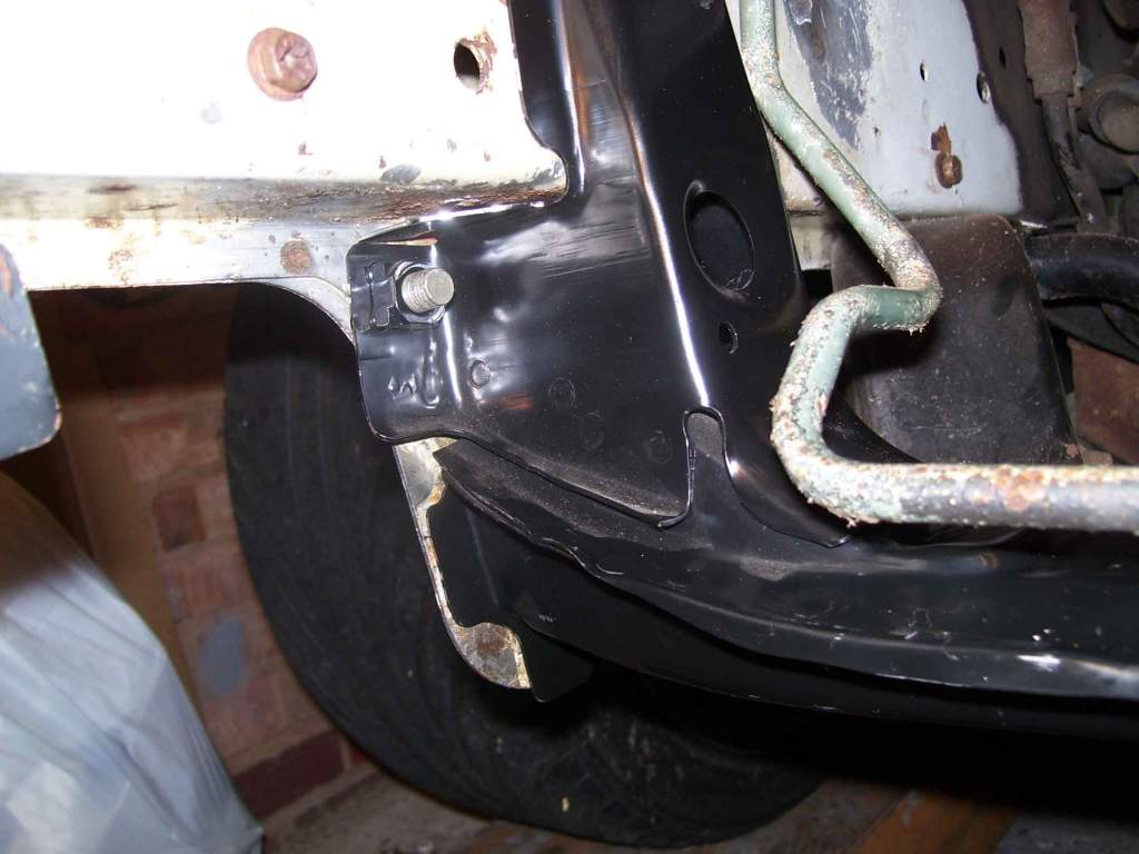

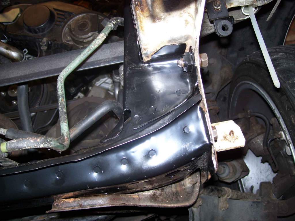

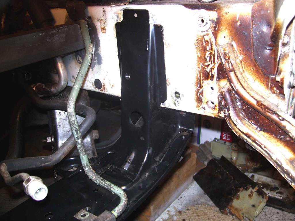

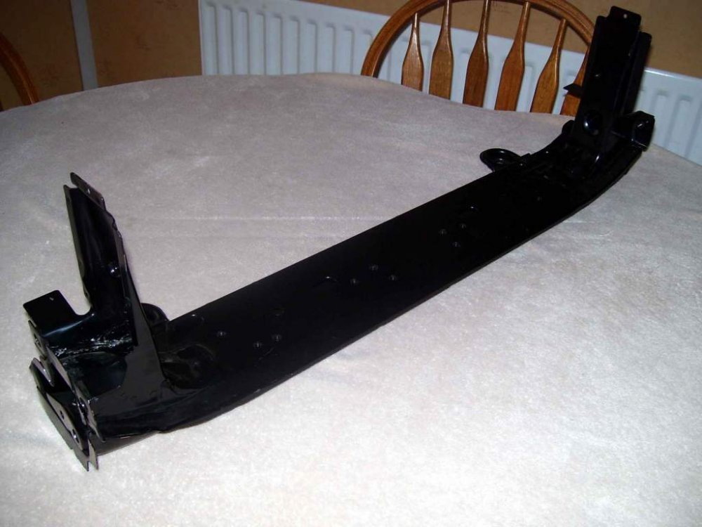

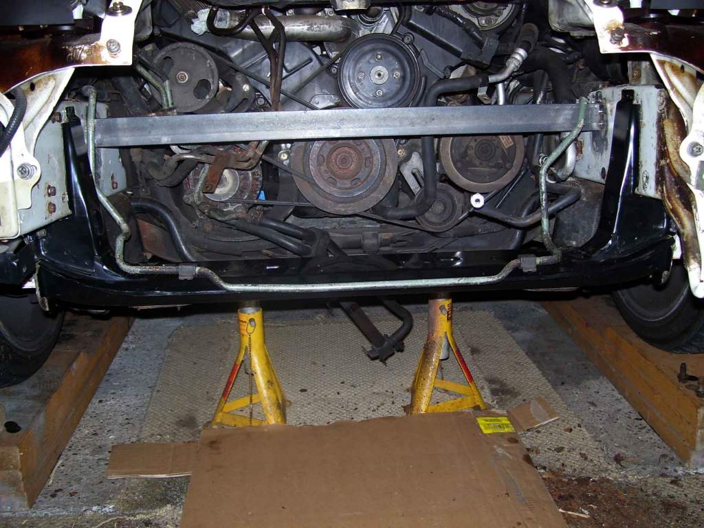

Looks a tidy fit too, saves all that messing trying to bodge the old one up eh? :thumbup1:
So pleased with the fit, very happy with it.
Those locating bolts are very handy aren't they.
A real god send, so grateful to Lymon for referring to them in an earlier post.
Not sure I would of picked up on it myself.

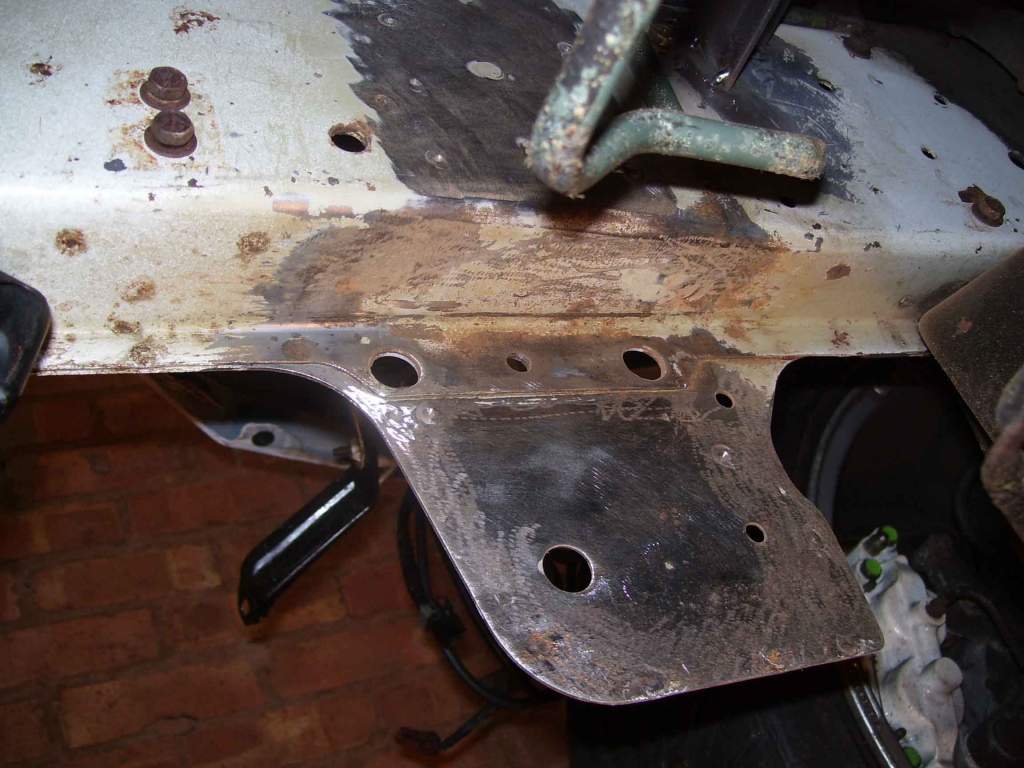

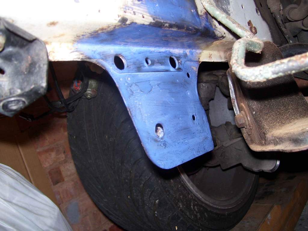

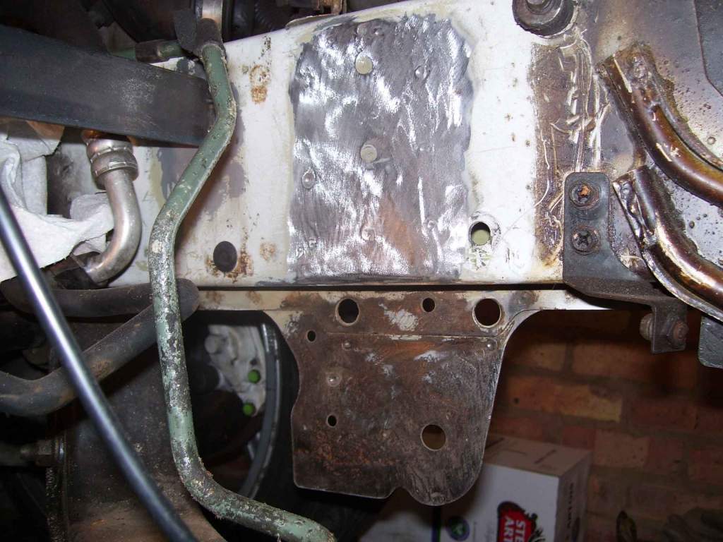

You want some rust killer on there mate, plenty of it. Time spent now is time well spent. Good on you for getting stuck in, too many people don't even know which end of a hammer does what these days. I got some zinc primer the other week, pretty good stuff and it's pretty cheap from screwfix, you can weld through it etc. If nothing else it will keep the surface rust away whilst your working on it.
This is the stuff I use £3.60 a tin;
http://www.screwfix.com/p/no-nonsense-zinc-galvanising-spray-paint-silver-400ml/40801
Great minds think alike.

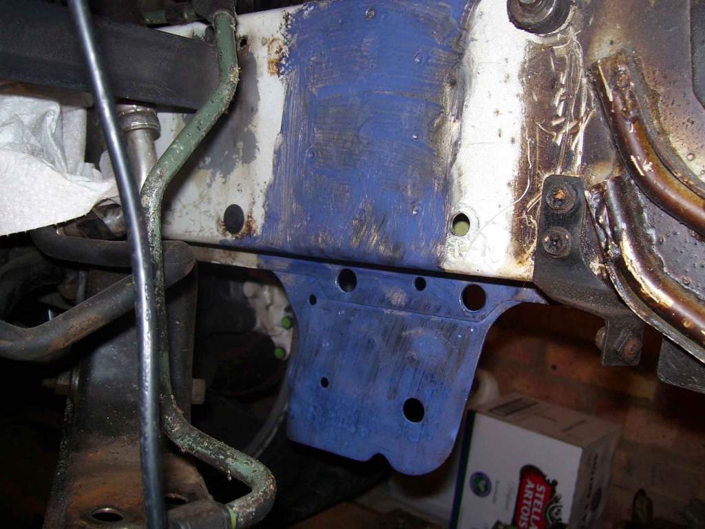

Just applied my first coat of rust killer, waiting to put the second coat on.
Went a bit overboard in places.
That way it should be ready in time to apply some 90% Zinc primer tomorrow.

Like Stephen said........ rust killer........ I use the Bilthamber one Deox-C gel....... paint it on, wait 30 - 60 minutes, wire brush gel, wash off with clean water and dry......
Comes up lovely..... just done suspension parts yesterday evening.....
