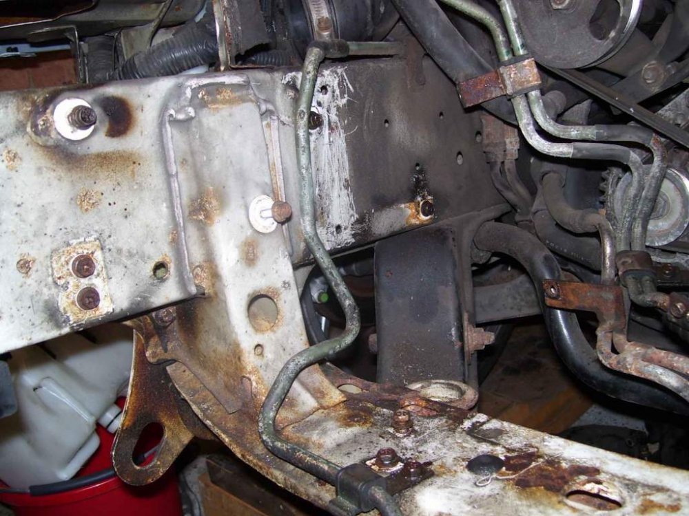

So, today I started the dismantling of the front end, and within a couple of hours I had removed the front bumper etc'
This was done on the driveway, and I hope to complete the rest of the work in the garage, hopefully.
I have reached the point where I am unfamiliar with most of the critical items that now stand in my way, and would seriously appreciate some advice as to how I should proceed.
First question/concern that springs to mind is... Can I continue successfully with the car being in the garage?
The last thing I want to do is get half way through the strip down only to find that I do not have the correct access.
The car is drivable at the moment, but once I start taking various parts off she will become immobile.
Your help and advise would be very much appreciated.
Please see photo's attached...

I would just like to understand if there is any load being held under compression from the suspension as I am getting close to removing the fixing bolts.
Do you mean the tension rod bracket fixing bolts? Are your front wheels off and the suspension fully relaxed? If so, you can safely
undo the bolts. I would remove the tension rods from the brackets and lower suspension arms first and get them out of the way
and then undo the brackets.
Edited by AndrewG
the only thing that's slightly under compression is the swaybar, but nothing serious
> I would remove the tension rods from the brackets and lower suspension arms first and get them out of the way and then undo the brackets.
I find it's actually easier to remove the tensionrods complete with brackets as there's no need to remove the rods from the brackets, unless you need/want to replace them.
Correct Andrew.
As for my front wheels, they are still on.
However, they are barely in contact with the ramps. they're there just for safety to be honest.
Hopefully now knowing this, I will aim to have everything clear this weekend ready for cleaning and measuring.
Thank you.

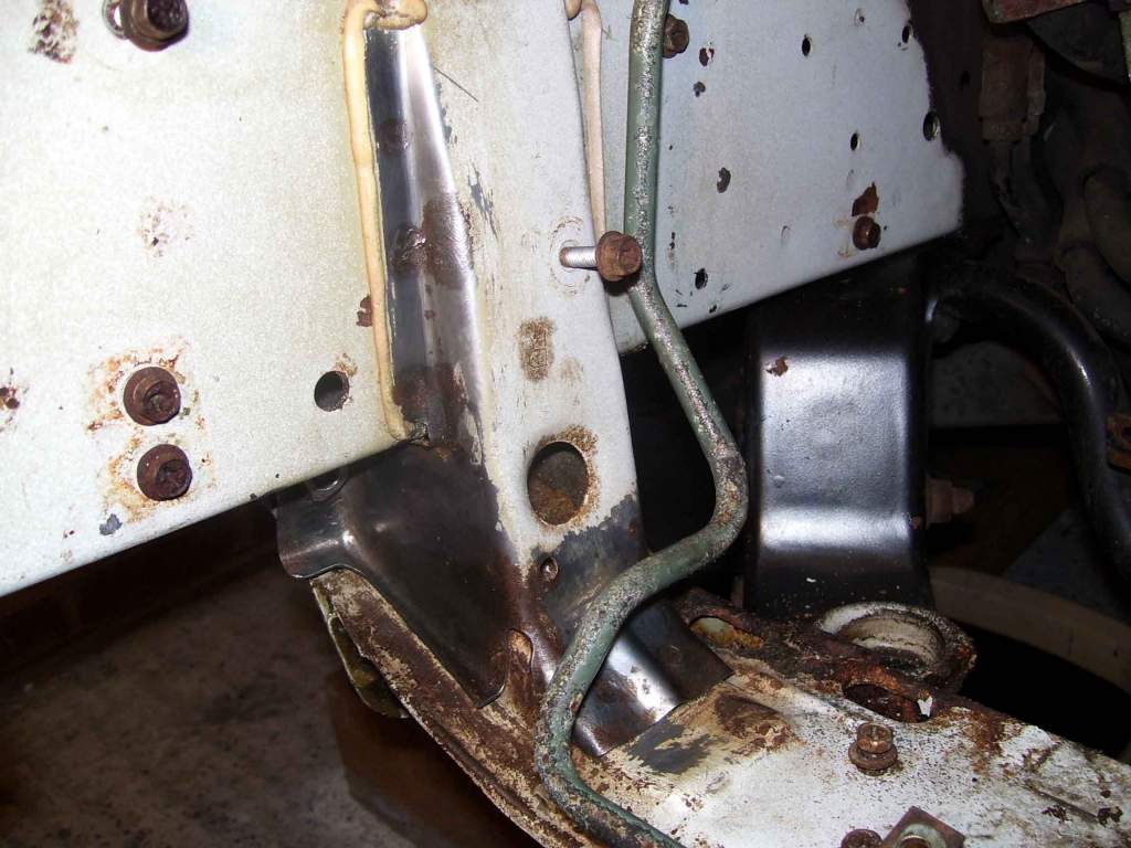

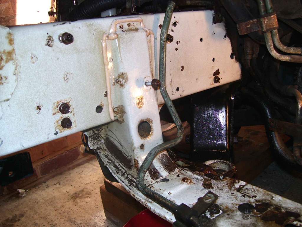

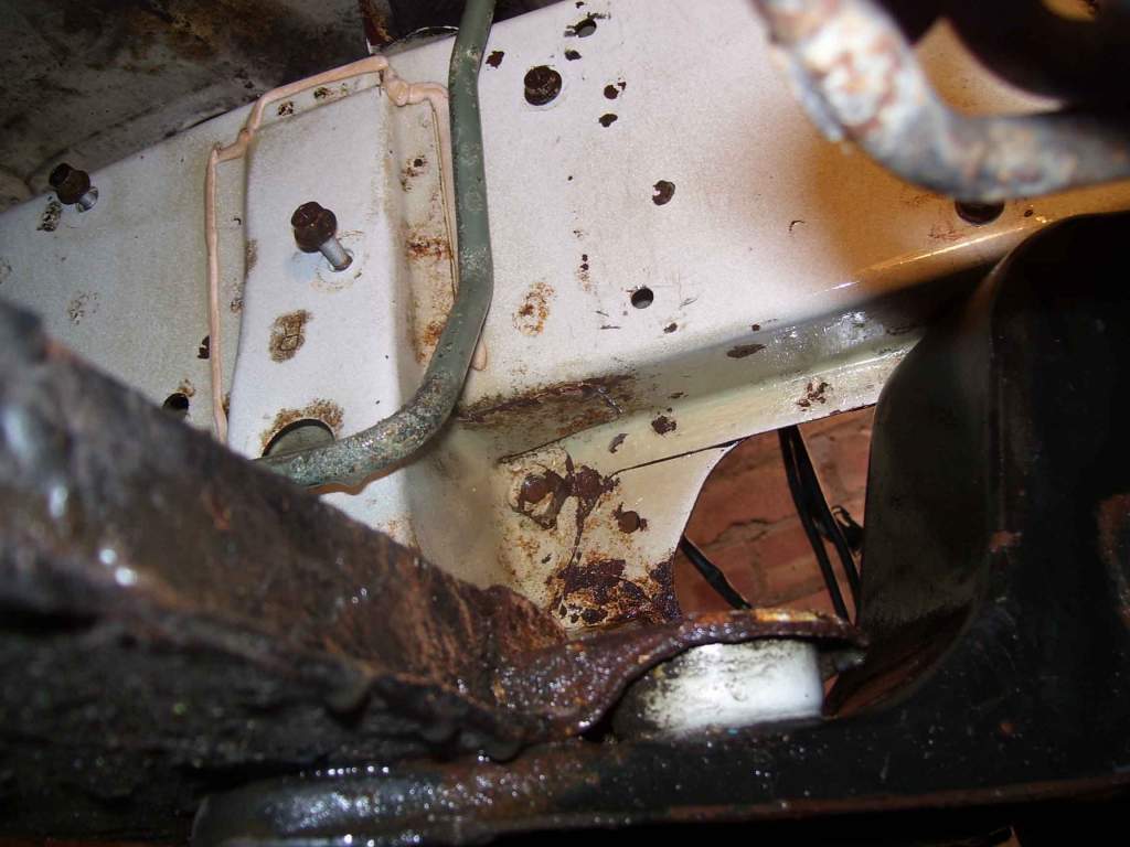

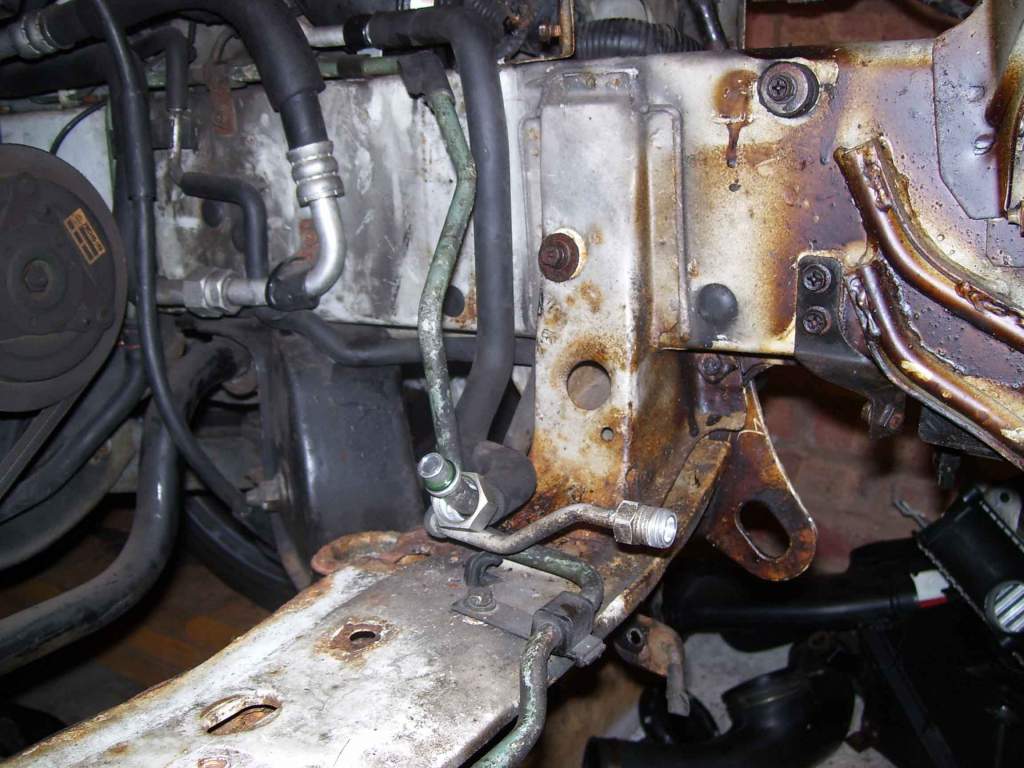

Yet again, another painfully frustrating 3 hours of joy, not!
Still, managed to get very close to completely clearing the way ready for removal.

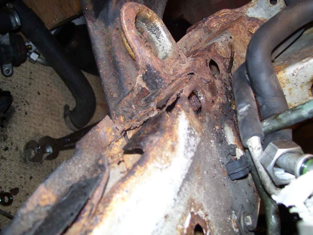

Also managed to get a better view of the corrosion. (bl==dy British weather)

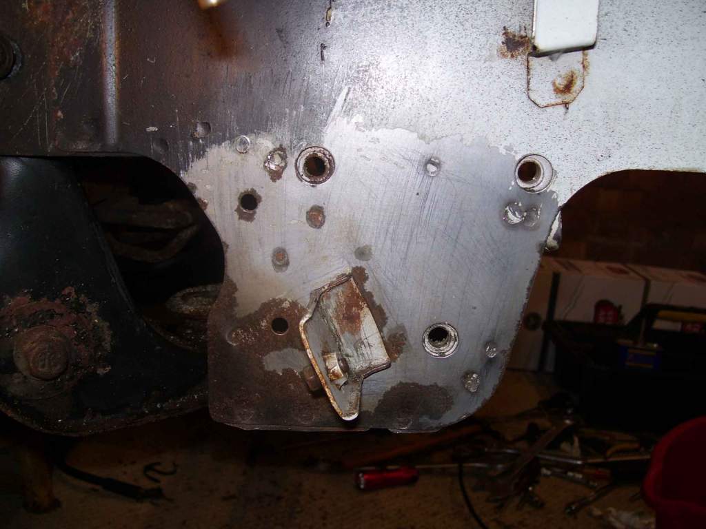

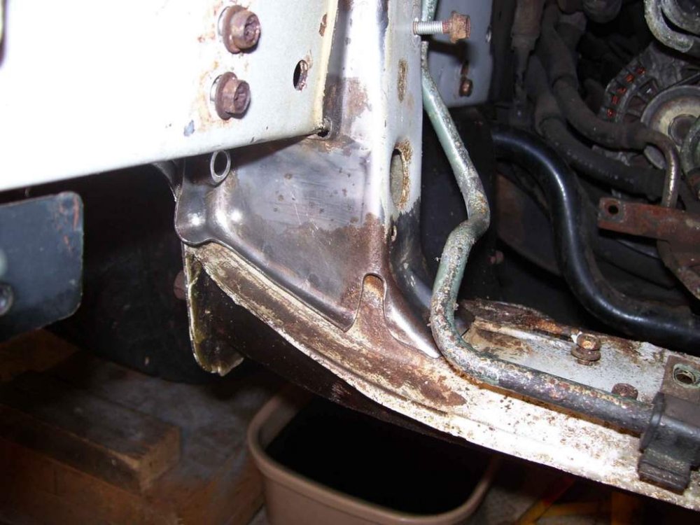

Started to clean away the dirt,rust and old paint this afternoon so as to locate all the pesky spot welds.
It's going to be a long job me thinks.
Looks like you could do with going even further. Be a shame to buy a brand new crossmember them leave surface rust on the chassis rail and inner wing. Shouldn't take too long to drill out the spot welds and pry it out. Good luck, I don't envy you.
Then go for a new replacement part mate, don't even consider a second hand part it's not worth the trouble, let the drilling commence (after a beer of course) :pint:
Agreed Steven, I will look at treating affected surrounding areas once I have the crossmember firmly in place.
As you say, it would be shame not to.

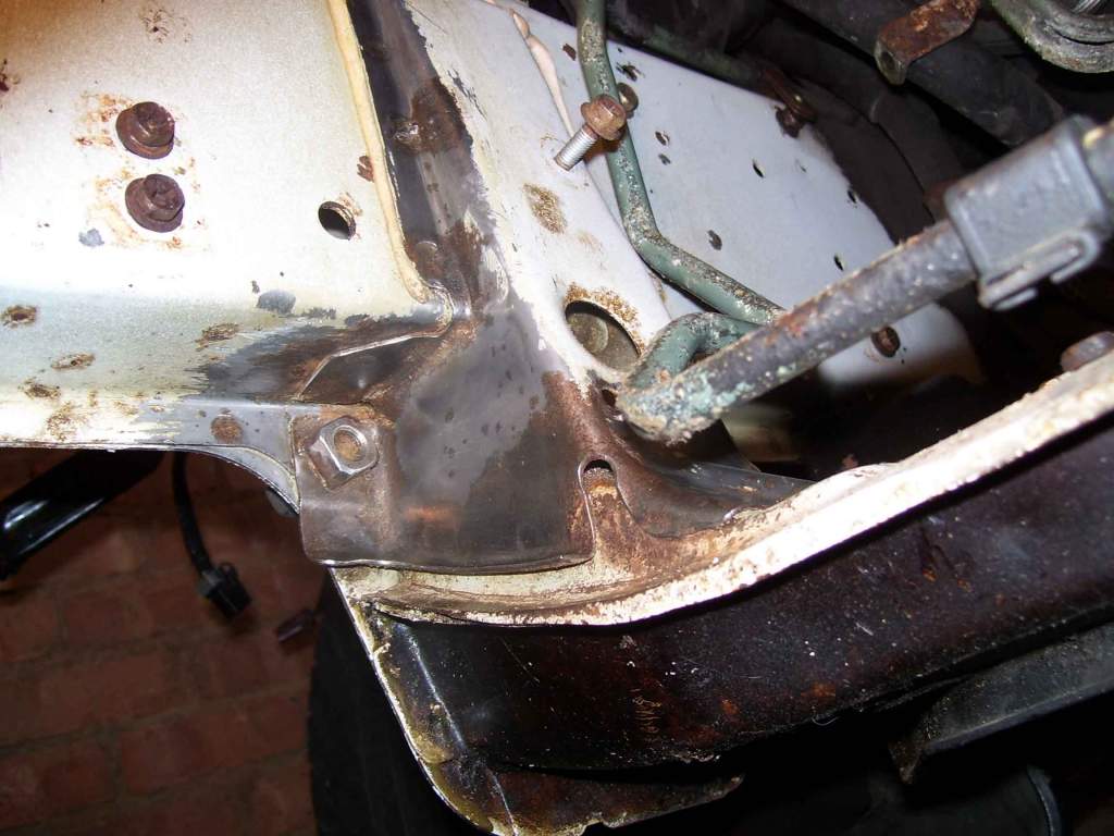

Well, after a couple of more hours scraping and wire brushing I have called it a day for now.
Pretty happy with my progress so far.
