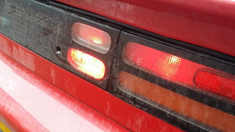

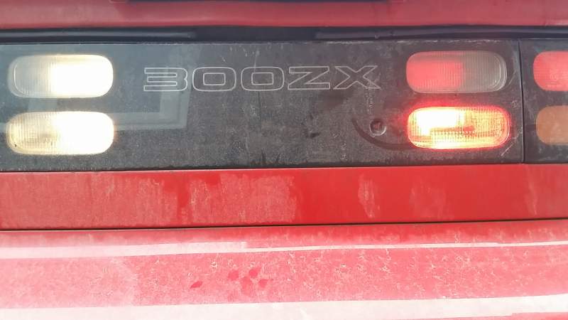

Wired up my reverse lights so I have a fog light at the flick of a switch. Looks brighter in person :)

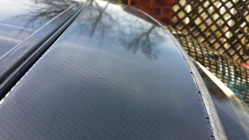

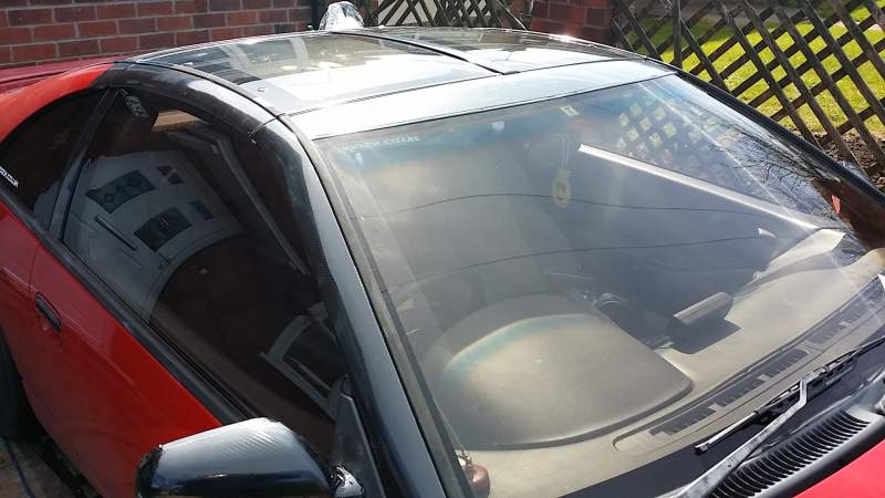

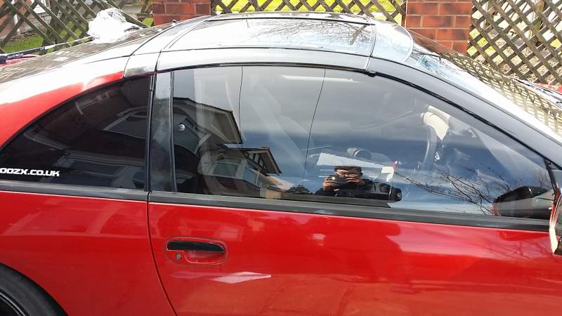

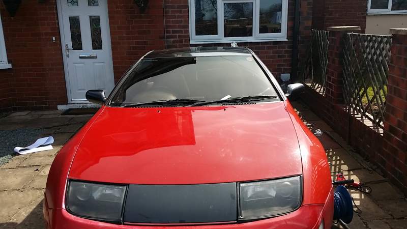

Because it's been such a nice day. I thought I would use some of my wrap ;)
Happy with results... gonna have bonnet done properly though.

Probably your car's way of saying 'get that sticky mess off me'. Why are your pillars and t-bar trim black...and filler cap for that matter? :confused:

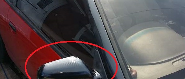

...and what's going on here?

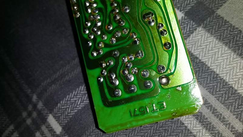

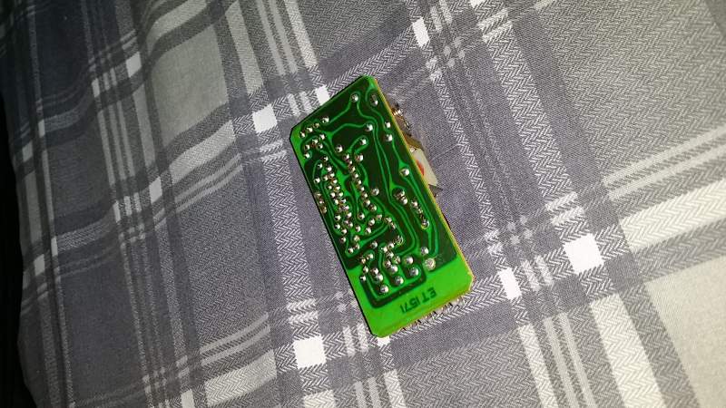

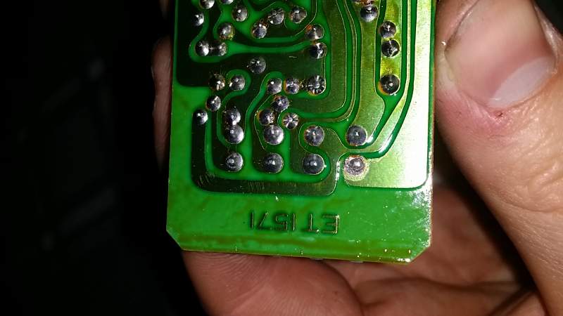

My drivers window wouldn't work the other day and thanks to Jeff tt. He sent me a link that fixed it. Cheers mate :)
