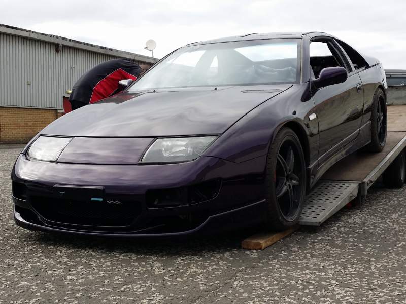

I've got 19s on mine at the moment. 255/35 rubber on the rear and 255/30 on the front as the 35s rubbed (standard suspension).

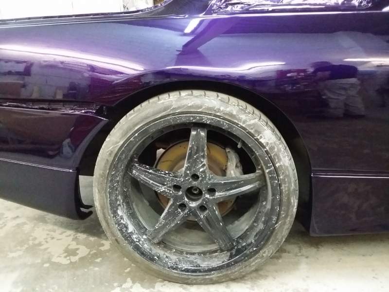

My fronts are 8.5" wide @ +20 with 245 35 19 tyres and the rears are 9.5" @ +25 with 275 30 19, but I do have the very top of my arch lip rolled which you can't see.

Depends what style you go for. My 19s don't look too big at all. Proportionally, the 2+2 with the right style looks better in 19" than 18" guise. I had 2 sets of 18" wheels before in a similar style and never felt it looked proportionally correct.
yours looks ok like just other 300s I have seen on 19s looks a bit to big and not rite for the car the rotas I have in 18 looks just rite
