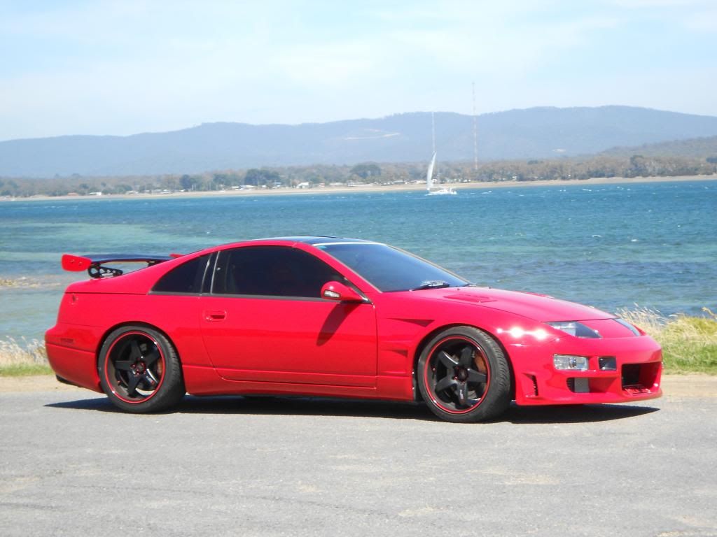

ozx 320, nice machine you've built there. What's the rear spoiler from?
They're the best thing you can do to the back end of any Z32 IMO.
rear spoiler is actually a Navan from a Y32 Cima. Wanted to retain something of a factory look, but wasn't sold on the z32 one, specifically how high it sat, and the angle it came down on. The Y32 variant is more flat, overall thicker, incorporates an LED brake light and more complimenting in shape in my opinion.

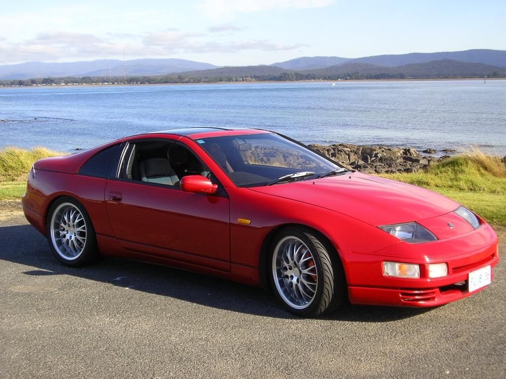

This is the other one. 1995 J-spec 2+2 TT. 75000 original k's on the clock. Previous owner imported and briefly used as a race car, before running too much NOS and losing cylinder #6. In the process of pulling all of the illegals off and reverting back to stock-ish. Replacement motor being assembled- forged bottom end, mild cams, head work, o/s valves, 650 injectors, 2560R Turbos
... and yes, modified TBO front bar and FMIC combo have been removed in place for a stock TT bar and larger SMICs
