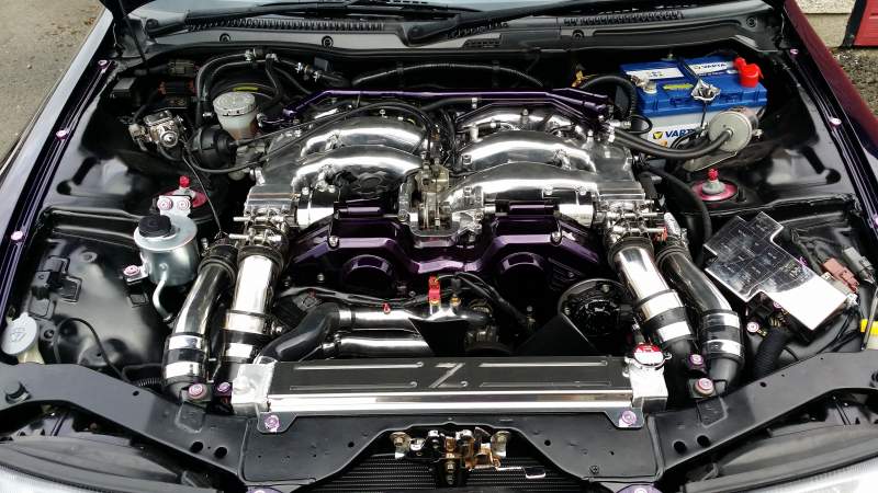

Regarding your video and the high pitched noise...it sounds like the alternator bearing. Mine failed earlier this year and the initial noise was identical.
One of the few design issues with our cars is that the water pipes sit directly above the alternator so if there have been any leaks during the life of the car, the alternator gets an early bath which dries out the bearings.
Hope his helps.
Stunning car by the way, top work.
Good call :yes: My alternator bearing was making a high pitched noise also and I got it refurbished. Check the power steering pump also Lee.

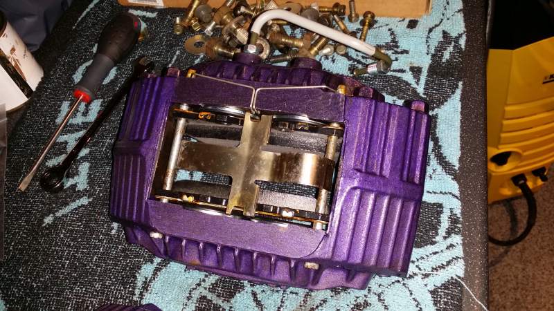

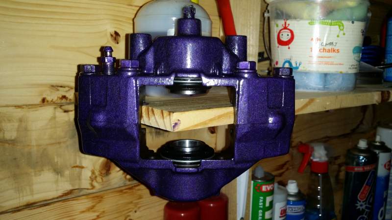

Spent a few hours last night pulling off the old brake discs and callipers to fit the new ones over this weekend.
But bugger me it was a hard job as the back left side decided to have a collapsed hand brake shoe which jammed on.
After 30 minutes of struggling with it we finally got it off and repairs the shoe but putting the wee pin clips back in.
New discs all round and just need to fit the painted callipers.

Did you not have the little drilled and threaded holes on the disc hub? Wind a bolt in and off the pop? Or were they that seized?
yeh,
We eventually did that but still took a while as the brake shoe basically fell off inside and was wedged at an angle.
Oh you gotta love stuff like that! The five minute job that becomes a three hour task because of one pissy little bolt etc.

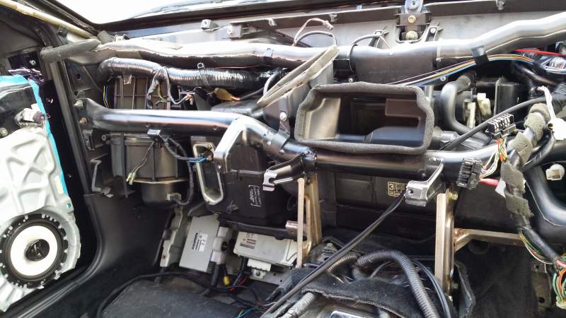

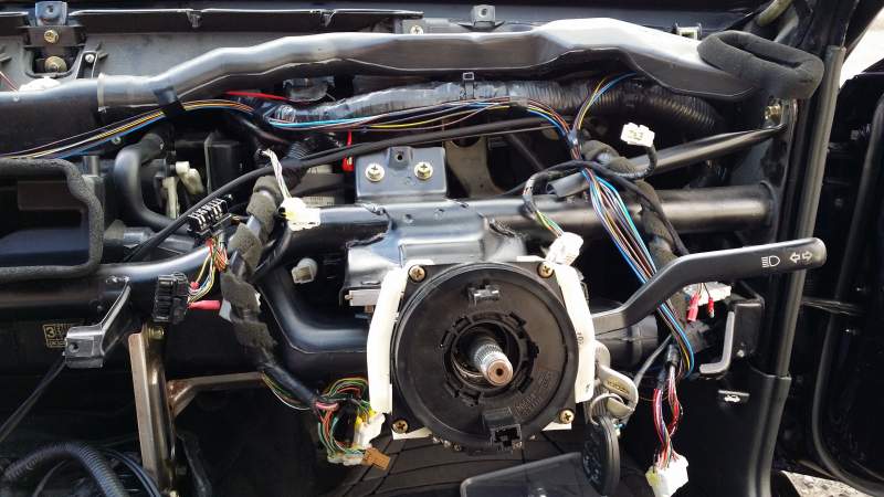

So had a few electrical issues needing resolving with regards to an immobiliser and extra cabling
I installed and after 20 minutes if fiddling running cables I decided it was much better minus a dash.
So out it came; again :
Also took the opportunity to properly route some cables from the boost controller.
All in I think I can do this blind folded nearly as the dash was off and on again within an hour or so.
