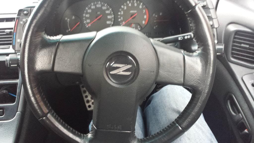

FAO FunkiSi - 350z steering wheel fitted
Si, you were curious as to what the wheel would look like once fitted.
I got round to finishing it today.
I covered the normally silver bits in faux leather that Si from Hide n seat kindly donated to me.

That faux leather looks like a decent match, Al. :thumbup1:

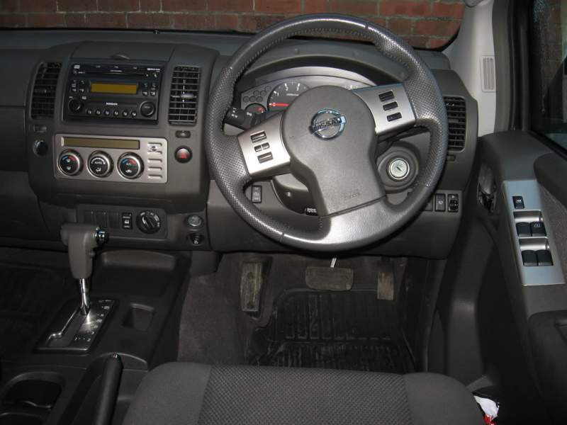

i dont like it but thats me. its pretty much the same a navara steering wheel. you should get a complete steering wheel with buttons to work with your stereo if you are going to keep that steering wheel. the nissan logo looks alot better i think :)
