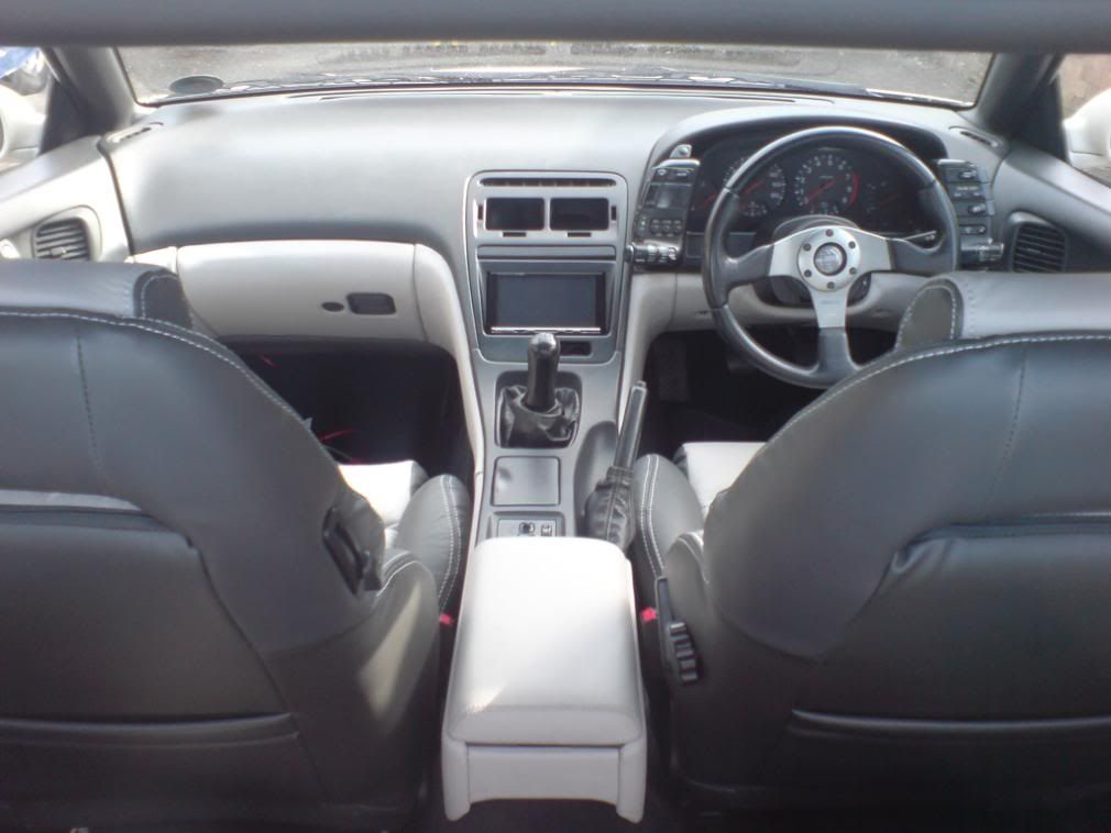

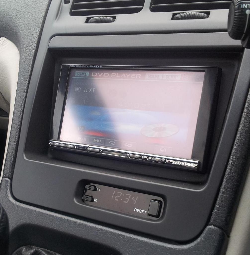

I went out and bought an Alpine IVA-W200RI touchscreen and ordered a double-din fascia from z32-zone in Japan - the first and only one of these to be fitted over here that I am aware of - this was back in 2008, long before Zthirtytwo were about.
I fitted it all at the same time I did the retrim -

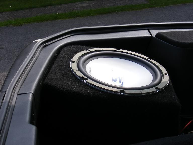

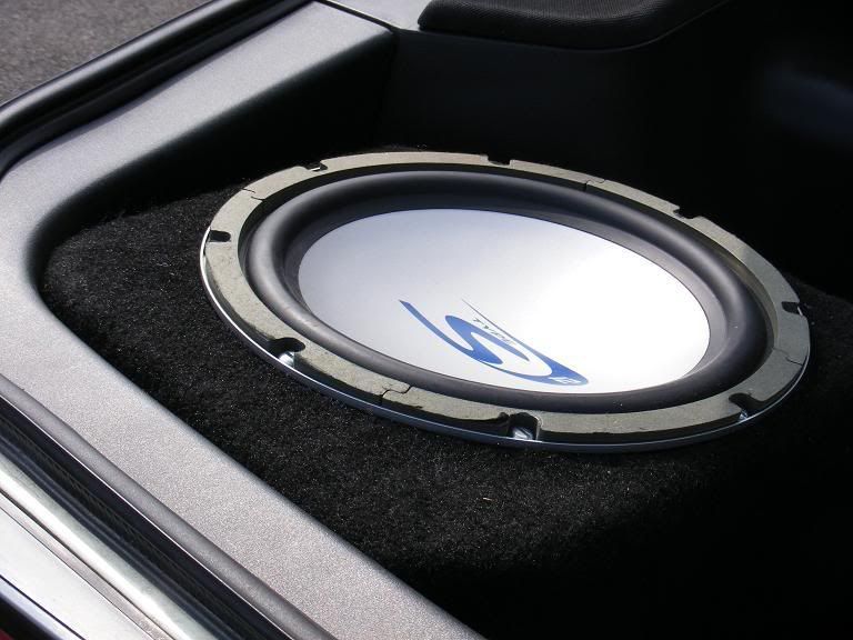

I hated the lack of bass in the car, so bought a nice sub box and 12" Alpine sub and a Pioneer amplifier.
This made the bass a lot better, but mid-range and general clarity of the rest of the system was just pants. I then grew to hate the sub and amp. I like having the boot space for when I go touring and I really don't like having a huge great big speaker there. Every time I opened the boot, I was worried someone might see my 'phat sub', so it had to go as I couldn't cope with the embarrassment.

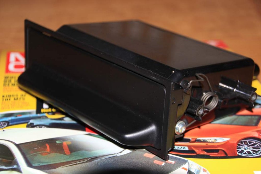

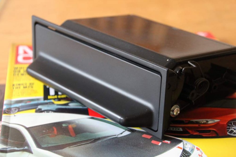

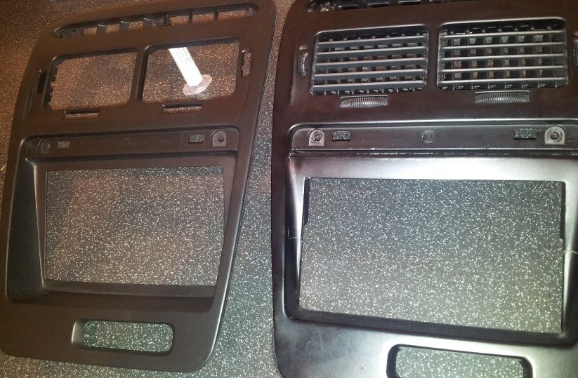

First things first - I was never happy with the z32-zone 2 din fascia. It was a 'remanufactured' OEM item and was looking a little tired - so took part in the GB for the Zthirtytwo 2din fascia which is much better. Excuse the low-level light ouput of the head unit. A combination of angle and having it set to -8 brightness didn't help!
New Vs Old

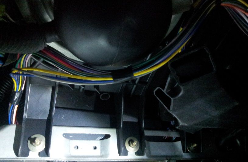

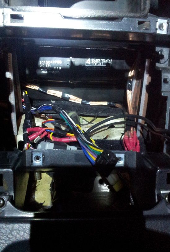

I stripped the passenger footwell out for access and unhooked and moved the main car harness which gave me enough room to fit the amp behind the lower strut bar. So it's very neatly hidden and still has relatively good access to ambient air - it's a digital amplifer, so it doesn't really need it. Alpine give you long enough looms and connectors for you to be able to run this amp to pretty much anywhere in the front of the car.
I haven't finished installing the cabling, but it's routed, just not secure. I wanted to power the unit before I did all that! If you see the metal bar at the lower half of the pic, you'll see a little black box behind it, that's the amp! You can see the cable feeds too and from it.
That cables are then routed back to the centre consol area and you plug the Alpine HU loom into it (which mates with the ISO connector) and then you plug the other lead which comes from the other side of the amplifier directly into the back of the head unit (which is the only flying lead that you need to utilise). It's all plug and play and actually frees up a lot of space behind the head unit. I was then able to strip out any unnecessary wiring and tidy up the speaker cables. I also added some edge grommet to those horrible metal reinforcement spars to protect against cable chafing. I actually want to ditch all of those bullet connectors - but not too sure whether I want to hard-wire the ISO loom to the Alpine loom.....

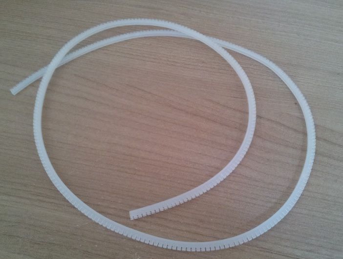

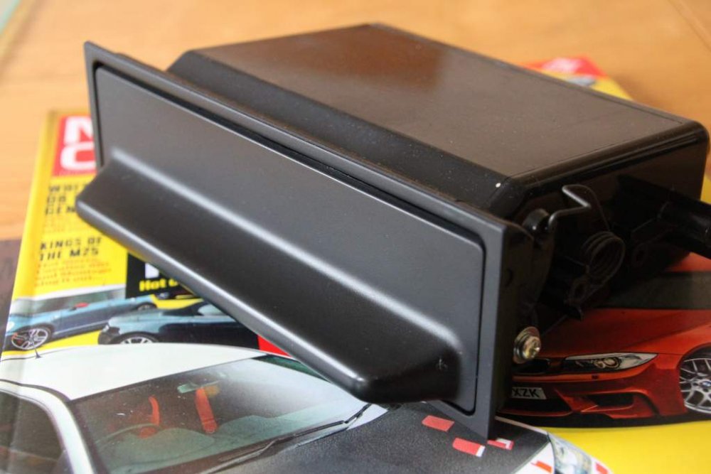

This is the stuff I used as edge protection - pretty decent stuff to fit and is pretty secure.

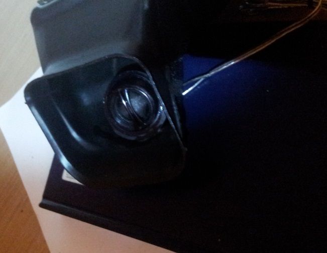

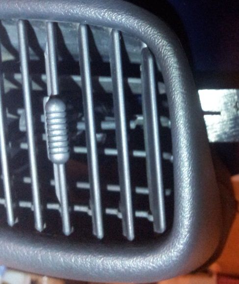

What I've also been doing is planning where to put my tweeter (ooooh err!). Now the tweeters supplied with these particular speakers are really not very elegant looking, nor do they come with a nice enclosure. These are designed as a replacement for OEM fit tweeters for existing housings. They're ugly and I sure as hell don't want these sticking out of my door cards (which was the original plan). They're not able to be flush mounted, so they'll have to be hidden away!
Because the hardware that came with them was also limited, I just had to hide them away completely.....but where!? I took an idea from JoelyP who has made up a bracket that sits behind the air vent in the doors which the tweeters are mounted to projecting sound into the cabin by way of the vent. Quite ingenious. I changed that design ever so slightly and decided to mount them on the side of the vent ducting in a modified tube (supplied).
They now sit proud and sculpted into the ducting. I've had to mount them like that as the ducting itself has a channel guide for door mounted cables. Anyway, my idea is very similar to Joel's, but gives a little more access to unhindered airflow as they take up a little less space and are quite aerodynamic. The tweeters are angled so that the sound is projected into the cabin. The vents are at a reasonable height and angle themselves, so should sound pretty good, certainly a LOT better than my old setup!

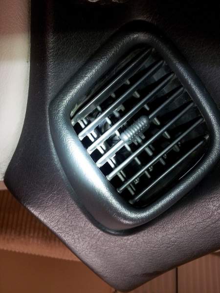

You can just about make them out behind the vent here. When fitted in the car, you'll not be able to view them at all. In addition, even if the vent is moved to an extreme angle, the tweeter still has a sound path. Under regular airflow angles onto the occupants, the tweeter has an excellent sound path. I'll get some better photos once the tweeter enclosures have been finished as they've not been sealed in properly yet.

Tweeter finally installed in the duct which has now been fitted to the door card. I've trail fitted the door card and all the wiring clears!
Anyway, here's the little beastie hiding away there! This is with a torch shining inside it at an obscure angle. You can JUST about make it out, but it's very well hidden, but close to the aperture. I've now fitted my AndrewG-routed speaker spacers and have glued them in with a strong black silicone and smoothed that all off, so that it's nice and neat. Speakers will be screwed through the spacers and the bracket. I've offered the speakers in and the speaker chassis doesn't make contact with the bracket. So my continuation of having everything fitted neatly and out-of-sight is continuing!
