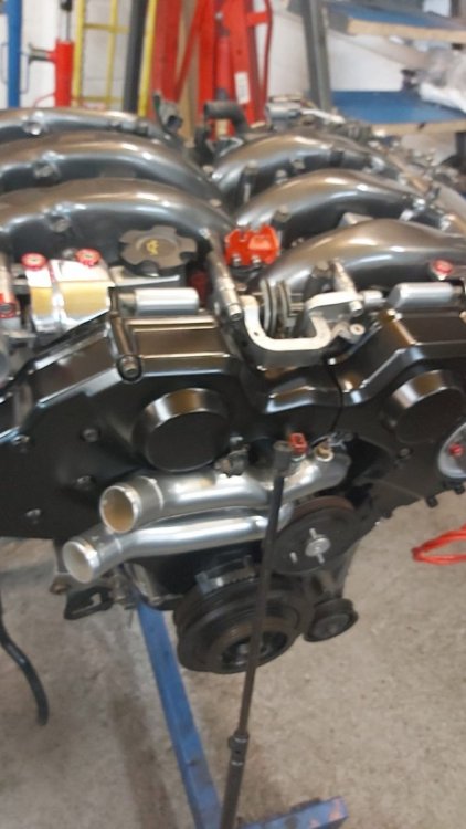

Took many items off my engine and have sent them to a metal polisher just a few miles from me and below are the results of his and my work :cool3:.
This is my aftermarket radiator bracket, it was or is stainless steel but now highly polished. The SLICKTOP plate was made by TwinTurboRich and I've had this powder coated and bolts on with some stainless steel allen capped nuts and bolts.
This is my Tokyo Auto cooling panel, original these come in silver or blue from z32-zone in Japan, mine was silver and the polisher told me it was anodized but now polished up as you can see. The logo was originally silver and riveted on, I drilled these out and had it powder coated, again bolted on using the same attractive stainless bolts.
Then the usual polished up water pipes, these will be used with red silicone hoses and mikalor t-clamps
Finally for this post, had my Altia sills polished, this removed many many scratches incurred from over the years, now I have a mirror finish.

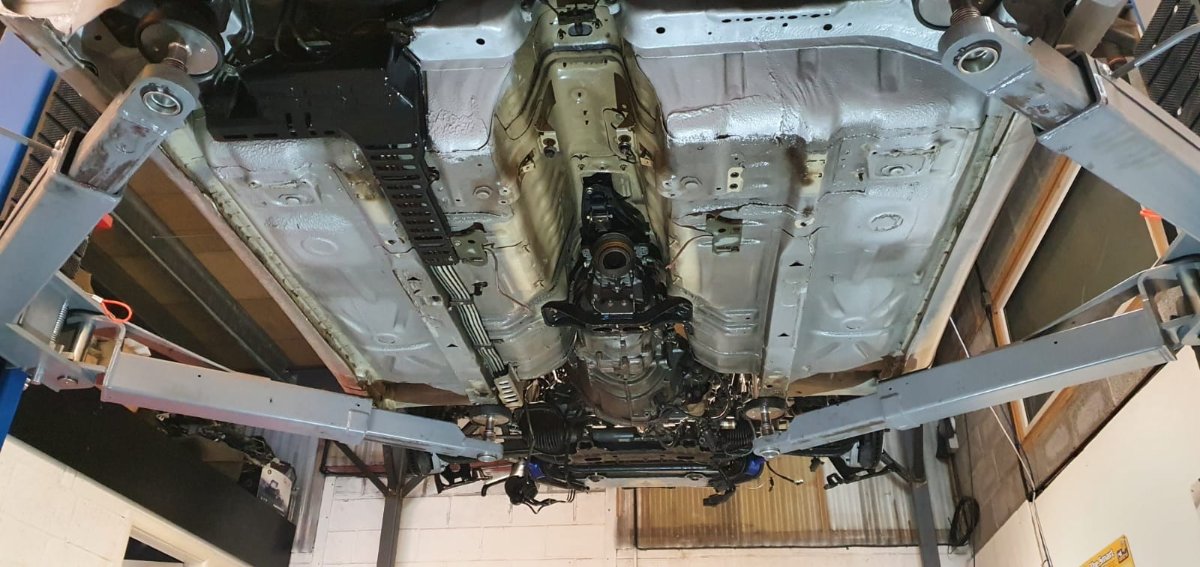

  • Although this 95 is incredibly clean and we want it to stay this way, Jim has been underneath it, scrubbing, cleaning because he bought a Rust Buster Epoxy Kit in Silver Aluminium which is not far off

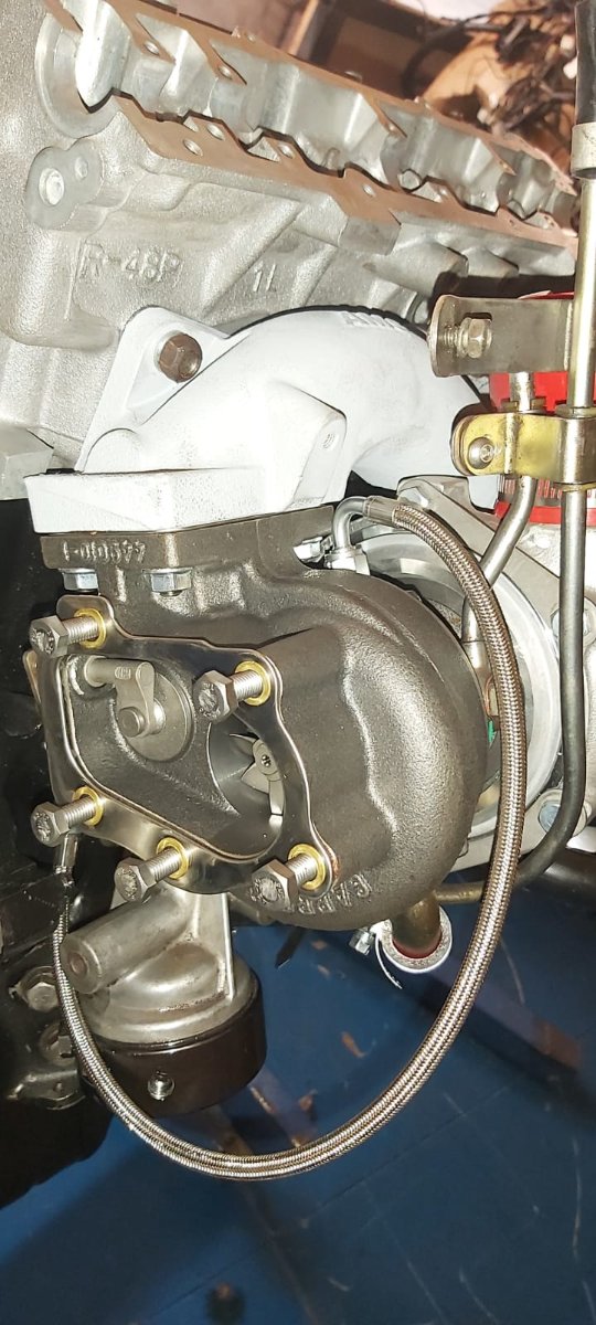

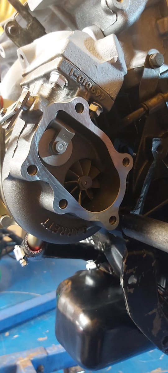

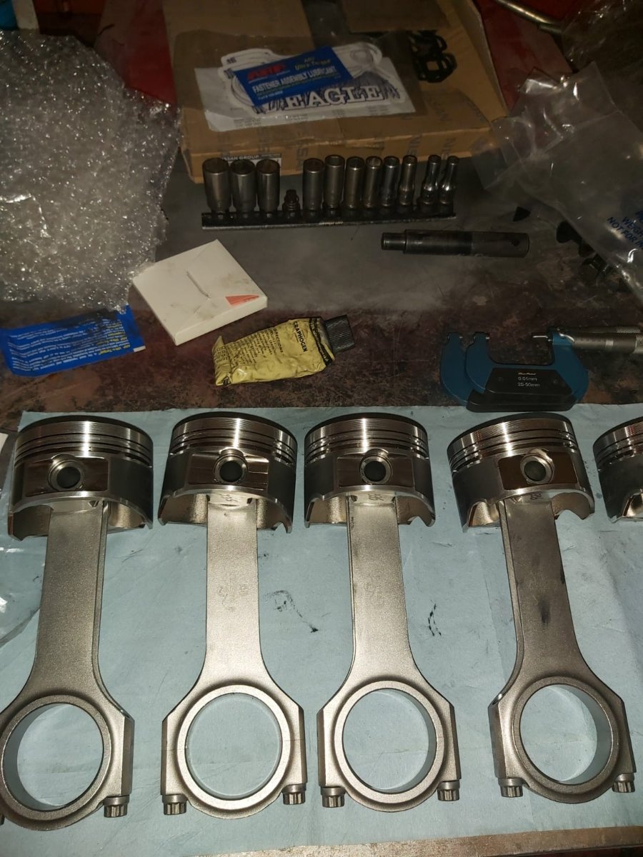

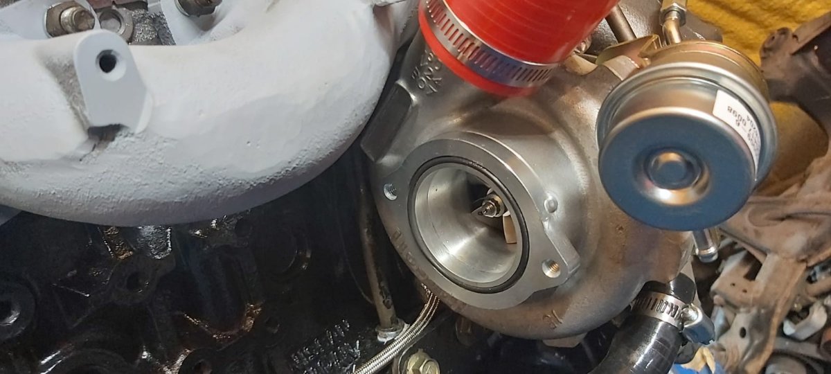

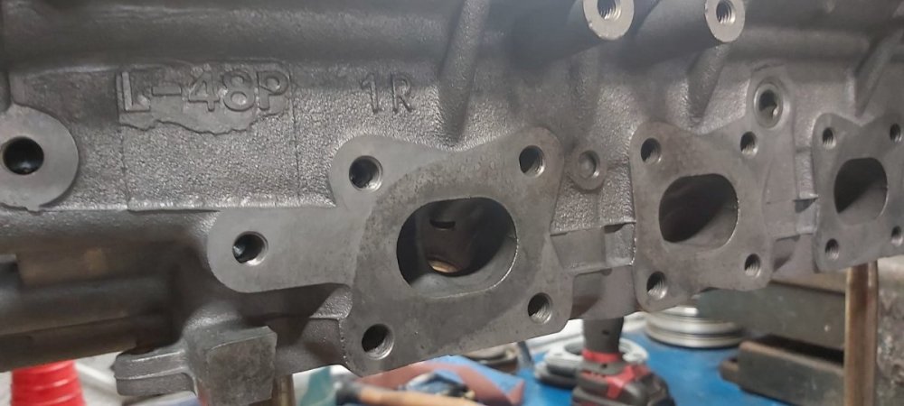

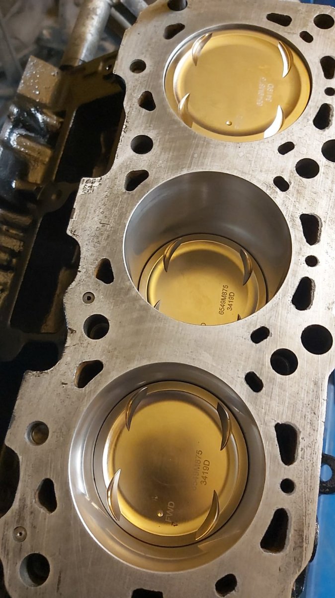

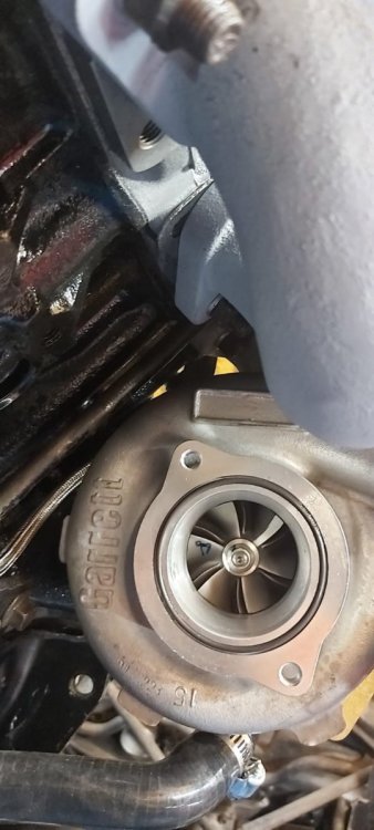

The engine has been totally rebuilt with 87.5mm Wiseco pistons with Eagle rods.

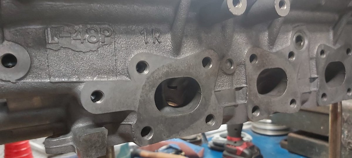

Same 48P head as before, later series this is.

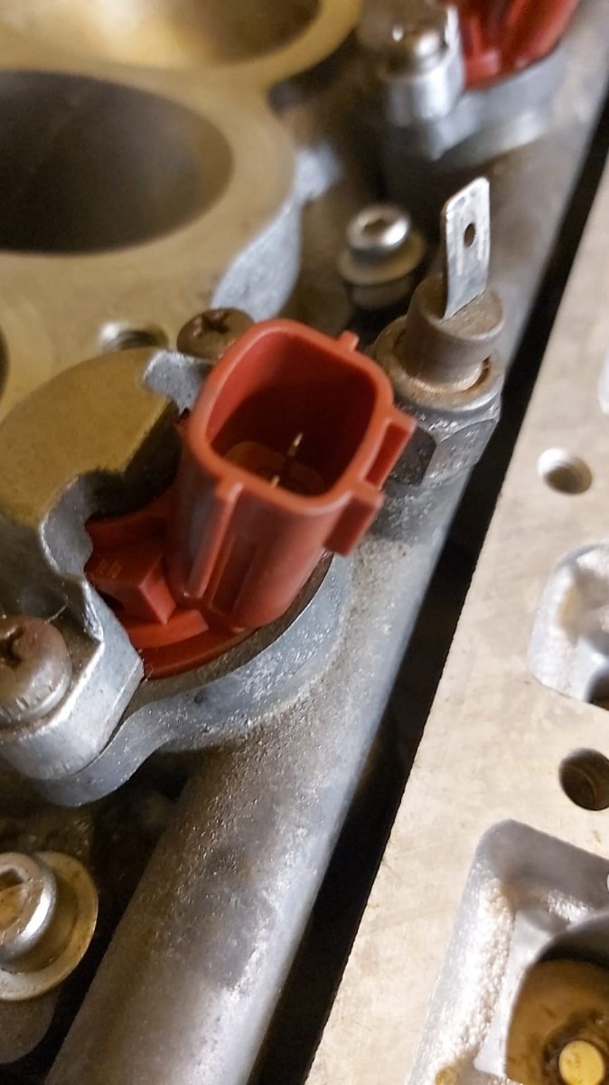

850cc Injectors.

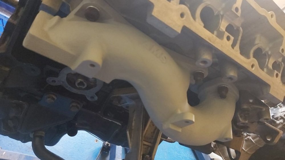

AMS Manifolds.
Z1 Urethane Engine Mounts.

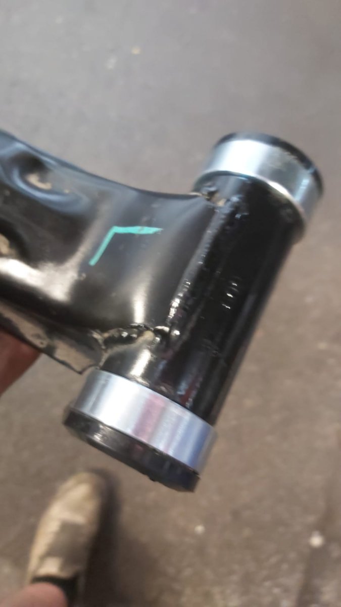

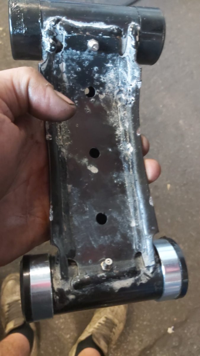

The OEM fucas with adjustable whiteline bushes is the way I'm going. Just finishing up painting the arms and waiting on KCA336 being delivered.
Can you clarify something for me though - I though only the KCA336 kit would be needed? What's the reason for the KCA348 kit too?
I’ll be lowering mine but nothing silly, I believe the kit is to correct the negative camber that I’ll create.
Also, Jim said buy, so I bought and plus it was only £70.

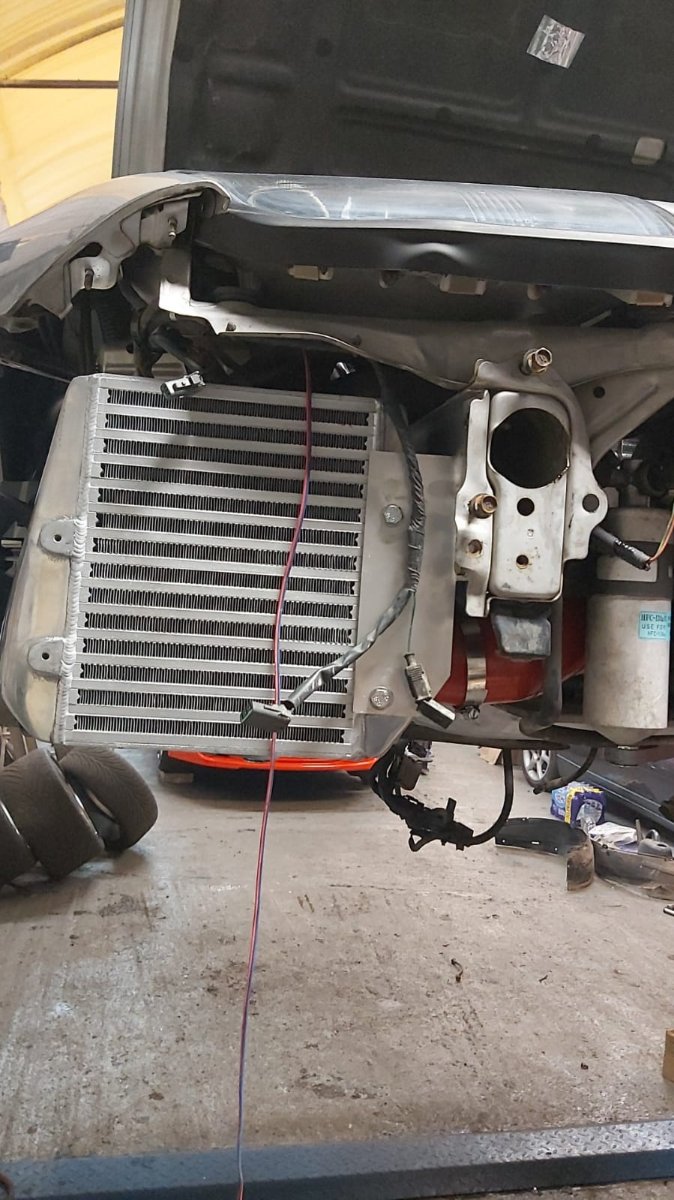

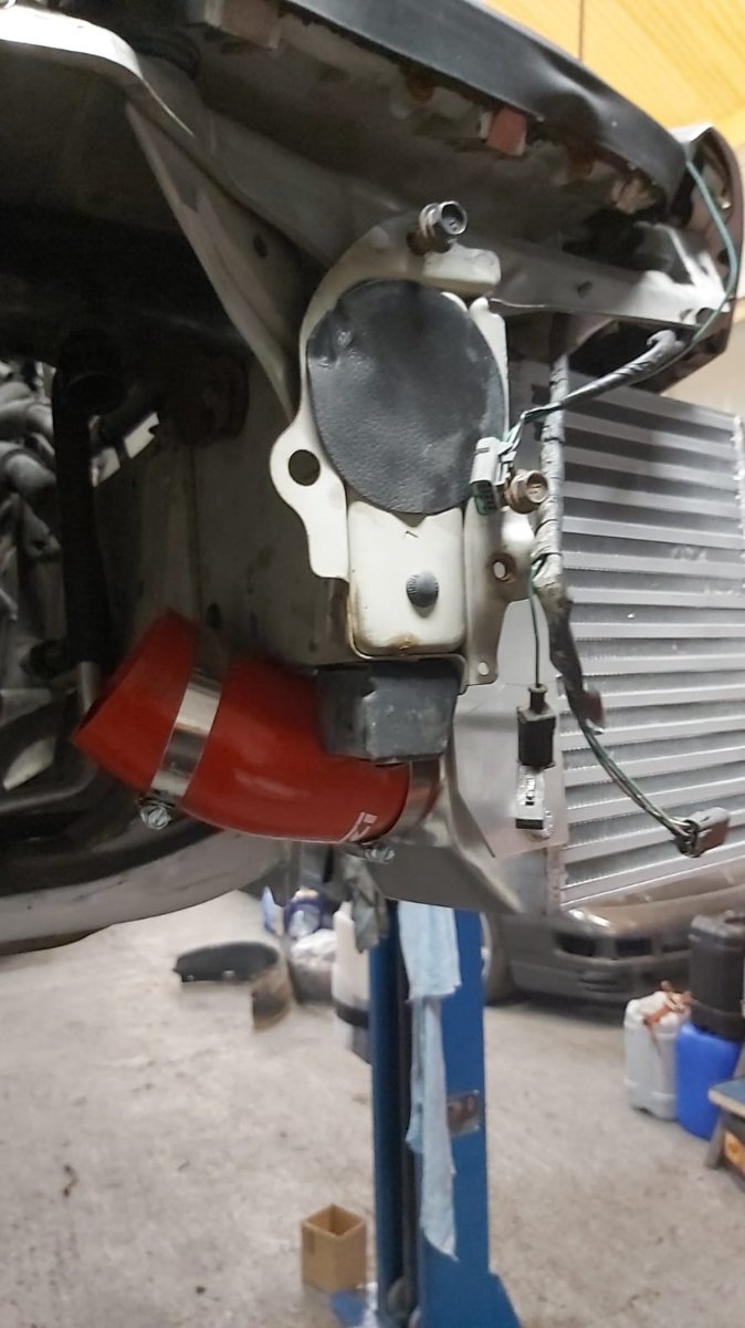

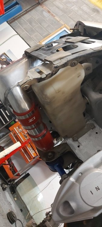

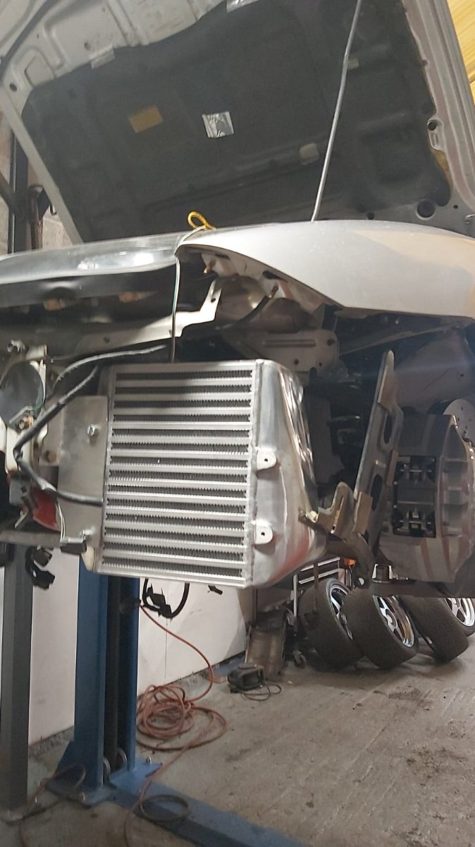

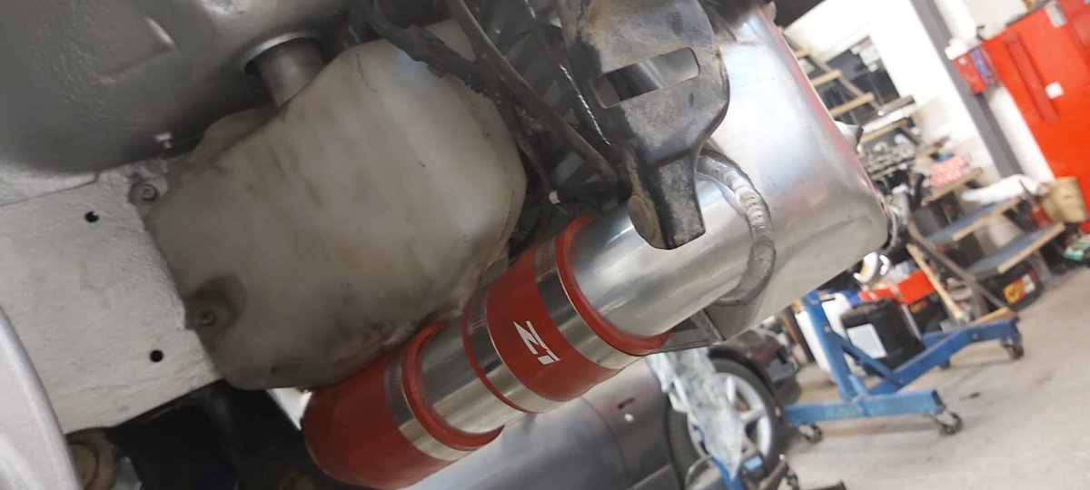

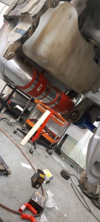

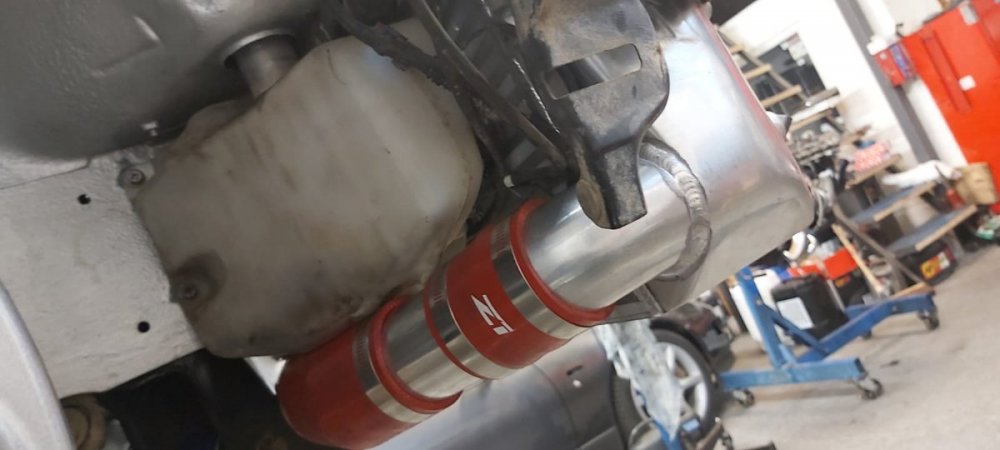

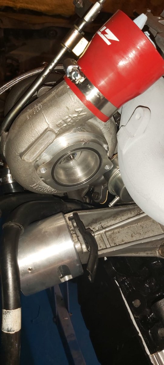

10 years ago I upgraded to Pace side mount intercoolers but things have moved on.
I now have this kit from Z1, the B.A. sidemount Intercooler Set, as you can see I went with the red piping.
