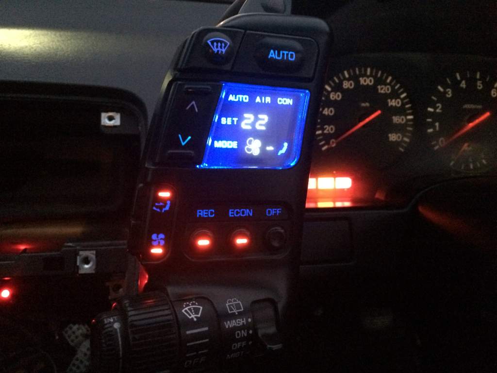

  • More also on the digital AC in the days to come, I always had the manual pod on the 94 but with the white 95 providing the digital one I have migrated the full loom from that LWB into my 95 SWB, this

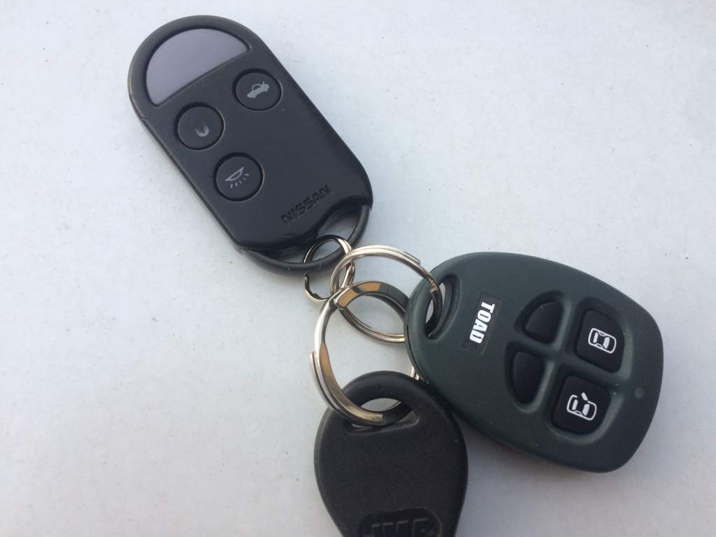

Sadly Bones28 (Tony) wrote his 1995 off but we liaised and he mentioned I could have his genuine keyless lock remote which he kindly remembered I was struggling to get hold of quite recently, we liaised further and ended up swapping something I had for the remote and I was only too pleased to do so.
My 1995 donor which is all kitted out, solenoid in the boot, etc, but I was missing the factory remote, I did buy a 'replacement' remote but after briefly trying I could not get this to work.
So I sat in the drivers seat and went through the programming procedure and it only works an absolute treat :yes:. Thank you Tony once more.
It locks and unlocks the doors, it releases the tailgate and it also turns on and off the cabin courtesy light.
Here it is top of the pic, you can still use another for the alarm as you'll notice in my case it's a Toad but i'll sort all that out when it is all migrated into my same series 1994.

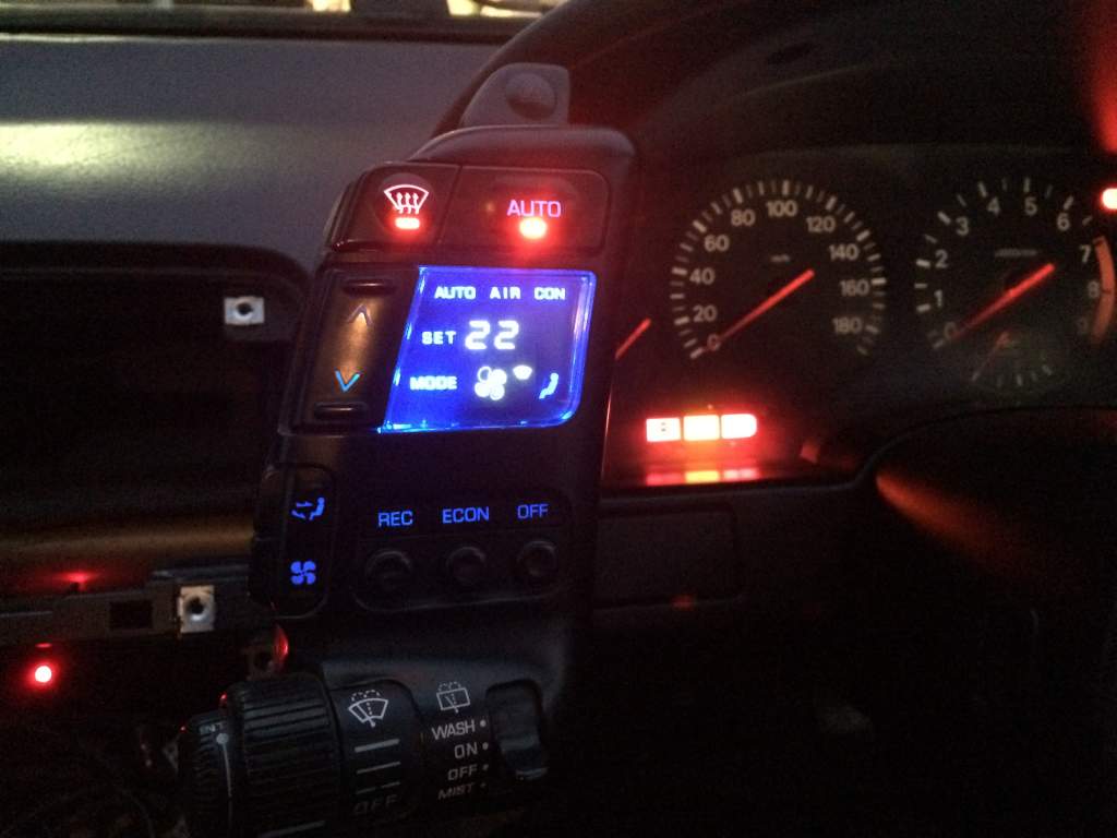

Secondly today, my donor has the late series optional extra of a digital pod but it's completely factory so the lighting on it is poor and not in keeping with a red blue theme I have going on, this I would of done at some point myself.
However, I spotted another directional one on ebay, as a bonus advertised as having a led conversion and here it is for testing purposes in the donor below, i'm going to presume Groover has had it in his hands because it is in a red and blue loveliness, so I don't need to do a thing with it :).

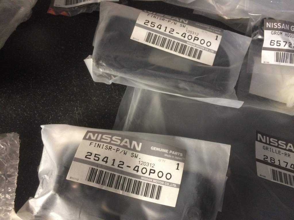

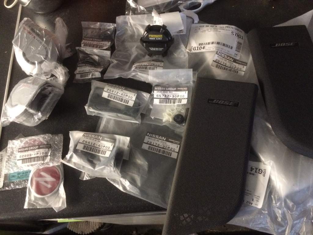

Just having returned from the US, I got an order delivered to my hotel from Nick at CZP, superb to deal with btw...
Here's my purchases, top left we have the Nissan sports universal horns, 65722-30P10, I have the oem covers for these as well.

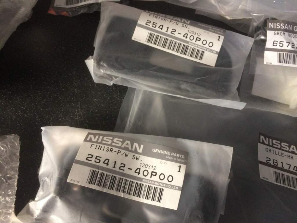

What prompted my order was that I wanted the RHD LH window finisher, not many of these left in the world I believe, so I bought 2 !!!

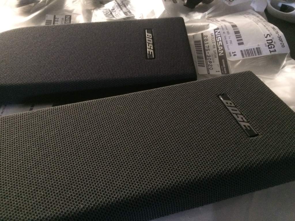

My Bose speaker covers were recovered a few years ago with black tights, actually worked very well !!!!
Spotted that they were available so bought a pair, 28175-30P20 and 28174-30P20.

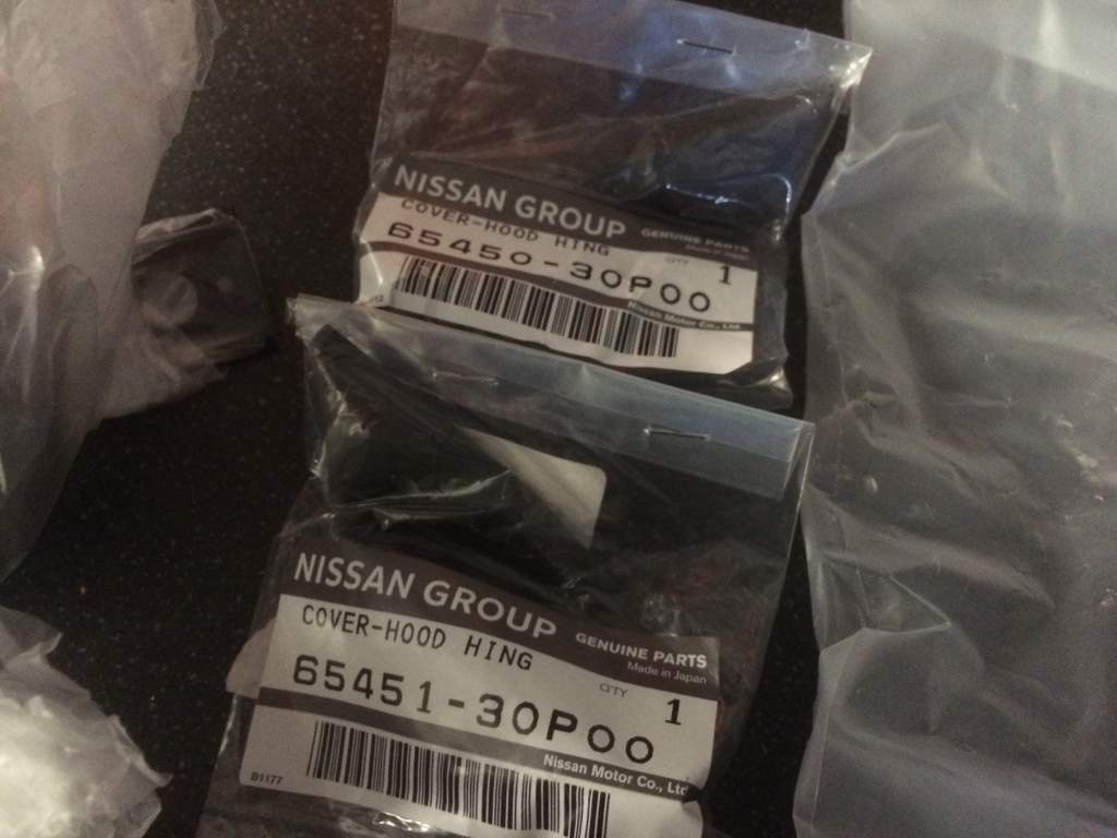

Same as the Bose covers in that I did have some vgc bonnet hinge covers but bought some more.

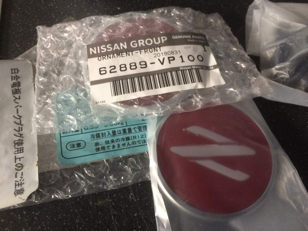

Another brand new red ornament bought...…..

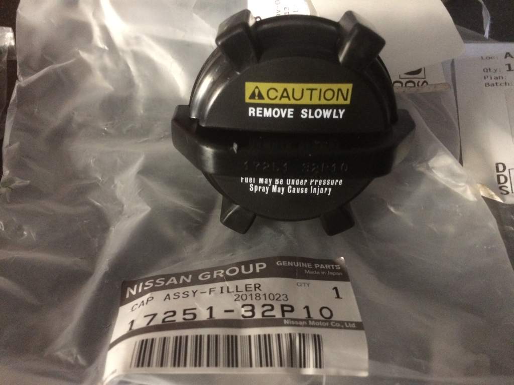

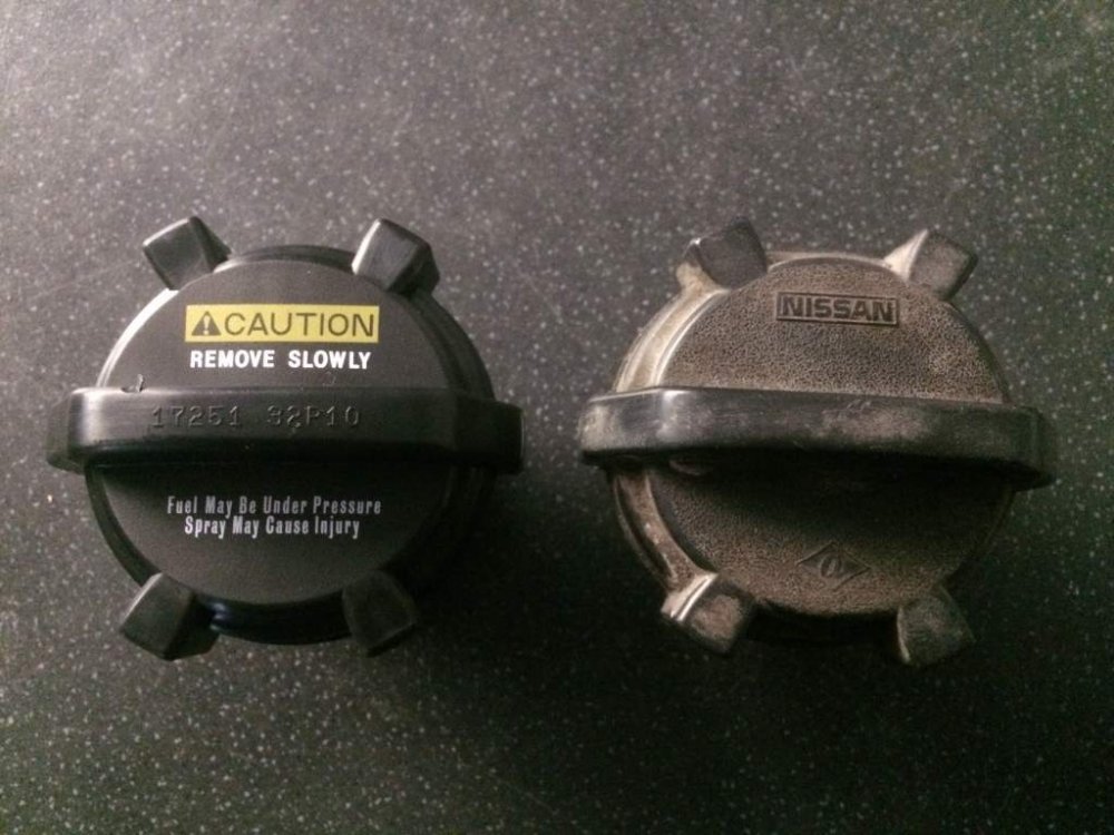

I've always liked the petrol filler cap with the writing on, I now own :cool:.
And here it is against the 'tatty' unclean old one !!
Andy...If you feel the urge to offload your duplicates...I would be very interested in your 'spare' RHD LH window finisher....I had one on order for 8 weeks only to be told it was NLA :no:
[sIGPIC][/sIGPIC] "Exaggeration is the enemy of credibility"
The urge is not very strong !!
When I first talked to czp, 5th Feb 2019, Nick said they were showing 4 switch finishers in stock, of course I have two of that stock now, might be worth enquiring.
EDIT: I had to reply to czp just now, so I asked about stock levels for you, watch this space !!
EDIT 2: Another one bites the dust....all gone.

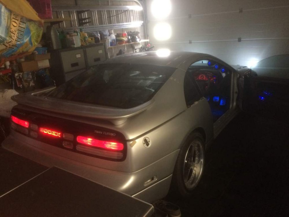

Some things are happening...…..both these will be on the move very very soon :sneaky2:.
Put a few parts back on, tested this and that, watch this space, back in the room !!
I drove it around the block a couple of times for old times sake, it felt lively or I drove it aggressively, one of the two, what will it be like after the upgrades :wub:.

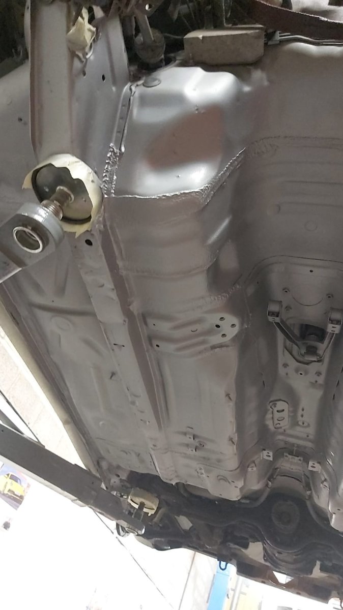

I'll go through things in the order Jim has sent me pictures and/or done them, so I'm going back into last year and eventually I'll catch up. This has been purchased
Driftworks Total HICAS Eliminator Kit with Rod Ends for Nissan 300ZX Z32 90-96

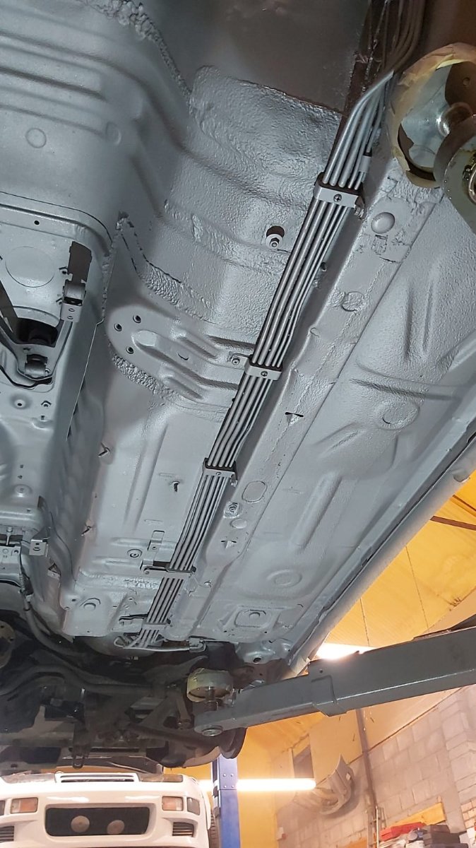

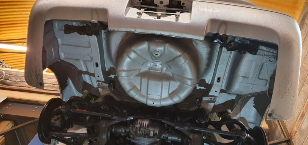

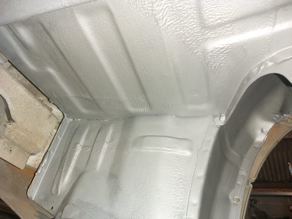

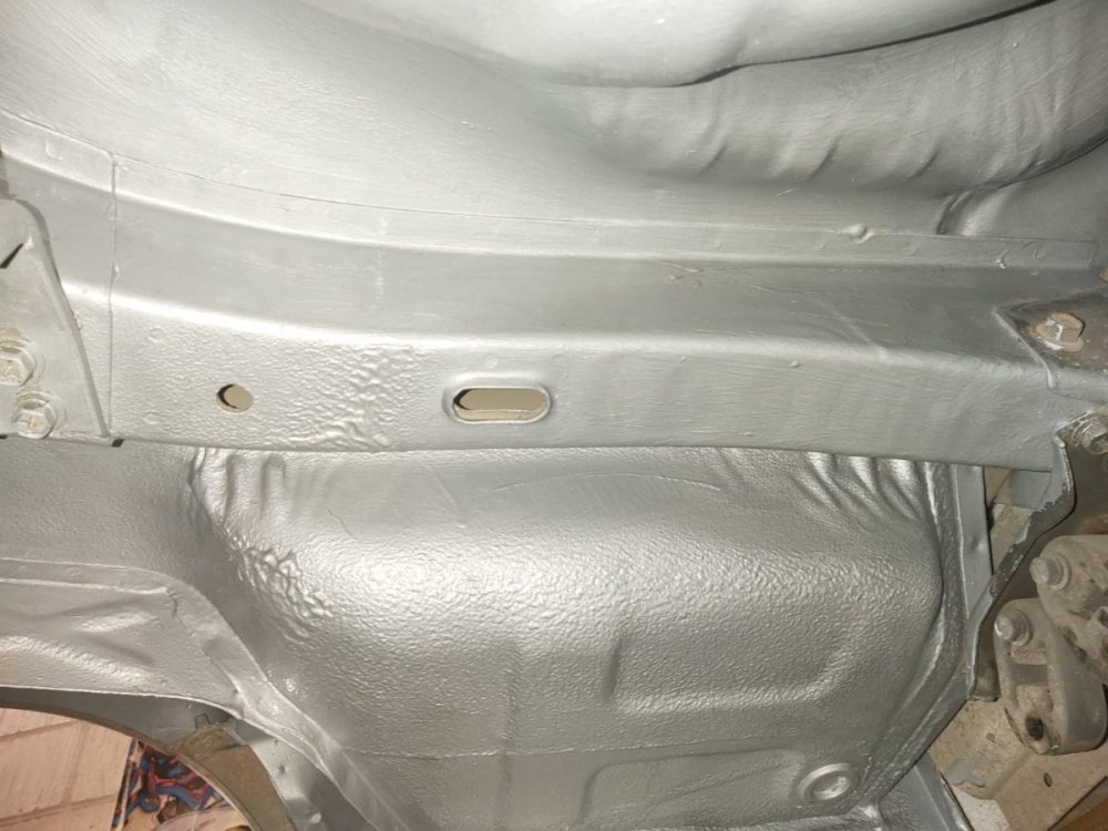

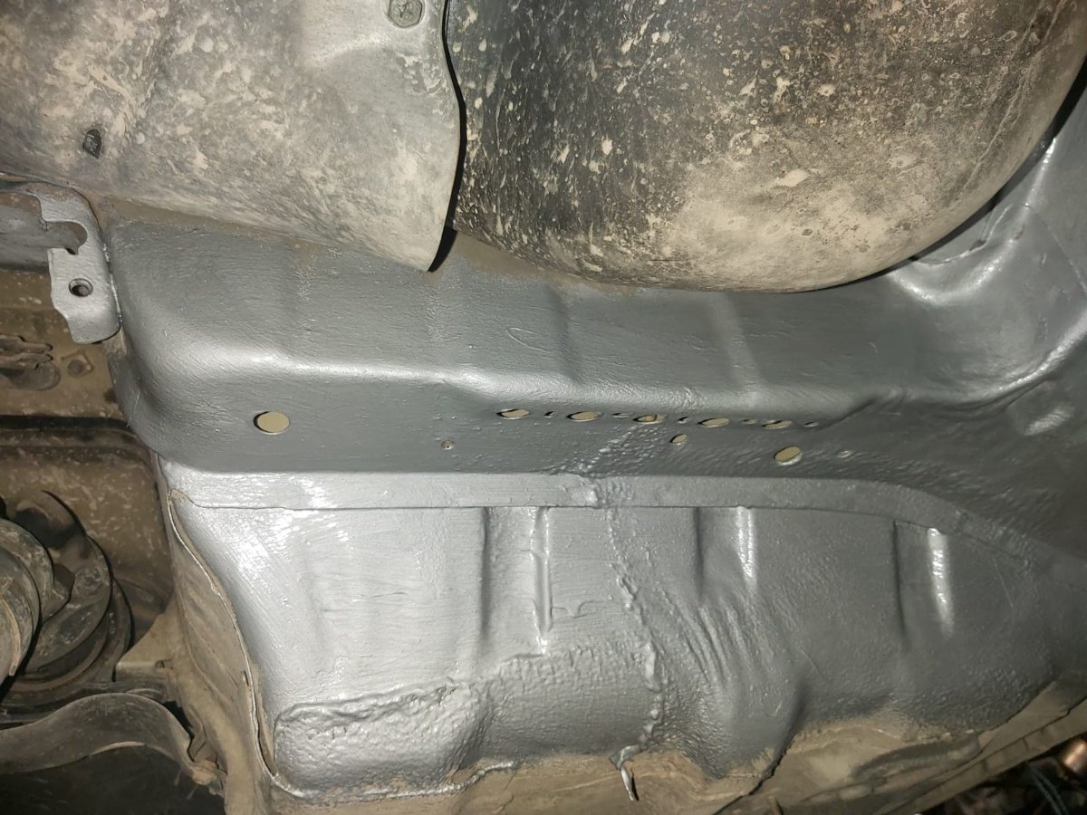

Although this 95 is incredibly clean and we want it to stay this way, Jim has been underneath it, scrubbing, cleaning because he bought a Rust Buster Epoxy Kit in Silver Aluminium which is not far off a factory colour and here are some pictures after application.

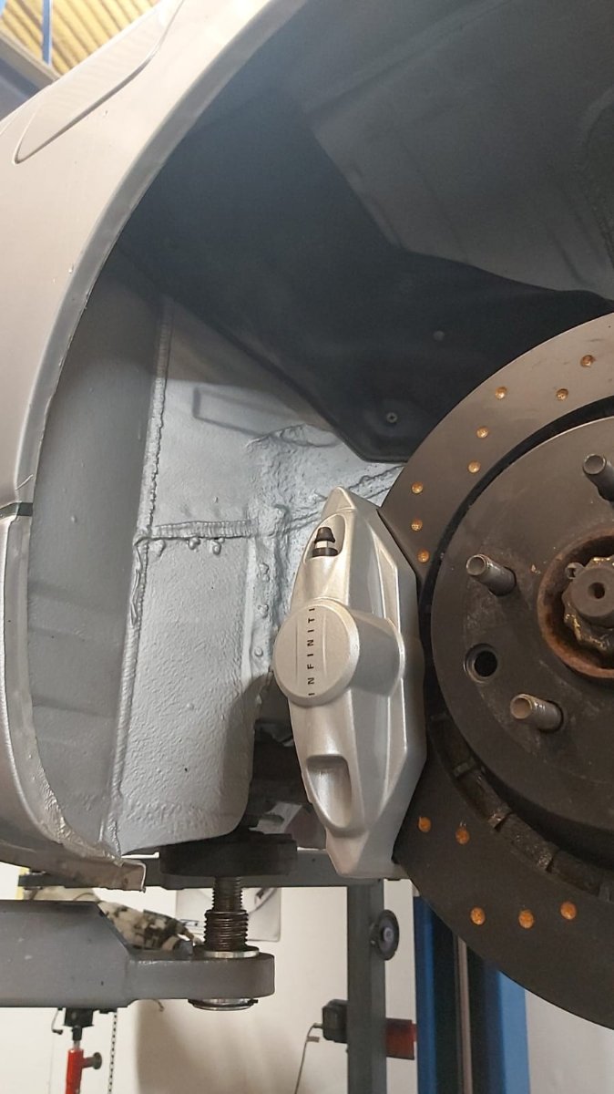

Although a sound shell is the most important part, it is no good building on sand.

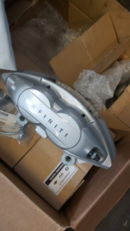

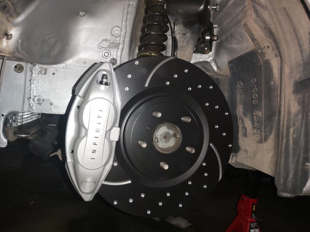

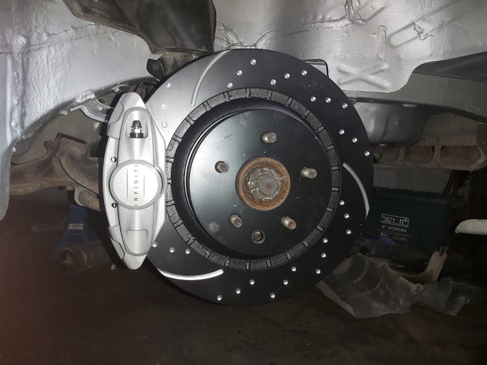

I do have some sexier pictures for todays post, Akebono brakes front are rear.
Because of the size of these new brakes the 17" Work Equips are no good and have already been sold, 18" wheels are on order and will be going on this shorty.

What wheel size and offset did you go for in the end? These are my ideal brakes but sadly won’t fit under my wheels.
