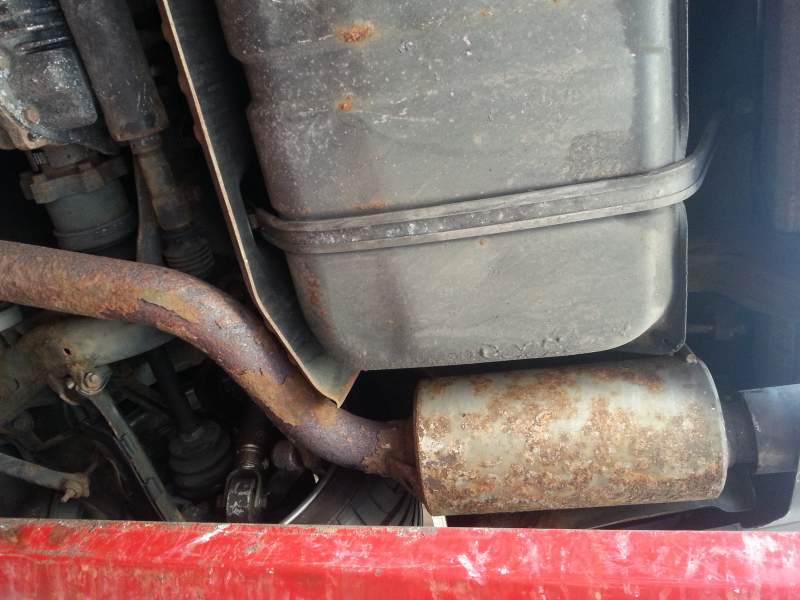

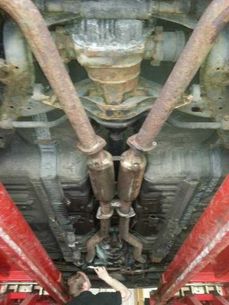

If some of you remember i'm looking at changing my exhaust, The pipes from my mid section to the backbox are badly corroded and have got little holes behind the wheels and they're slowly getting bigger.
I'm still unsure what to do. I've managed to find a place in Darlington that will replace those two pipes with stainless and attach them to my original Kakimoto boxes for £80 a side. however the boxes are quite old and looking through the pipe it doesn't seem to have a lot of packing left inside them.
The bloke said if I provide new back boxes he will fit them at no extra charge. but if he were to be providing the back boxes then it would be £200 a side, but he said it would be very loud, and would probably ruin it.

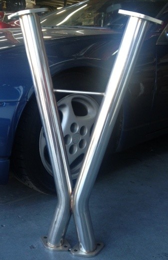

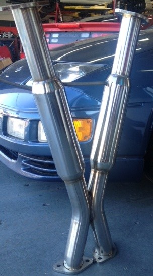

Are the resonators fitted in the centre xpipe?
Yep,
Bit of a daft question, but the two box thingy's in my centre section, are they resonators :blushing:? How much difference does the shape of the centre section make? Mine looks like a H join but I believe its actually two separate systems, and they don't actually join, having it off in the past and looking down it, it looks like two separate pipes.
The two sides should be balanced in some way (X or H pipe), its to do with the offset negative pressure pulses from each bank, but it also improves the sound.

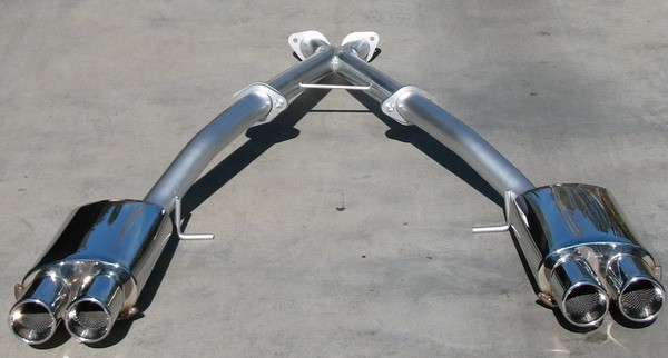

Its 2.5" pipes from mongose system, no cat + x-pipe + back boxes like on picture below
Edited by Draxan
are the boxes mongoose too? it sounds nice, what's it like on motorway though, or just round town?
No they are not mongoose, now i dont know brand of them. On motorway around 2-3k rpm they are resonating (like a subwoofer) , so its not a really nice and quiet exhaust ;) . But i think sound they make is really nice :)
